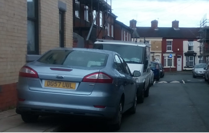

Yesterday I had the pleasure of taking a couple of murder enthusiasts on a tour of a few of the famous crime scenes of Liverpool. While visiting the site of the Cameo Cinema murder, a notorious miscarriage of justice resulting in an innocent man getting hanged,   I took the opportunity to snap this booted beauty.
Very tidy indeed and looking sexy in its base model beauty.

It's only a 1.8 diesel!  I'm now enjoying something of a chubby on.
57 plate. It doesn’t get much earlier.
I have seen an 07 once, IIRC.
