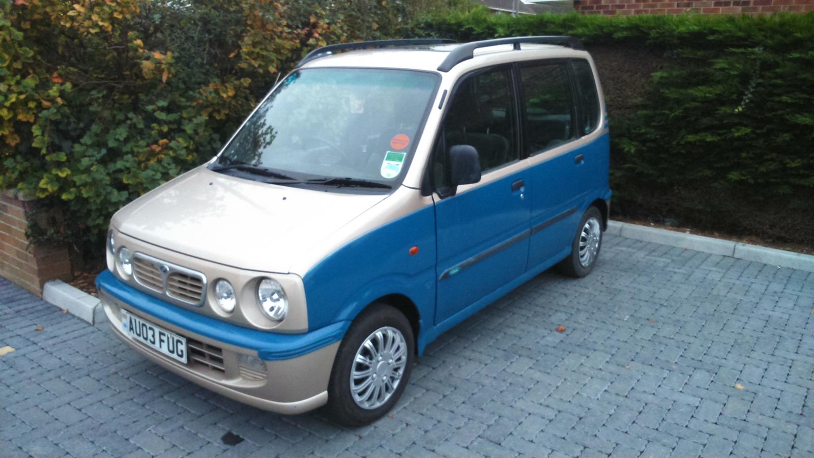

While we're on the subject of car electrics, as well as the Vectra-related shenanigans that I've posted about elsewhere, the other task for today was to fit the replacement alternator for the Perodua which arrived in the post yesterday.  It was a bit of a faff to get off (I had to remove the PAS fluid bottle to be able to get to the top bolt, and the only way to actually get the alternator out of the engine bay was to roll the car off the ramps, jack up the offside front so the suspension is at full hang and then wiggle it out between the inner wing and the driveshaft), but refitting was indeed the reverse of removal and I now have a charging alternator.  The fanbelt is a little bit squealy for a few seconds after startup, but I can live with that for now - especially as it's such a twat to adjust.  I'd never bought a secondhand alternator before, but it's doing the job, and for 30 quid delivered I can't moan too much.
Here's a picture of it, resplendent* in its new two-tone paint scheme.
