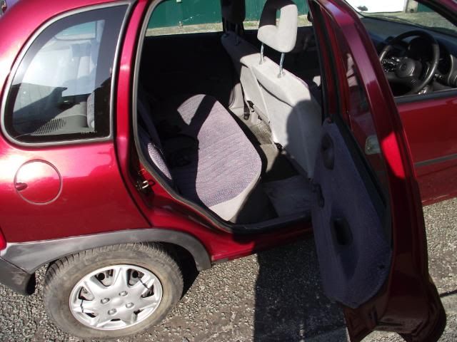

Applied light amount of elbow grease to Corsa on Sunday, came up a treat though a couple of minor OAP dings/'repairs' were highlighted. Pictures don't show how clean it actually is, the paintwork (mostly) shines like new.
