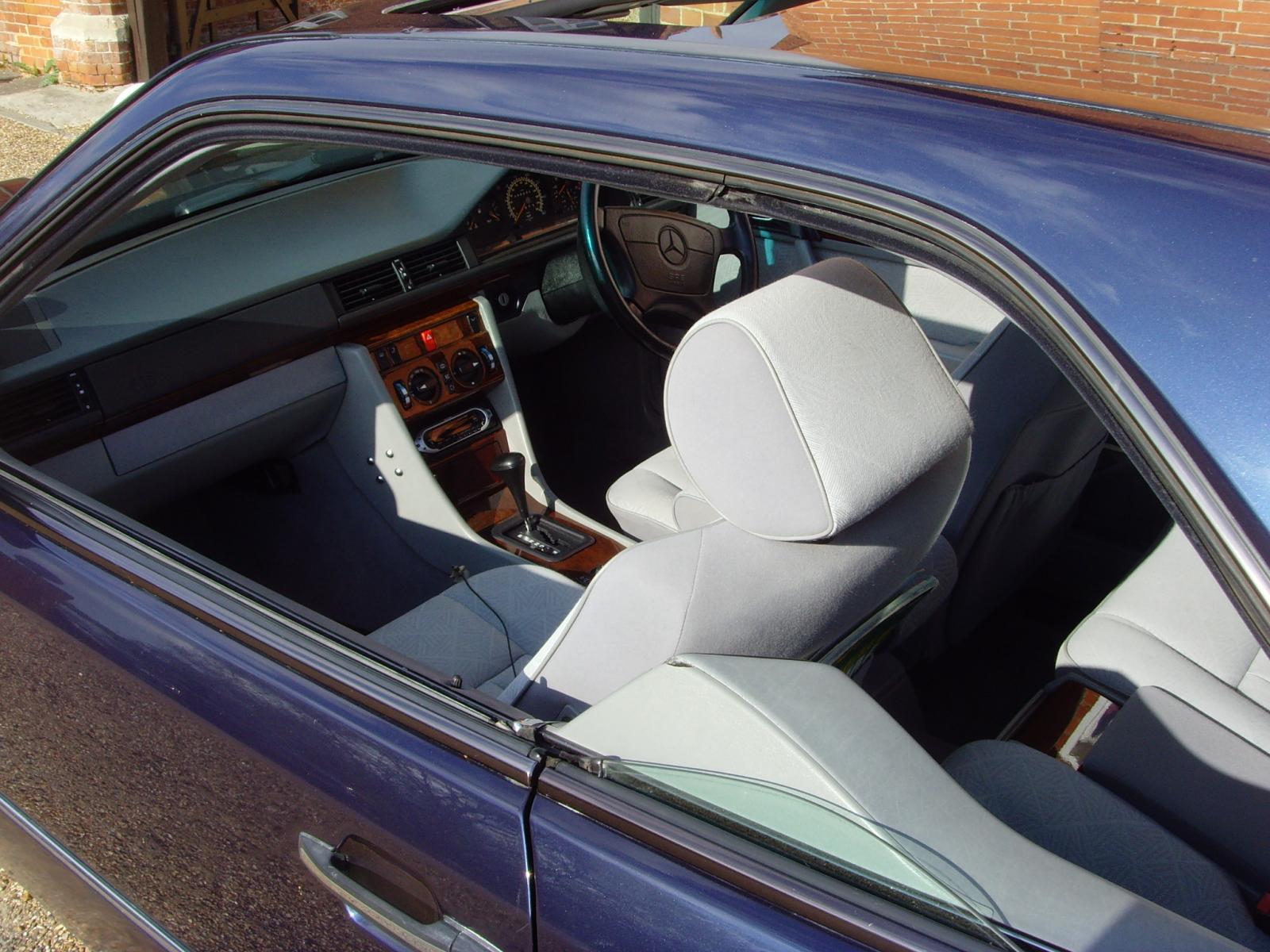

Used the merc. for the first time for a week today. It seems to have developed what I would only describe as a heart murmur. When cold this morning the idle was a little uneven but it sometimes is until it's up to temp, but on the way home revs were fluctuating at idle. Under power was fine and the problem seemed to go away if put into N or P.

Could be lots of things, idle control valve may need a clean, most likely cause as if its only idling wobbly in N or P then that's when the idle valve is supposed to work, try turning on your heated rear screen as the car's idling, the idle should momentarily drop then the idle control valve should immediately bring it up a touch to cope with the extra current draw of the heated screen. Or perhaps take your OVP relay out and clean the terminals. After that its probably a vacuum leak somewhere, brake cleaner in the engine bay time for a more exact diagnosis.
Funnily enough I spent this afternoon chasing a few vacuum and electrical gremlins. Probably only placebo maintenence (I.e. the car probably doesn't run any different to before but after lightening my wallet to the tune of €50 then I imagine that it does), new OVP relay and 6 new sealing rings around the plastic holders the fuel injectors slide into. The new sealing rings may have made the seal around the injectors marginally better, no noticeable change in engine running when I sprayed all 6 in turn with brake cleaner. Just a shame that the bloody cold running regulator (a modification to get cheaper tax on an old gas guzzler) will always be an air leak, but now the car has two years TÜV I might sneakily de-modify it to see if the idle smooths out.
Ah, the rear screen is something else not working now - usual coupe delaminated screen. I was thinking about the idle control valve though (and the dreaded loom).  I have sent an email off to my local specialist. Was doing it again this morning on the way to the supermarket, but oddly not on the way back.

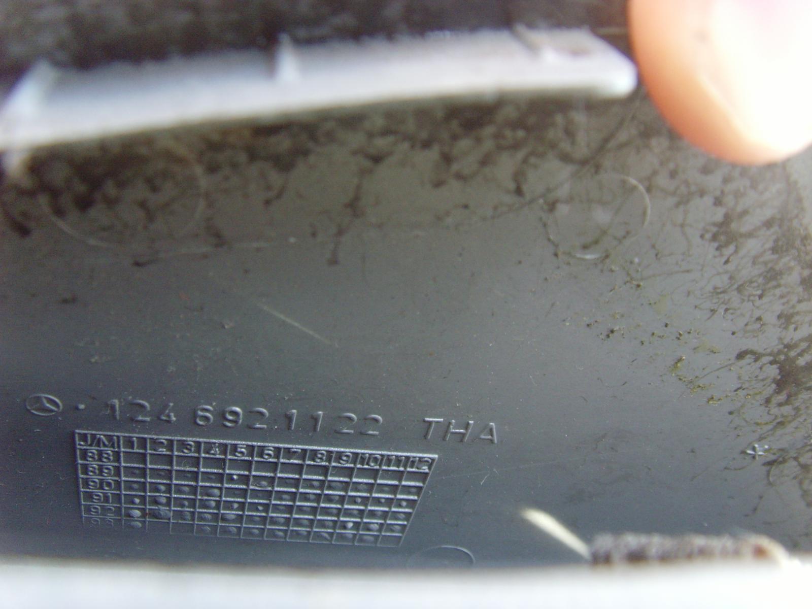

While I'm thinking about it. The only thing I need for the interior is a new trim panel that covers the side of the seatbelt butler. I can't find one in the uk, would you know what the german name is so I can search on ebay.de?

You would be looking for a Gurtbringer or Gurtgeber. Try either of those plus Abdeckung or Verkleidung , both of which mean cover or panel. Or even better if you look up the part number off online parts catalogue and put that in the ebay search box.
Not really the one in the link; that's for the rear, what I'm after is the triangular shaped thing in the photo between the seatbelt bump and side window. Mine has a chunk out of it. Thanks for the words though - I'll try them out.
A few interior panels show up with those words, but no sign of the one of interest yet. Have added it to my saved searches though.  I have just been out though to look at the back of the panel and get the part number.

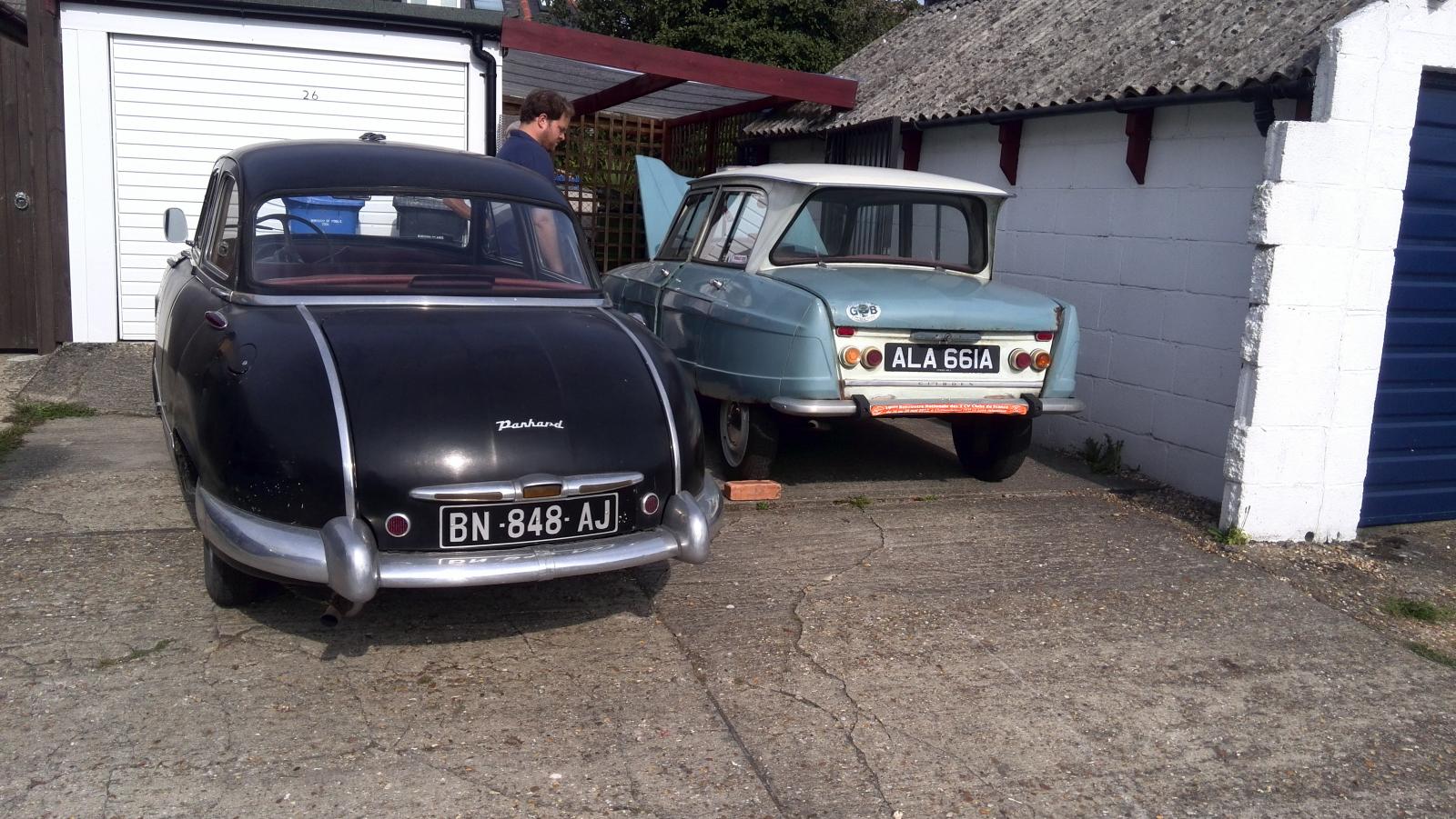

Pretty much as expected really. Obviously well loved but showing its age after 12 years in an open fronted car port. Chap has done 75,000km in that time though including solo trips to Sweden and it seems mechanically perfect. Lots of ugly welding underneath but it all seems solid. We'll have a punt at what I reckon it's worth if we can find some money, but I won't lose any sleep I it goes for silly money to somebody who didn't bother having a look. We'll see
I went to see a Traction Avant like that - looked good and interior was nice, but it hadn't run in 15years. I took along my citroen mechanic friend who has four of them and gave it a good going over and made a list. The price on ebay at the time was about £2700 which we thought was ok and priced up all the work and parts needed (sills, bit of floor, fuel tank, tyres, bearings, brakes, full exhaust, etc) to be about £3500. So set a limit of £3500 for the bidding. Eventually sold for £6500 to someone who hadn't been to see it. The reg. hasn't appeared back on the traction owners club yet either, and this was about four years ago.
