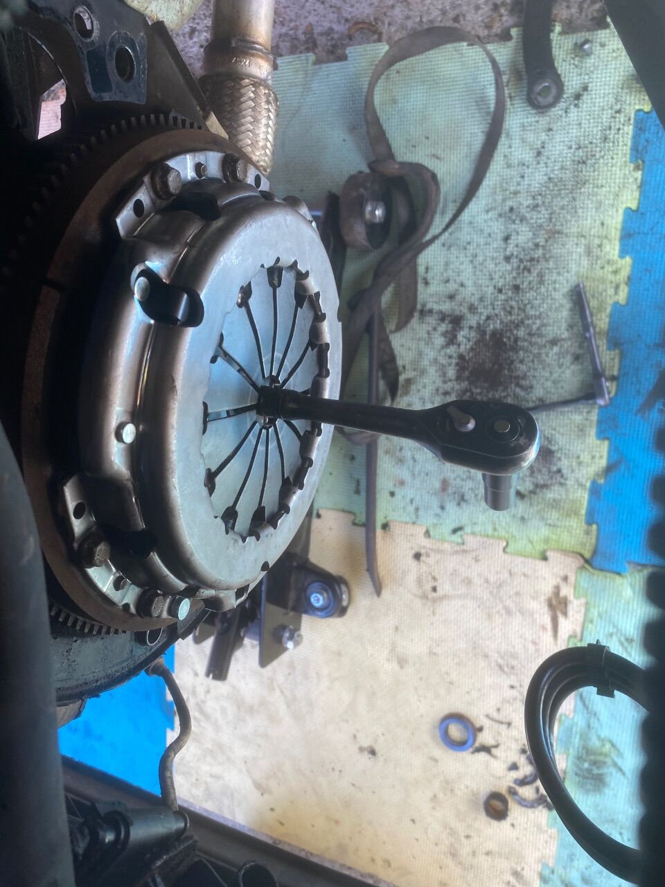

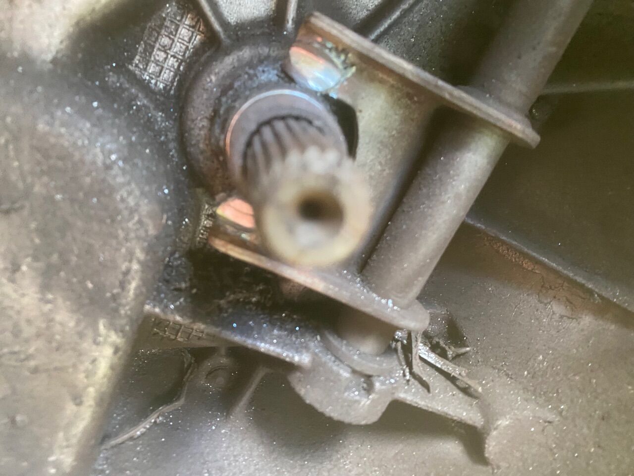

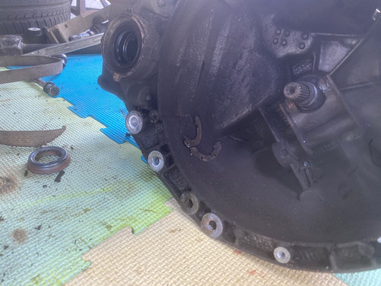

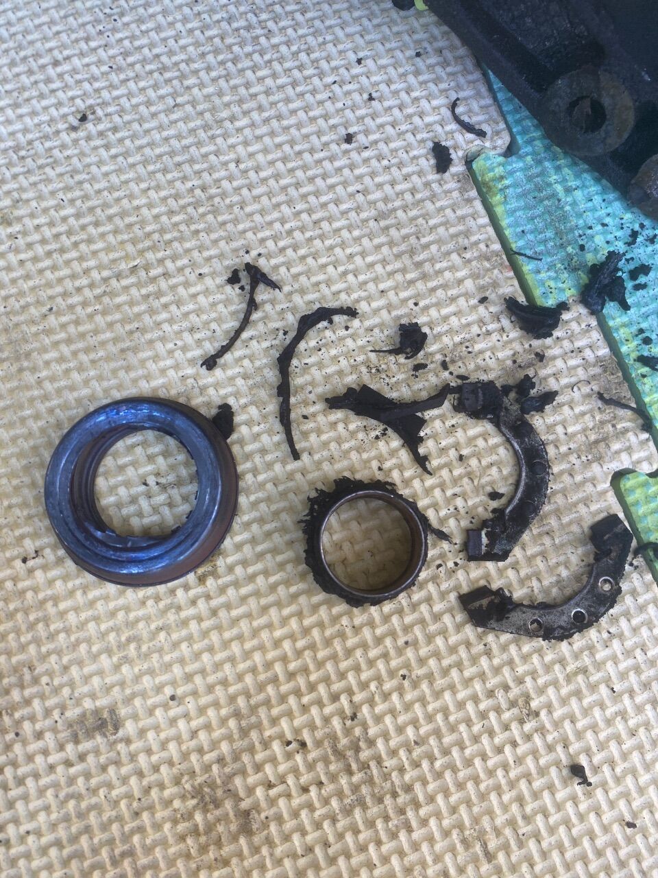

Always nice when the diagnosis is correct. Release bearing fell out in bits as the box came off. Clutch fork pushing thingy pretty eaten up too so not going back together today by the looks of things.
not sure how easy the input shaft bearing and oil seal are to do but they're also a weak spot on these so worth doing if possible
Despite there being oil kinda all over the engine and box inside the bell housing is dry muck. I'd heard about the input bearing woes though have satisfied myself with a dry seal and no wiggle on the shaft after a cursory check. My desire to split the gearbox is not strong haha.
Just stopped for tea and a bite to eat. Shall fit the clutch and get to the factors tomorrow morning. No time to work on it again till late in the week by which time they'll be a lot of guess work with what bolt goes where. All part of the fun.

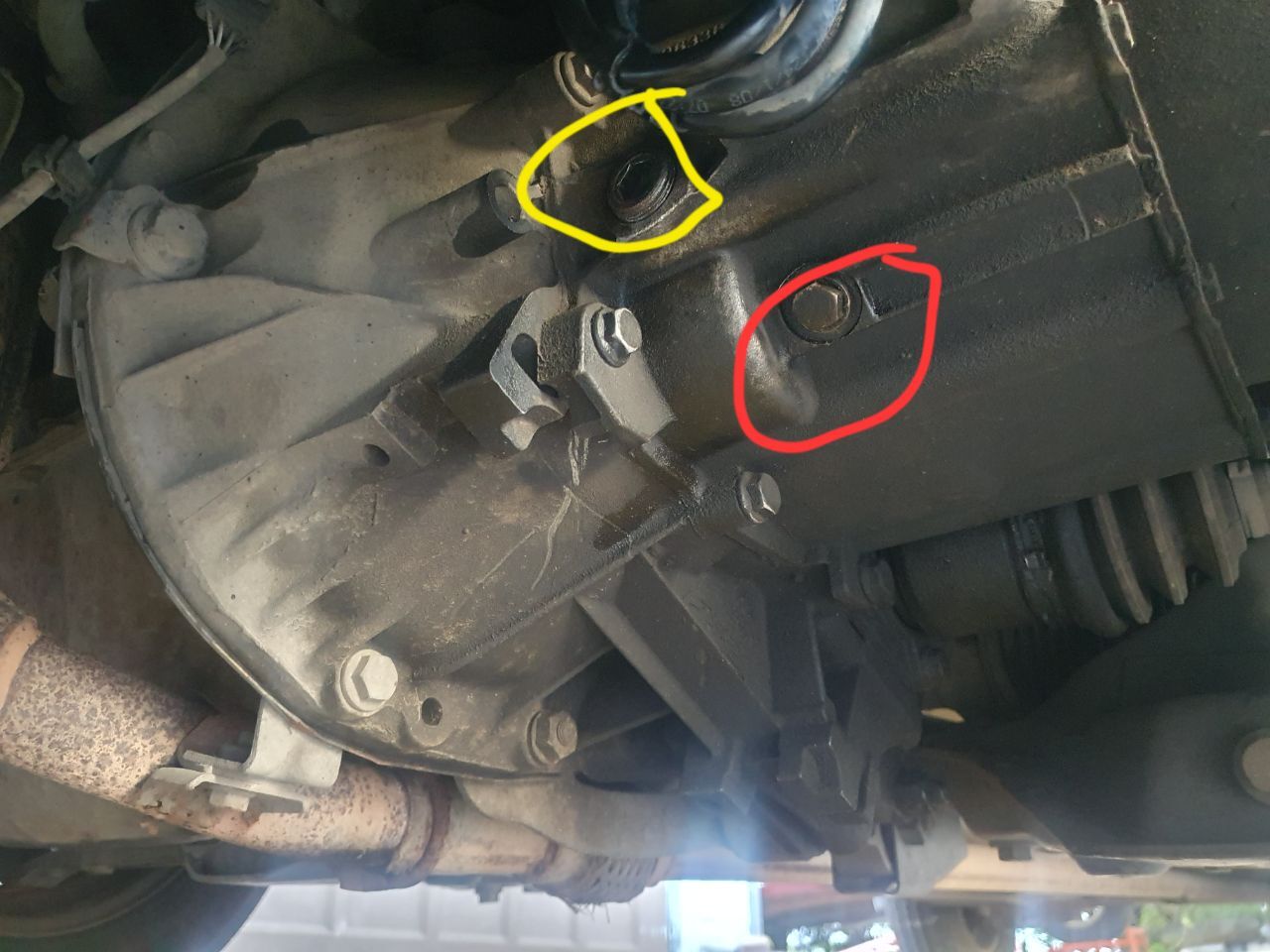

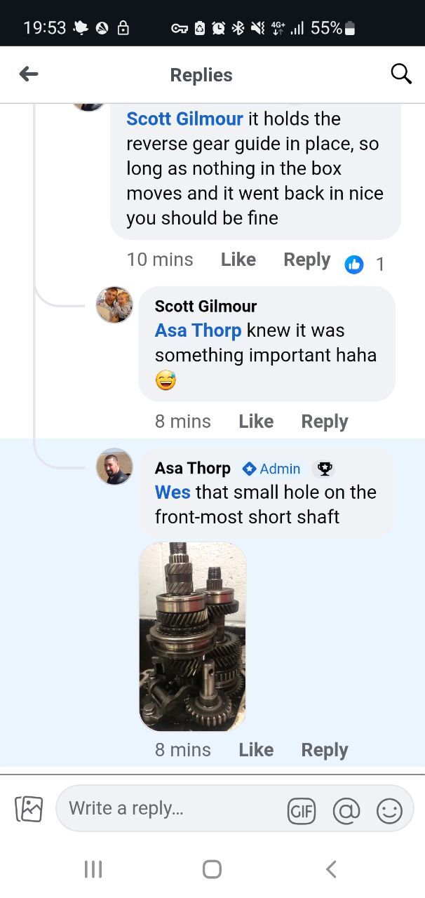

did your gearbox filld/drain look like this?  Drain in red fill in yellow
I can't find another drain but struggled to get more than about half the capacity out of the drain plug even with car nose down on slope
Posted (edited)
Ha I took that one out too and got nowt. Check round the back of the box the drain looks like the fill.
Am hoping that red circled bolt does nothing too important and wasn't holding some cogs in place!
Edited by Rustybullethole
Ta..yeah I think I've seen a video now, but was worrying that bolt held something inside the gearbox otherwise it seems quite pointless having it.
See my edit!!! Have you driven yours since?
no not yet 😬
1 minute ago, wesacosa said:
no not yet 😬
Am sure it'll be fine.

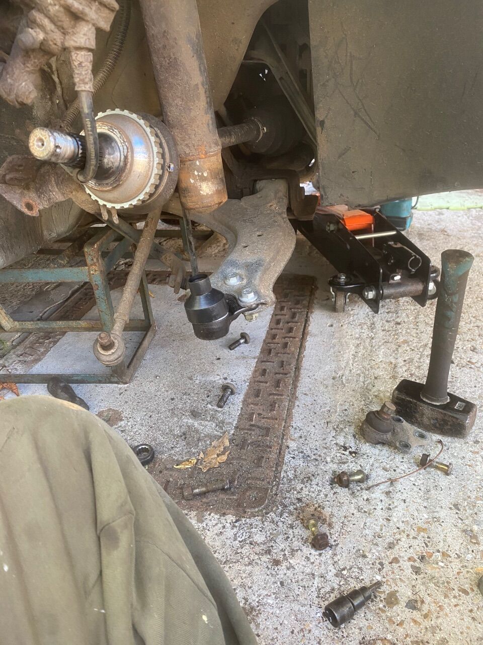

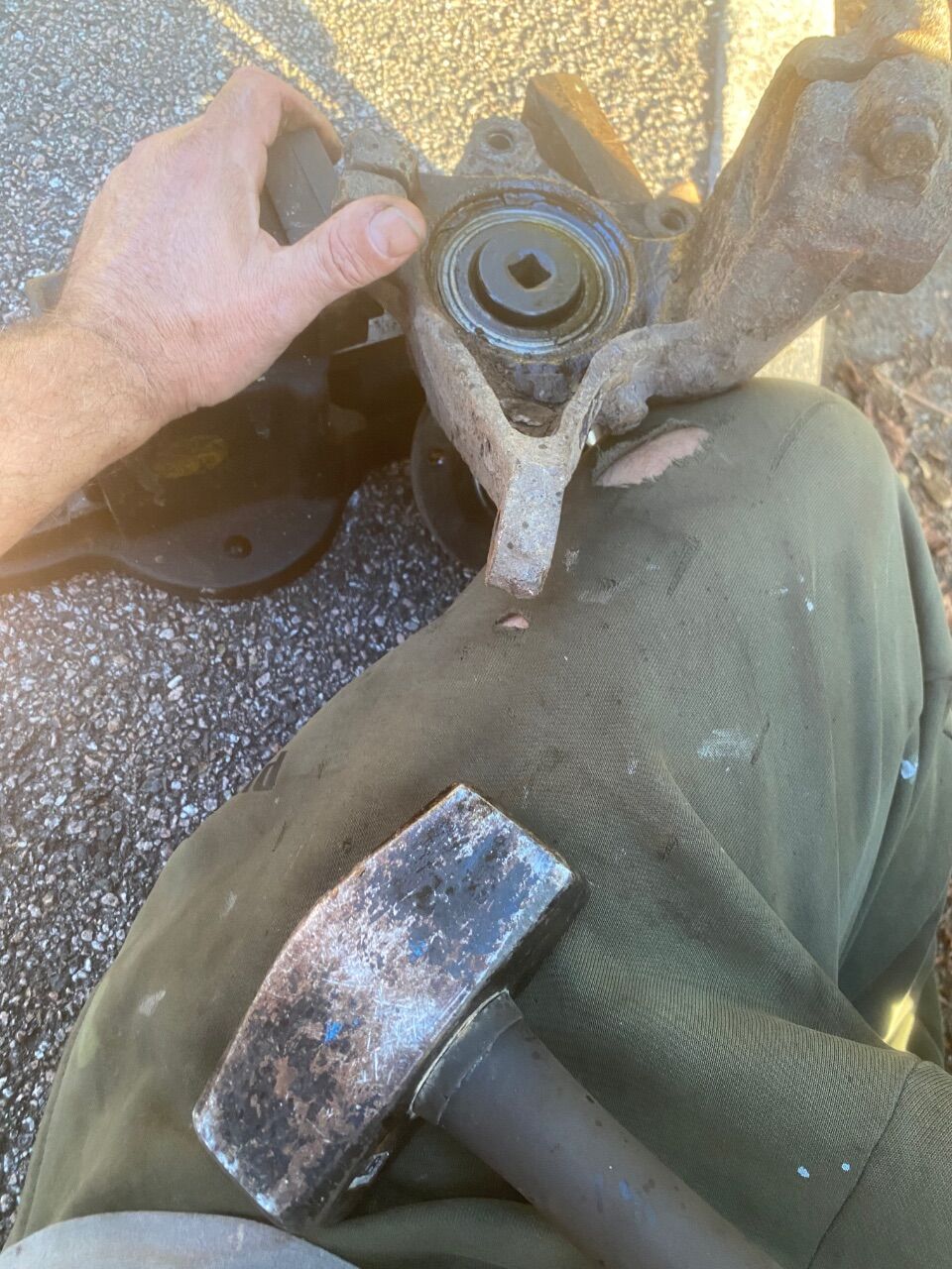

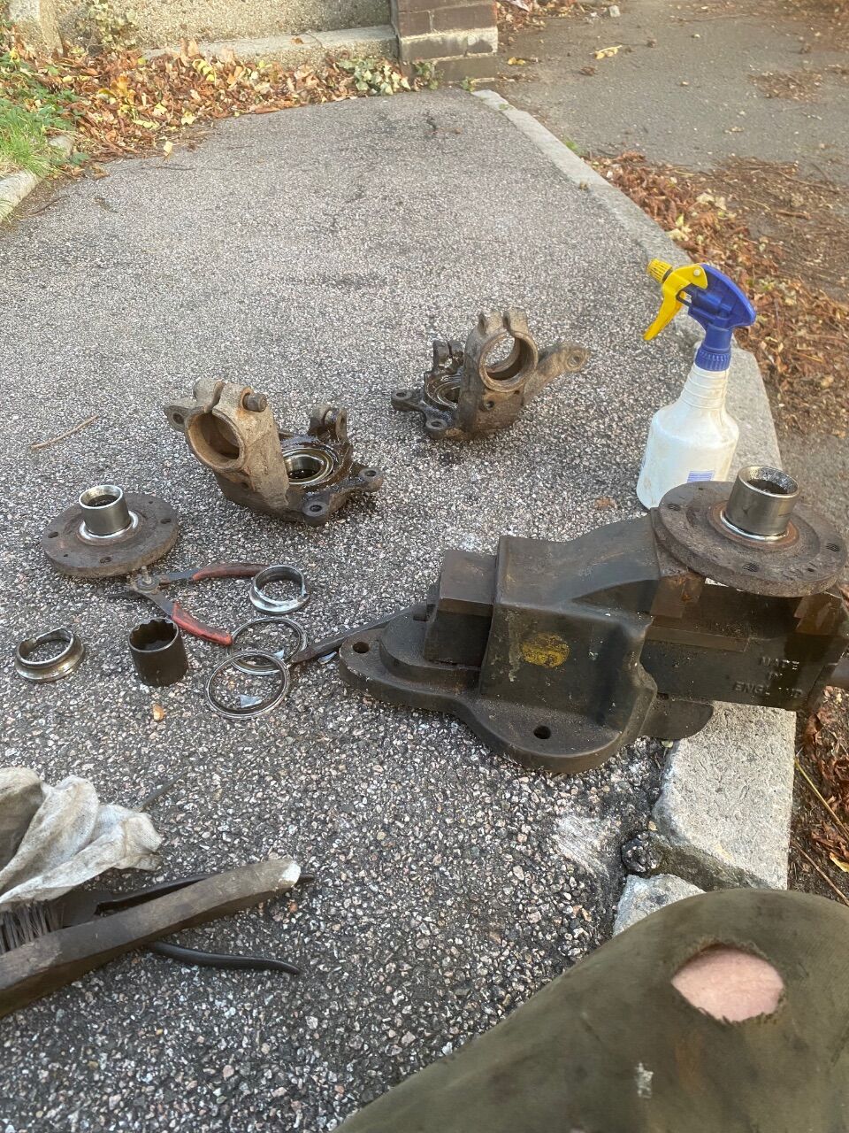

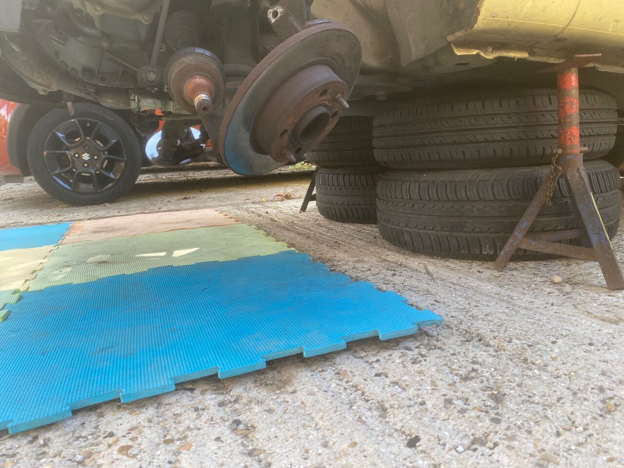

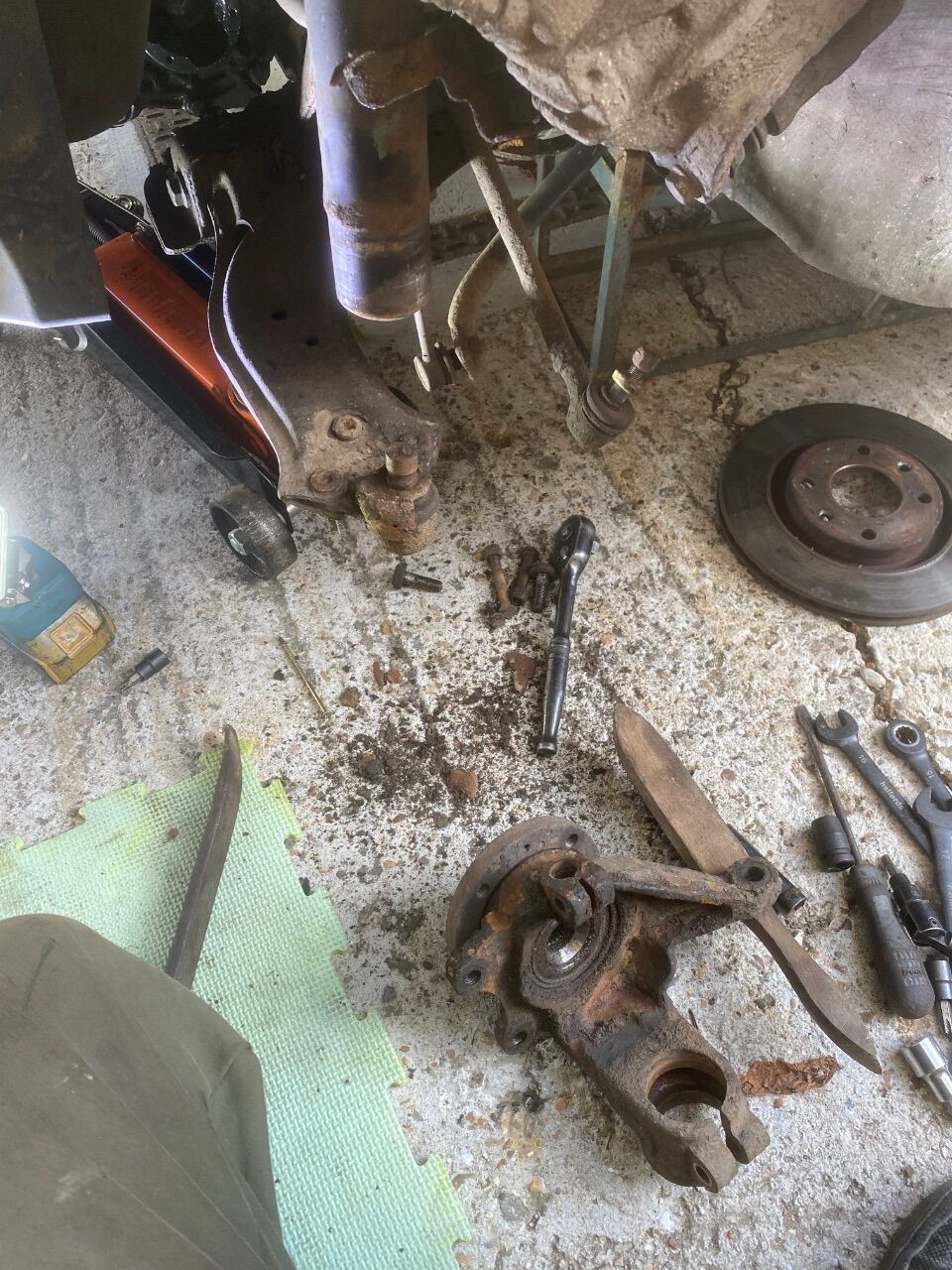

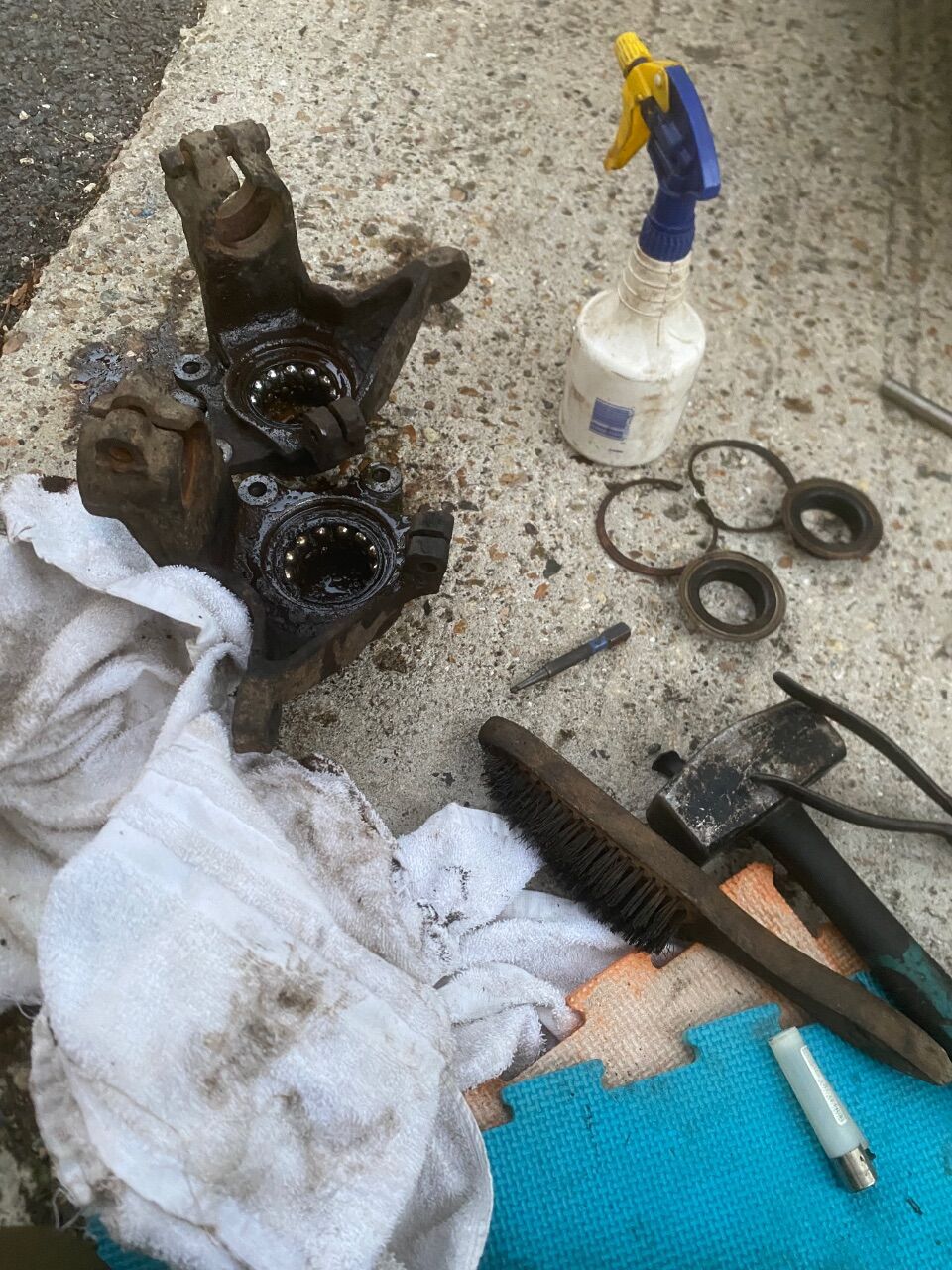

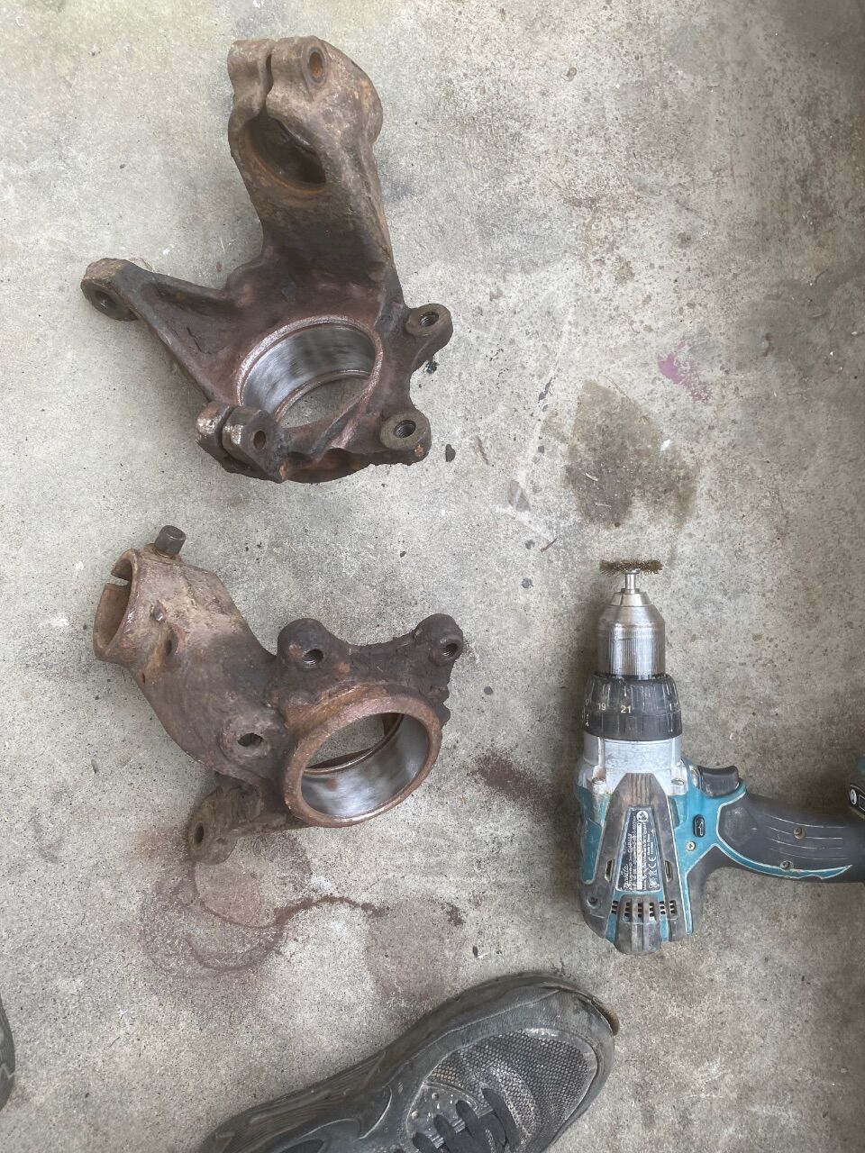

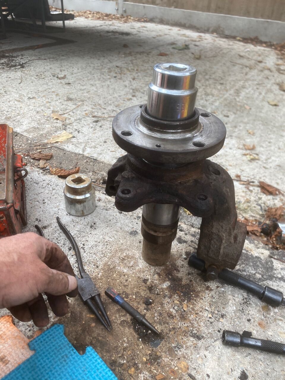

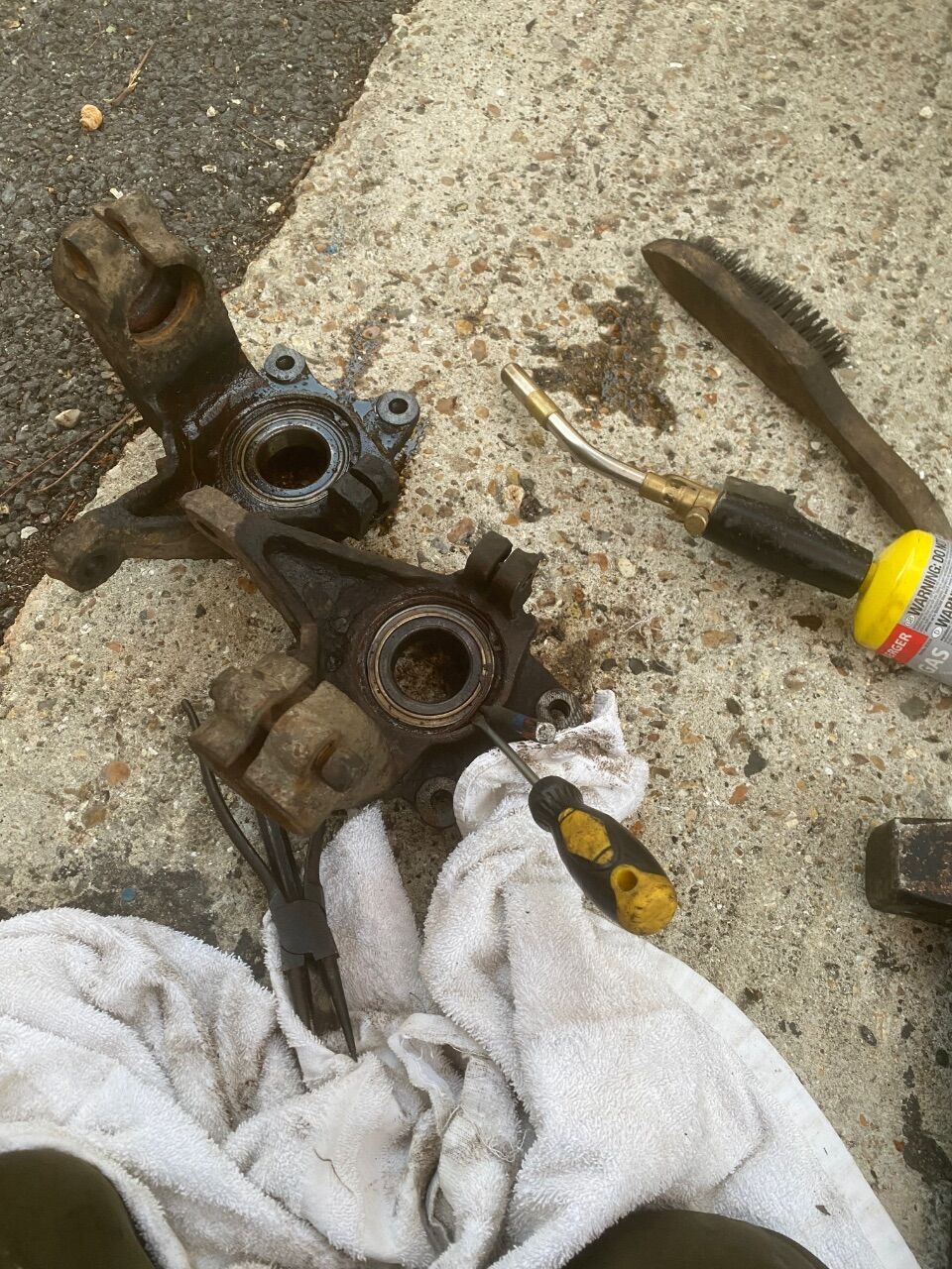

Went as far with the Panda as I could. Loads on bikes though this is the first car clutch i've done so has been a learn on the job process. Not sure this is the correct way of lining up the plate though seems to have worked. Truth will be when lining the box up I guess.

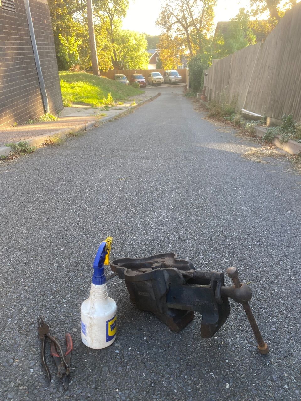

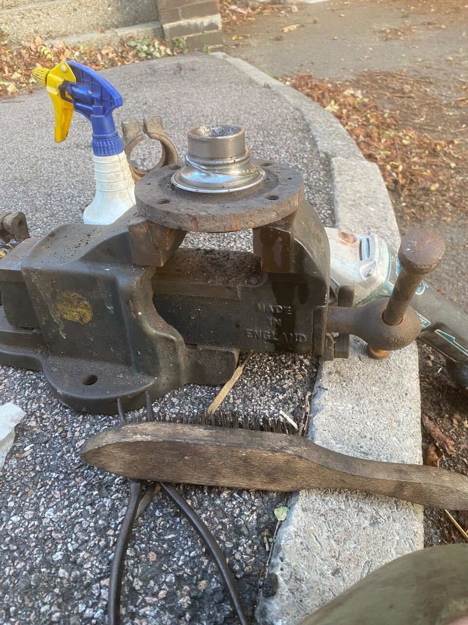

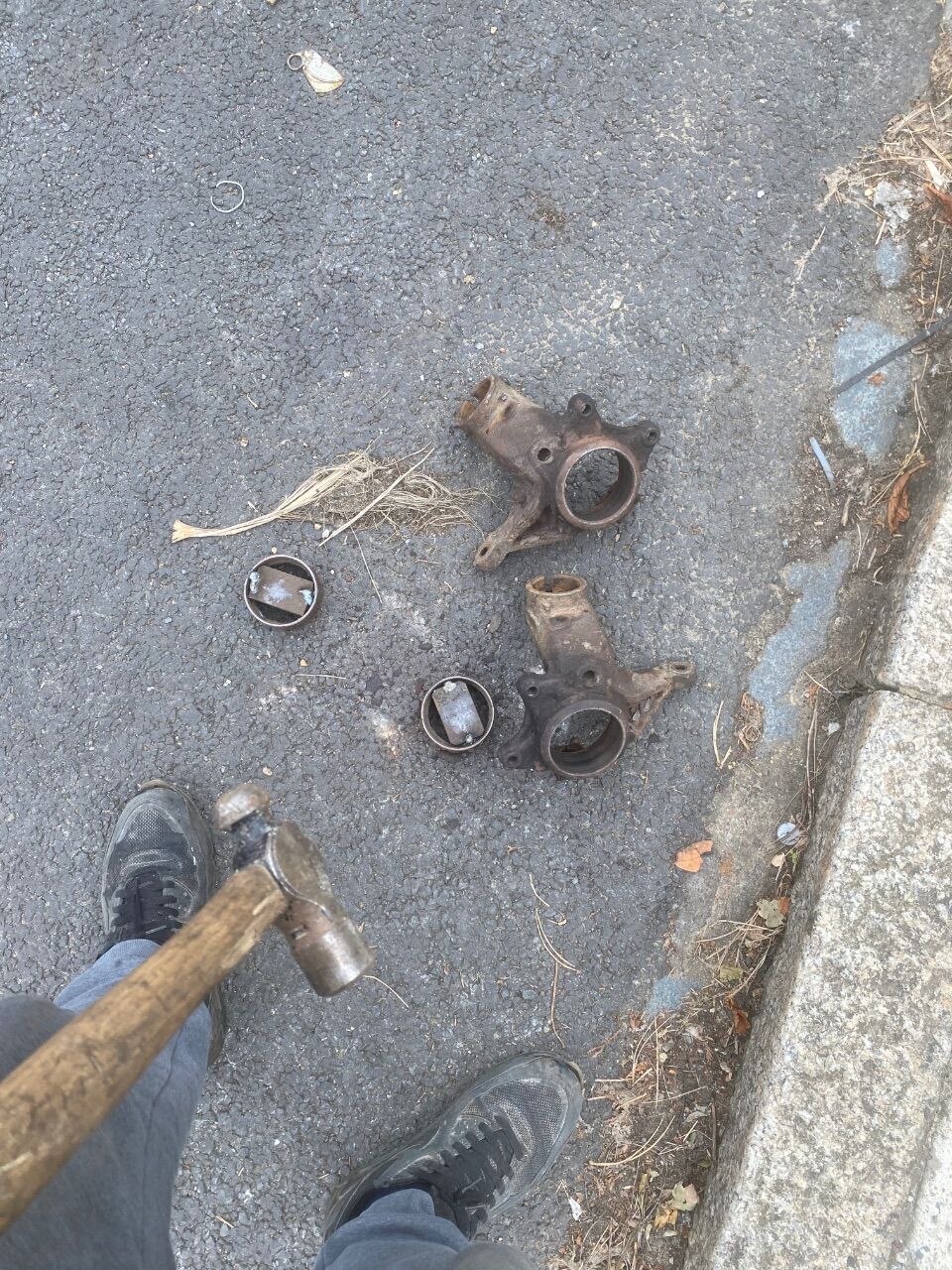

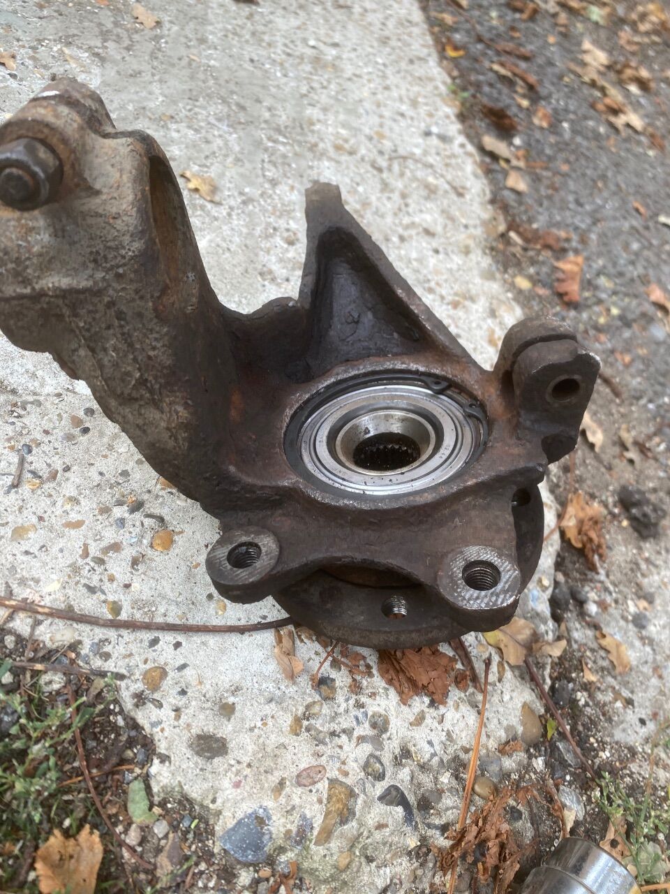

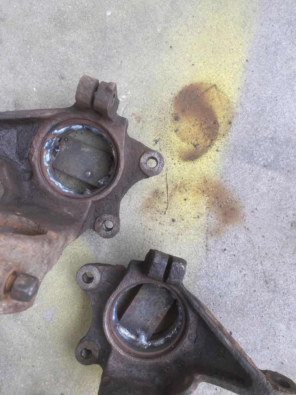

I then disabled the Berlingo. Wheel bearing was howling and all of a sudden has loads of play so shouldn't be driving it. Hubs off and apart and new lower ball joint fitted.
I don't have a press sadly though do have a vice. Well more than one to be honest.
Jaws a bit small to fit the hubs in though got them apart and inner bearings out.
Circlips are holding fast and would like to avoid snapping my pliers if possible so leaving them to soak and maybe come back with some heat.
Dark was setting in so that's that for today.

Haha no way! Fingers crossed. Surely lightning can't strike twice. Or three times. Guess we might both be replacing that output shaft bearing if the worst comes.

Surely if something had moved the bolt wouldn't have gone back in cleanly? That's what I'm convincing myself anyway .  What a fucking stupid place to put it!
Yeah looking again at the pic I make you right there. Looks like it would be a case of access denied if out of line. Funny thing is I had the Ural box incident in my head as I undid it thinking it was strange that it was such a small bolt. The Ural one was holding a spring in place which went wayward. Sure we'll be good,
I'm thinking if nothing moved in the gearbox and the bolt went back in ok it should be ok.  It's not like the bolt was holding it in place and it could drop out when removed unless something in the the gearbox was moved
As I said its a bloody silly place to have it ,  clearly, as it caught us both out. Id had a good look around the box before I took it out and couldn't see anything else that looked like a drain, coupled with the fact it had a washer
Im guessing it should be obvious if its broken once I try and drive the car...

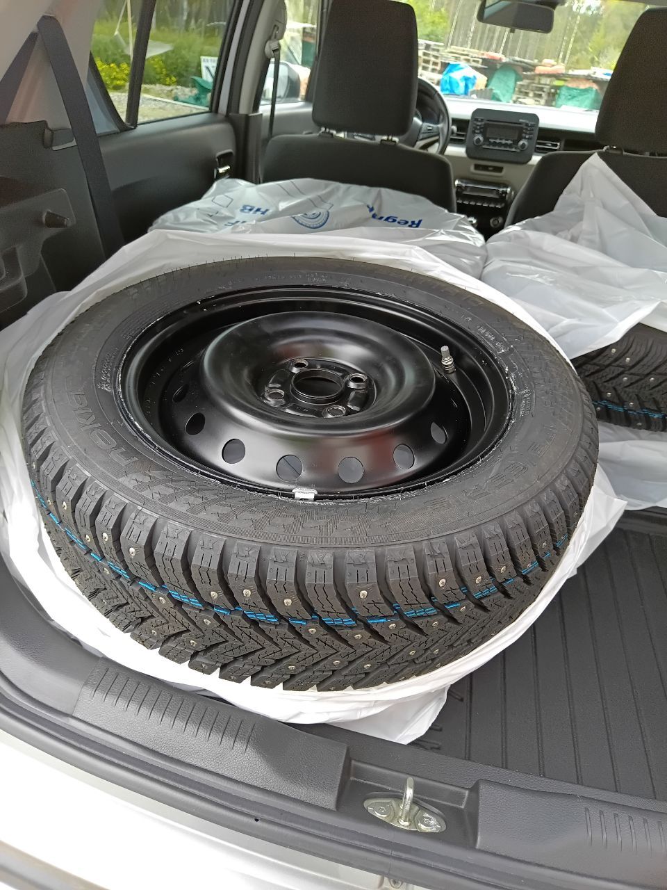

Suzuki's winter wheels got 4 new Finnish Nokian Hakkapeliitta 10 studded winter tires today
Interesting .. I thought they'd stick out more?
The studs only stick out a few millimeters, but it's a enough to make a difference.
