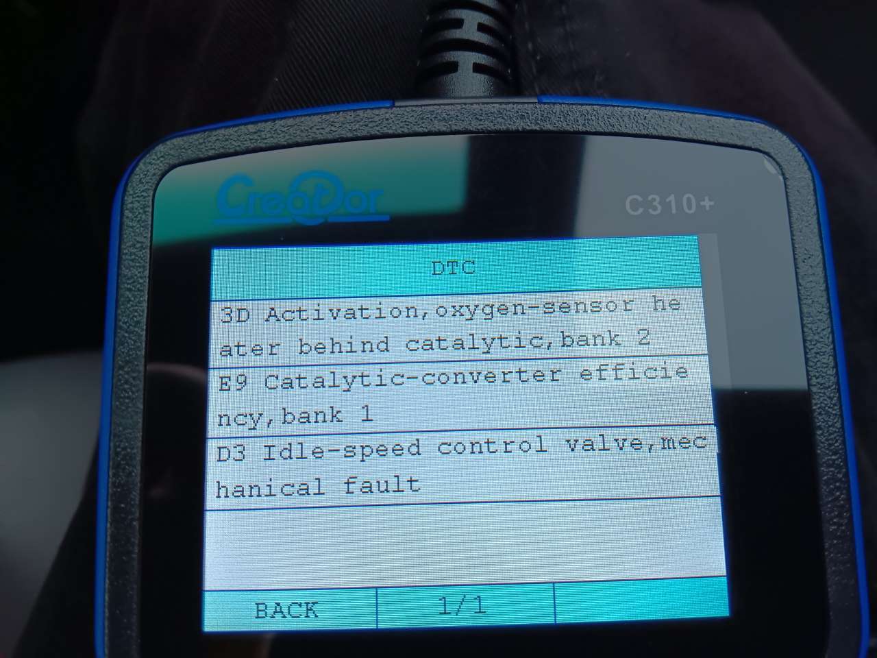

Cleared the codes on the E46 and these 3 lights came back on:
Code reader says:
- 5e19 CAN data fault from DME/DDE (DSC lamp is on for as long as error is present)
- O2 sensor bank 2
- Cat
-D3 idle speed control valve mechanical fault.
The wheel speed sensor code is gone so that must have been an old one from when they really were faulty last year.
I'll ignore the o2 sensor for now as that's expensive and I think there's a primary fault causing them to error.
The CAN error - I'll check the wiring near the TB, DISA and ICV.
I'm also going to have a go at making a smoke tester with a cheap soldering iron from Amazon. I already have all the other paraphernalia.  I think there's a tiny vac leaks somewhere. The systems on these cars are over complicated and obviously ger brittle with age.
I think I might SORN this and work through the issues and get the 75 back on the road as it just needs 2 suspension arms, handbrake and the airbag light putting out. I'm convinced the E46 has a free fix waiting for me, I just need to investigate it properly and avoid spending unnecessarily.
The 75 is otherwise reliable and it's the only other car on fleet that my wife is confident driving. This is a pain having off the road as I can't currently  get the Audi off her for long enough to sort the window regulator.
DSC (Traction control) uses the DME (engine computer/ECU) data to determine how much power is being put through the wheels. If the engine computer is in a fault state so that it isn't able to send engine load information to other stuff on the CAN bus, the DSC goes 🤷‍♂️ I can't see any engine info and throws the light up.
I'd find it's highly unlikely a wiring fault causing this going by the other codes. I imagine the Speedo is driven by data over the CAN bus (might not be on this age but anything even relatively modern does) and if that works, then the CAN bus signals are fine. Just DSC system is not getting ECU data.
Clean the idle control valve and make sure it rattles (sorry intake off again)
This possibly be causing limp. Without the ICV you'll probably get a shit idle.
- O2 sensor bank 2
- Cat
Cat code on the same bank as the O2?
Is it the O2 upstream (before cat) or downstream (after cat)? If upstream then the engine won't be able to go into closed loop mode (i.e. monitoring exhaust gases and tweaking injection/ignition) and likely what is causing limp mode. Iirc BMWs use the downstream sensor more than for just detecting cat condition and possibly could also be causing limp.
What is the O2 code? Heater code or other?
"...and work through the issues and get the 75 back on the road as it just needs..." - God loves an optimist !  🤣
Loads of videos on the ICV in this era BMWs but this is one of the shortest. Others show removal. From memory you were almost there with the throttle body and just one more fastener and connector.
Thanks Si 😀 great knowledge.
Here's the exact codes:
I shouldn't need to take the inlet pipe off again to remove the ICV, just the small top pipe. No big deal of so, the jubilee clip is much more accessible with the DISA removed.
Will give it a good clean out.
Nah mine definitely didn't make that noise! Definitely needs a clean!
Heater could be dead in the O2 or just cleaning up/reconnecting the O2 sensor might help. Depends if it's open circuit causing the error or the ECU isn't seeing sensor data quick enough after turning the heater on. Warmer weather may help here.
Cat efficiency could well be the cat on the way out. I'd be inclined to put a bottle of Cataclean in as easy and cheap - I know many people swear by it to get cars through an MOT (including my local MOT place). Might help prolong it a bit more. Especially once we get warmer weather and the engine/cat warm up quicker anyway.

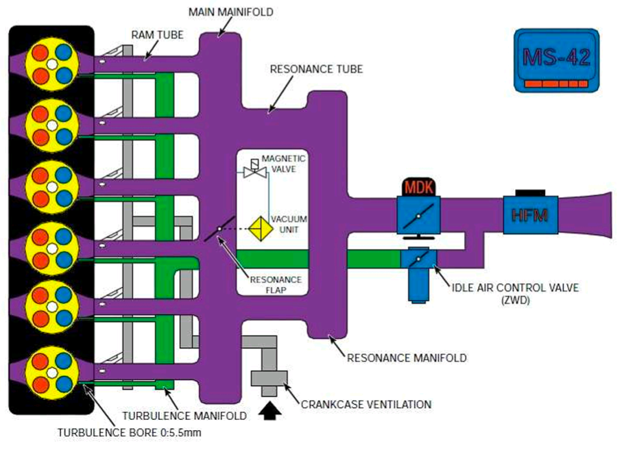

Google says other E46 users get limp mode if the ICV isn't working properly. Maybe root cause of the majority of limp mode issues you're having. Makes sense as it'll lead to the ECU being unable to fully control intake airflow as it'll effectively have a big air leak if it's stuck open.
The diagram below shows how the green tube would be constantly letting air through if the Idle Control was sticking open or if the ECU isn't able to control it.
Maaaaaaybe the excess airflow could also could cause lean fuel issues and cat code on this old a car/dumber ECU.

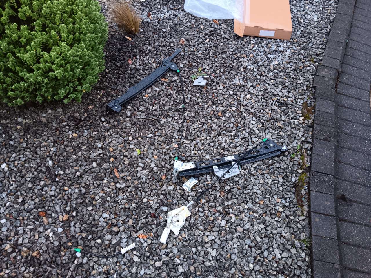

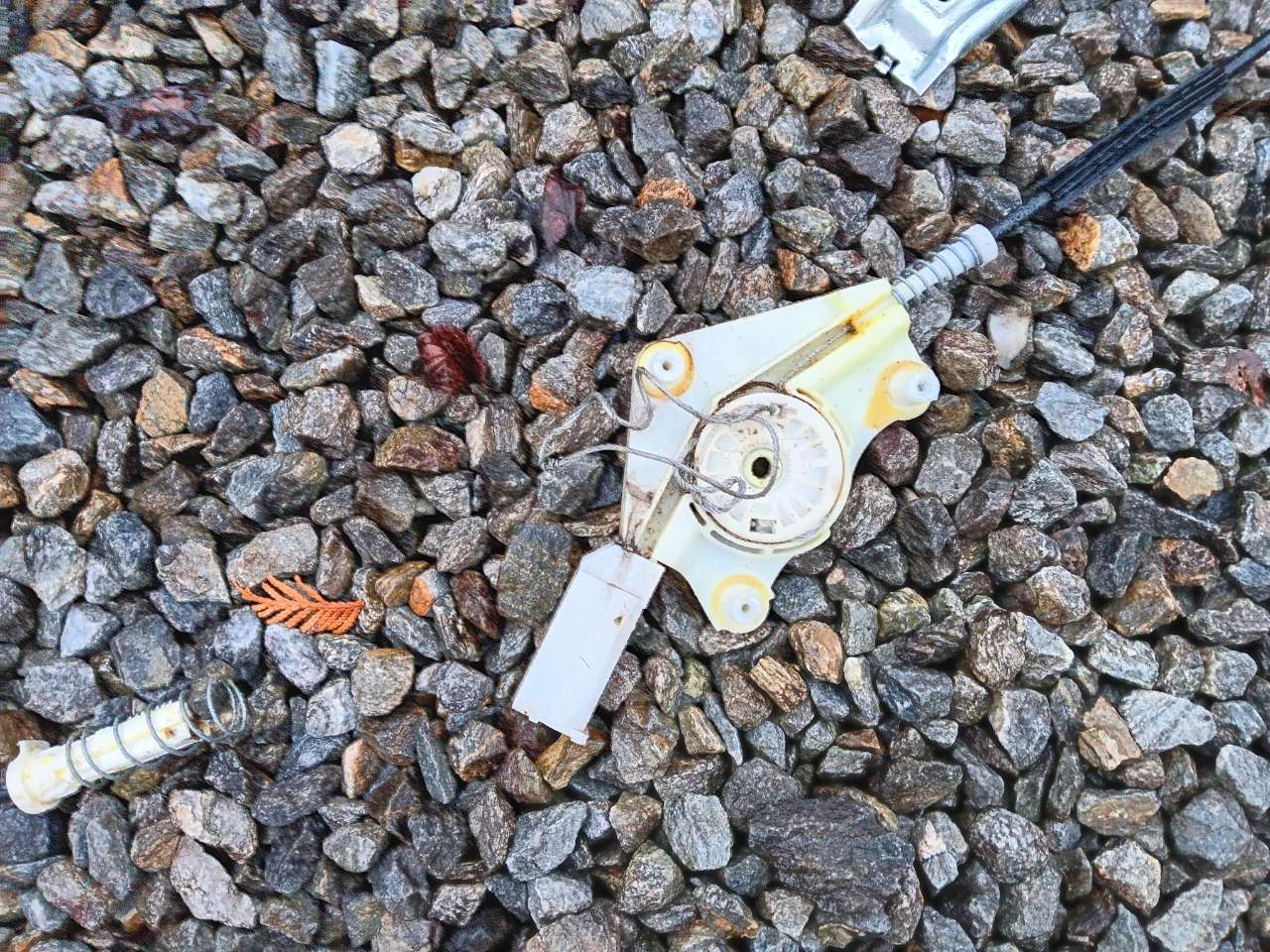

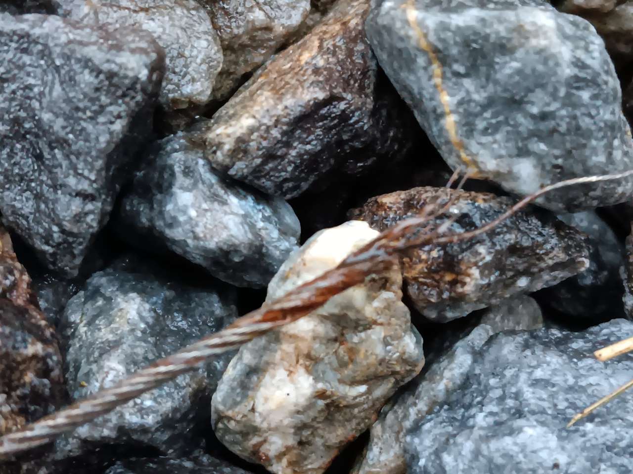

I changed the drivers side window regulator on the A4 today.
The old one was mega scrunkled up and the cable snapped:
This is the first and last time I'll speak of this. Cunt of a job.
All working nicely now and it lined up first go. It even drops again when the door is opened and closed.
