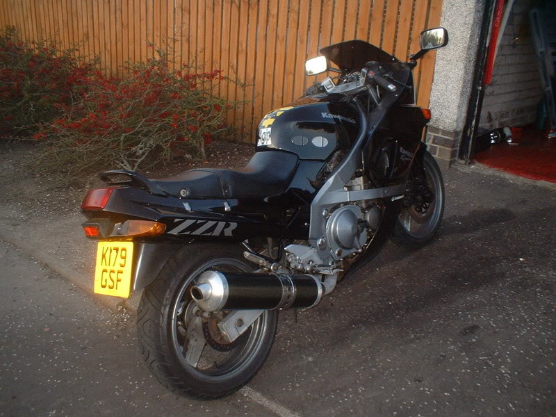

YEAH.. ZZR :)  Love these things, on my 4th.

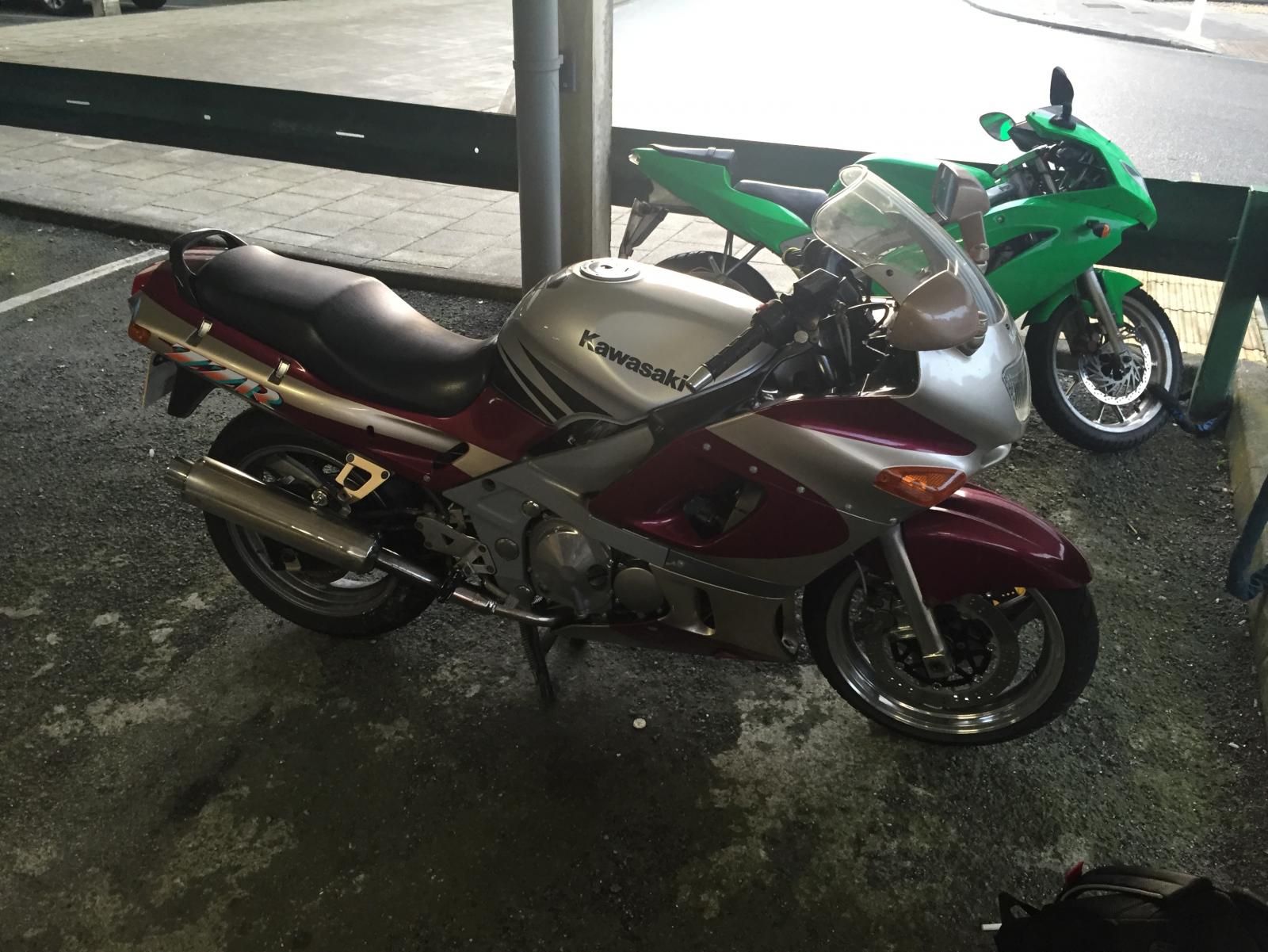

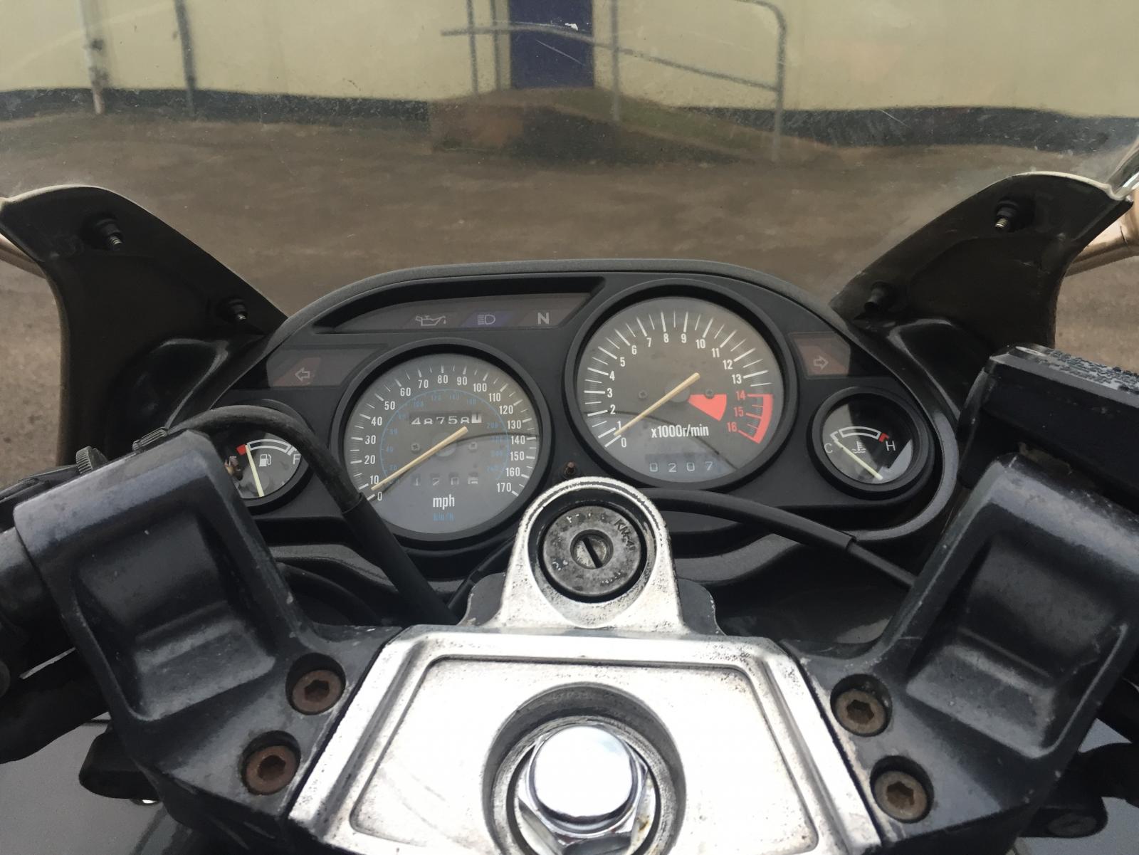

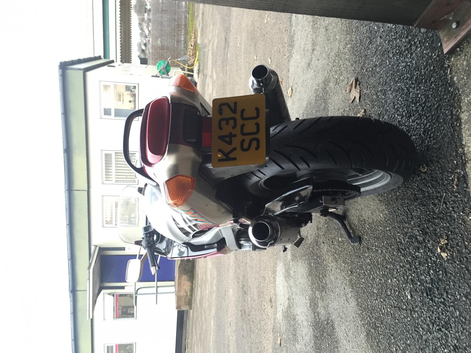

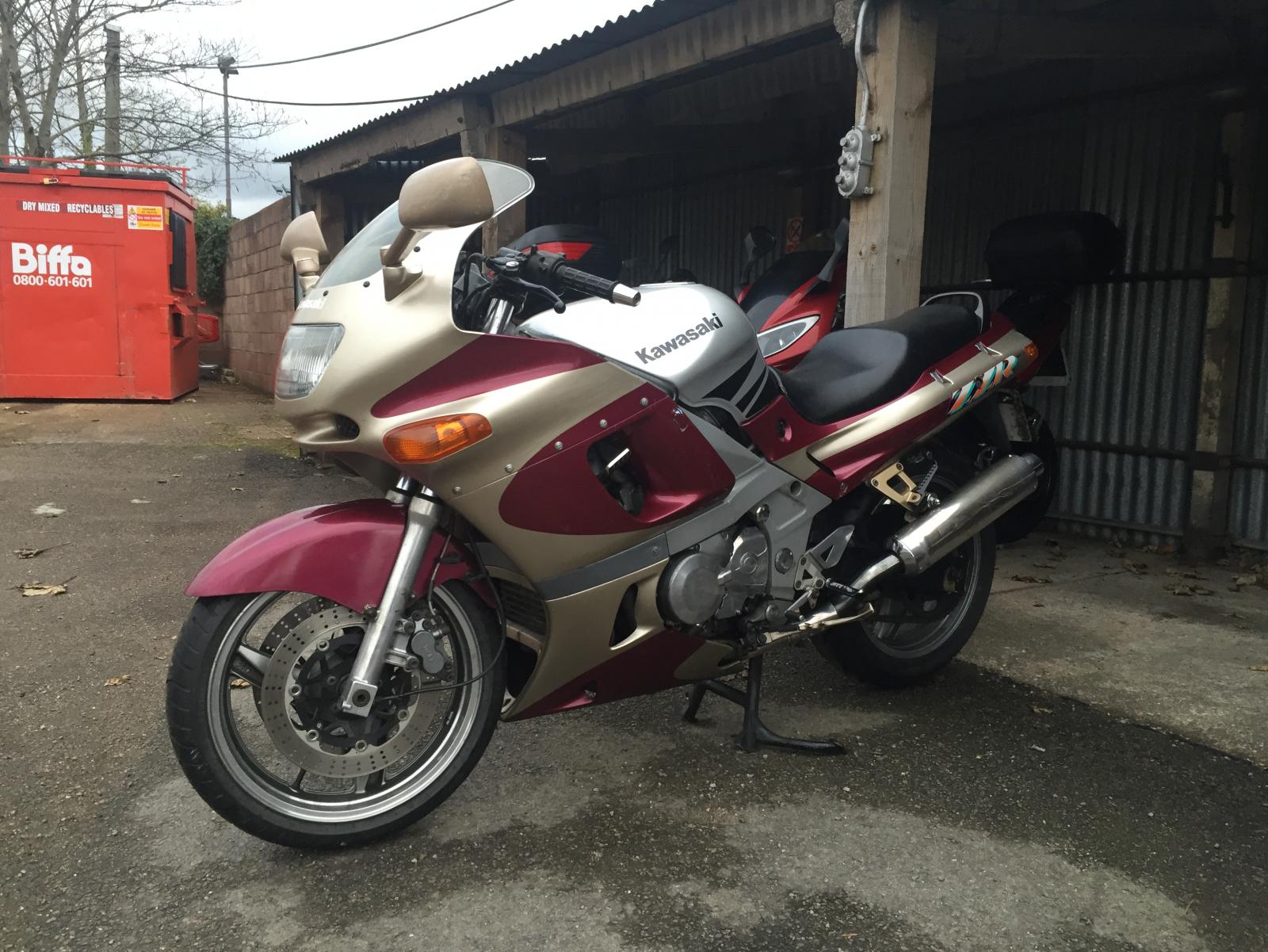

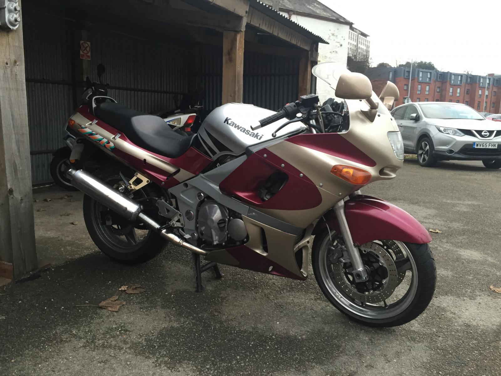

The basics: its a 1993 ZZ-R600 E1. 48k on the clock, some minor service history and a few little issues. I rode it back from Plymouth to Exeter, and got a bit cold doing so. Bearing in mind it was bought for £not much, the plastics are good, the tank is a replacement as the original got rust inside, tyres are good (although they are mismatched), a previous owner has put some effort into polishing various metal bits, and it rode from Plymouth back to Exeter easily. That said, the wheels don't match (front is polished, rear isn't), the headlight dipped beam is out and the main beam only works on the flash function, theres a rattle at idle that is probably the cam chain tensioner needing attention, the rear shock is rather well sprung, it needs a good service and applying the rear brake - even stamping on it - doesn't give exactly inspiring results.
Still, it'll be a good project. I'm seriously thinking of a repaint, maybe into some kind of deep metallic gunmetal grey with metallic Kwak green bits here and there.

Polished wheels look nice, but are a pain in the erse- GPZ had them and they'd go dull 20 mins after Solvol. They got painted. All my Kwak rear brakes were shite, but passed MOT's and Rattle at idle used to happen on mine too 'cause the idle was slightly low.
Good to see you still have twin pipes, singles tend to give an annoying flat spot and can be a bit fluffly low down.
The twin pipes sound mega, I want to paint the wheels too. Black or green, depending on whether I get the plastics and tank done or not.

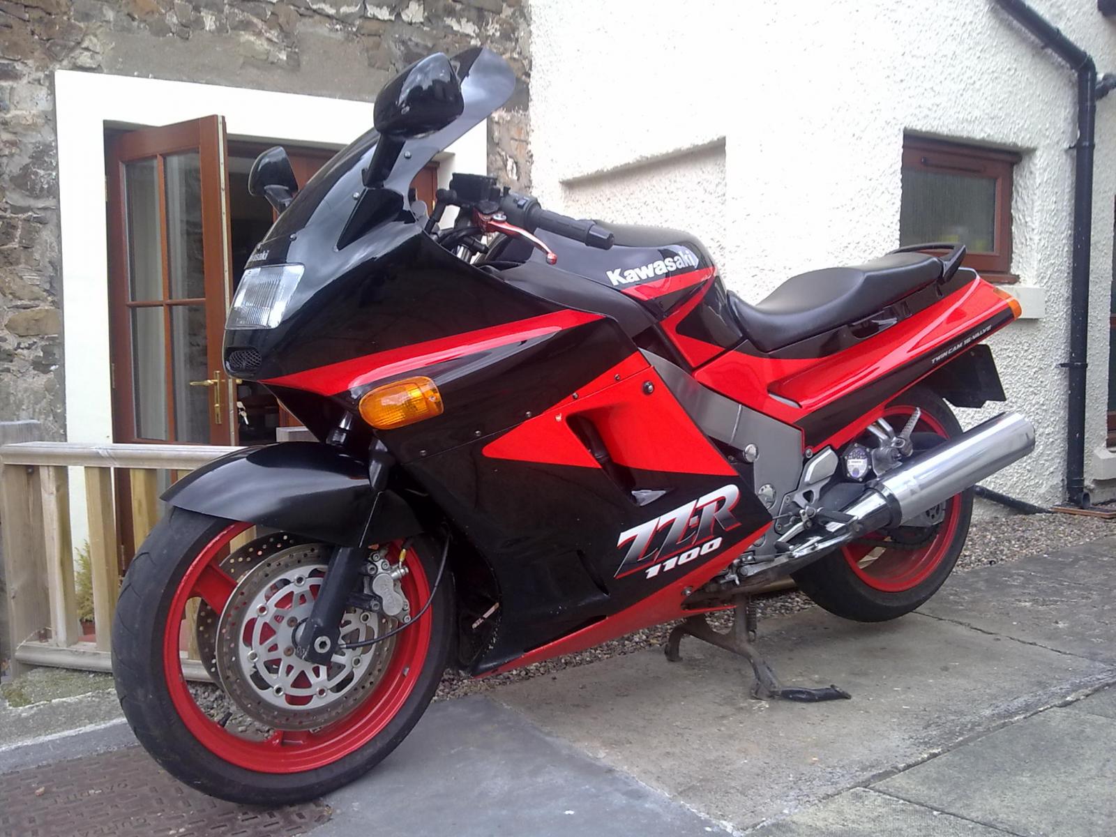

My zzr1100 had a terrible rattle at idle which turned out to be the nut holding the alternator sprocket working loose. Apparently TADTS but I know the chain tensioner is also TADS

Some better pictures:
It needs the rear brake overhauling and a braided line fitting (the fronts have already been done), and a matching tyre fitting to the front as the Bridgestone on the back is the better of the two.
