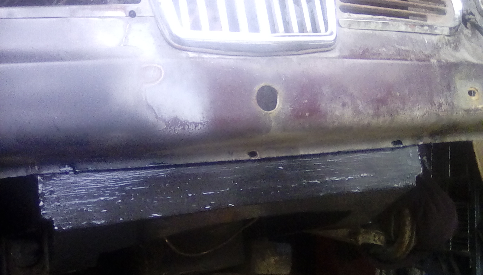

D Spares & Tyres Posted December 1, 2017 Author Posted December 1, 2017 And talking of fluorescent lights... I use a strip light as my worklamp. Its like daylight under the car with that under there! Turned it on today and it immediately stopped working. After some investigation it turned out to be wet inside, but not just wet. It was blue came slightly sticky. Turns out the radiator on the Wolseley has a slight leak and has been slowly dripping inside the light unit and burned a diode out by the look of itSods law.Ah well, I sorted another light out and got to work. Years of having a leaky windscreen had rotted out not only the floorpan but also the dashboardAt least it gave me access to this bit of rotNot the prettiest repair but it will be out of sightSo that's the passenger compartment of the car now finished and weather proofed. The only job left to do in there is to chop a section out of the top of the chassis rail to access the captive bolts on the drivers side of the gearbox crossmember. They unbolted fine but started spinning when it was time to put the crossmember back. Angrydicky, danthecapriman, Squire_Dawson and 9 others 12

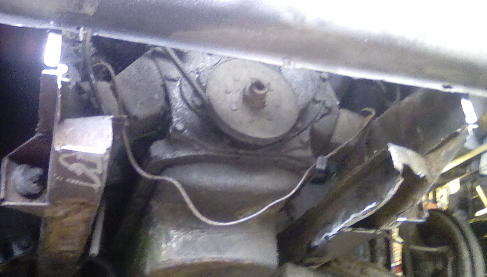

D Spares & Tyres Posted December 1, 2017 Author Posted December 1, 2017 I moved on to the front of the main chassis rail. It looked solid enough and even with a good poking with a screwdriver I only made a couple of small holes.So I attacked the first hole with a wire brush on the grinder and it got bigger so cut it out furtherBut what to do about the rest? It is solid and would pass a test but it looks a mess. Patches on patches and some of it is quite thin. Not sure if that is due to rust or if they just used thin gauge steel but think i will cut it all out and start again.I want to fill it with wax after welding so may as well do a proper job rather that catch all the wax on fire in a couple of years when it would need welding again!Made a plate to fit what I had cut out so far. Overkill?That's today's work done, might do some more tomorrow,I'm actually enjoying this a little bit Here is what it looks like underneath... mercrocker, Coprolalia, Dick Cheeseburger and 7 others 10

D Spares & Tyres Posted December 6, 2017 Author Posted December 6, 2017 Bit more progress today The front crossmember was rather ripeSo I removed itAnd made a new oneThere was a patch on the drivers side chassis leg that somebody had put there years ago. Just clean up their pigeon shit welds then clean with wire wheel on the grinder, then paint. Front end will then be done.More holes... Oh well, I'll cut that off tomorrow and make a better one.. theshadow, Angrydicky, danthecapriman and 9 others 12

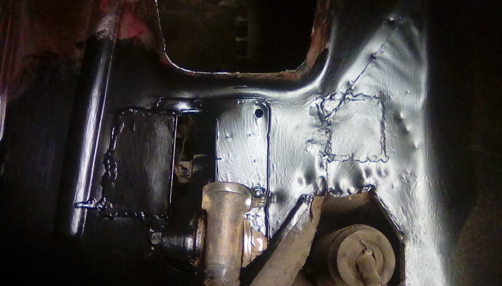

D Spares & Tyres Posted December 7, 2017 Author Posted December 7, 2017 What's happened here then?Something has happened to the suspension. It has damaged the car here. Someone has 'fixed' it though...This thing has been welded on. There has been one added on the other side too. Some kind of bumpstop??? theshadow and johngarty 2
Asimo Posted December 7, 2017 Posted December 7, 2017 Looks like a bodged on upper mount for a telescopic damper. Or if you mean the damage at the front of the slot by the upper suspension link maybe the lever arm damper came adrift. The four mounting bolts do come loose sometimes and / or break. D Spares & Tyres 1
cros Posted December 7, 2017 Posted December 7, 2017 I had one of these until recently. It became quite wayward and the reason was the radius rod had rotted through inside the rubber bush where it joins the chassis. Not spottable by the mot man, but could be nasty. The gear lever was weirdly short and the boot lid very heavy, mine had the early exposed hinges. I liked it. D Spares & Tyres 1
Asimo Posted December 7, 2017 Posted December 7, 2017 There should be a rubber bumpstop that acts on the top of the upper trunion - it seems to be missing.This pic. is a Minor, but everything in the front suspension is the same as I remember. D Spares & Tyres 1
D Spares & Tyres Posted December 8, 2017 Author Posted December 8, 2017 Yes I know about the bumpstops, the mounting on the other side was rotten but I remade it. This side is saveable I think. I don't have the rubbers though. I'm guessing that in normal usage I won't need them?? I'll chop off the extra shock mounts then I know nothing of trunnions but I assume I put oil in the nipples, not grease?

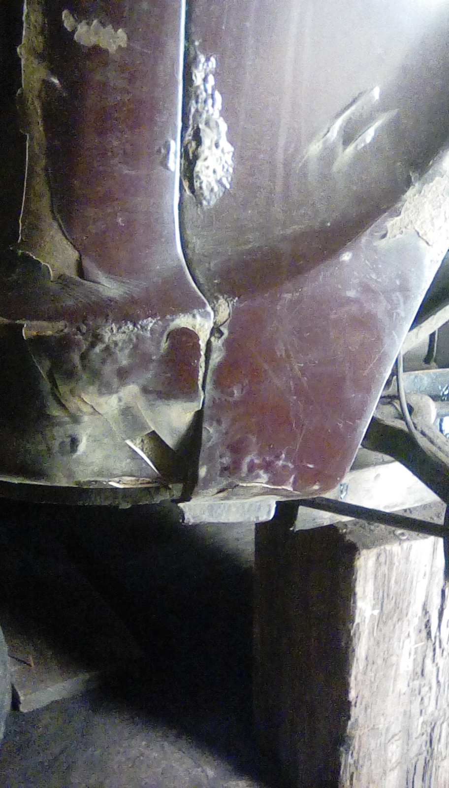

D Spares & Tyres Posted December 14, 2017 Author Posted December 14, 2017 Done a little bit more on the Holeseley. Chopped the extra shock mount off and surprise, surprise I found a hole behind it. Tidied up the damaged area from a previous suspension collapse!Bump stop mount and inner wing turned out to be crispier than I thought too so I chopped it outAll my illusions about being able to sort this side of the car out without removing the wing are rapidly being eroded... The wing is a mess anyway so I was only kidding myself! Ah well more welding. Not much else I can do on it in this cold anyway RayMK, puddlethumper, Sigmund Fraud and 10 others 13
