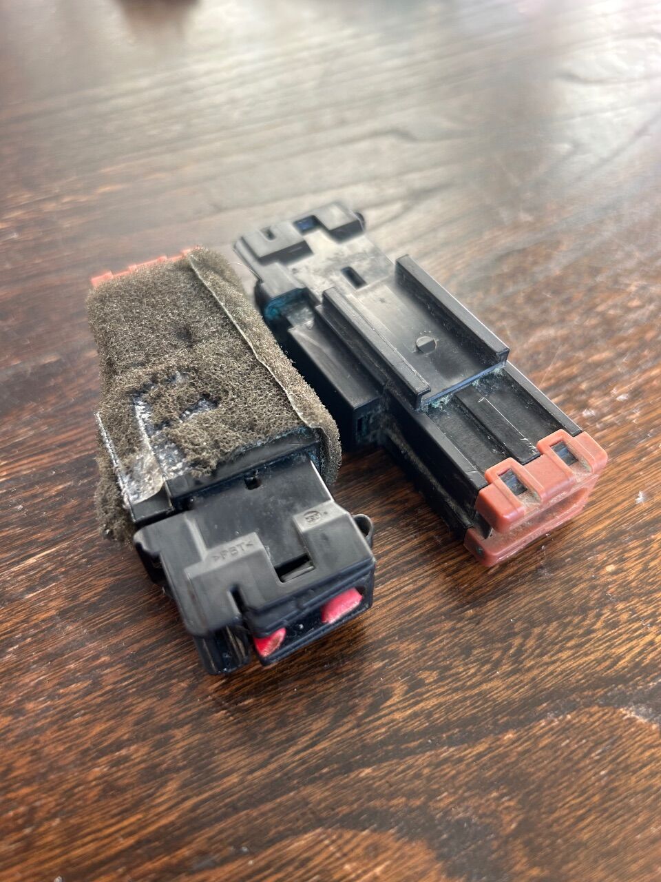

Aftermarket immobiliser…
Joy.
Immobiliser shouldn't cause a drain per se, but if there's a backup battery over 8 years old in the module...
Interior light is my bet. Also the door lock modules if they are not fully disengaging, but the interior light is prone to capacitor leakage and PCB damage as a result 😕

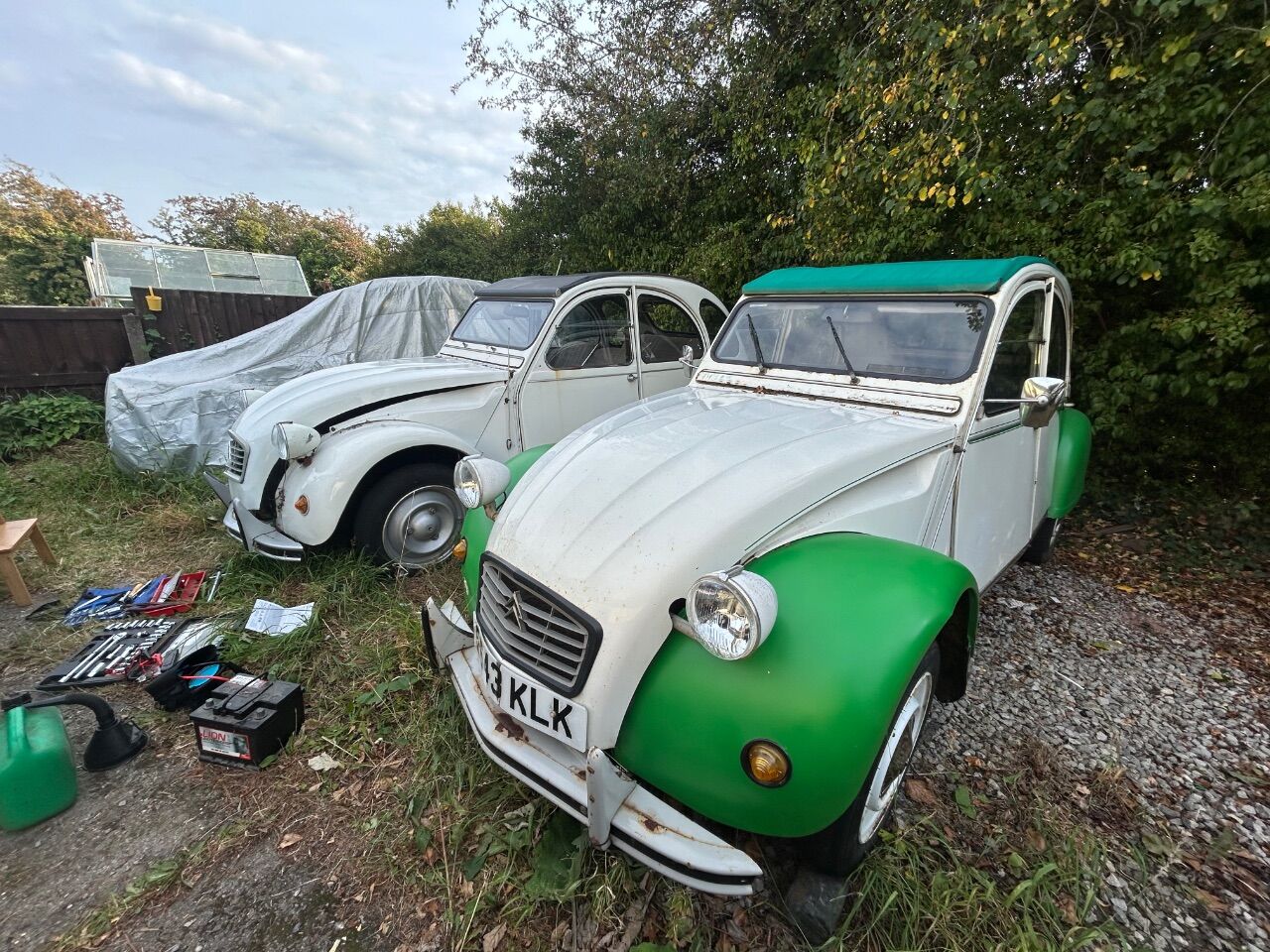

First up was the Yellow one. It hasn’t run properly since it threw its spark plug on the way home from the AS meet at the Truckers rest. Having done helicoil, inserts and failed to get any of them to stay in the engine more than 10 minutes before being unceremoniously ejected. Fast forward to the Volvo MoT where my tester (a very experienced mechanic) suggested that as the head was likely junk anyway putting some heat resistant loctite on the helicoil would be a last resort that might just work. IMG_0626.jpeg.93f50e4f5a96e4697c88873421e1d5e4.jpegLong story short, it didn’t. The Helicoil came out after about ten minutes running on the drive despite having been rock solid when it went in and having had plenty of time to cure. So with all easy solutions exhausted we’re either looking at a new head on that side or possibly a replacement engine.
Talking of which…

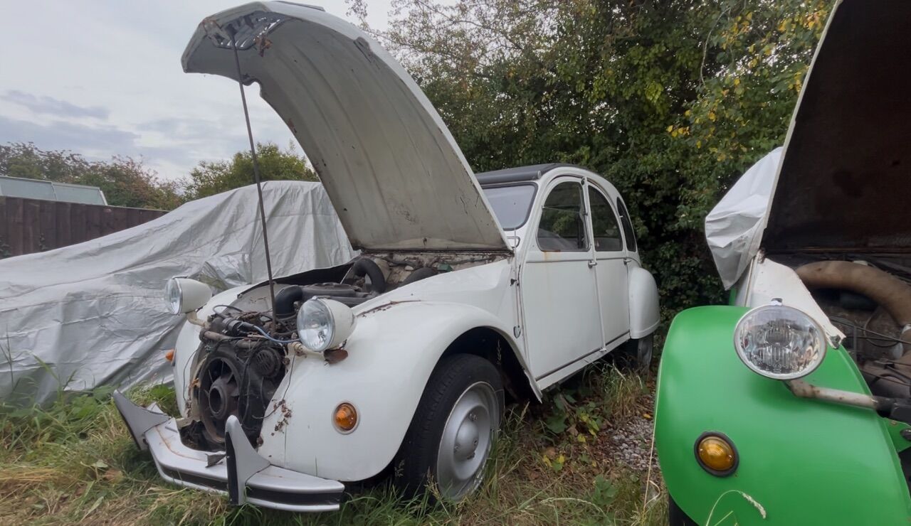

One of the two projects I picked up almost two years ago (where the fuck has that time gone?!?) has a complete and free turning engine, but so far I’ve failed to get it running. It was last on the road in 2008, and I believe it’s been laid up since then undergoing some welding work until the owner passed away and it just sat.
I’ve changed the leads and plugs and coil to no avail, so today I changed the condenser and points. Fan came off relatively easily, and the change was straightforward. I’ve not actually done the points on a 2CV before as my main one has electronic ignition.
Fuel into the carb and no dice, persistence maybe? And we get a cough and a splutter. Then eventually it runs… well… sort of. Spluttering on one cylinder.
It was at this point I realised I had only put one spark plug in…. Doh!
The next lot of fuel in and we have running! And not only running, but very smooth and nice running! It’s not run in many many years so this was really exciting. It’s had an aftermarket electric fuel pump fitted, so I want to check the lines before putting fuel into the tank.

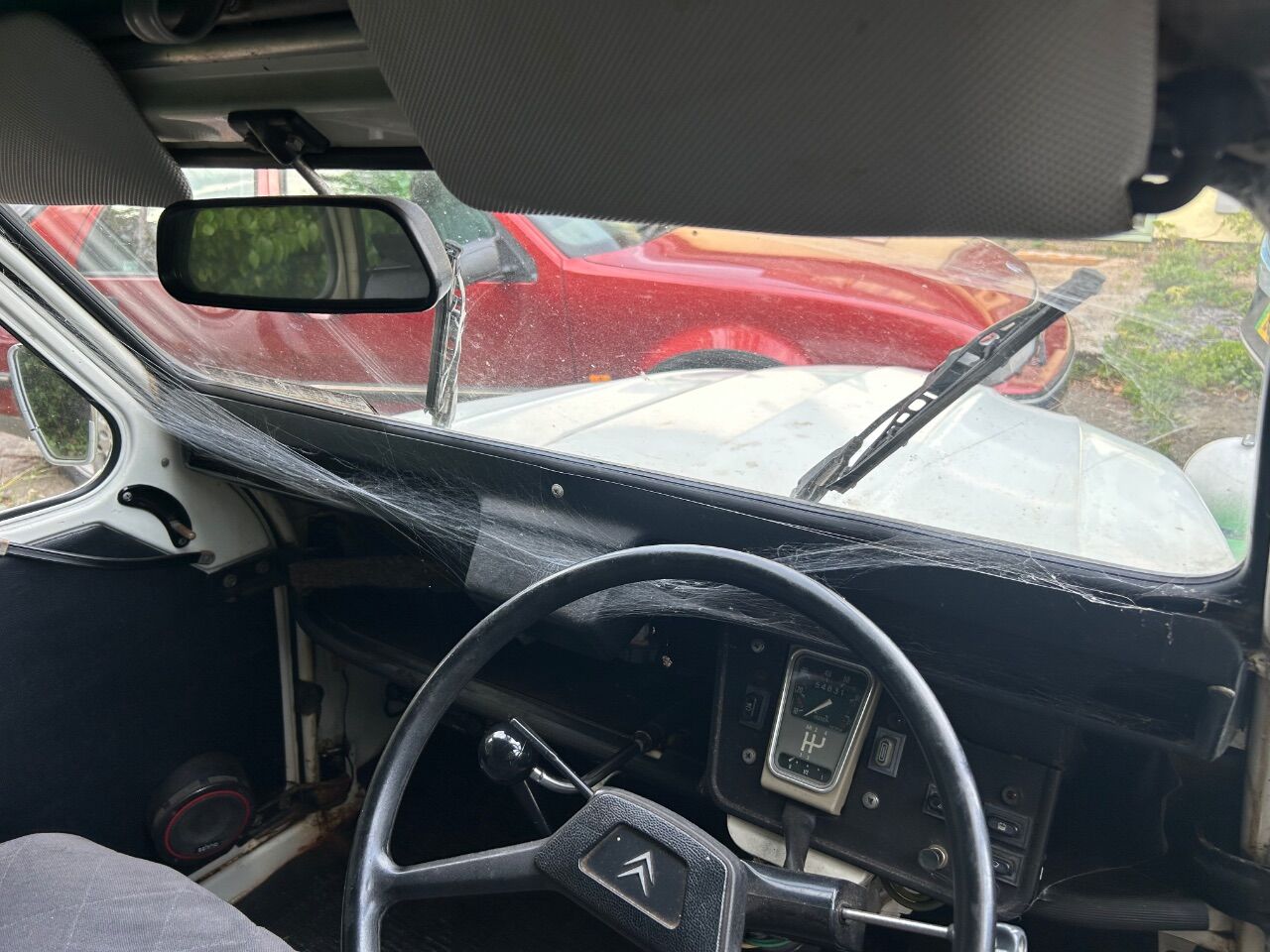

Started the green one too. It’s not been run for a while, but the children interrupted any attempts to dig into the brake maladies which are preventing it from being on the road.
Cobwebs galore!

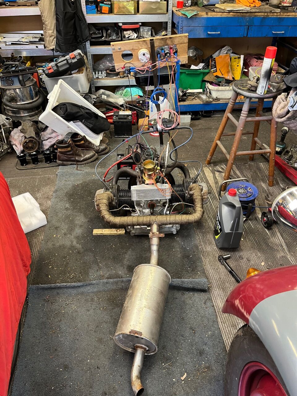

In other exciting news… the new engine for my 2CV has been built! Just need to go collect it, pay for it… oh and then fit it… and re-jet the carb…
That exhaust is... interesting... 😳🤔
