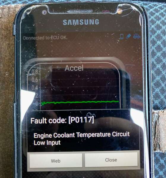

Okay, engine management light first.
I've just got so used to its cheery presence on the dash now; it's like a friend to me.
In with the £9.99 Chinesium dongle, then...
And on with the ancient Samsung J3 Android phone, which I only keep because it seems newer versions of android won't work with the Torque app.
Yup, still the same bastarding fault.
Like it's going to have fixed itself.
My hot take is that a wire's broken somewhere; call me lazy, but it just hasn't been a major priority.
'CLOSE' and 'CLEAR ALL FAULT CODES'.
Boof.
FIXT.
Hopefully it'll stay off til tomorrow, but I'll keep the dongle in the car just in case...

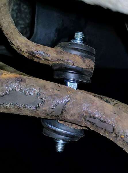

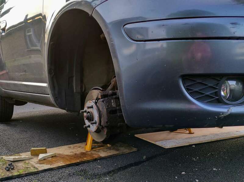

Okay then - the BAD NOISES.
A cursory pop of the bonnet and jiggle of the suspension produced no noises, with shocks apparently boinging okay.
Top mounts seemed tight, and a quick shufty around the arches indicated springs were intact and where they ought to be.

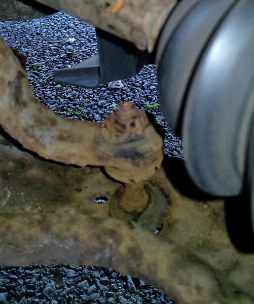

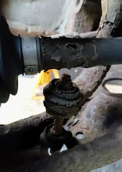

But then looking more closely around the control arm on the driver's side...
Mmm.
NOPE.
I've a very funny feeling there used to be a rubber cup on that drop link.
And, curiously, there isn't now. 🧐
Right. Well.
The other side's also pretty rough looking.

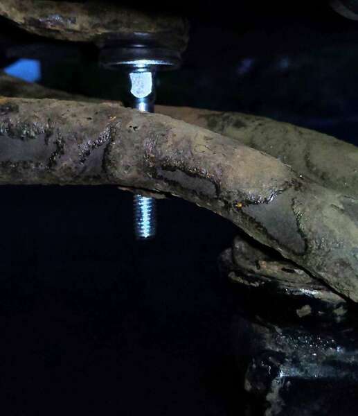

Alright, well they LOOK like teeny-tiny Yaris droplinks alright...
And, quite importantly, they don't look like someone else's old drop links stuffed back into the box and reshelved as a return.
I guess we'll find out shortly, hey?
I replaced these on a Yaris like this earlier this summer. And it wasn't a bad job, but it required an angle grinder and it's a good idea to take a picture of them or have one to look at before they are cut into pieces so you know where all the parts on the new ones go. And you probably know this, but jacking up both sides when doing these is a good idea, I did so.
Thanks for the kind words!
Yes, after my last experience of droplinks on the Subaru, the angle grinder will be going in first!
There's no point even trying to argue with old rusted bolts.

Finally I dragged everything together, and hoicked the car up in the air so I could get the wheels off...
Naturally, at this point of the operation a blood sacrifice was demanded, and received.
Nipping your thumb while telescoping up the extendable wheelnut wrench - not recommended.
I know it's crusty under here. I know.
Many years of hard use, followed by several years of comparatively little use, have not been kind to this little car.

One thing's for sure though - we've certainly got our money's worth from the original drop links. These are the factory fitted items.
The lower fastening has literally worn away to nothing, and isn't connected to the control arm at all.
One point which came to my attention was that raising the car enough to remove the wheels also moved the driveshaft much closer to the droplinks.
Hmm. This was annoying, as Lidl's finest angle grinder isn't all that manoeuvrable under the wheel arch.
Obviously, cutting into the anti roll bar or slicing through the CV gaiter with the grinding disc was something I wanted to avoid at all costs.
But, despite me being generally shit-scared of power tools, and none too appreciative of getting the odd earful of sparks, I managed to get the sorry remains of the top nut evaporated without too much effort or swearing.
And a little bit of gentle persuasion with a bar later...
Oh! It's out!
Bloody Nora.
Yup, I reckon that's done its duty.
Stand down, soldier.
A little bit of trial and error was required to get the right bits of the new drop link in the correct places:
Taking a reference pic of the old unit only helps so much, whenever half of it's completely worn away.
At this point, the Haynes Book Of Lies unexpectedly rode to the rescue with an exploded diagram of the front suspension set-up.
It was incredibly small and hard to read, but I kinda got the gist.
Probably.
Hopefully.
Yes, those little dots marked 6, 7 and 8 - that are literally smaller than the head of a pin - are the one True and Faithful way to reassemble Yaris droplinks. So sayeth the Word of our Lord John Haynes (O.B.E.) in the Book of Suspension and Steering, Chapter 5, Verse 7.
Amen.
Once I was fairly sure I had things the right way round, I also found it necessary to put the jack under the wheel hub and raise it up a little, reducing the gap between the ARB and lower arm so that enough of the thread protruded downwards to allow the metal cups, rubber bushes and the locknut to actually fit together.
It took a fair bit of poking, hauling and adjusting to try to get everything lined up more or less straight on the main shaft of the link...
And I'm not sure if it'll need adjusting again when the wheels are refitted and it's back on the ground again, to avoid any misalignment or asymmetric loading which might tear the rubber bits apart in short order.
Maybe.
The HBoL also tells me that the locknuts on these links should be torqued to a fairly low 13 Nm - but the trouble is, the handle on my torque wrench is so long that I can't get it to fit under the wheelarch.
(Obvious innuendos only, please.)
So I just tightened them up with a 13mm ratchet spanner, and stopped once I started to feel some resistance.
So! One droplink fitted... it was getting pretty dark by this stage, and the infrequent bouts of drizzle weren't really helping matters much. Not only was my mauled thumb throbbing, but my arse was wet from the dampness of the driveway.
Since this driver's side droplink was the critical component requiring urgent replacement, I took an executive decision to pack up for the night and come back to replace the other, slightly less critical side tomorrow morning.
The hope is that now I've a better idea of what needs doing to get the link to slot into place, it shouldn't take me all that long.
That's the theory, anyway.
