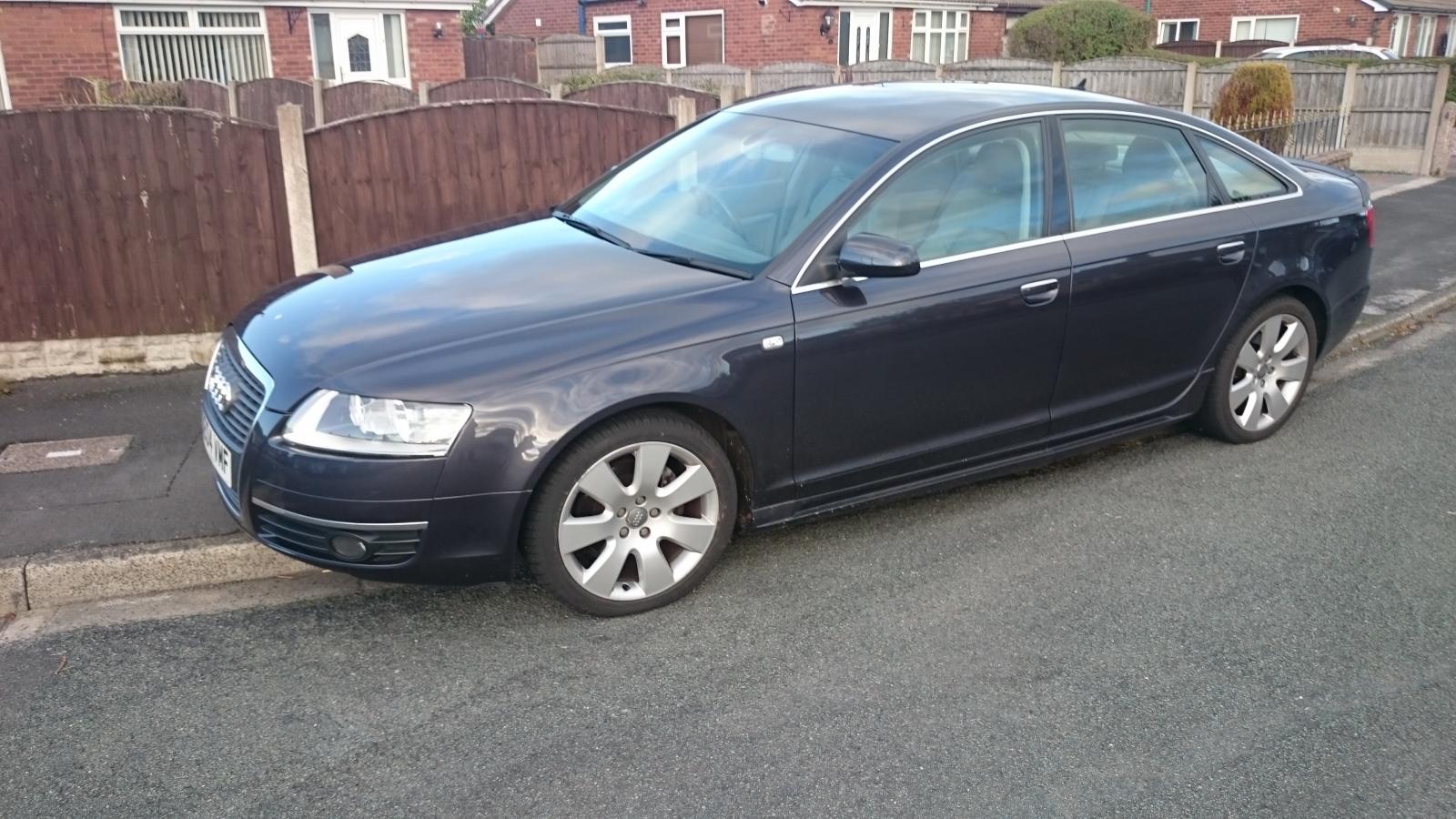

Bren Posted November 5, 2017 Author Posted November 5, 2017 I had to have a proper scan on my S3 when all the warning lights came on, and abs stopped working.... turned out to be a longitudinal yaw sensor behind the dash. There's a lateral one too...All bollocks - it's a car - not a eurofighter. Why do I need to know about yaw when I am on the A55? Audi get your act together. As for the car - its a 2004 A6 C6 2.4 SE. It is slightly povo spec - six manual gears, no sat nav, no sunroof. However it has nice leather and is oyster grey in colour - it has a purple flip in the sunlight. Genuine 57k with lots of history. It is a nice smooth drive but could do with another 50 hp as 174 bhp in a car like this is very modest. Faker and rantingYoof 2

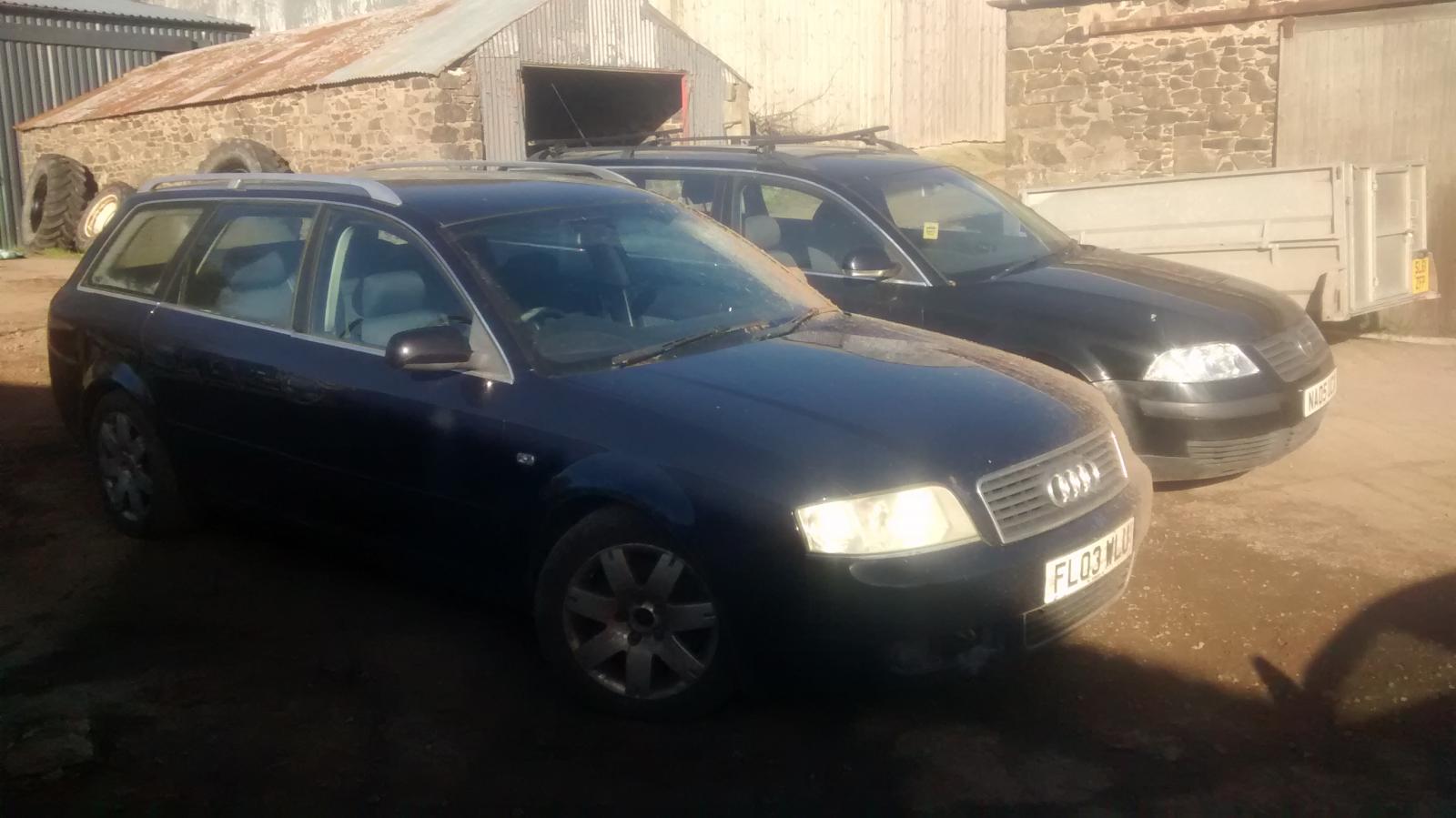

garbaldy Posted November 9, 2017 Posted November 9, 2017 I have this old scrapper which you can have whole or parts off if any good,
