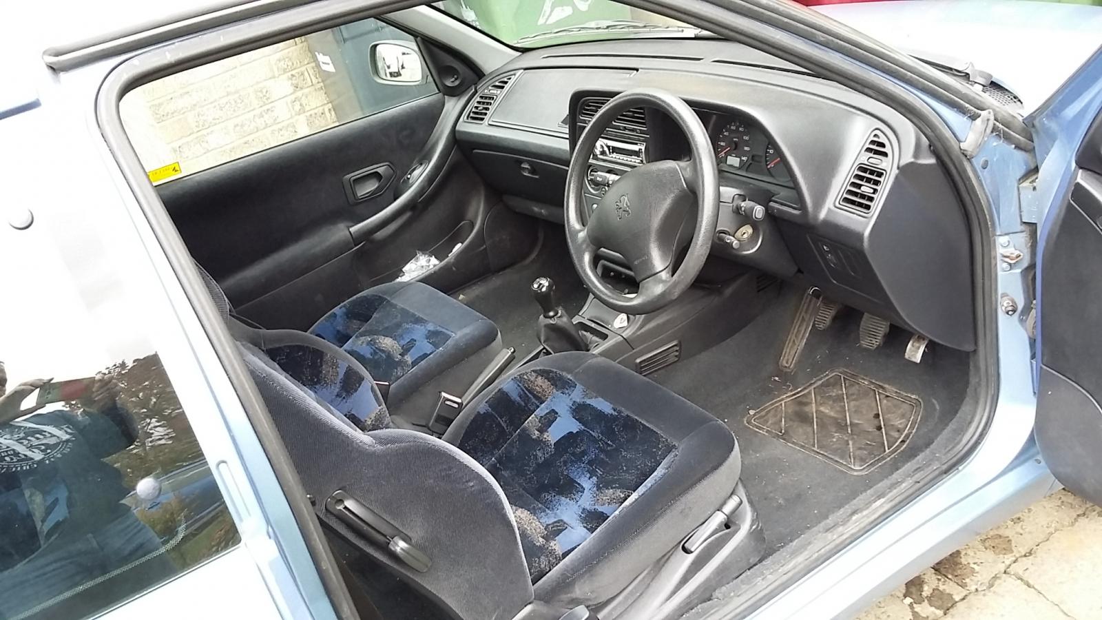

sporty-shite Posted November 18, 2017 Author Posted November 18, 2017 Some pics....... Sudsprint, DeeJay, Junkman and 1 other 4
sierraman Posted November 18, 2017 Posted November 18, 2017 Looks tidy that. A bit of spannering over a weekend or two and you’ve got a decent car there.
sporty-shite Posted November 18, 2017 Author Posted November 18, 2017 Humm... Bosch?Unfortunately not.
D Spares & Tyres Posted November 18, 2017 Posted November 18, 2017 Never mind the engine, good 3 door 306s are getting hard to come by. Shame to scrap that, if I were closer and / or still in hoarding mode I would have that.
SRi05 Posted November 19, 2017 Posted November 19, 2017 Those 306's have aged really well, a nice looking car still Lankytim 1
