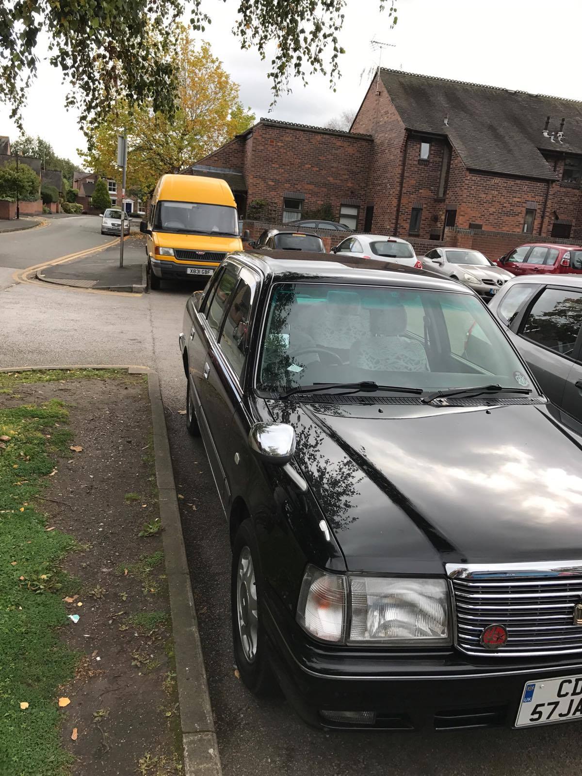

Spotted on the car park outside the pub I live in. Wtf?
The interior doilies?

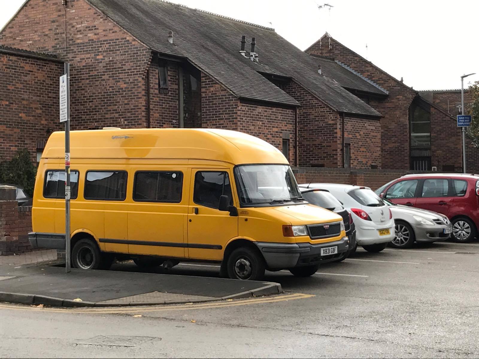

The ldv behind made my morning.

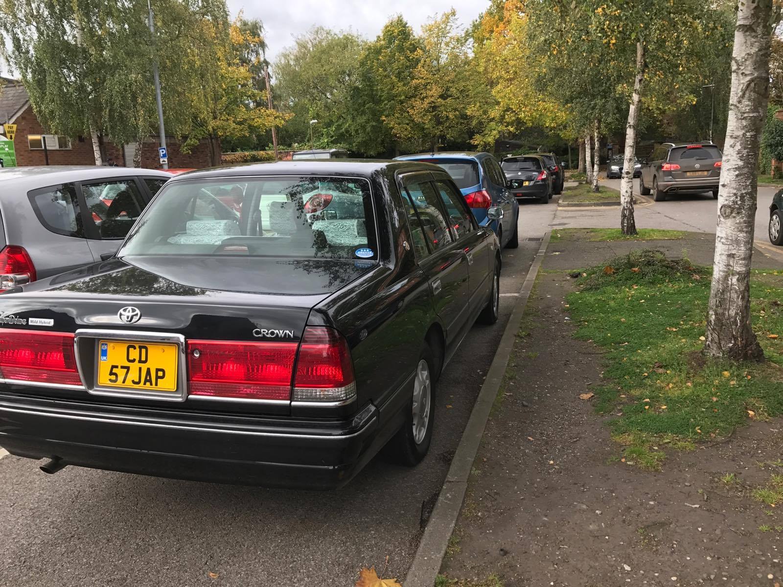

It actually says mild hybrid on the back, any shiters know what a mild hybrid is.

"Mild Hybrid" is Toyotaspeak for a rather half baked arrangement that only really makes sense for Taxis in hot cities, like Japan and Hong Kong where you see these Crowns in their thousands as they are the default choice for Taxi.
How it works is: there is an generator/motor built into the crankshaft pulley and connected to the crankshaft by a clutch like an AC compressor clutch.
When the vehicle is decelerating, extra braking effect comes from this generator charging a battery.
When the vehicle is stopped, the engine stops, the clutch on the front of the crank disengages and the motor/generator runs as a motor powering the A/C compressor, keeping the Taxi cool with no fuel used / pong emitted.
When the lights go green, the clutch closes, the motor/generator spins the engine to start and gives extra whoosh from the battery to reduce fuel used during acceleration up to the next stop light.

So it's rather like the next generation DAF hybrid, all belt drive and such.
The doilies just mean it was a taxi like is said above. They automatic opening back doors as well.

I don't think it is a diplomatic plate as they usually have a xxx D xxx format. Also presumably DVLA would not be so undiplomatic (sorry) as to give the Japanese embassy a 'Jap' plate.
These used to be the common taxi in singers with an excellent lever system for the driver to shut the near side door. Now being superseded by dull Hyundais.
