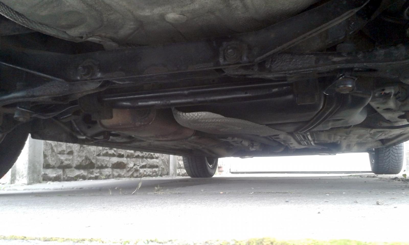

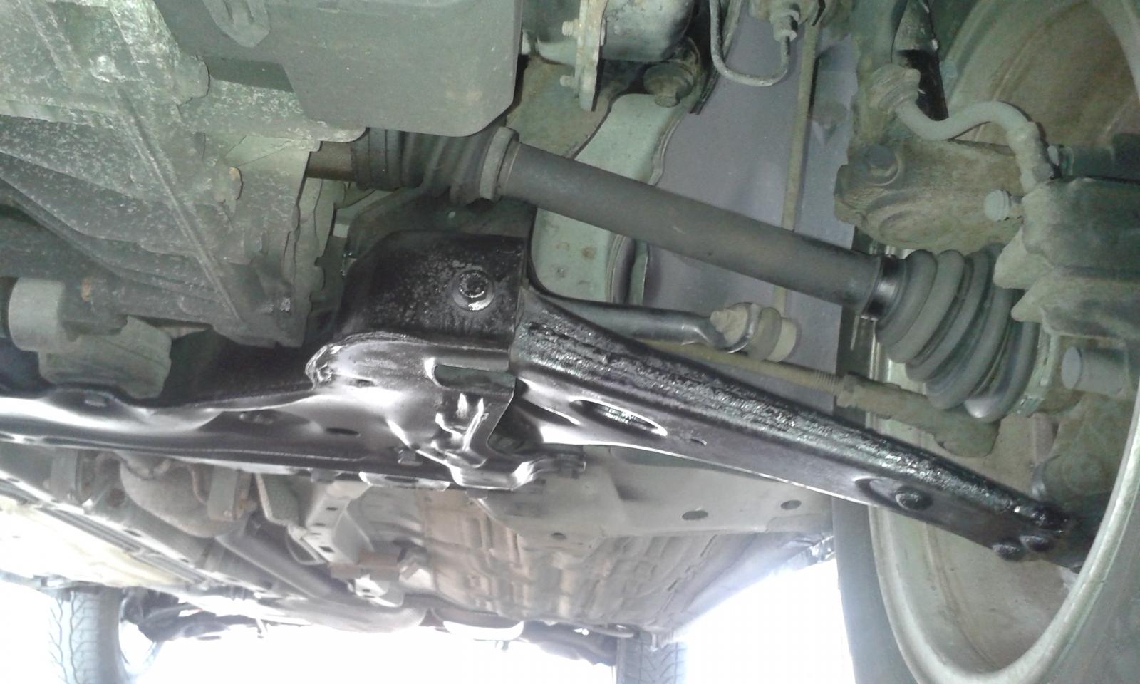

having just bought a 14 year old ford focus that had a underside in quite good nick , I decided to just repaint any tired subframe paint with poundshops best spray gloss ,  some of that brush on waxoil stuff to more worn areas , and oil spray into any box sections , I was working on the premise if it had lasted 14 years already with minimal input  , it was going to last a bit longer with some TLC ,
whenever I jack the thing up , I have a cleaning rag and a can of oil and paint spray to hand ,
hah thought i recognised that car , was doing just that on ours yesterday but with a pot of grease , take a look at the inner sills where the suspension bolts on , they can get frilly there too
those bits are fine , just got to finish off the polishing during the next break !!!!
funny how the back metal work suffers the most !
yeah another £1 worth of paint when they made those subframes would have kept them tidy , expect they had the lightest misting of black when new

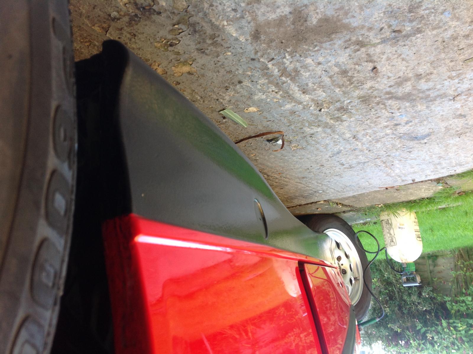

Just finished the Morris today - last job was coating each inner wheel arch and inner face of the wings with Dynax UB.   One can per side.   Just the van to do now and the Cowley when it comes back from the welders.   I don't do this thorough a job every year but I do go over everything again each September/October with the UB spray.
You would think the bastard wouldn't rust but it still does!
Inner surface condensation is the killer and you can only slow it down but even that's worth the effort.
