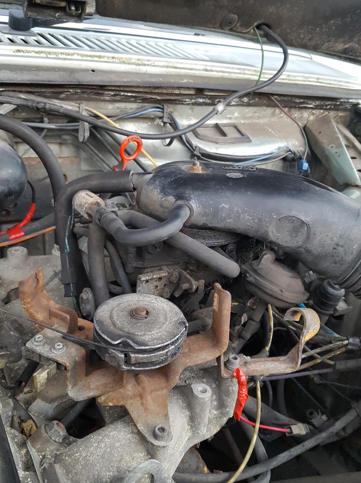

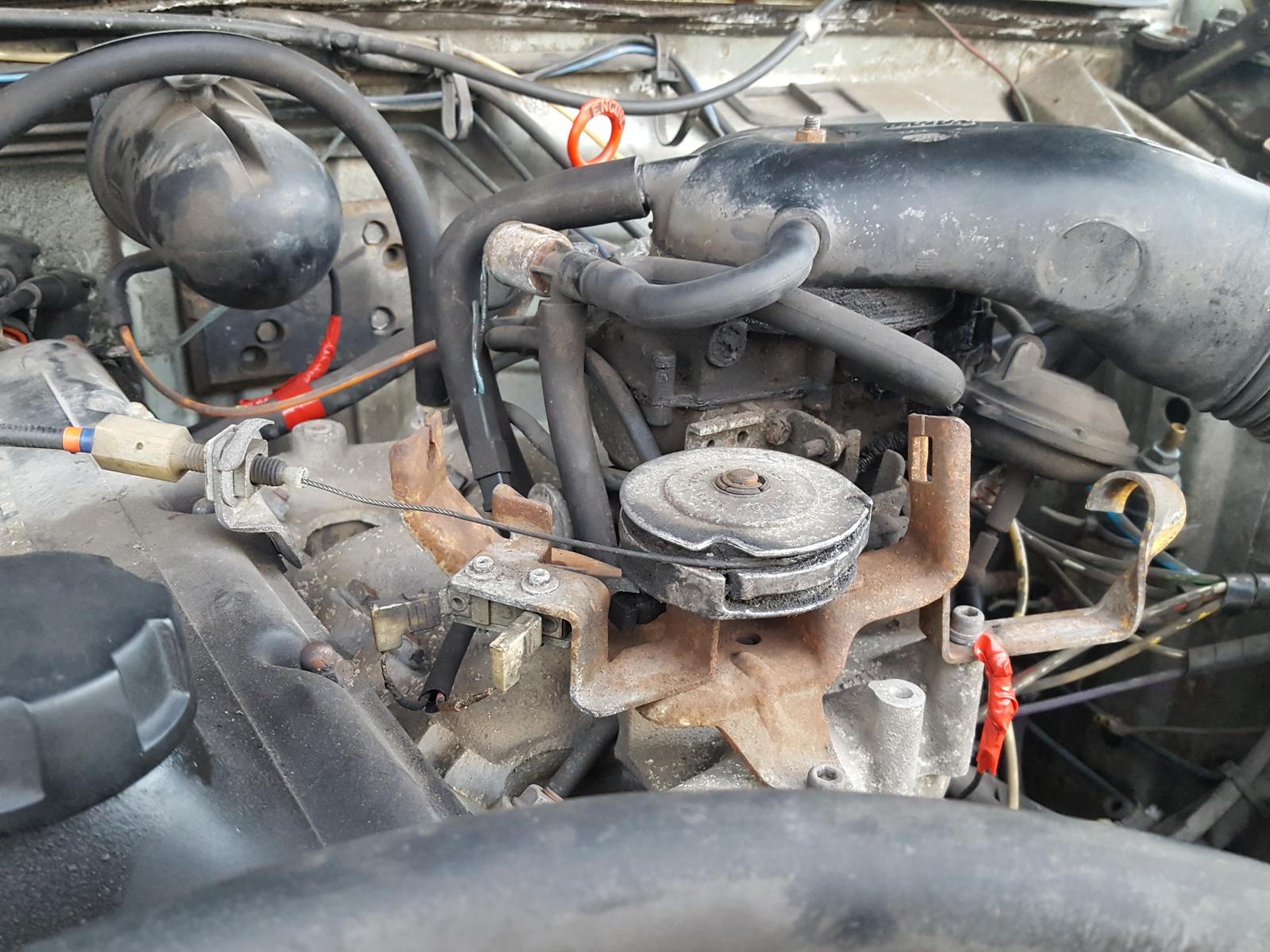

PS: Photos - I cant see a flame trap etc? Anyone else see it in photos?
Ta
looks like its been re-plumbed to me !!

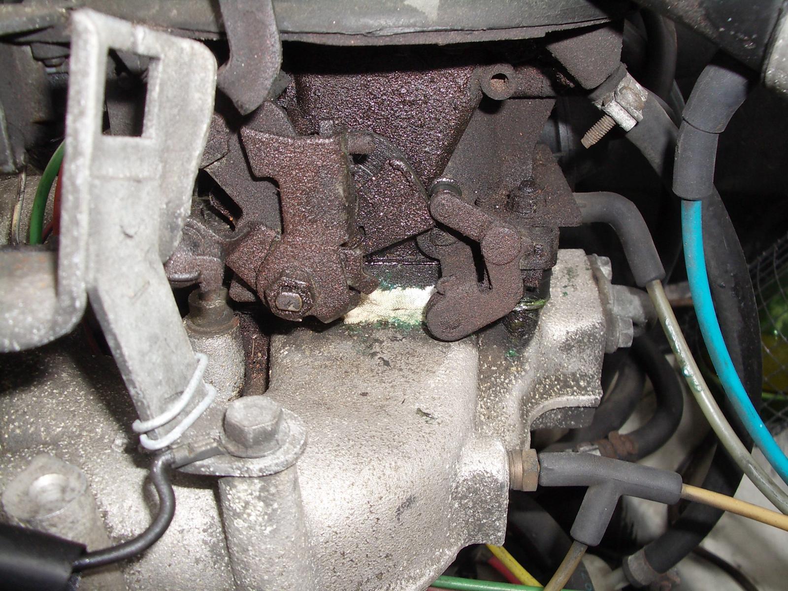

and a photo of a leaking carb gasket fix
I may have a leaking carb gasket everything does look a bit black and full of gunk in that area. Is that gasket between the top where the air box sits on and the carb itself?
there are 2 gaskets , one either side of the black heat insulator .....
its not the flattest thing and may need a bit of sorting out

It looks to me like your flame trap has been removed by someone and in its place is a length of rubber hose. You can get a kit with the required pieces in off eBay.
I'll add pics later! Havent got any yet! Debating whether to put the Volvo Trims on? I quite like the Steelies without the trims lol. Looks badass lol.
It does looks as though someone has re-plumbed it. Will I need to make changes? if it aint there it can't clog up?

It shouldn't cause any real problems without the flame trap but you might find you get a bit of oily grunge getting past back into the intake. The flame trap does prevent the majority of the sludge and crap getting through, hence why they block.
