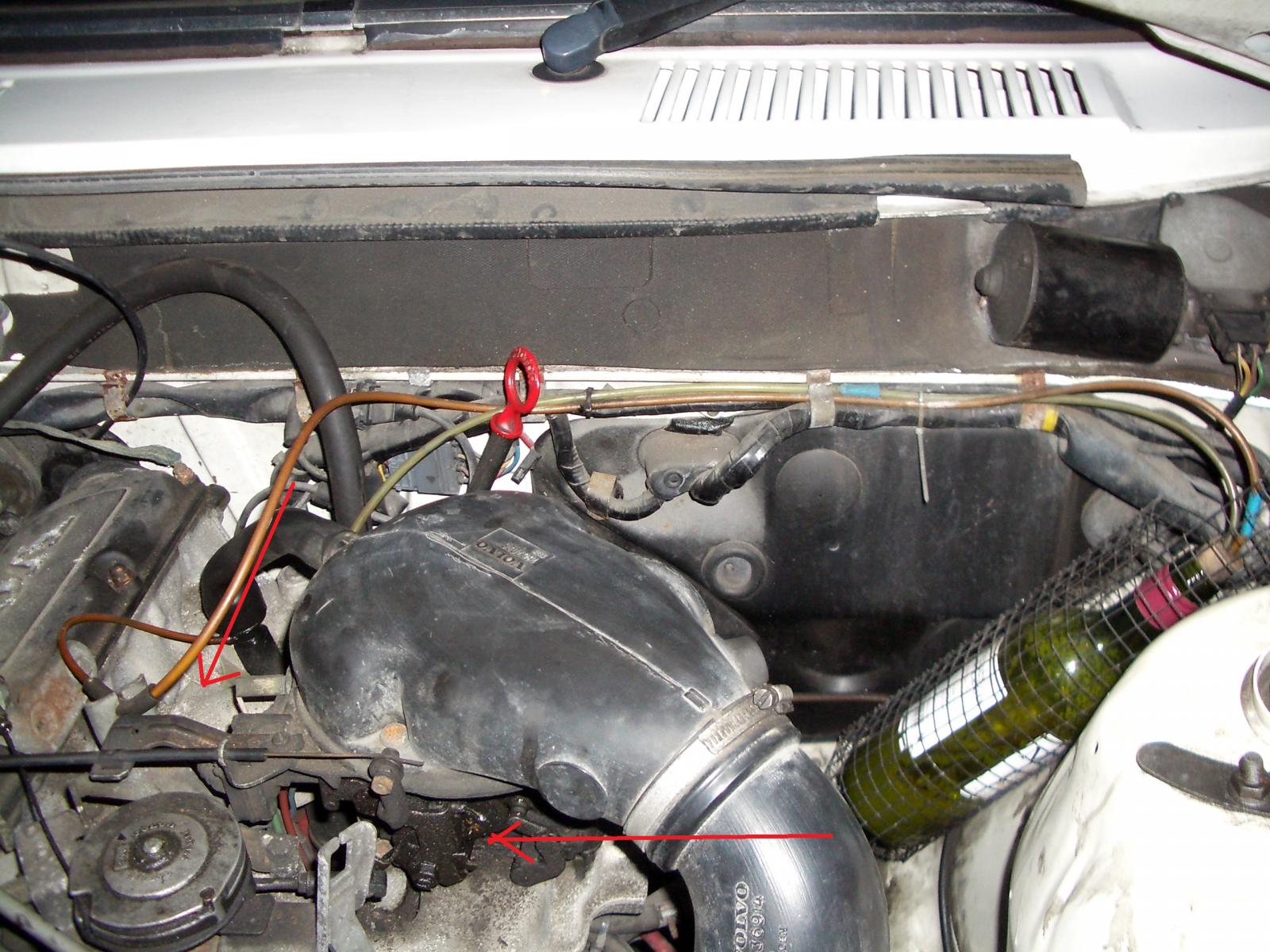

I have heard this but have failed to locate the flame trap! Can you show me where it would be? Mines auto choke!

As for flame trap.. where would I find it?
flame trap marked in yellow
Thanks. Armed with all of this info will hopefully solve the problem. MOT next week so WILL do this after that.
Flame trap location varies from car to car depending on engine/induction type but the actual flame trap itself is often a black plastic 'cup' with a press on top cover with small rubber hoses going into it. Inside it's got a circular filter element.

Thanks brilliant info! What I'll do is check it out tonight when I'm home and if needs be if I cant find it I'll take some pics!
