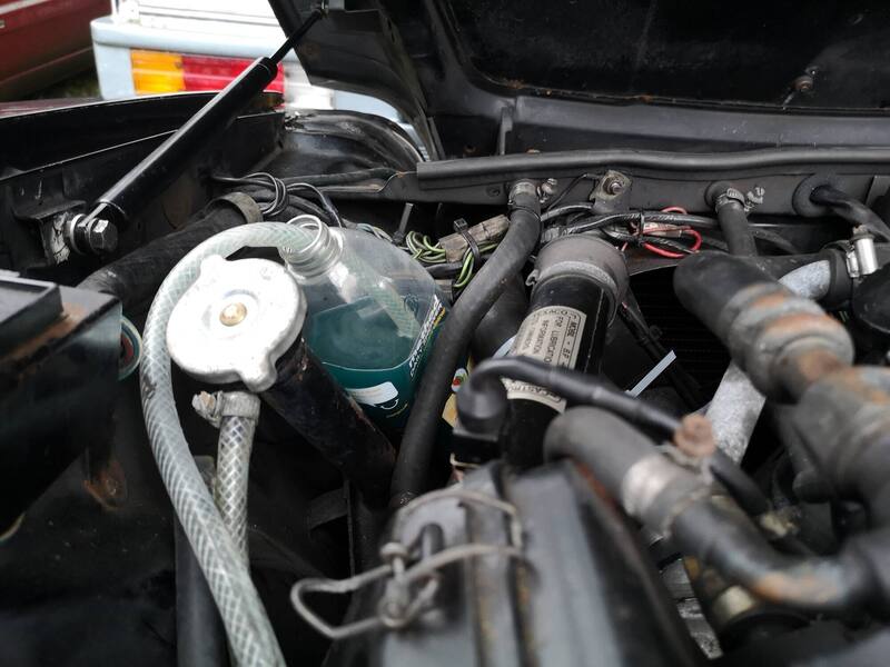

Had a look at the temporary expansion bottle today after a decent run.  About 3/4 full (and I put a bit of coolant in the bottom of it to help prevent air being drawn in as things cool anyway), so doesn't look like I need to worry about it overflowing.
The hoses also feel firm but not absolutely rock solid like they were, so it looks like the pressure is being managed correctly now.  If the weather permits I'll try to get the inner wing metalwork off and strip out the proper expansion tank and its pipework to be cleaned at the weekend.
As fixing the reversing lights was deceptively easy, I'm sure this will be an utter pig of a job to make up for it...

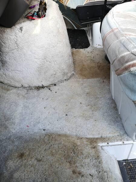

Got the main carpets out today for a proper clean.
The thing about mid brown carpets is that they can be filthy without it being obvious.  The water which came off the driver's one was utterly disgusting for about five minutes.  The rest weren't too bad aside from the substantial amount of milkshake to be removed from both of the passenger side ones.

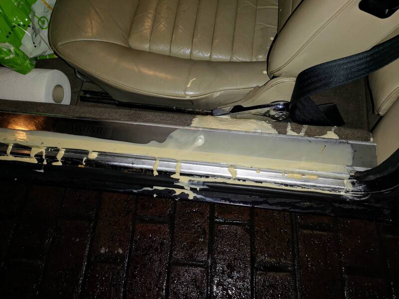

Sadly the carpets on the actual sills appear to be glued in place... firmly.  Think this may be the point I finally get a wet and dry vacuum cleaner so I can deep clean those in place.  Really could do with one for the van anyway and a basic one up to being used a few times a year isn't expensive.
Still need to do something about the one sill (it's been sponged clean as far as I can manage so far) but the rest of the carpets were finally dry today and are now back in.

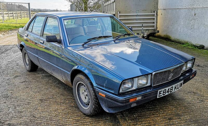

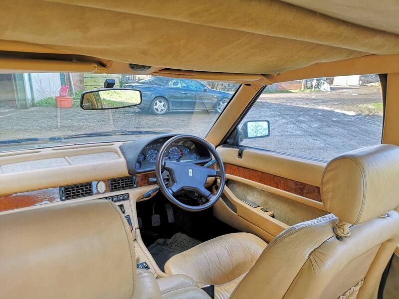

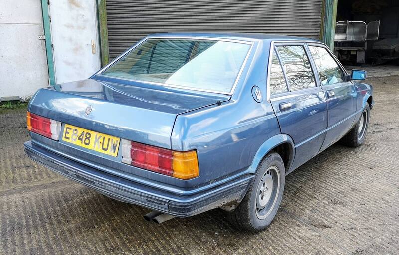

Well today I got to have a shot of something just a little bit special.

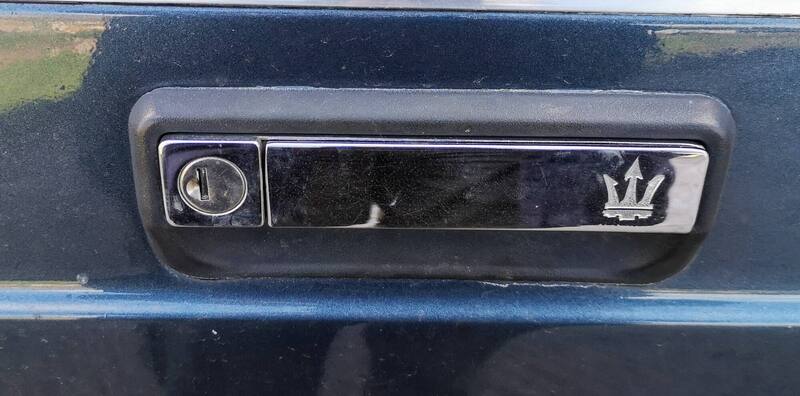

I love how while it is so pure Italian luxury sports car inside that the outside is so understated...
Though the little details like the door handles are nice and do bely how special it really is.  As does the noise she makes.
It's been a hell of a long time since I was last in a Biturbo...and I had forgotten how bloody gorgeous cars they are.  Very Italian in that feeling like a living, breathing being more than a machine and in the delightful blend of supremely classy and comically shonky.  The wing mirrors which immediately point skywards when you hit a bump and the comprehensive selection of warning lights provided...which are totally pointless in reality as they are entirely hidden by the steering wheel when you're driving.
One is very definitely back on my list...near the top in fact.  A few years ago I sort of glossed over high performance luxury cars, but as I'm getting older the "high velocity squidgy leather sofa" category is appealing more and more.

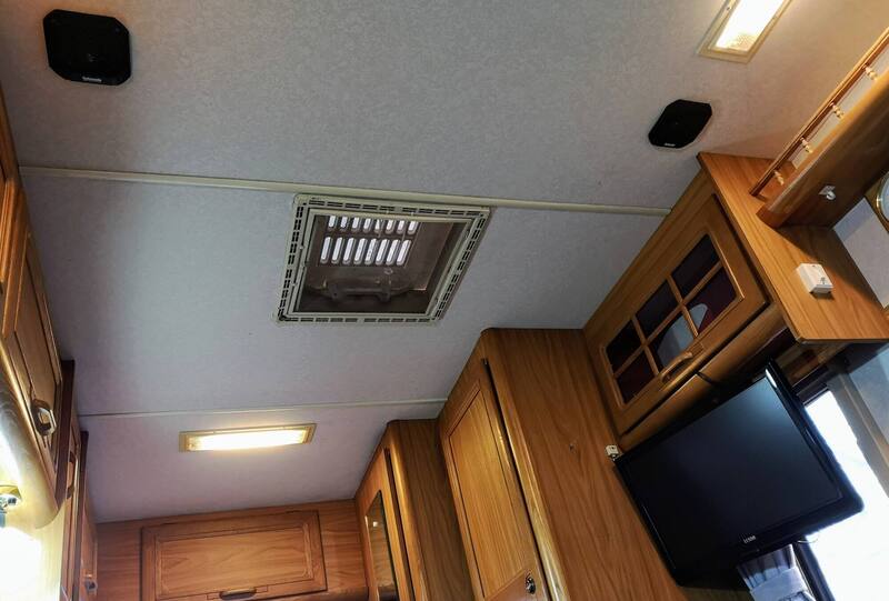

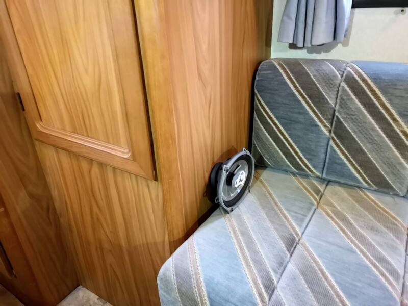

Something I've been scratching my head about a little in the van has been audio.  The speakers in the cab are just about passable now (not great, but the speaker enclosures are only 10cm so options are a bit limited), but the ones in the back are rubbish.
Again they're only 10cm drivers...but the issue here isn't the diameter it's the depth.  The roof panel is only about an inch and a bit behind there so any serious upgrade is likely to involve a bigger enclosure that will stand proud of the ceiling.
Had a bit of an epiphany this afternoon though and realised that there's absolutely nothing to say that the speakers need to stay in the ceiling.  There's plenty of other places they can go where depth isn't a problem.
Grabbed a 5x7" speaker I had laying around and went to have a look.
Nearside one can go here, helpfully it can actually hide below the floor in the wardrobe I believe.
Offside is a little more awkward, but here looks to be the best spot.
It backs onto the side of the oven, but the outer skin of it barely gets warm so I'm not too worried about that.  If depth is an issue there I can probably get away with using a little spacer without it being too obvious.
A 6x9" should work just as well as this in these locations and give us a bit more punch.
Have a plan to get things a bit beefier in the cab too.  What I reckon I'm going to try is getting a decent set of drivers installed down here forward facing behind the seats in the end of the lockers...
The important thing though is that I'd keep a pair of tweeters in the place of the current cab speakers to help keep a decent soundstage in the cab.  Bass is relatively non-directional, it's the treble you need to place carefully as that's what will give you the stereo separation.
It's either this or in the front of the box under the seats, but those boxes are full of battery and it involves cutting metalwork with I'd rather avoid.
I'll keep the original speakers in the back of the van, but what I'll do is hook those into the TV as they're absolutely perfectly serviceable for that sort of duty...just not providing music above an OM.601 with a straight through exhaust being worked hard!

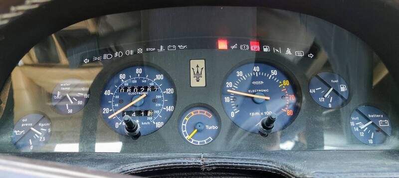

Pretty sure we've got a developing issue with either the alternator or the regulator on the Jag.  While the light goes out as normal when the engine starts, it doesn't seem to properly start charging until the engine is brought up to around 3000rpm and held there for a couple of seconds.  Then the system seems to wake up and start charging properly.  It will then stay there until the engine is next stopped.  Before that point the system voltage will hover around 13V - so it is still generating power, just at a reduced level.  Once the system "wakes up" it jumps up to a normal charging voltage.
Need to do some research on the likely cause and get the necessary things ordered in.  At least alternators don't look to be massively expensive if a new one is needed.  This one has been rebuilt - but that was back in 1998 so it's not really undue some attention.
Sounds like the Zener that controls the flipflop in the regulator is goosed. That or the diode set that picks up off the main rectifier.

I believe the alternator on this is an integral unit, so no external regulators or anything.
Here's a crappy video recorded while I was sitting waiting for someone in an Asda car park earlier.  Note that the dash voltmeter does read slightly low.
So it lifts up from the resting voltage when the engine is started to around 13V, so still charging just not very much, until the revs are brought up to around 3000rpm for a second or two, at which point it jumps up to 14.4V...and will then behave normally until the engine is stopped.  Does still drop a bit at idle (especially if the idle speed is a bit low) as you'd expect...but never dropping anywhere near as far as it starts out.

Re alternator, I would think the behavior of it (guessing a Lucas unit) is very similar to the Delco I have.
Half sine 3 phase from the output of the stator is fed into the feedback of the regulator pack. There's a bleed resistor that ensures there's a small amount of current flows into the rotor (via the warning bulb) so that part of the circuit is working because you get a small rise in voltage with revs. That needs to rise a little to trigger a transistor from the sense line into conducting, which causes the rotor to get a higher voltage and boost the output; at this point the other side of the transistor it bypasses is at the same voltage at the bulb and it extinguishes.
There's a Zener on the input to the bleed transistor which regulates the rotor current and provides a stable 14.4V when it can.
So, if you're not triggering I would say:
