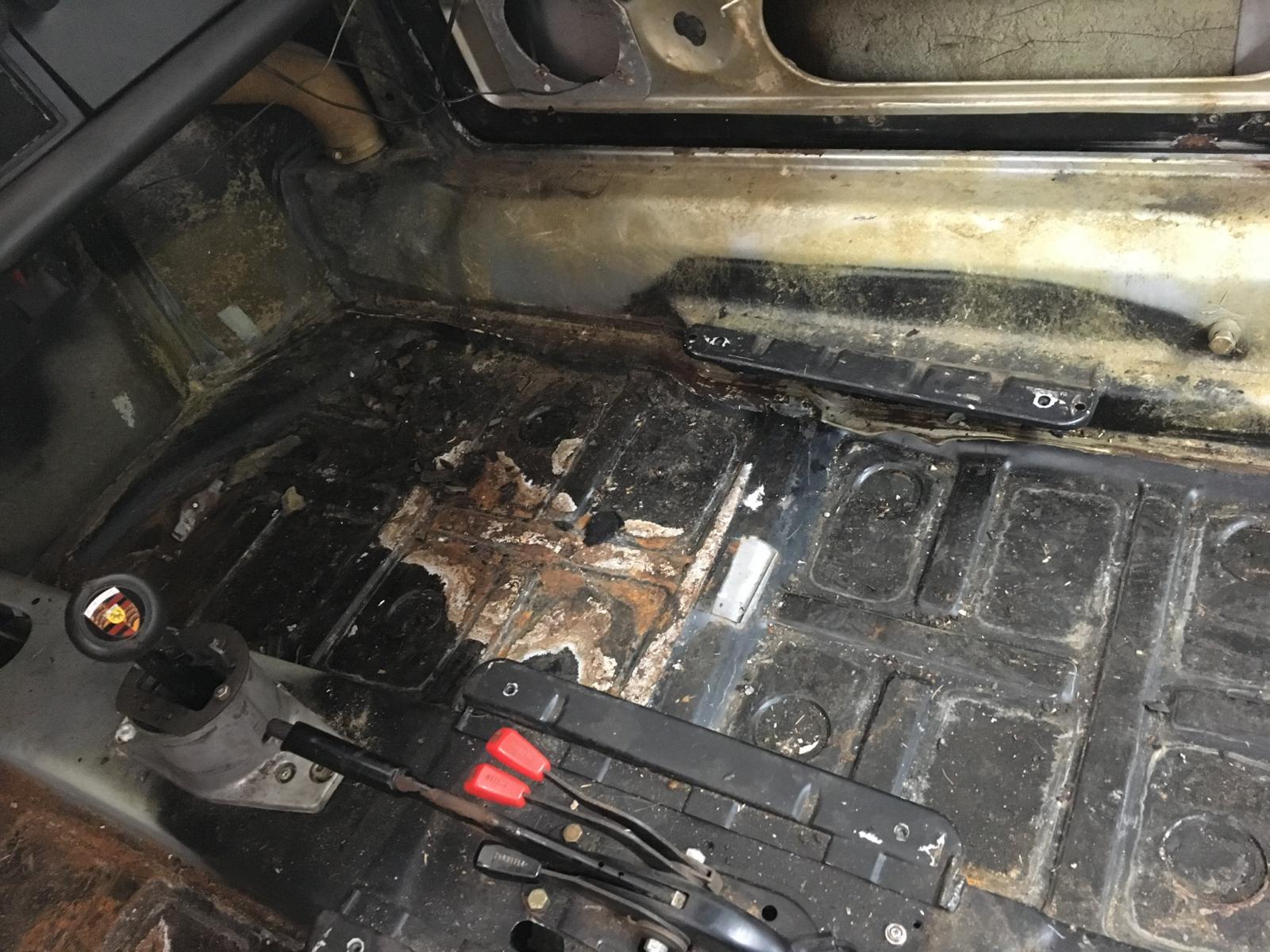

The drivers side floor is almost completely de-tarred.
Passenger side is pretty tar free now too.

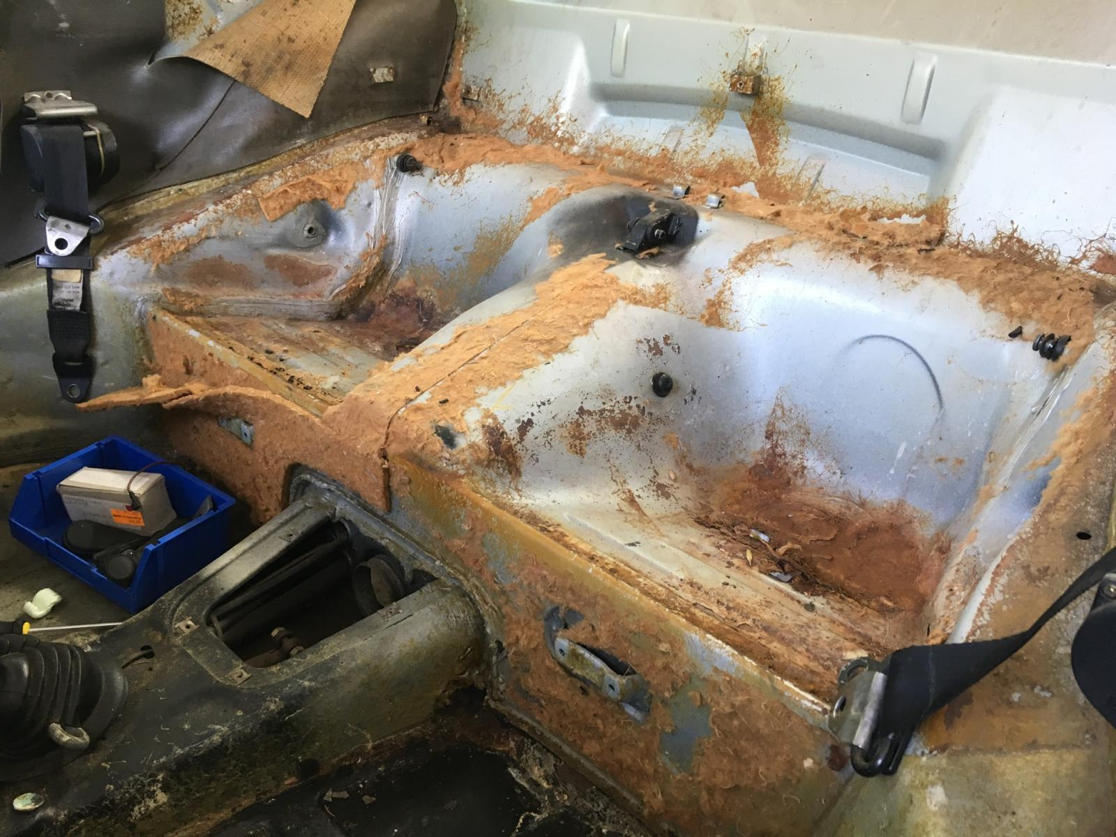

Started ripping the fur off the back, but still need to scrape the residue off.
A good bikini wax in' is in order I think :D
I managed to get the gas tank free too, just need to extract it now.
Not rusty.  That's money saved!
And more significantly - sanity!
There are a couple of minor holes to be attended to, (one was drilled by the PO and then left to become a rust former), but still managed to break a couple of bolts. One was a captive, so probably just cut out the bracket and weld a new one in.

So I had half a morning to play on the car today, so I thought I would pull the pedal box.
Every time I've passed the car, I've been tapping the main two bolts and spraying them with PB blaster. I've also given it a good rub with a wire brush, but as you might guess, I managed to break both bolts :(
I did think about heating it, but there was a good amount of PB residue and under the dash isn't a great place to have a mini fire...
Then I started on the two at the back. I remember pulling a friends pedal box years ago on his '82, but my back bolts seemed to be really corroded in. As I tried polishing around them (to get rid of the rust) I realized that the prior owner must have been some sort of safety freak as it looked like he had gone and welded them in.
Dang. I thought I was going to have to cut the rotten things off.
I'll save that until next time, I thought as I had to carry on with the honey do list.
This afternoon, I was reading Wayne Dempsy's 101 book and realized that they are welded from the factory on early models and I need to take the bolt out from the front on early models (pulling the brake master cylinder. DOH!!!
I should have read his book earlier! Oh the wonders of working on rusty cars.

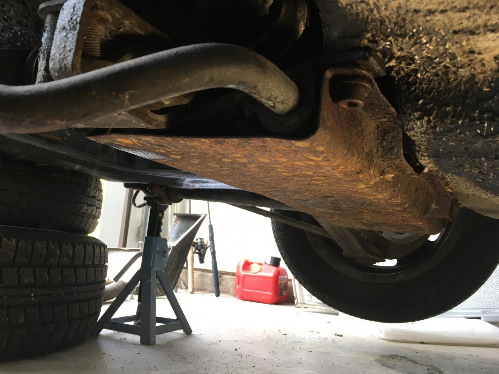

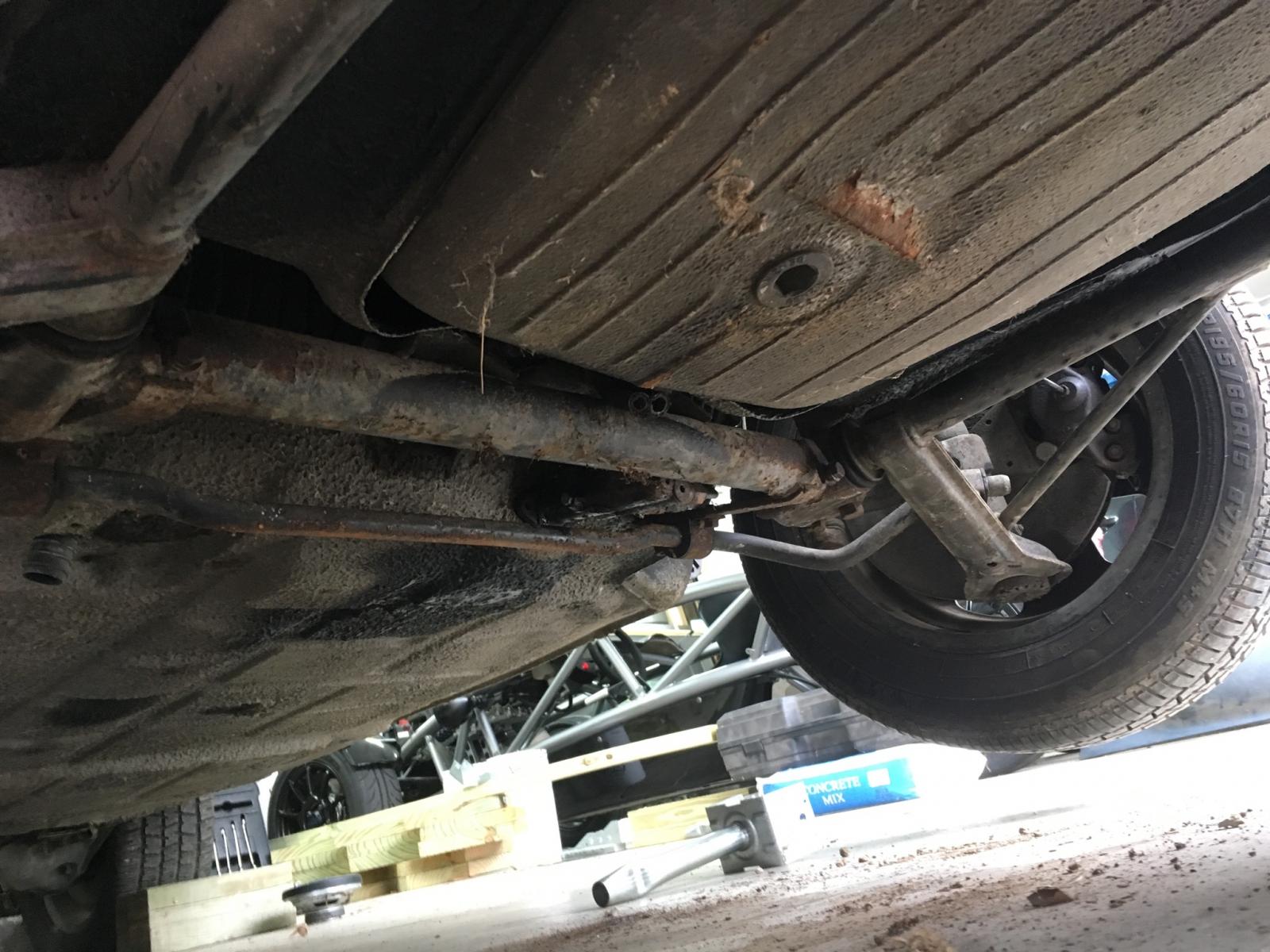

Next up is this skid plate so that I can get to the pedal box bolts.
Small movement towards that final goal... sigh.
Not sure what I'm fannying about at really.
As I keep telling anyone who will listen, it's all about the journey, not the destination! :D
As I keep telling anyone who will listen, it's all about the journey myriad FTPs, not the destination! :D
EFA
TS
Bit more fun today. Finally got the skid plate off (weighs a ton - but that's all good at the front of a 911) and managed to get the pedal cluster out.post-20944-0-12189000-1506910281_thumb.jpgpost-20944-0-96189900-1506910308_thumb.jpg
