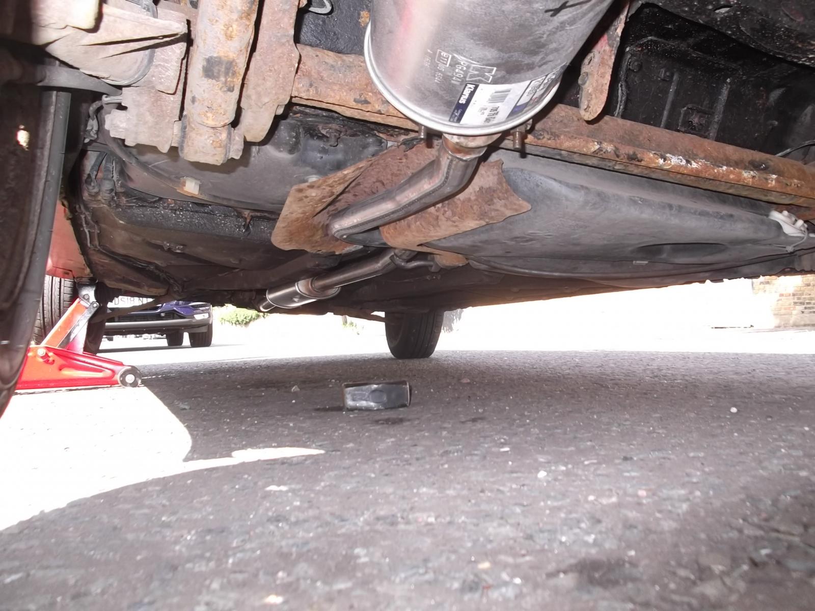

Jobs that are probably simple if you know what you're doing and have a lift and an assistant part 153: replacing an exhaust.
Rushing over to my mate's house the other day I got stuck behind a learner rigidly sticking to the ridiculous 20mph speed limit on a wide major road. Thanks Lewisham council! Anyway as I was in a rush I thought I'd nip past them using the not-in-operation-at-that-time bus lane. Unfortunately the bus lane has speed cushions on it and as I attempted to straddle one in the very narrow 106 at about 25mph there was a pop followed by the sound of something dragging along the road. So I pulled over shamefacedly and got out to find the exhaust pipe had come apart just in front of the front box. After considering calling Auto Aid, I decided that I should just try and pull the fucker off and carry on with a very noisy straight pipe. That turned out to be easier than expected, as the joint between the centre pipe and the back box was also completely rusted out and fell apart as soon as I started tugging on it! A helpful gent across the road came over with a hacksaw that made very easy work of cutting the centre pipe in half so I could stick it in the boot, and I proceeded on my merry way making a hell of a racket at anything over 1/5th throttle.

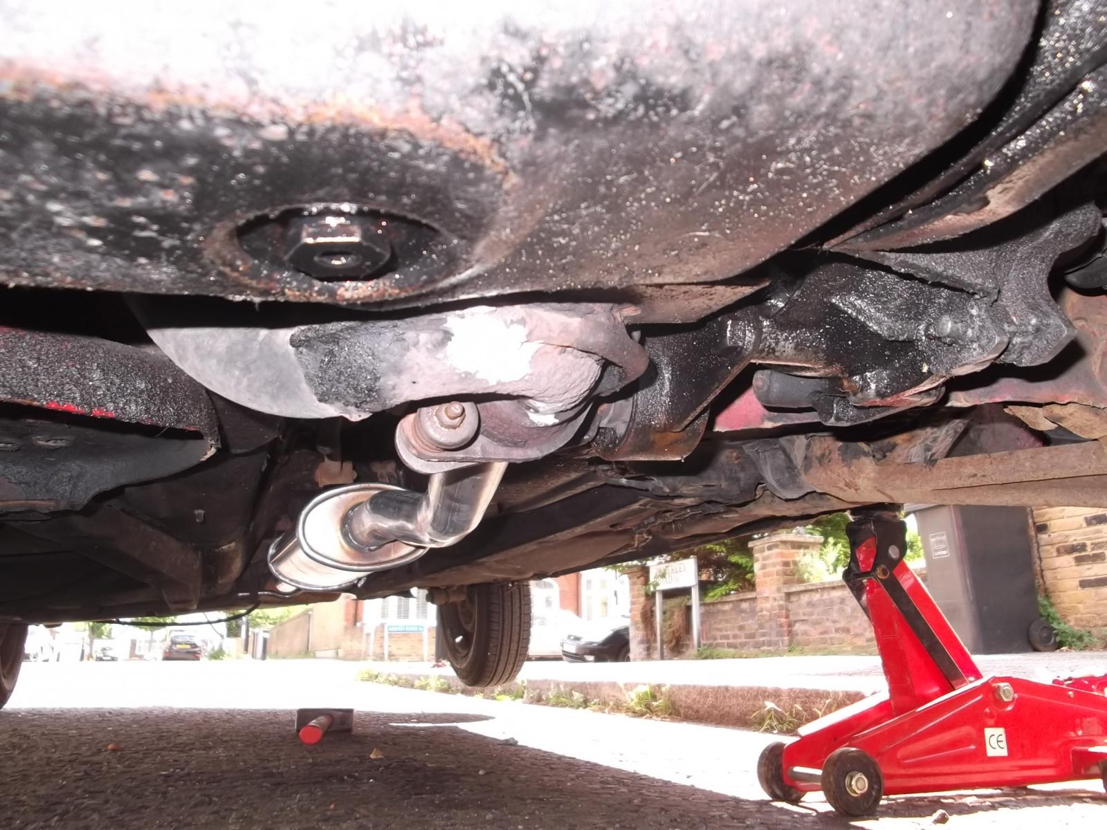

Some investigation revealed that ECP would sell me a new back box and centre pipe for a smidge over 45 quid. As I'm off with a friend this evening to visit another friend 70 miles away, a trip for which I know a return train ticket is about 25 quid each, I figured I might as well give it a pop even though the 106 is going to need some welding for its MOT in 6 weeks. So a very noisy trip to ECP in Woolwich was undertaken yesterday morning (it was out of stock at the one that's a 10 minute walk away, of course).
I had thought that the main difficulty in doing the job with the car jacked up at the side of the road would be the bolts holding the remaining stub of centre pipe to the downpipe being seized up. Actually, it turned out to be getting a socket onto the back of them to stop it rotating; one took a good heave to get moving but then came apart easily enough. What I hadn't considered was that there might be some sort of gasket in there, and even more annoyingly, that there were some insert things in the centre pipe flange which the bolts sit in. So I pulled the gasket off the old pipe and smashed it over the new one with a lump hammer, with a good coating of Gun Gum for good measure. Slightly damaged it as it seems to be made of compacted wire wool, but never mind. Then I turned the attentions of the lump hammer to the inserts, which soon yielded, and went into the new pipe easily despite being rusted to buggery.
So then it was time to try bolting the new one up. I hung the centre pipe from it's rubber and attempted to attach it to the downpipe, but there was no way I could get enough torque on it to rotate it to the correct orientation. So then I figured if I put the back box on and bolted them together it would hold it in roughly the right position. So more gun gum between them, bit of copaslip on the clamp bolts, and it was on lovely and tight.

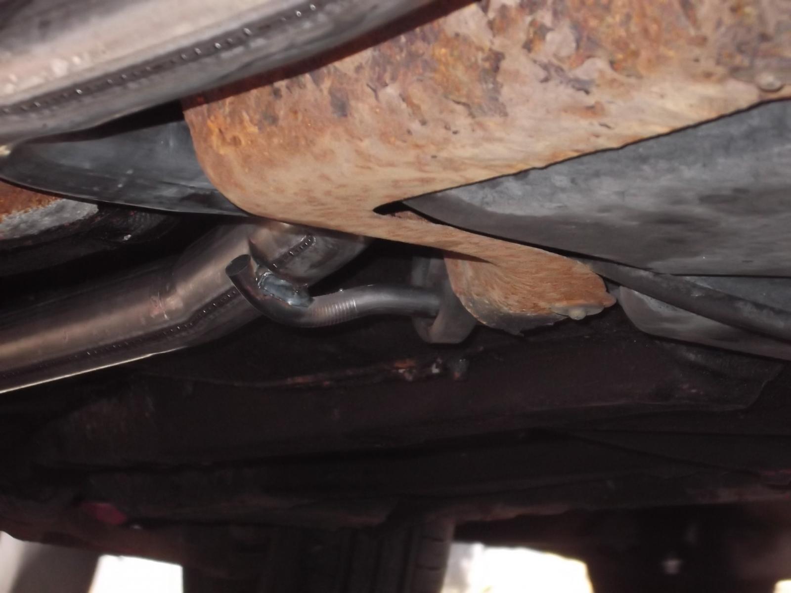

Unfortunately, the centre pipe flange was still a good 20 degrees out from where it needed to be. In the end, loosening the clamp, rotating the backbox, and using the lump hammer to prop up the centre pipe mount up at the rubber got it to within about 10 degrees and I did the spring bolts up at the front up good and tight before nipping the clamp at the back up again.
So there it is. The pipe isn't resting on the centre rubber at all, but I'm not sure what I could possibly have done any different. I can only assume the flange is on the pipe at the wrong angle, because in every other respect the pipe fitted perfectly, which was of course a very pleasant surprise:
Here's the front mounting out of alignment with the downpipe. Also (possibly) visible, a couple of patches of gum I put on the holes I found in it, not sure if they will hold, but worth a go while I was bodging the rest of it:

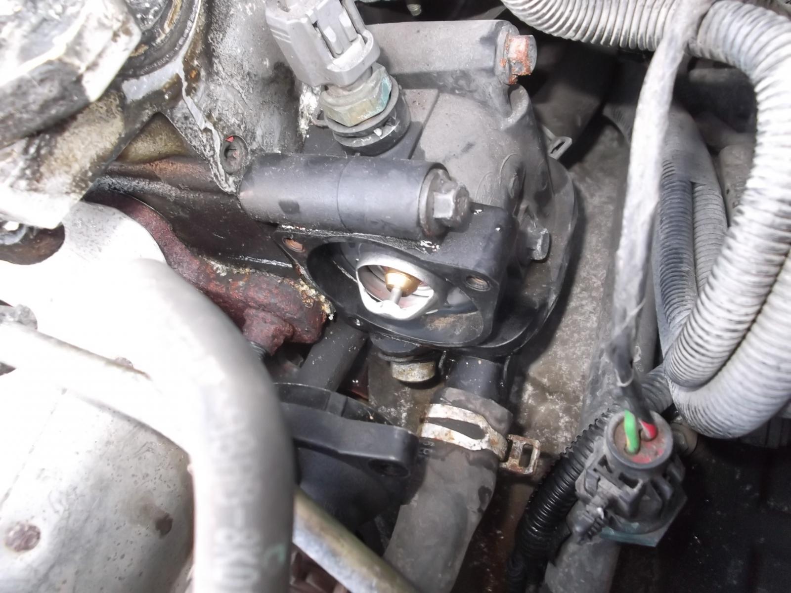

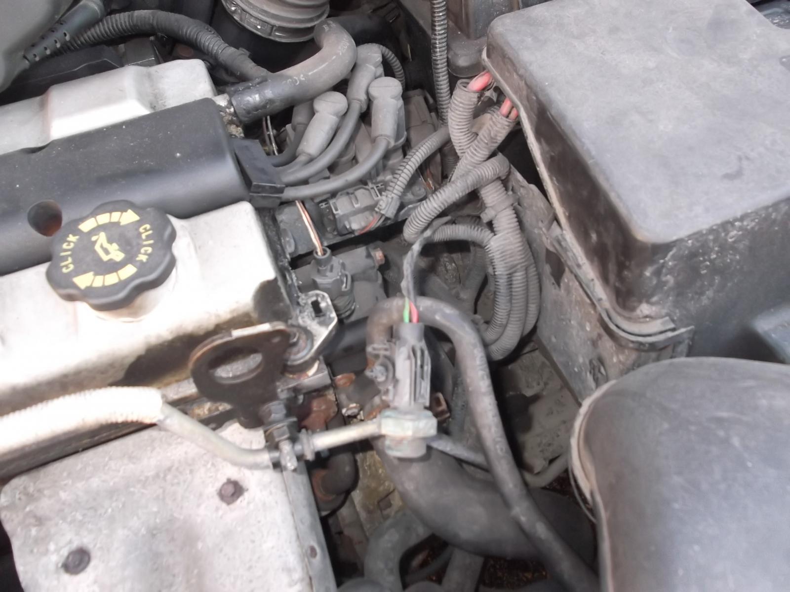

Looking under the bonnet it doesn't appear that the thermostat housing has been touched for years- surely that's the first thing you'd try? Rob was kind enough to give me a thermostat, so I'll definitely try that first. However, there's something that looks a lot like a temperature sender just dangling loose under the bonnet:
Here's a wider shot to show where it is:

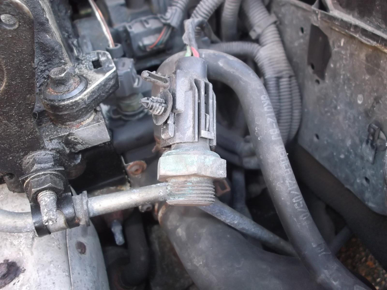

I can't see anywhere on the head, block or coolant system for it to go in. The wire for it joins into the battery positive lead by the looks of things, so I wondered if it might be something to do with the Smart Charge system, which I assume a Mk1 Focus will have?
Actually, having written this post out I thought I'd do a quick google, and the consensus is that the sensor isn't supposed to be plugged into anything, it's fitted by Ford to monitor underbonnet temperatures and kick the fans in if they get too high. So I've sort of answered my own question. Anyone know anything more about it? Is it likely to have anything to do with the overheating?

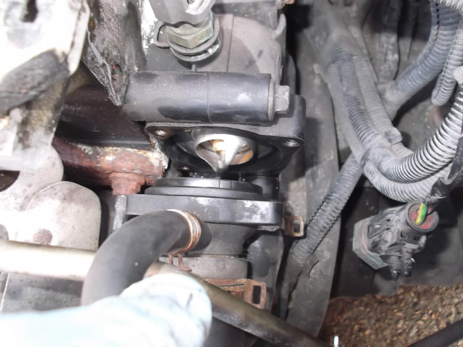

Focus next. Bought the gasket yesterday, heading round my mates for the footy later, will try and get it fitted before kick off.
Which seal do you mean Rave on the Focus? Is there one between the stat housing and stat housing cover? Mondy silver top doesn't have one there.
Edit: here is a pic...
Yeah I'm hoping it's the one marked HR2 in your diagram. Pretty sure there wasn't one there when I bunged the new stat in. I'll find out in a couple of hours!
The Mondeo has a big O ring where it meets the cylinder head. You can buy this separate, there's no seal as far as I can remember on the cover for the thermostat.
HR2 looks like the actual thermostat seal, best to get the thicker ford seal. It sits on the lip of the thermostat. Don't forget to fit the stat with the bypass valve at the top.
The coolant was all coming out from between the stat housing and the cover- the bit on the front you remove to actually get at the stat itself? (forgive my ignorance of stat related nomenclature if I've got it wrong ;) ). The seal I've bought from ECP for 3 quid looks the right size to go in there so I will try it. If it doesn't work, I will have to sack it off until I get back from France a week on Saturday, I guess, no biggie now I have the Mondeo working, and I can stick the Clio in for MOT in the meantime if my mate complains about continued pisstaking use of his driveway and side alley.
The stat itself goes in with most of the gubbins facing away from you as you look from the front, like in the diagram?

Yup, you have it the right way round. Here is an example OEM stat and OEM rubber seal that I have in stock for the Mondys.
Just thought, your engine has almost twice the power of my 1.6 base. 170 v 90!
Easily solved if its between the cover and the housing. A bead of sealant and away you go. Flange could be warped.
