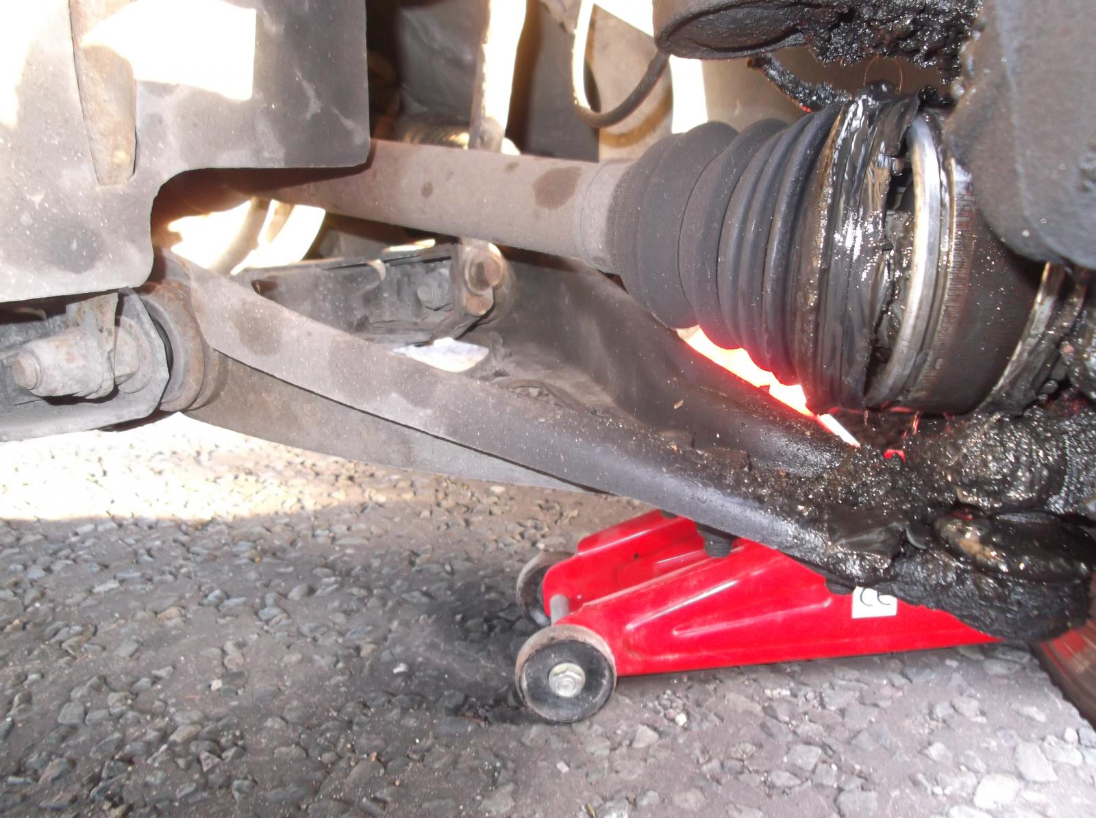

Apparently, the car has started pulling to the left. She took it to the garage next to her house who apparently told her that the CV boot has failed, and that she's bent part of the suspension. They quoted her something like 500 quid to sort it, so I said I'd have a look. Anyway, I jacked it up and had a look. Offside first:
Hmm. This boot was replaced for the last MOT at the end of September, should it be that loose on the inside edge? There's lots of grease on the inside of the wheel but that could have been there for months. I could replace the spring clip with a jubilee clip easily enough, I suppose, and maybe squirt a load of new grease into the boot while I'm at it. There didn't seem to be anything wrong with the wishbone.
So wheel back on, turned the car around so I could work on it from the curb, confirming that it does indeed pull to the left.
Oh, so that's what they meant.
The problem is that the wishbone on that side looks fine too. I reckon that replacing a wishbone with the car on axle stands at the side of the road looks doable, especially the NS one, and I could have a go with a stretchy boot kit on the CV joint while I'm at it. But if it's not bent, that's not going to help. How does one go about trying to diagnose bent suspension bits? Looking at the car, the NS wheel does seem to have a bit more positive camber, but I could well be just imagining it.
I reckon that the garage that I usually go to would do a wishbone and a driveshaft for more like £200 if I took it up to them, which is debatably worth it as the car has MOT till the end of September. If I could do it myself at a cost of £40 for a wishbone and stretchy boot kit, then that would definitely be a result. Equally it would probably weigh in for £100 and there seems to be no shortage of cars on here and elsewhere for £300-350, and if I got her something smaller than a 1.6 she'd save on tax and possibly insurance as well. I don't know if my FIL even charged her anything for the car but even if he charged her £300 she's had 5 months use out of it and would get £100-ish back from the scrappy. What do you all reckon?

Cheers. She's a pretty good friend and she admits to abusing the car, so we're unlikely to fall out over it. The problem is trying to figure out why the steering's gone skew-whiff, I can foresee a frustrating wild goose chase replacing bits of suspension until we find the one that's bent. Maybe I should take it to a place with a laser alignment system and see what they say about it?
The CV boot on my Megane split last year so I got a second hand shaft (cv joint is not separate) for £30 and had my local shop fit it, £100 all in. I woukd suggest that the tracking might just have been knocked out. If the garage have a tracking device, that would be the best way of confirming accurately what it or isnt bent.
Quite possibly Ben. I will inspect the other side before I remove it and re-affix that side with a jubilee clip if necessary.
Having watched a couple of videos on youtube I reckon what I'm going to do it try and do the CV joint boot with a stretchy universal one, and if I succeed, drive the car to a tyre shop to get the tracking done, see if they can straighten it up satisfactorily. If they find something's bent I'll only be down the cost of the boot and many hours of pissing about, and I can decide what to do then.
With the wheels straight, measure the distance between the tyre and the arch. If same both are the same then arm is not bent.
If the arm is bent then its easy enough to replace at the roadside.
As for the CV, I'm not sure if the CV itself knocks off on these? If so, then just put a new gaiter on if if its split. If not then the stretchy ones are a pain to fit and the glue together ones don't work for long.
I bet a new or reconditioned shaft isn't much money, maybe £30 for these and they are easy to do.
Or you could just say you don't have time or whatever excuse you want. That's probably what I would do!
Have a look at JR driveshafts.... Might end up cheaper overall
Cheers Tom. I think I can get a replacement shaft from ebay for about 30 quid, but I don't really fancy draining all the oil out of the gearbox which I think would be required? The stretchy boots don't look all that hard to do, and I can manage a bit of determined shoving and swearing. Good tip on measuring wheel to arch, I will try that. I'm not sure how easy it will be to find a completely level bit of road though, does that matter?
As I said earlier the CV does not separate from the shaft on these. I got a second hand shaft from ebay which was indeed 30 quid. 1.4 and 1.6 items are the same so either will do.
Sorry no they aren't necessarily the same. On the ones I have encountered, the 1.4 has a slightly smaller shaft. Count the splines for accuracy.
Easy to refill the gearbox with oil. If you are very quick, with the new shaft ready to go it then you might not loose that much oil but its usually no big deal to top it up.
Level ground is best. Maybe a multi story car park? Nice and dry ☺
Pulling could also be a bent track rod, or maybe worn wishbone bushes?
Get a pry bar or big screwdriver and try levering the wishbone about near the bushes to see if there is any movement.
If not, I would agree with the approach of putting some new clips on the boot (assuming it's not torn or holed) then taking it for tracking/alignment to see if they can spot the issue.

If the boot has gone for any length of time the CV joint will be knackered. I'd just pull the driveshaft out and put a JR Driveshaft on it.
To test the wishbone accurately, with the car on the ground try prying the lower swivel against the knuckle, similarly if the inner void bushes are seriously shot it would affect the tracking. Again if she's twatted a kerb the tracking will be way out. Wishbone isn't a difficult job unless like I've had in the past the pinch bolt sheared.

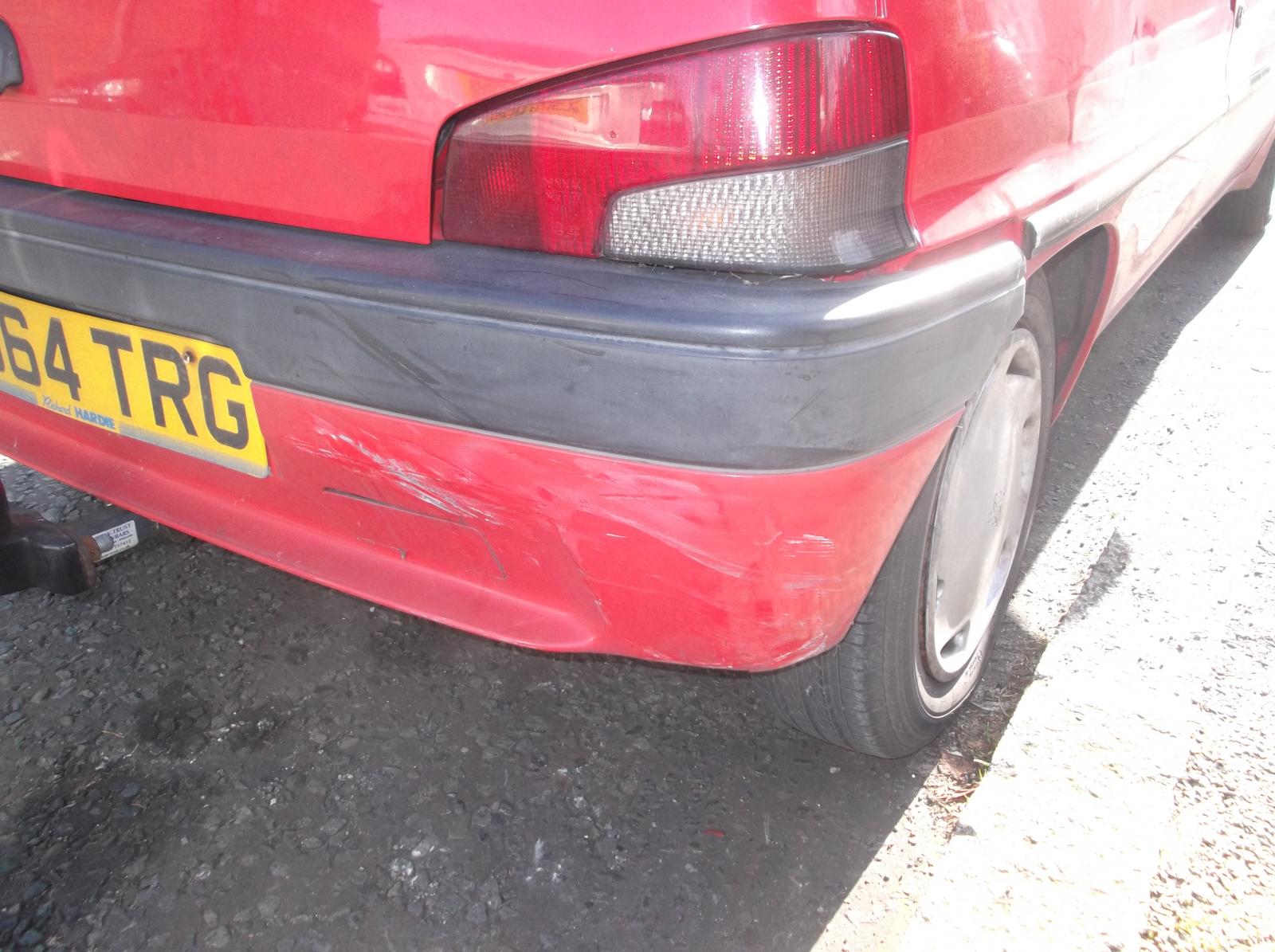

Damnit. My mum took the Peugeot off to Stansted airport today to collect our lodger. Less than a mile away from our house on the way home, she was turning into a very short section of one way street when she had to stop as someone was illegally pulling out of it- at which point someone else ran into the back of her.
The damage really does look fairly minimal, but I can foresee it being a pain in the arse. The other driver was apparently a youngish lad in an 06 reg 1.6 Golf, he sustained a smashed up headlight and possibly some other damage according to my mum. There was already a patch of rust in that corner of the boot which I had been meaning to do something about, it has clearly pushed that corner in a bit as the light cluster is slightly to cock, but the boot floor still looks flat. The car's clearly only worth a few hundred quid anyway. Half tempted to see if the lad just wants to make a donation of a couple of hundred quid to save his own NCB, but I'm opening myself up to all sorts of being pissed about if I do that, I bet. I might just do nothing for the time being, see if he or his insurance company ring up. I'll certainly not be letting them take it away for appraisal, but I foresee a lot of "we hear you've been injured" (they haven't) and "don't you need a hire car" calls in our near future too. Bollocks!
I would always ask. Had young guy in land rover go into the back of me - offer him £170 to buy and repair myself or stick through insurance and he ripped my arm off.
He rang up an hour after I posted that- by that point I'd already decided that I wasn't getting involved in any insurance claims even if it meant I ended up with nothing.
He was polite and apologetic, and said that he didn't want to claim on his own insurance, and could we sort it out between us? So I asked for 100 quid. Done. I have yet to get it, will ring him tomorrow.

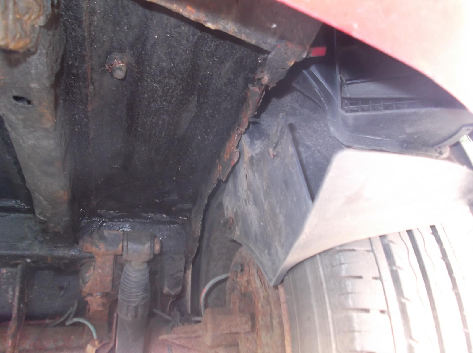

Today I took the wheel off to investigate. The arch liner just fell off! It looks as if one of the screws was missing anyway, and the impact sheared off the rusty bit that the other one was attached to. I already knew I'd be welding up that corner sooner or later, looks like it's sooner now. I'll try and push it back into shape a bit once I've cut the rot out. The bumper is scuffed and it looks as if the mount on that side has broken off, but otherwise it doesn't seem to be cracked.
