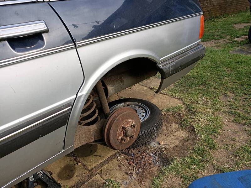

i have mostly been sourcing parts ive got pretty much everything to rebuild the brakes new brake hoses, wheel cylinders and pads i also managed to get a pair of refurbished calipers for it aswell as some engine service stuff.
today i took the drivers side arch liner off just to check behind it and was pleasantly surprised to find it was like new behind so i gave the inner arch and a good clean and was impressed how well it came up , i also treated the rust spots on the wing.
next weekend i shall start on the brakes.

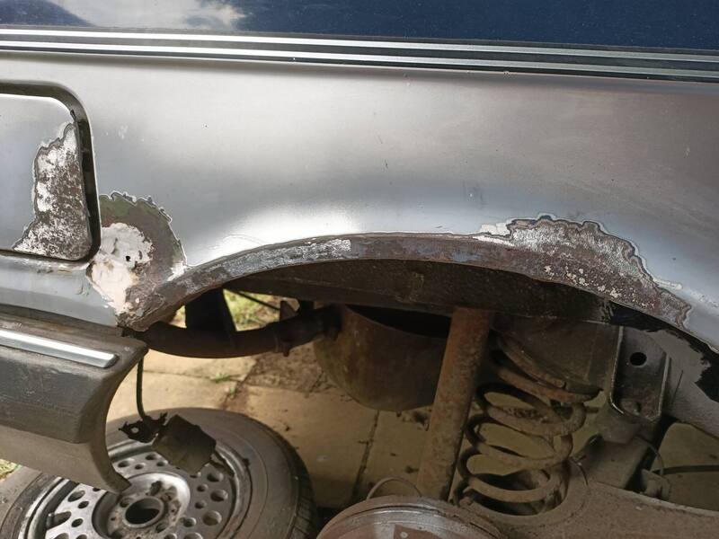

i  started on repairing the rust in the passanger rear sill end, it had been  plated before and was looking rather crumbly.

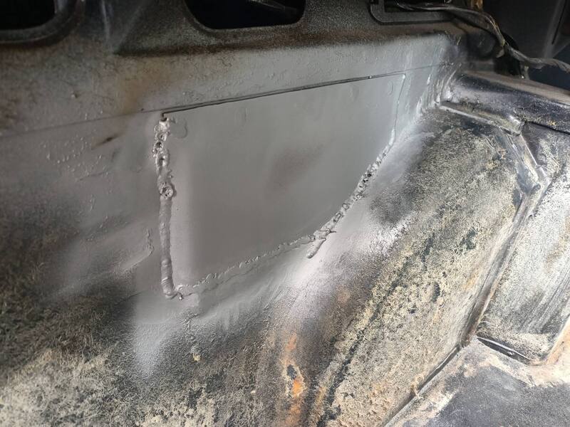

crunchy, so at work i made up some new outer sill pieces and a new strengthener piece.
with those made i started to repair the inner sill .i also bead welded the nut for the rear subrame on as ive heard these can spin out if you try to undo them .

i also managed to do a bit more welding to the passanger rear wheel arch and door step.
its coming along slowly but steadily.

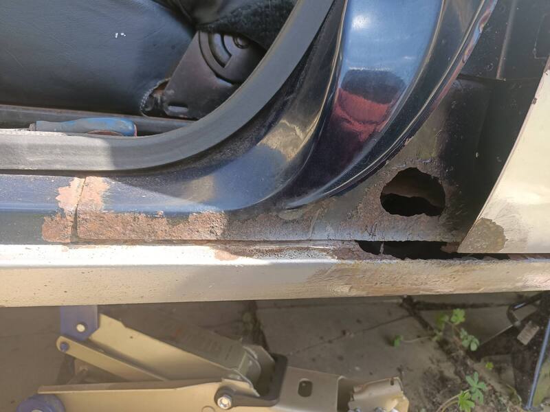

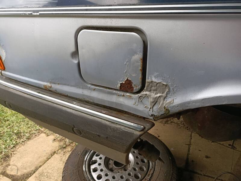

Time for a thread resurrection!! with the lockdown I’ve had some more time on my hands to remember I had this, id be lying if id said I had done anything to it in just over a year about the only thing that happened was I moved it when I sold my calibra.so I decided I should probably take a look at it now my brother wanted to have a go at welding it as he has never done any welding and this would be some good practice. I wasn’t planning on this so didn’t bring home any of my equipment from work so we made do with the stuff I had in the garage which isn’t much.  their was two large holes in the rear inner tubs that he welded up.
the top one was his first attempt and overall I think he did very well for his first attempt at welding with the not very good welder I have here at home it only really has two settings doesn’t weld anything or so hot everything melts, but with those done he moved on to some smaller holes in the tubs and under the rear seat.

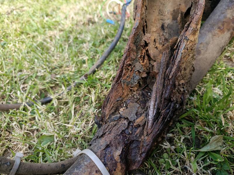

with those done I gave him a hand to fix the hole in the passenger chassis leg  and b post.
with those done that was pretty much all the holes that would fail an mot.so I went on to finish tidying the repair I did to the driver rear sill some time ago.
looking much better I did paint the sill with some silver paint that is close to the original and then  game it a cote of lacquer but didn’t take a picture of it. I also made an attempt to tidy up the drivers rear wheel arch now the rear section of the arch by the filler cap is completely rotten the last owner looks to have made a section out of plastic and filler now I have two new wheel arch panels to go on but I didn’t want to do it with  the welder I have here I also have no air tools here so I ground back the worst of it put some rust treat on it and re skimmed it with filler.
now I really don’t like doing stuff like that but it looks a lot better and should hold it back for a while I also did the other side as well which is in far better shape.

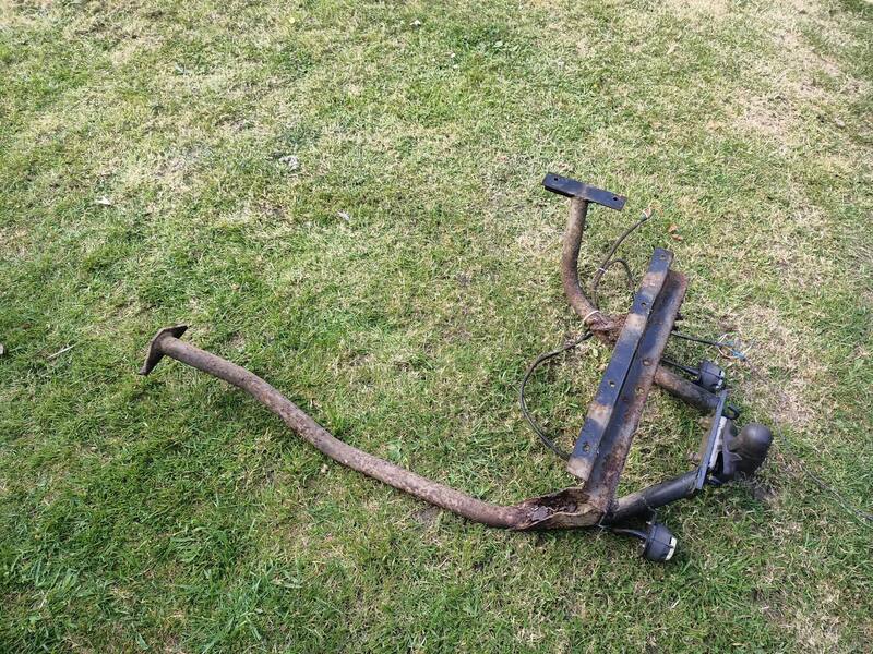

with that done it looks much better now I had to remove the tow bar as every time I’ve walked past the back of the car I’ve hit my leg on it which was annoying also I had discovered it was rotten when I was looking underneath at something else so off it came.
to my amazement all the bolts came undone really easy which was nice. while that was off I cleaned up the spare wheel mount bolt and repaired the stripped thread on the end witch I believe is a safety.

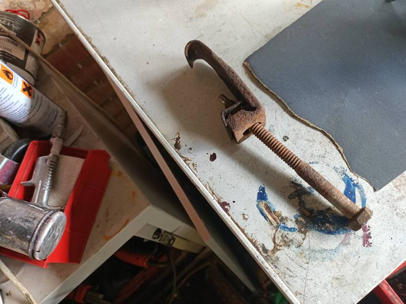

An absolutely splendid design- the pin rusts in its plastic housing,seizing the handle in the open position - curiously locking the car!
I had to lever, wrestle & strip all 4 doors down to get them off, and they’ve been sitting in diesel f r a few weeks.. Two currently shown signs of partial recovery......One on EBay £40. Fat chance....
