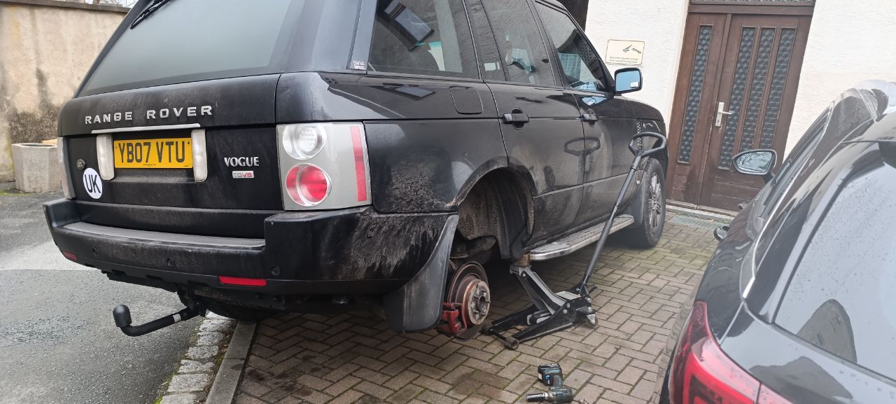

Moving on to the Range Rover. We left off when one of the air struts blew after jacking it up to replace a brake hose:
54942160104_e0c7ec5153_h.jpg?s=eyJpIjo1NDk0MjE2MDEwNCwiZSI6MTc2MzkyMzA3NCwicyI6IjI4ODY5MjFjNmYxYzgyNDM1ZWQ2N2MxZDUyNDViMGIyMDBkNjM5ZTgiLCJ2IjoxfQ
I then managed to lose my wheel lock nut key and had to order a replacement. It arrived earlier in the week so I immediately set off to replace the strut in my (extended) lunch break:
54942212160_8f32ff7d7c_h.jpg?s=eyJpIjo1NDk0MjIxMjE2MCwiZSI6MTc2MzkyMzc1NCwicyI6IjE5ZDAwZmI3ZThjYTZkNmJiZjhiN2UxZmUyMDgwYzgzYThhOTVmZDUiLCJ2IjoxfQ
54942159849_e07d326582_h.jpg?s=eyJpIjo1NDk0MjE1OTg0OSwiZSI6MTc2MzkyMzE2MCwicyI6IjdlMjg0ODdiMzY4YmZhMzM0M2JkYTlmNDdjNjY3OGYxZGI3MDlkZDQiLCJ2IjoxfQ
The lower bolts came out surprisingly easy considering they are usually supposed to be an absolute pain. The drop link was the bigger pain of the two and eventually just snapped off...
54941028467_d0ee837167_h.jpg?s=eyJpIjo1NDk0MTAyODQ2NywiZSI6MTc2MzkyMzIzMiwicyI6ImYzYThhMGE2YTc4OWU1YzdmMzc3ZDE3MDU0YWIzZDQwZjU5OWFjMDUiLCJ2IjoxfQ
Old vs. New, fortunately identical.
New strut installed, incl. new bolts and the worlds longest droplink (Lemforder as it should be). Probably was long overdue anyway.
54941901251_da585d753e_h.jpg?s=eyJpIjo1NDk0MTkwMTI1MSwiZSI6MTc2MzkyMzgxMiwicyI6Ijk2MDJmODI3YWJhZTA2ZjZmNTEzZGQ2NTlhMWUzMTdkMmE3ZTI2YjIiLCJ2IjoxfQ
Success! I reconnected the battery and it aired up just fine! I took it for a longer test drive yesterday. After several miles (and a few minutes after starting the car after parking it for 2 hours) an air suspension warning popped up again but I think it might just need to get calibrated properly at some point. No corner is deflating over night so the original error from months back might still very much be there (i.e. height sensor) and the leak was just adding to the drama.
54941024097_af3108d97f_h.jpg?s=eyJpIjo1NDk0MTAyNDA5NywiZSI6MTc2MzkyNDEzMiwicyI6IjFmNWVmNjhhN2YyNmRjOGRhMzZhZDZiMjIwYTU2M2FkOWQ2MDliNDciLCJ2IjoxfQ
Crossing my fingers that this really will be it for now and it'll at least get me to Germany in 3 weeks time. It can break there if its needs to, I'll have the time and tools to sort it there...

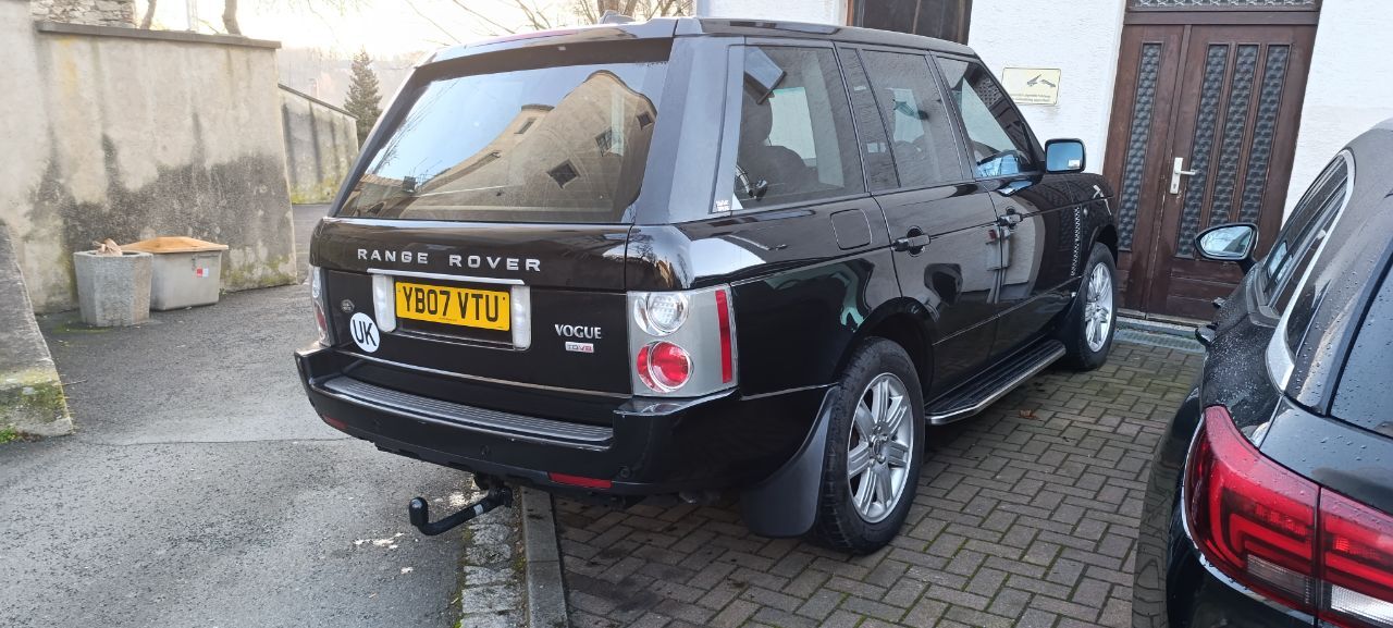

The bigger news however is that the Range Rover has made it to Germany for the Xmas holidays/family visit! We arrived over a week ago by now, adding 1100 miles to the odometer. A good chunk of the journey here was taken by ferry, courtesy of DFDS:
Since I originally planned to buy a trailer in the UK to tow my semi-abandoned German Oldsmobile Aurora home but in the end bought one in Germany instead I had some credit left for my booking that DFDS wouldn't refund (taking a trailer isn't cheap). I got a nicer Commodore cabin and free dinner instead which was a nice change from the usual bunk beds:

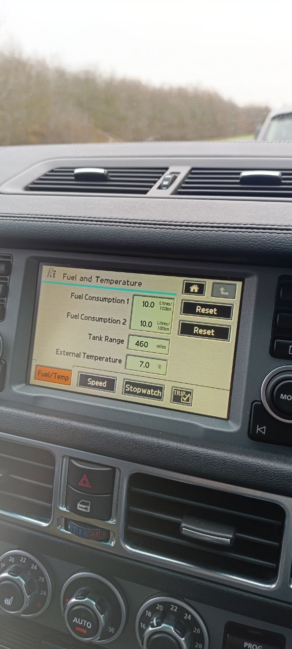

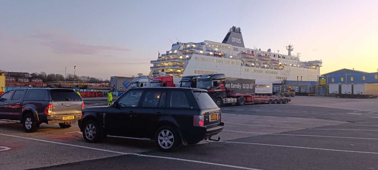

The trip through the Netherlands and their ridiculous day-time speed limits meant progress was slow but at least yielded some pretty respectable fuel economy numbers:
That's 28 UK MPG, not bad for a twin turbo V8-powered brick. Naturally that didn't last long after I crossed the German border, not only because of the higher speed limits but also the constant slowdowns due to built up traffic. The car was pretty loaded with tools and stuff I wanted to get out of my garage and sold here for a little more than I'd get for it in the UK so that probably didn't help either. It's settled at around 11.1l with quite a bit of city driving.

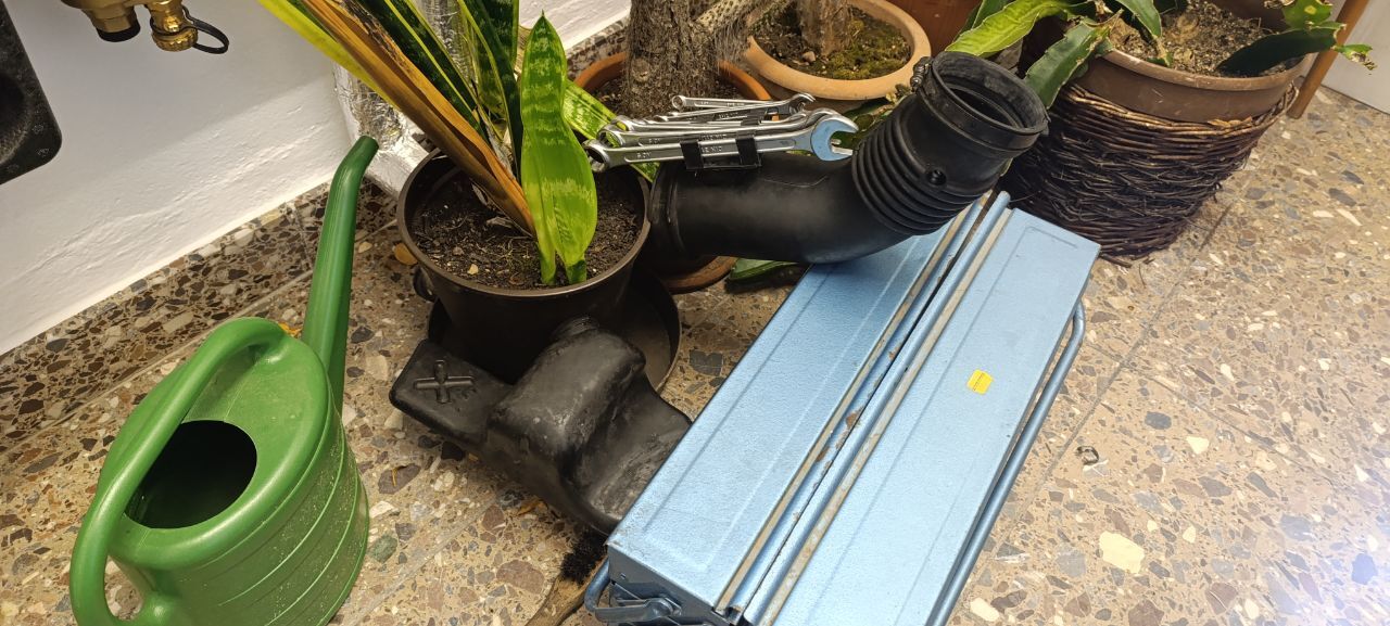

I've started to notice a vibration coming from the back starting at around 60mph and getting worse above that, but only occasionally. I knew that the right rear caliper was slightly sticky since I bought the car but held off until now. The rotor is probably warped so I took a look at what I needed and ordered new discs, pads and a caliper from Autodoc for under 200 Euros, they even delivered them fairly quickly (it helps that they are a German company).
I'll probably throw them at the car over the next few days.

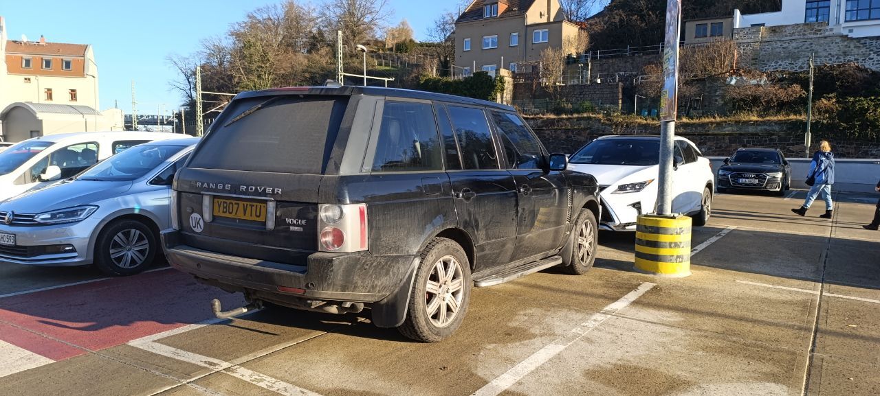

As you can tell the car has gotten quite filthy in the week it's been here, it's all road salt. Fortunately the weather's been really dry but this is the kind of crap you want to keep off your Land Rover product as much as possible:
So it got a proper wash yesterday.
So far it's holding up really well! One of the EGR solenoids is throwing a code I was aware of before, they'll get blanked off eventually but it'll be fine for now.

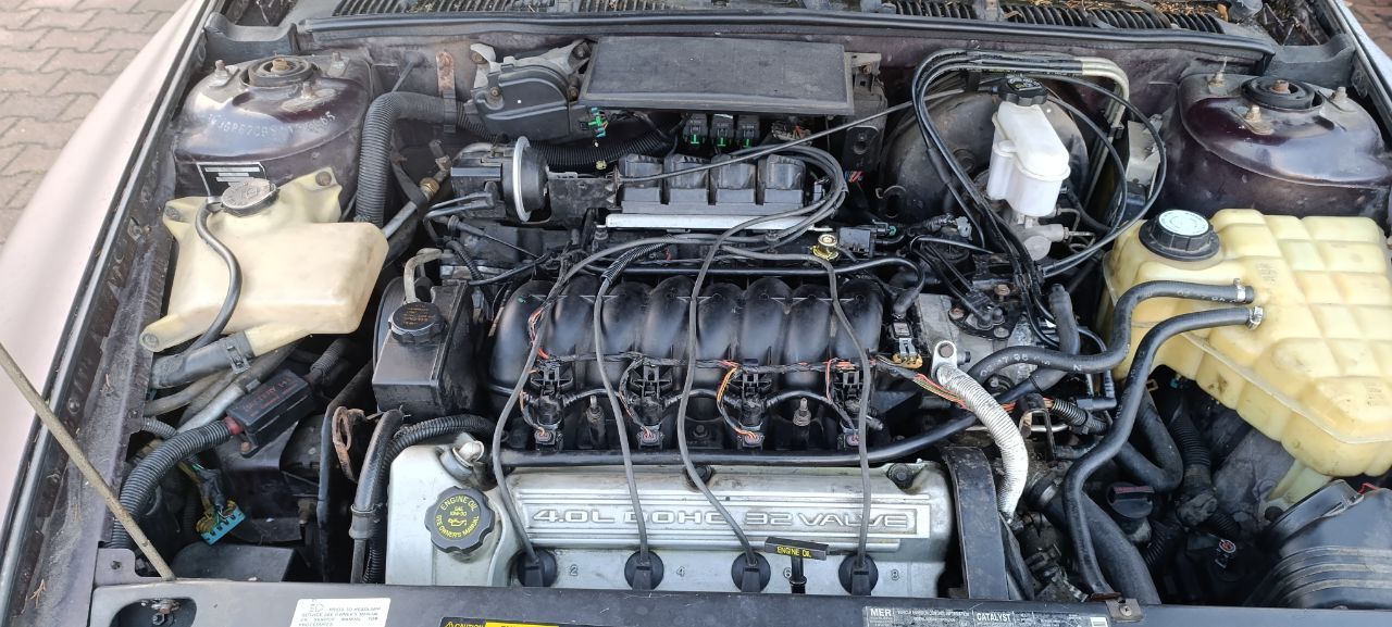

  • Schaefft changed the title to Schaefft's Bargain Barge Extravaganza - Oldsmobile Resurrection (again)

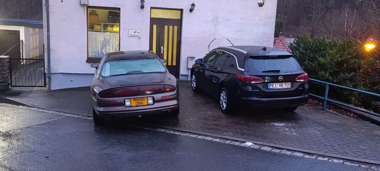

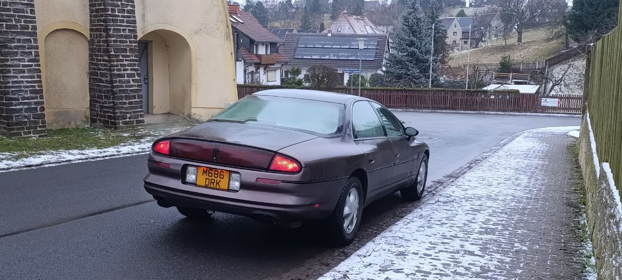

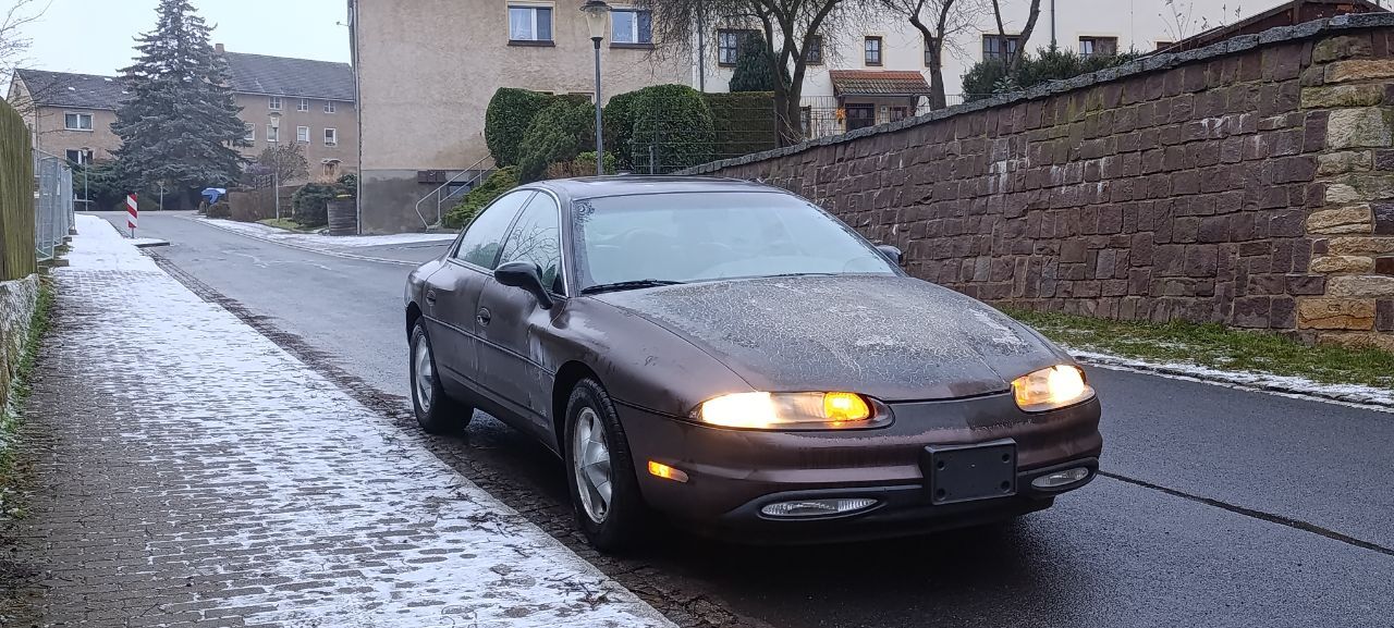

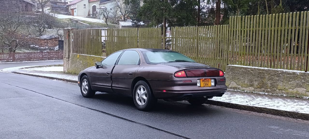

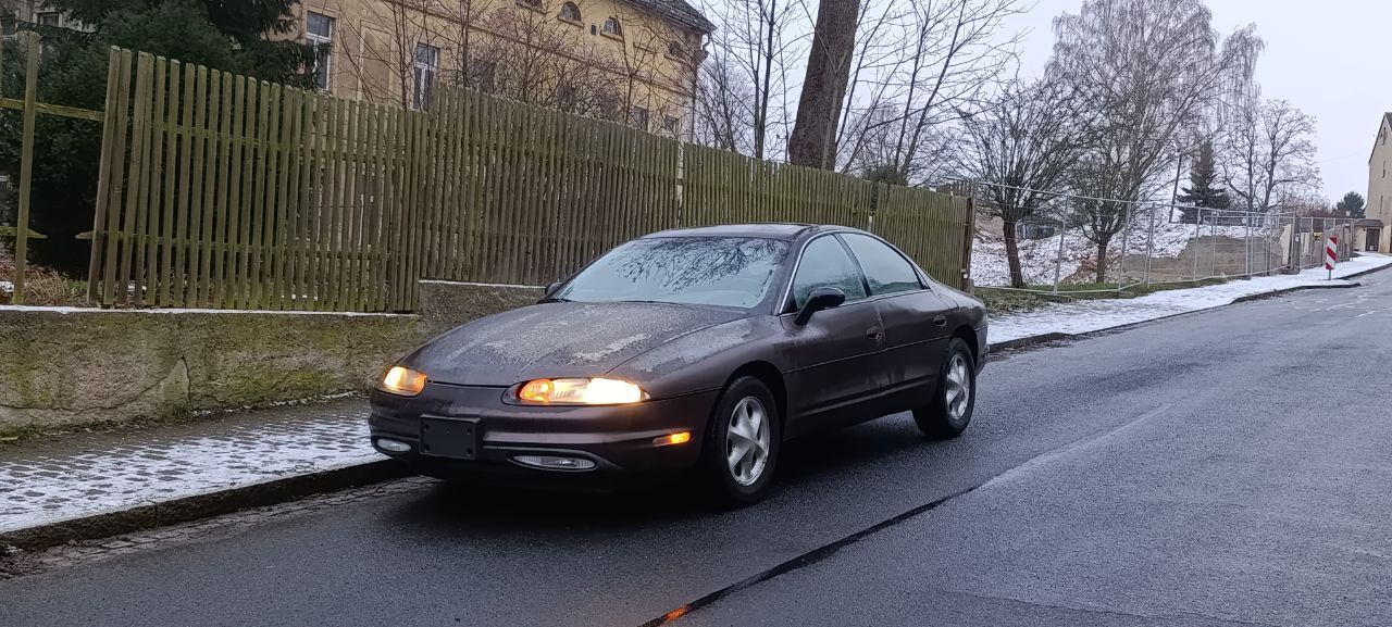

Great news! The semi-abandoned Oldsmobile Aurora lives, again!
Now you might remember me saying this almost exactly a year ago. While I was able to drive the car up to a local garage back then it really struggled with keeping running. I've asked the garage to clean the injectors to make sure it's running on all cylinders but somehow there must have been more shite in the tank, which since has completely clogged up the fuel system again...

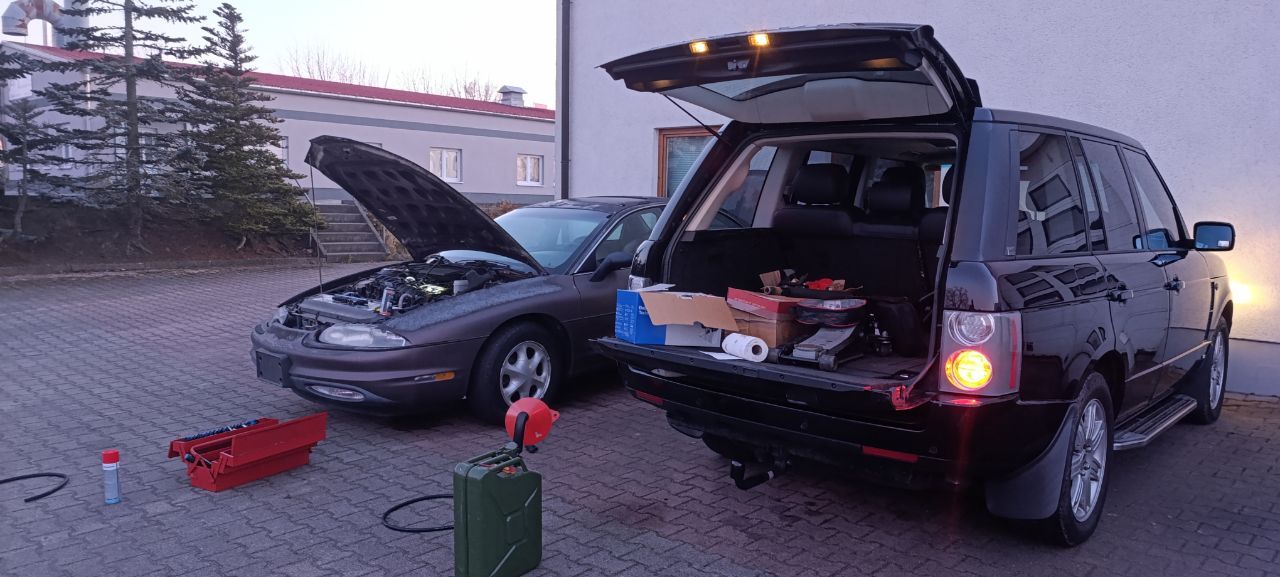

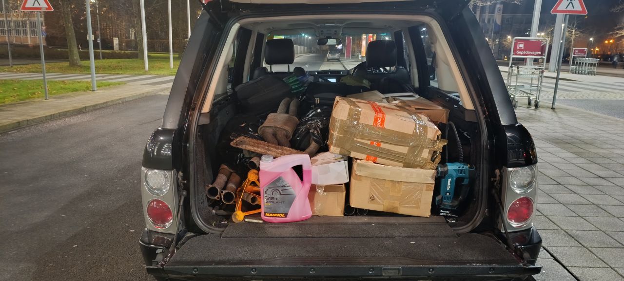

Fortunately I had pretty much everything I needed in the back of the Range Rover. The 1-year old fuel pump didn't seem to build as much pressure as it should so out it came again.
IMG_20251223_154859.jpg.e5a1f1d88d968c5d4c87acc07897abf7.jpgIMG_20251223_155225.jpg.86577137effb3e445277fdfa133b38e6.jpgIMG_20251223_153322.jpg.26db961db99e81a7ff1e5f404bdd98c7.jpg
I have absolutely no clue where this junk came from, it almost looks like something melted inside the tank. I'm not aware of anything falling inside there and everything used in the system is either original or rated for petrol and oil. I hooked up the pump to a battery to flush it and the filthiest soup emerged from it. I cleaned it all thoroughly and reassembled the pump to flush the fuel supply line after adding another 20l of fresh fuel. It eventually turned clean without any further debris but the original filter obviously has had it and the damage has already been done. Since the garage also said that the intake manifold had a hole in it (?) I removed the whole thing and took it home.
As you can tell I'm not having the best working conditions here, it was also -5 so plenty of fun was had.

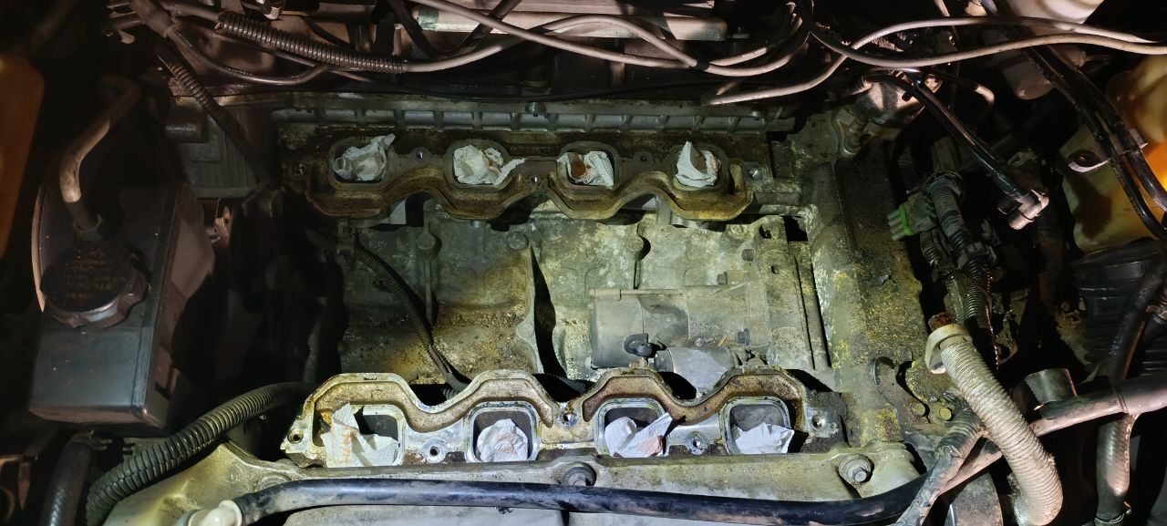

IMG_20251225_171430.jpg.95c75c7a3a7d166a5b1a146151dee733.jpgIMG_20251225_171506.jpg.418dbc917a5b5d3f2318c440557a8c4c.jpg

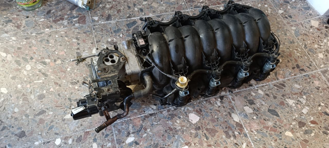

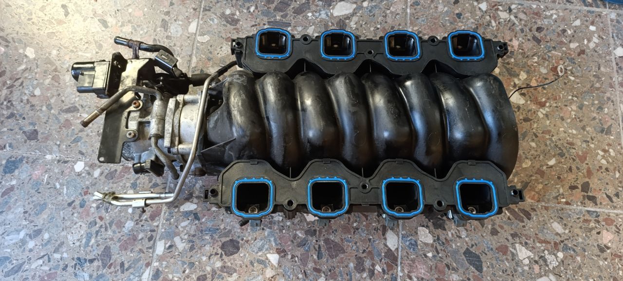

That's the starter in the valley btw. Similar to the Lexus V8 GM decided to put it under the intake manifold on the Northstar. To be honest, it's hardly more hassle than most starters mounted underneath the car.
I even brought a replacement manifold with me but as it turned out my old one was perfectly fine. The garage must have meant the intake boot having a tear. However none of that matters since no air is metered before it goes through the throttle body. My '95 doesn't even have a MAF and instead uses the TPS and MAP sensors to regulate the air/fuel mixture (the manifold on the top is from a later model year). A strange oversight from the garage there...

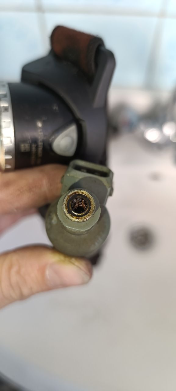

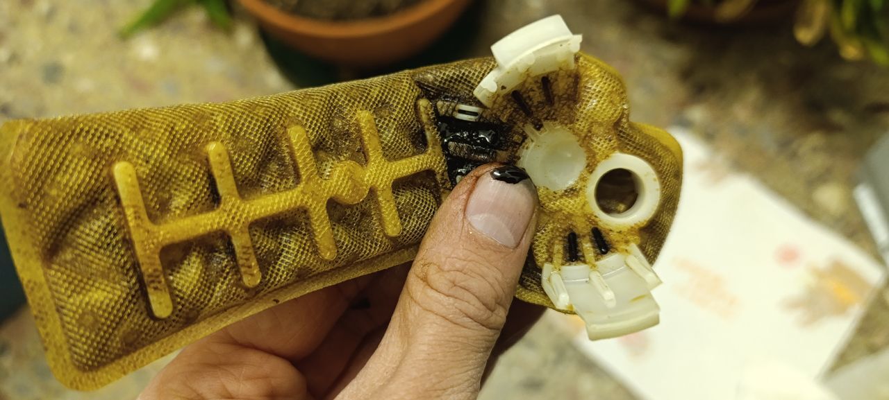

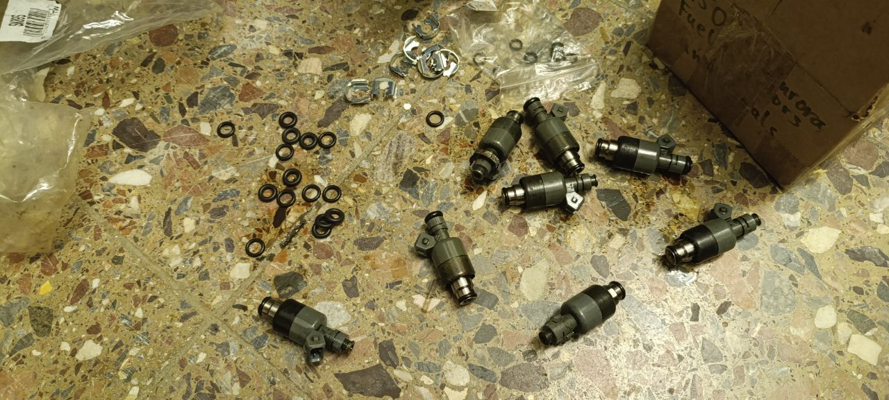

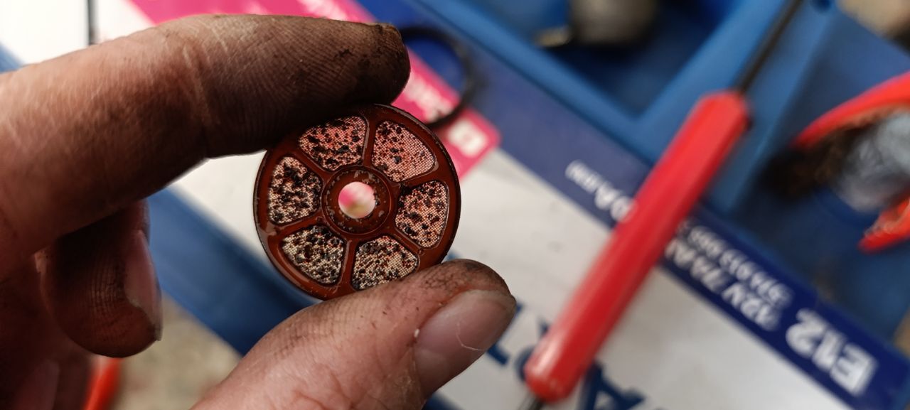

Moving on I removed the fuel rail to pull the injectors. My suspicions were confirmed, all but one injector were clogged up with junk. The filter is from the fuel pressure regulator after the fuel already passed all injectors...
IMG_20251227_123828.jpg.6fb82dbc2cc42b1321869983e83ca6aa.jpgIMG_20251227_130154.jpg.be270b1b6f80753de944a923dcca8cd1.jpg
I flushed the fuel rail, installed the set of replacement injectors I brought with me using new o-rings and retainment clips and also swapped out the pressure regulator which had a tear inside. New manifold gaskets completed the rebuild, I had a replacement throttle position sensor as well but the old one still worked perfectly fine.
IMG_20251227_143431.jpg.459f27635223f01b395775228d477d24.jpgIMG_20251227_143455.jpg.c3e7078a515bf93f589bcc9ee069b704.jpg
I also reseated the gasket of a flap GM only installed in the manifold in case of a backfire threatening to blow the thing to pieces. First time I've ever seen it but smart thinking, it sure came in handy before.😂
Here's where we left then. I've cleaned the mating surfaces on the heads and tried to get as much grime out of there as I could manage without a hoover. I noticed a wire to the starter missing some insulation so I cleaned it and wrapped it as well.
Rebuilt intake manifold installed. Since I won't trust the fuel supply until I get a chance to replace the old filter I added another one right at the fuel rail feed line, that should keep all larger chunks out of the rail hopefully. With everything ready I threw the battery back in the car and voila, we once again have V8 noises:

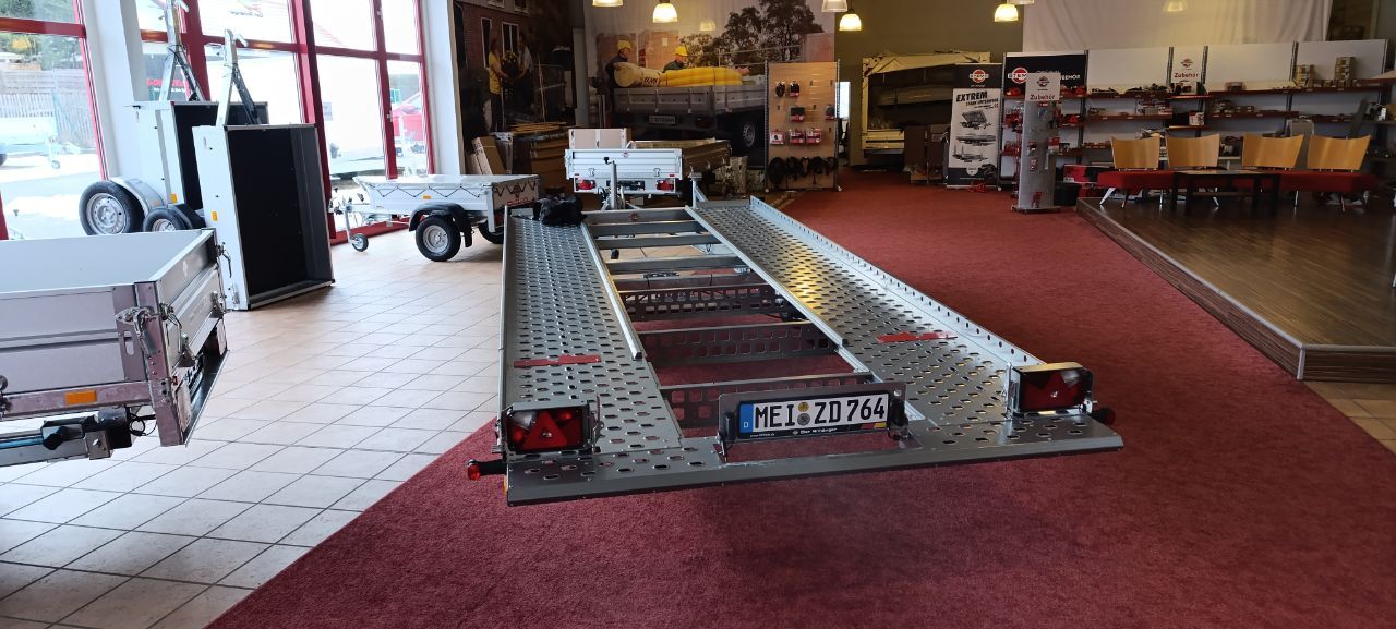

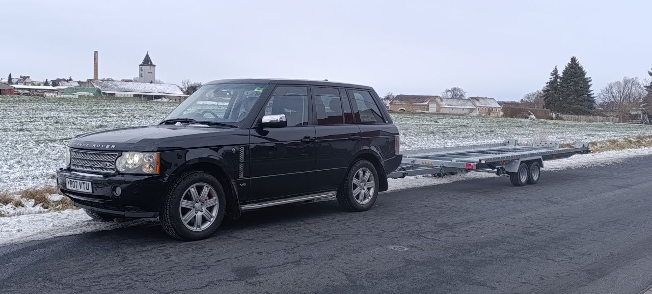

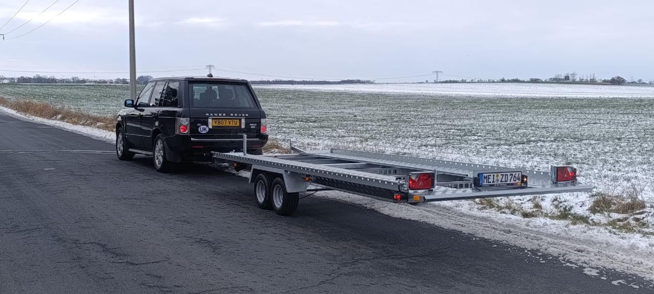

Today was the day I could finally pick up my new car trailer! A quick recap: to get the Oldsmobile home I needed something to tow it back on. The Range Rover was always intended to be a tow vehicle, I just couldn't find a suitable car transport trailer in the UK for sensible money in time to take it to Germany. Fortunately there happens to be one of Germany's largest trailer manufacturer just around the corner from here...
IMG_20260105_102524.jpg.b8e3d7759d9cb000997006cb9861c6ee.jpgIMG_20260105_102716.jpg.0bd0fcfbb9a9e4a647b0b82ac96ba892.jpg
Their showroom opened today, with all the paperwork already done it was time to finally take it home!
It's a  brand new Stema Atour tilt-bed trailer with a 3000kg load capacity and 4.90m usable bed length, more than enough for my purposes. It's fairly bare bones as of right now but provides anything I need to get the Aurora back to the UK. It's nice to buy something new and shiny for once, without having to worry about neglected maintenance or things just breaking. Exactly what I wanted to avoid for this fairly long journey as UK trailers don't require regular inspections and usually don't even have a registration, yet still cost close to what I paid here...

The 40min drive back went smoothly, the big benefit of this trailer is that it's no wider than the Range Rover, making city driving straight forward. Naturally it's self-braking so you can't feel much of it either while slowing down, or accelerating with the TDV8 at least.
I've loaded the Aurora without issues, I will get an electric winch eventually though as not all the stuff I'm planning to transport will be able to get on there under it's own power.
Some questions for those who tow regularly: How much tongue weight would you think is acceptable? My detachable towbar has a capacity of 140kg but I don't have a great way of measuring it without awkwardly using a body scale. In the image above it should be close to the limit.

It's hard to visualise the 'right' level of noseweight on an air spring tow car as they just correct it and level themselves out. My method with coil sprung towcar is just to watch for approx the right amount of squat in the rear arches.
If at 100km/h it's snaking along a bit, I would move the car forwards a little bit, and try then. You get a feel for where it's most comfortable!
I usually aim for the b pillar (on a 4 door car) to line up with the middle axle on my tri, so bang on centre between the 2 axles on a tandem. Puts you slightly forward of centre on the trailer which is where you’re better having the weight. Looking at your pic, to me you’re too far back.
Airsprung stuff like the L322 will self level and handle fine even with a little too much nose weight, but will be a pig with too little. I could be way out as I’ve never measured it but done thousands of miles this way with various D3’s and my L322, good enough for 60mph+vat towing 3.5t(ish) absolutely rock steady.
Agreed with @Gaffer especially as the axles look quite far forward on that one.
I've noticed that with the German tilting trailers - I suspect it's as much to allow a shallower loading angle when tilted, but also lets you push the car a bit further forward and keep it all balanced - at the expense of a bit more tail swing!
