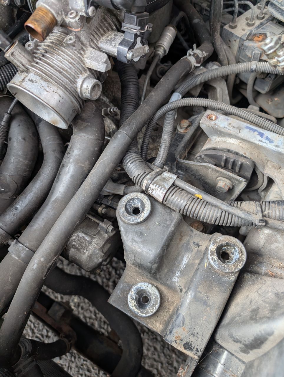

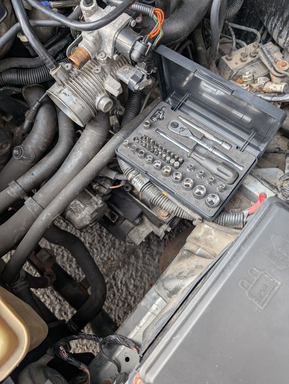

The internet lied the starter motor is more under the air filter housing than the battery box.
With the air filter housing bracket removed access is pretty good, I couldn't remove the starter today as the only tool kit I have at home goes up to 14mm and I think the starter bolts are 15mm. So I will need to pop over to my mom's and grab some more tools and wait for the solenoid rebuild kit to arrive in the post.

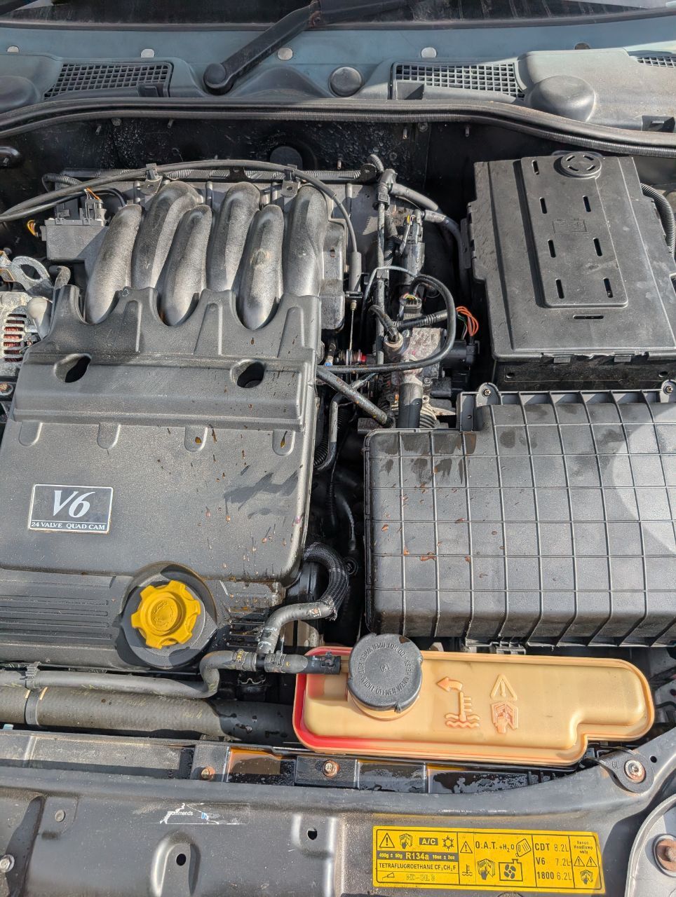

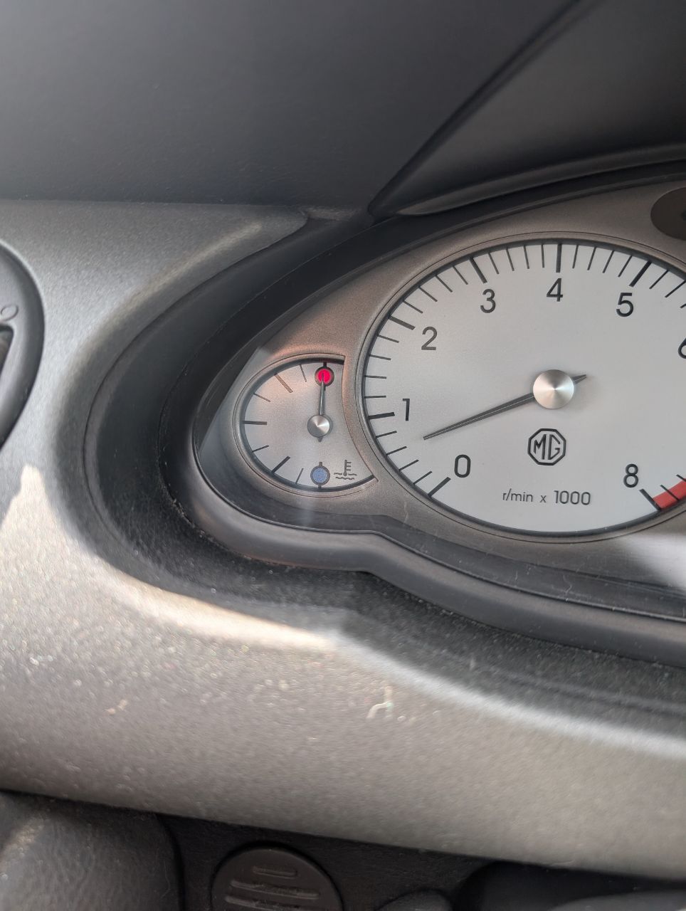

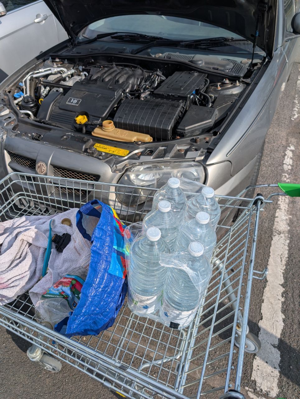

So this happened on the way home on the motorway today. I had noticed something not quite right yesterday when I got home and the radiator fan kept running so I disconnected the battery and checked the coolant level and it was fine so after a quick Google the internet suggested it might be a stuck fan relay. When I connected the battery this morning the fan didn't start running again so I thought I would have a proper look soon.
Asda's cheapest water came to the rescue and I drove the few miles home in diagnostic mode so I could monitor the temperature accurately (side note whoever decided that an ECU controlled temperature gauge that doesn't accurately display the coolant temperature will be first against the wall when the revolution comes) and it seemed okay.
I don't think it's done a head gasket(s) as no sign of smoke from the exhaust or oil in the coolant so I am leaning towards it being a thermostat issue maybe but my plan currently is to give the system a good flush and replace the header tank and cap and the thermostat and then see what it does.
Just ordered a thermostat kit and tank cap from DMGRS so will get it changed next week.

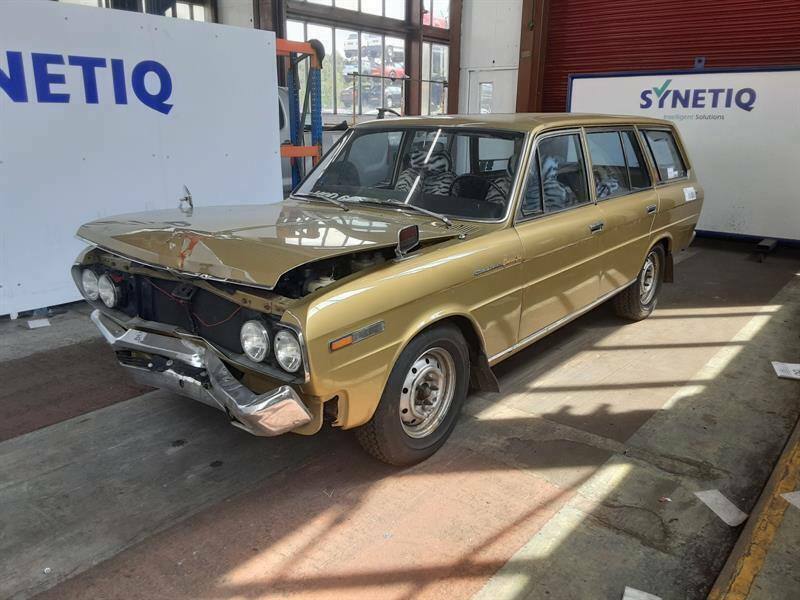

Well that's obviously a bit of a depressing outcome as even though it was declared a CAT B write off and the insurance paid out on it I did hope that someone would find a way of saving it as I still feel responsible for the tragic death of such a rare car that had managed to survive for 50+ years.
17 hours ago, DodgeRover said:
There was zero market for parts of was advertised for months - enough people tried to buy it complete but they wouldn't let it go in one piece.
The parts were mega overpriced too.
I spotted this yesterday too 🙁
If you have a breakers license and account with Synetic, they’ll sell it to you complete. Obviously, putting it back in the road is a no-no (technically) but there’s nothing to stop you racing it, I don’t suppose.
