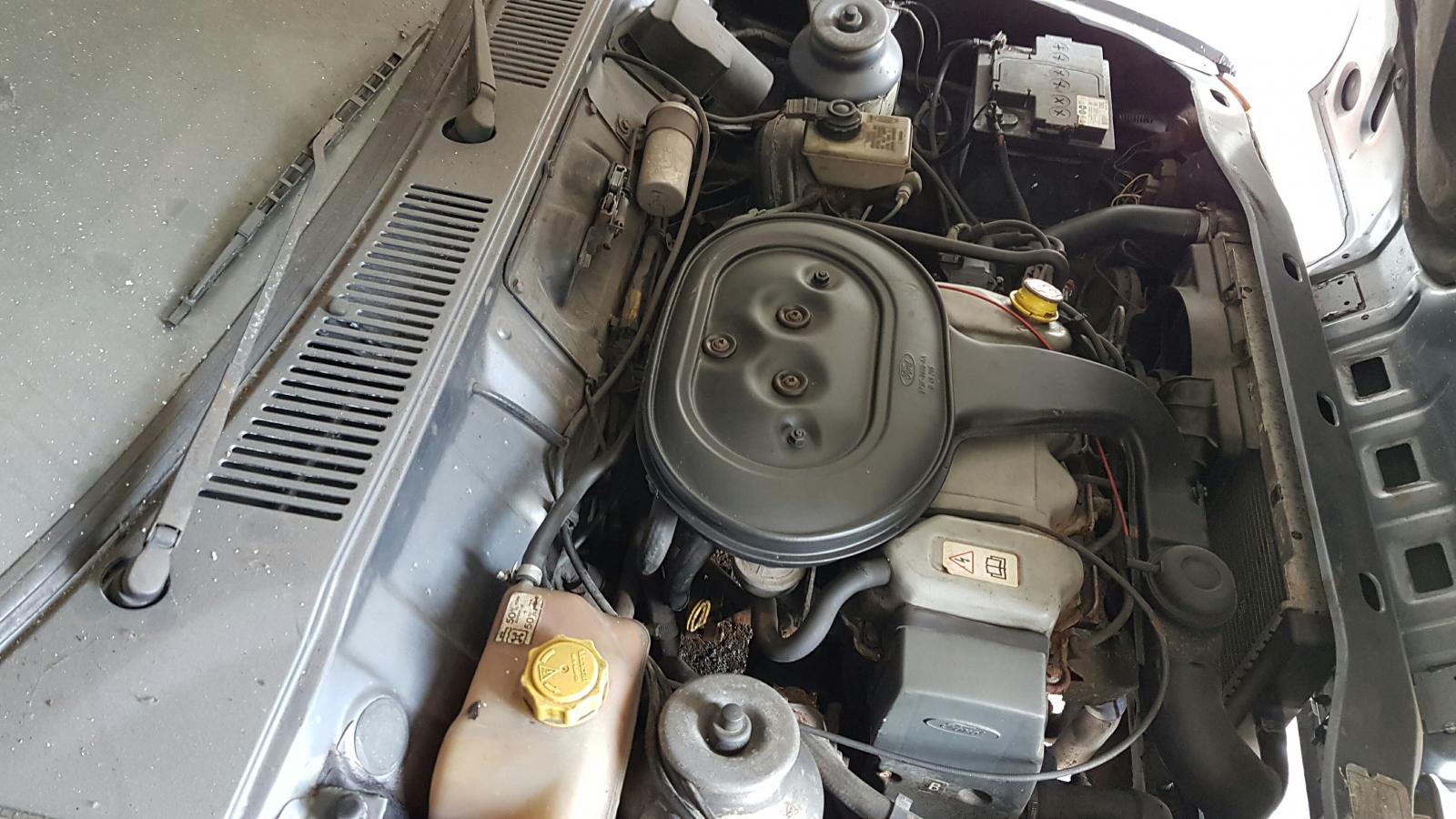

Is the spring washer on the battery post photo where it is for a reason? Would normally go next to the nut.
Also spring washers are supposed to be tightened until they flatten out or the terminal would be loose.
I thought that.
By putting the spring washer between the cable terminal and battery terminal you've effectively greatly reduced the contact surface area.
I've always put the washer next to the nut.
I'll shift it if it's best. I did it like that to make sure that I. Knew for sure that some metal was touching and not just flat plates that might not (yeah I know that stupid logic but I still don't get why it wouldn't work before)

As for the other thing I'll have to go over every air intake pipe again checking for splits or get it plugged in. Last time though, when it was worse, it showed no faults.
Get a can of easy start and spray around various induction parts whilst it's idling
Should help narrow things down a bit
How? You mean to see if there any bubbles or anything? If it's the same bit of pipe that went before it's totally hidden behind the inlet manifold
The combustible gas will affect the idle as its sprayed on the area which has the air leak, I usually use WD40

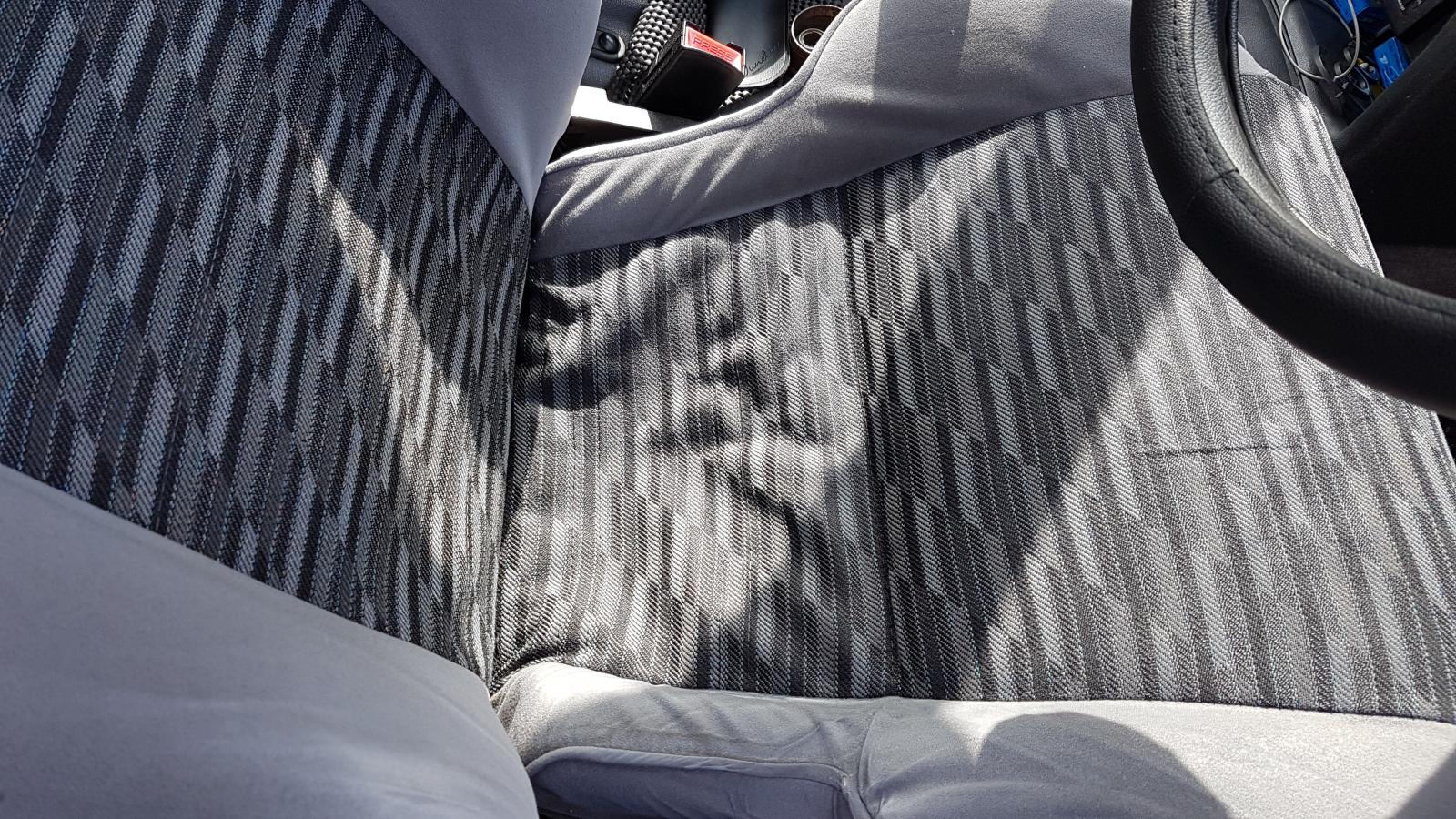

A new fun and exciting opportunity for bodging has presented itself that unfortunately I can't fix.
May I present the now very saggy Frontera drivers seat.
Yesterday just has I got to Huddersfield it made a very small movement and assumed a spring broke.

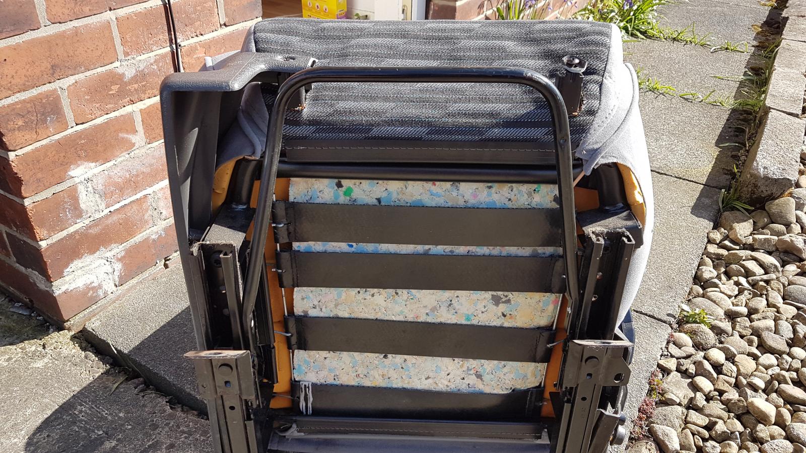

It's not nice to sit on so out it came today. It must have been out before as one of the four bolts was missing from the back.
It helpfully pulled the carpet up on removal.
So off with the trim and that white bit back on

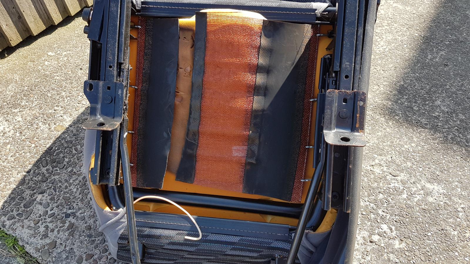

Oh dear it's not a spring
Of course on the quick look I've had I can't see anywhere that does replacements but I know a guy that fixes seats so I'm sure he'll be able to do it.

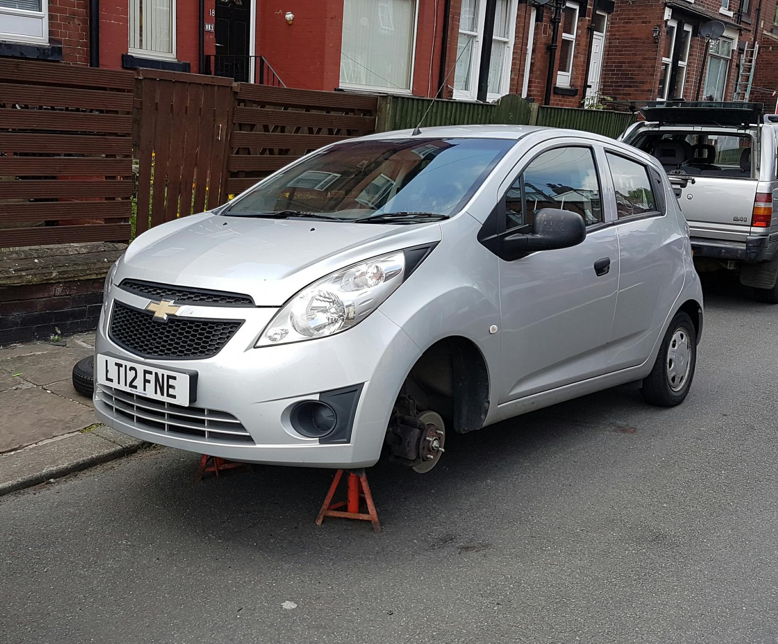

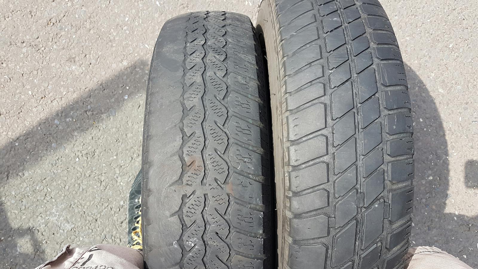

Following the post in the grumpy thread about my mate and the random juddering yesterday today I went to have a look.
When I got there the drivers side front tyre was flatish and covered in cracks, both were badly worn. So sod loads of messing about changing them around I just took axel stands.
Due to the shape of the road I had to pump the tyre back up to get the jack under. You could see then the side walls were wobbly but put them together
Oh dear.
Ended up at Kwik Fit as they were the only ones that could do it today. Guy thinks the whole side wall has failed. Mate had rung them and they said £60ish on the phone. Tit didn't ask was that for one or two tyres. Of course it was only one so £125 later.
Still needs the tracking doing and brakes as they are catching and a bit low.

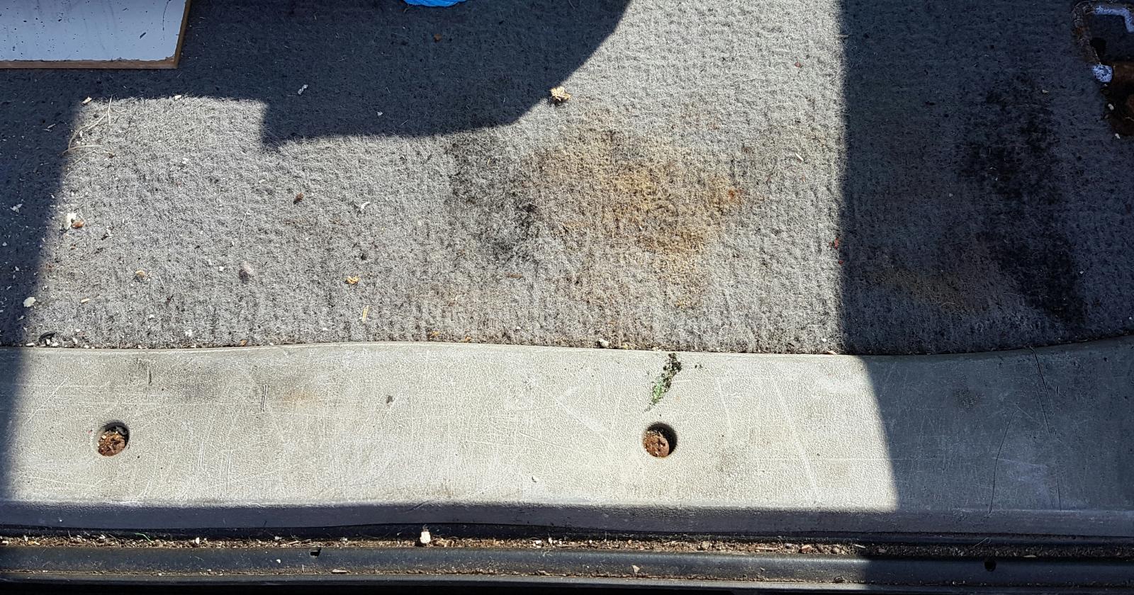

When getting the stuff out of the Frontera I noticed the bit of carpet in the back had what I thought was oil on it.
Not oil...
The boot floor doesn't look that bad and isn't wet
But it does mean waters getting in somewhere. All the seals on the tailgate look OK so when I've time it's going to have to be messing with a watering can.

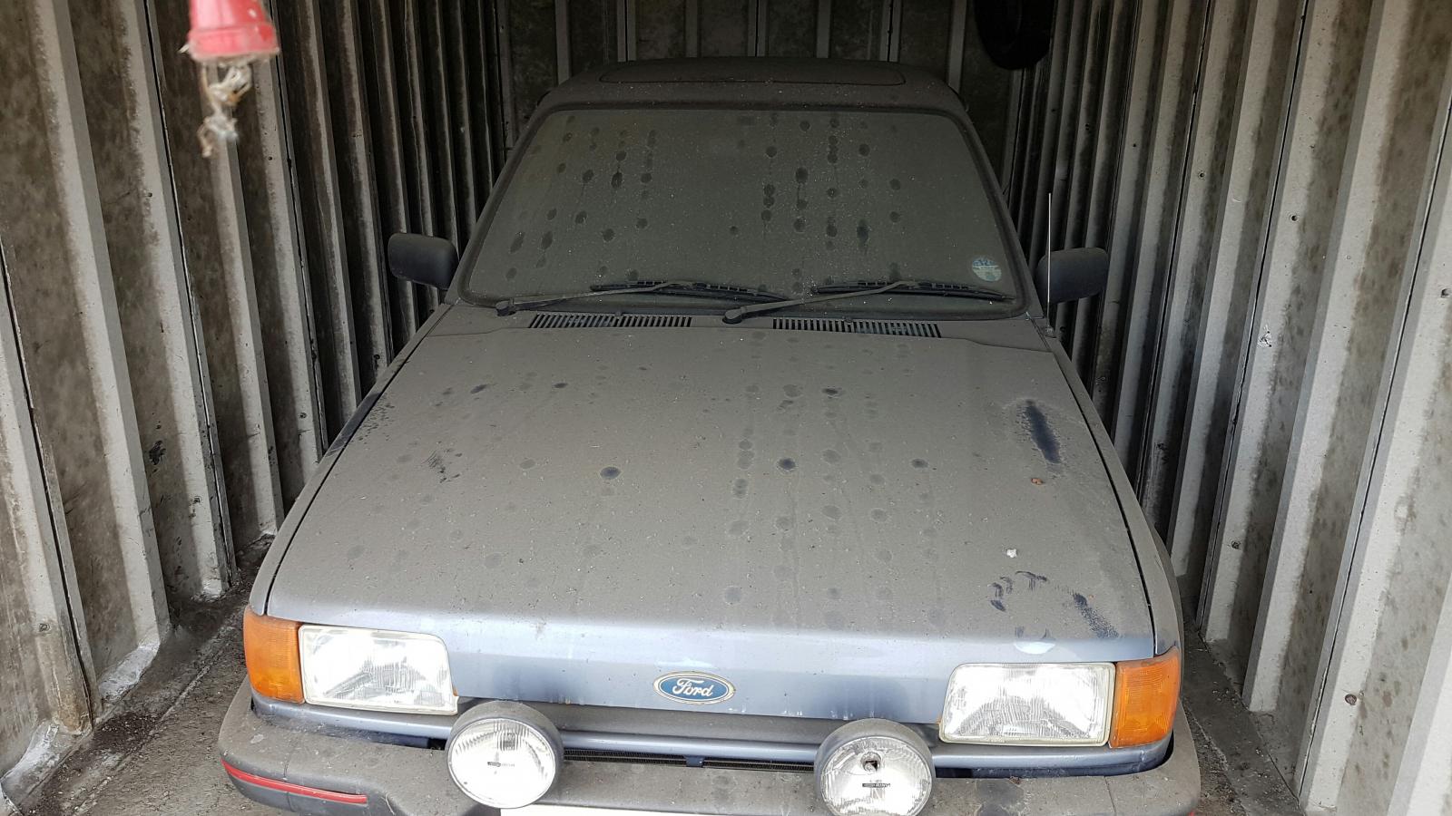

Can I interest anyone in a barn* find
Oh dear. All that time in the garage and it's still better than the red one I drive nearly everyday.
Managed to get into the garage it's byeaving some wd in the lock that loosened it enough then when off filled it with some ancient spray oil type stuff I found.
Good that I didn't have to cut the hasp off but now the door won't shut straight again.

When the seat collapses like that I have used paracord in a cat's cradle arrangement between all the little hooks.  Works OK because the cord has a little bit of give in it.
