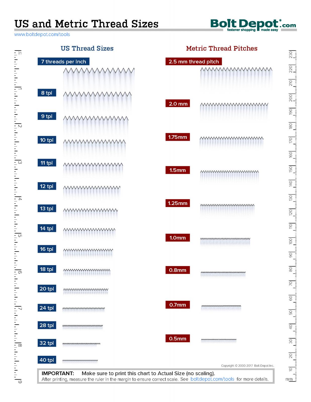

It'll be an M10.  Standard is a 17mm head, but metric never seems to be very standard, and automotive are devils for putting smaller heads on.  The thread for an M10 should be 1.5mm.  Fine threads are not so tightly defined in metric, but they take a step or two down so likely to be 1.25mm or 1.0mm but it is likely to be a standard thread on a shock hopefully.
Good luck, the spare bolt with a slot in is good for me.
It's probably an m10 as said - personally I always measure the bolt using a calliper - 10mm diameter = m10 then use a feeler gauge to check the thread pitch
If you're lucky enough to have thread gauges, fine, but the easiest way to check a metric thread which you think might not be standard is to check it against other standards.  So M10 is 1.5mm pitch and a fine will be either 1.25 or 1.0, and an M8 standard is 1.25 and an M6 standard is 1.0, so if you hold the thread against the light with some standard screws, you can see which it is.  Most metric threads, certainly away from cars are standard.

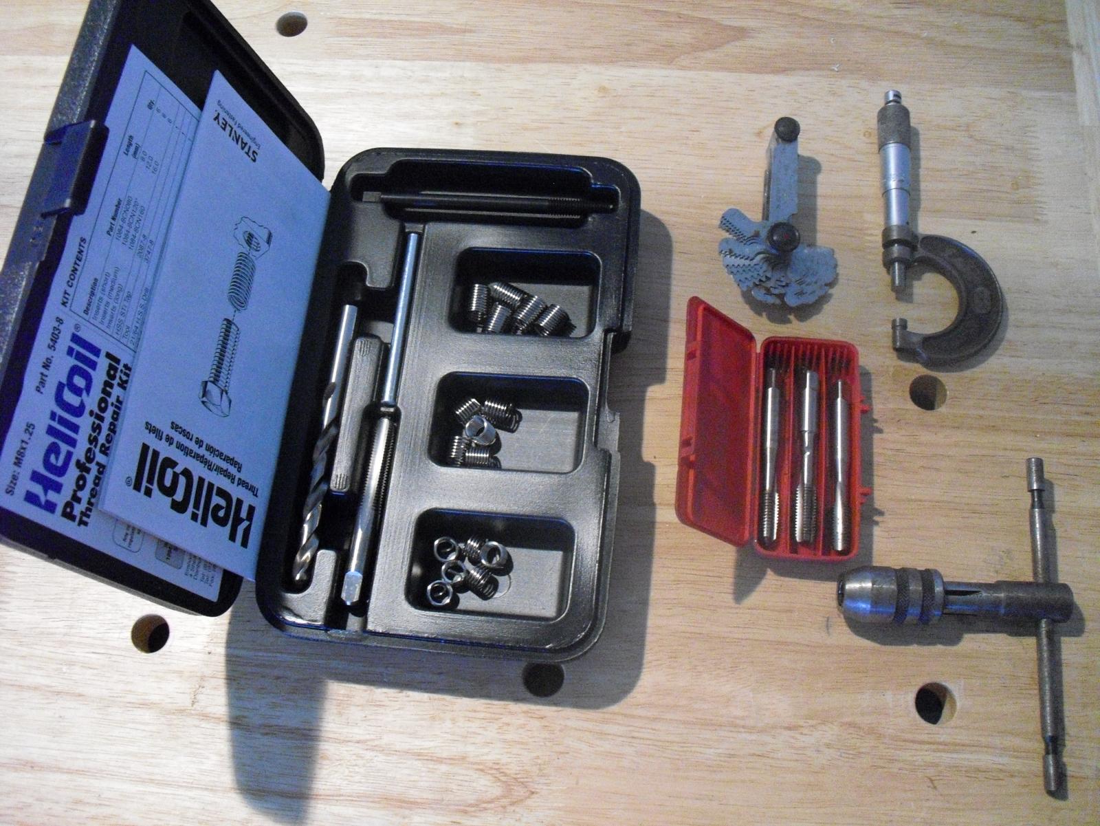

Yeah, another here just saying get a thread gauge, they cheap and so friggin' useful. I have three knocking about the workshop, mostly because I can only find one at a time.
I tap and die a lot in my work, it's saved me quite a bit of work. Especially things like manifold studs where they go into weak and sloppy aluminium heads.
If the threads are still sloppy after tapping out, you'll need to helicoil it which looks daunting but is actually incredibly easy and ends up with a stronger thread than factory.
I've never actually had much luck with helicoils they always seem to come unwound when you remove the bolt at a later date. Timeserts seem better for me.

Drop of one of the stronger threadlocks on the insert before fitting sorts that.
