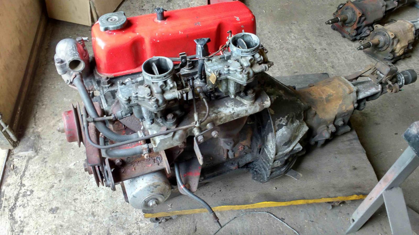

I fetched 2 Victor engines and 3 gearboxes from Runcorn this weekend, a nice Landrover full. I tried the standard 1500 first- it's been dragged out of the car carelessly and the bell housing has had a hole punched in the side. The carb has been walloped hard so the intake is egg shaped. I cleaned its motley collection of plugs (only 2 were the same heat range) and bent the points arm so that the contacts vaguely touched. After hooking it up to a battery on my test rig (the floor) it burst into life and ran very nicely without smoke.
The other engine is much smarter, bristling with horsepower (80+), carbs and an alloy head.

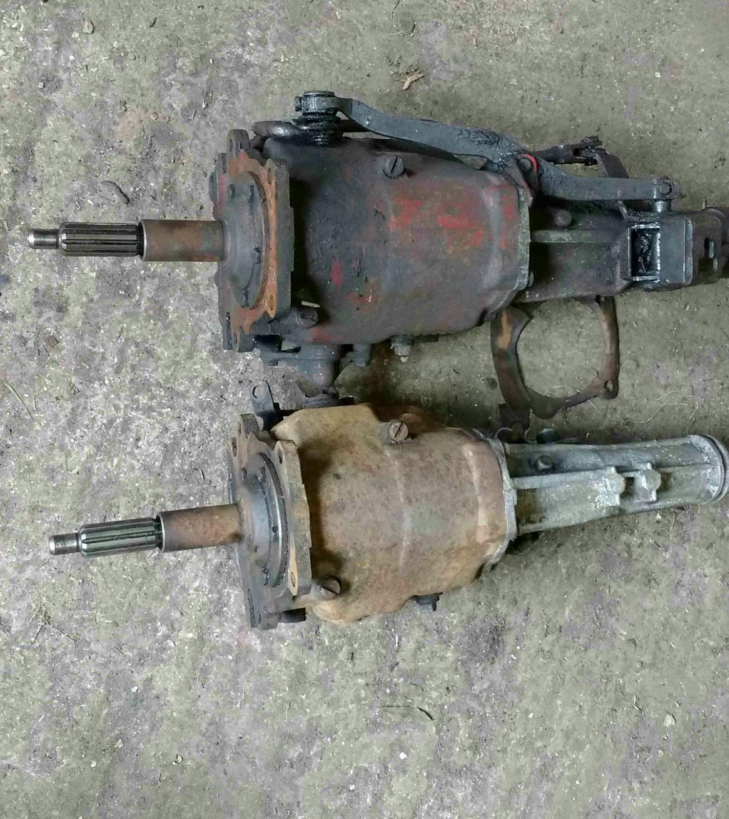

Last of all are the gearboxes, 2 X 4 speeds and one 3 speed. Here are the two types side by side, one is slightly shorter than the other so that's the one I'll use.

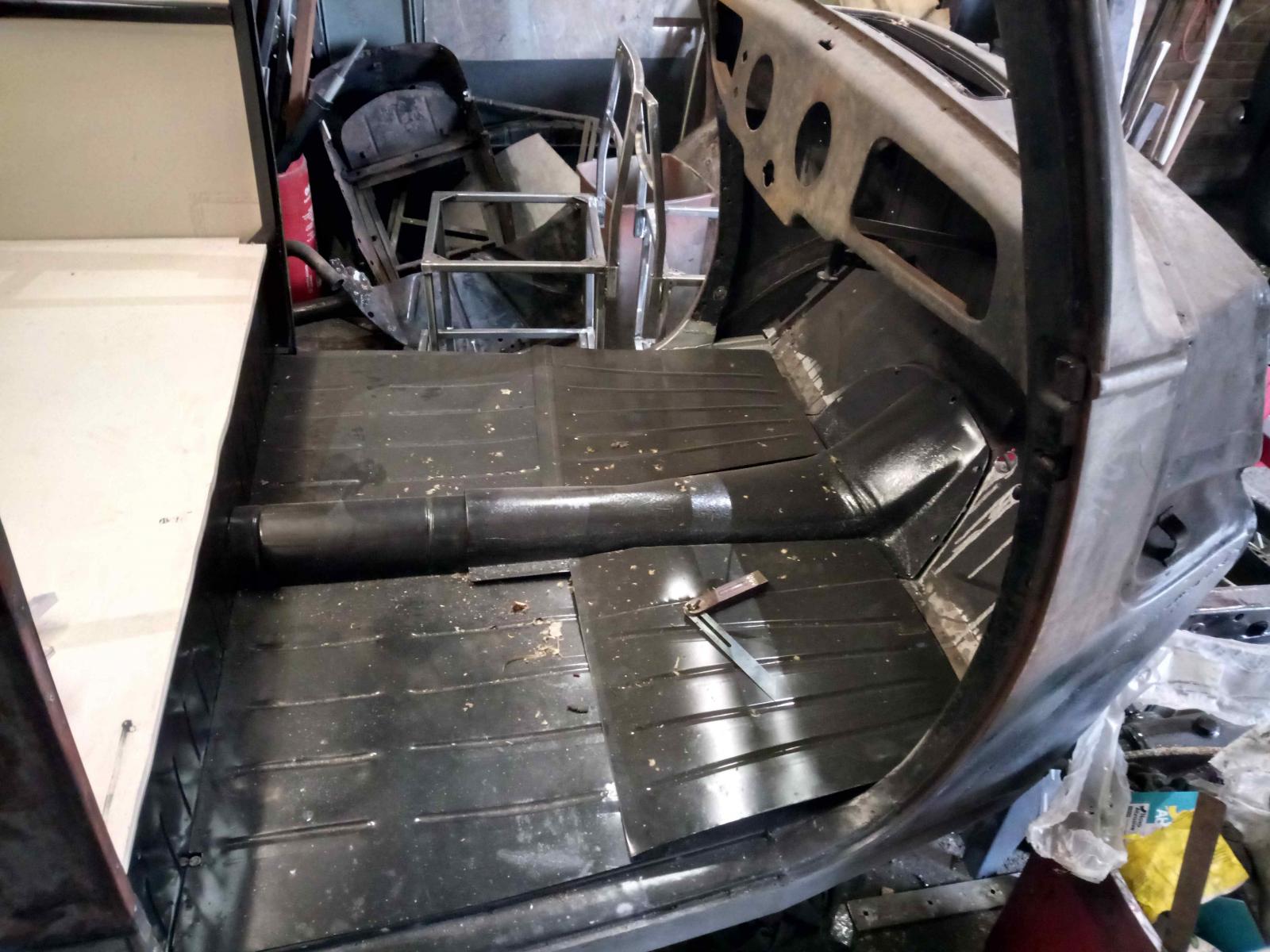

I've even made myself a bit of floor to bolt them to.
Almost forgot sills are done, they're now holding the floor up. I used some galvanised box section as I don't want to be doing them again when I'm 120. Also patched up are the rear doors and front wings- what fun that was.

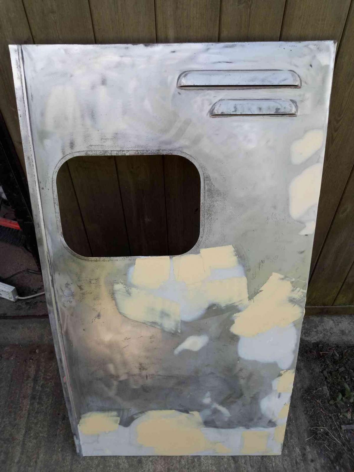

I remember being pleased that the rear door skins were only rusty at the bottom, but they proved to be so battered everywhere else that they needed a bit of filler. They also needed a metal frame as I burned the wooden one.
