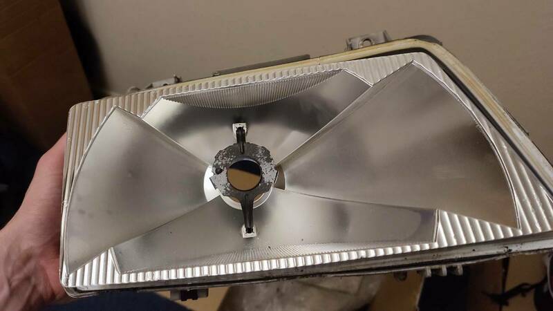

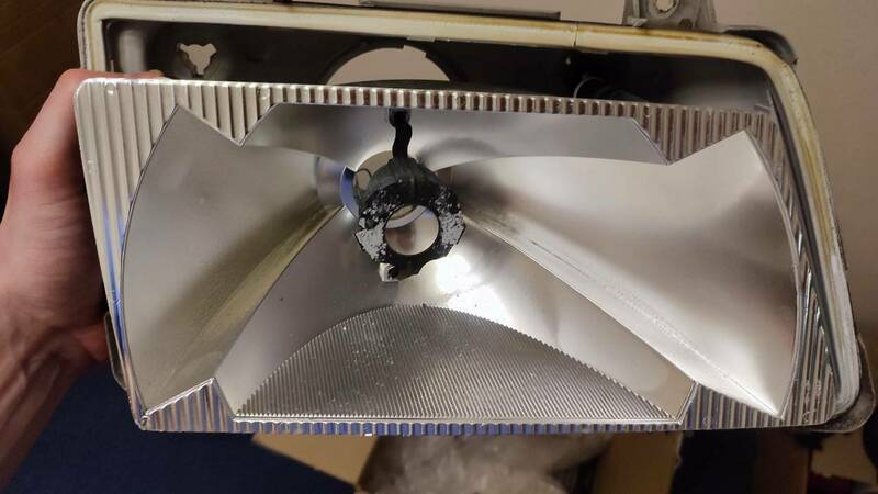

Old headlamps disassembled. As predicted, the plastic mirroring has dulled and has no real reflectivity at all. Any DIY ideas for restoration? Google is not massively helpful here.
Thanks. I guess as they're plastic it's a repainting job, not polishing/cleaning.

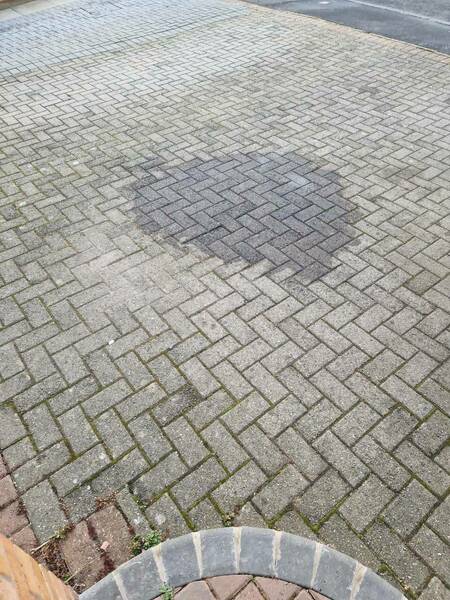

DIY Oil changes.... Oh Aye 🙄
@loserone has furnished me an AdBlu container..... Big n Square so *likely will get all the oil + filter dribbles caught now...

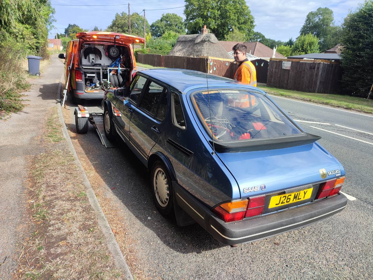

COMPETITION TIME!!! What is wrong with my car?
This drove fantastically until today. Driving back from holiday straight to work, 100milesish, the engine light came on flashing four 'blips'. Hard to tell if it was hesitating under load on the motorway, it was so potholed it was hard to tell what was just a bump, but I think it did VERY mildly every now again. Then almost at the end of my journey the hesitating became very bad, you know, put your foot down, car goes slower etc, clutch down to see what would happen... engine died... so coasted into a layby. Restart attempt #1 - car stuttered a bit - attempts #2 onward, nothing, just cranking.
RAC man suggested maybe low compression as he said it was 'cranking quickly' - not sure if this is the case as obvs it cranks quickly when warm anyway - and would this lead to catastrophic failure? He seemed to think there was a spark and fuel but this was determined purely looking at the engine - so maybe not the best diagnostic. Anyway, it's poorly, so any suggestions welcome on fixes... it's at the garage now anyway. The local Saab specialist sadly politely refused due to a very long orderbook and no space even on their yard.

Sounding like it has no compression / cranking quickly - it could be flooded. Pull a plug and see if is wet? It might fire up once it's cooled down again (before doing it again).
If it is flooded, on those 900s (and quite a few other injection systems) if you put your foot to the floor whilst cranking it helps it clear and it should start to fire. Might start firing on one before eventually picking up on all 4.
As for why it flooded, could be coolant temp sensor? I had 2 fail on my 900s, and an ignition module, which could also cause a FTP like above. It was only ever the Bosch parts that let me down!

Impressively fixed within a day - garage speculatively replaced coil, cap and rotor and it works again. Makes sense, I had really bad hesitation with my old Corolla and replacing these made it work again. Back to nice driving 😎 and they could get parts within 24 hours - result.

On 05/02/2024 at 20:52, red5 said:
Finally got round to using this to refurb the headlights, it works 😊
Not quite as good as in the videos (lesson: I think you need to apply it quite thick) but reflectivity is now good. Only downside is you can't clean your brush afterwards, neither spirits or water would get it off.
