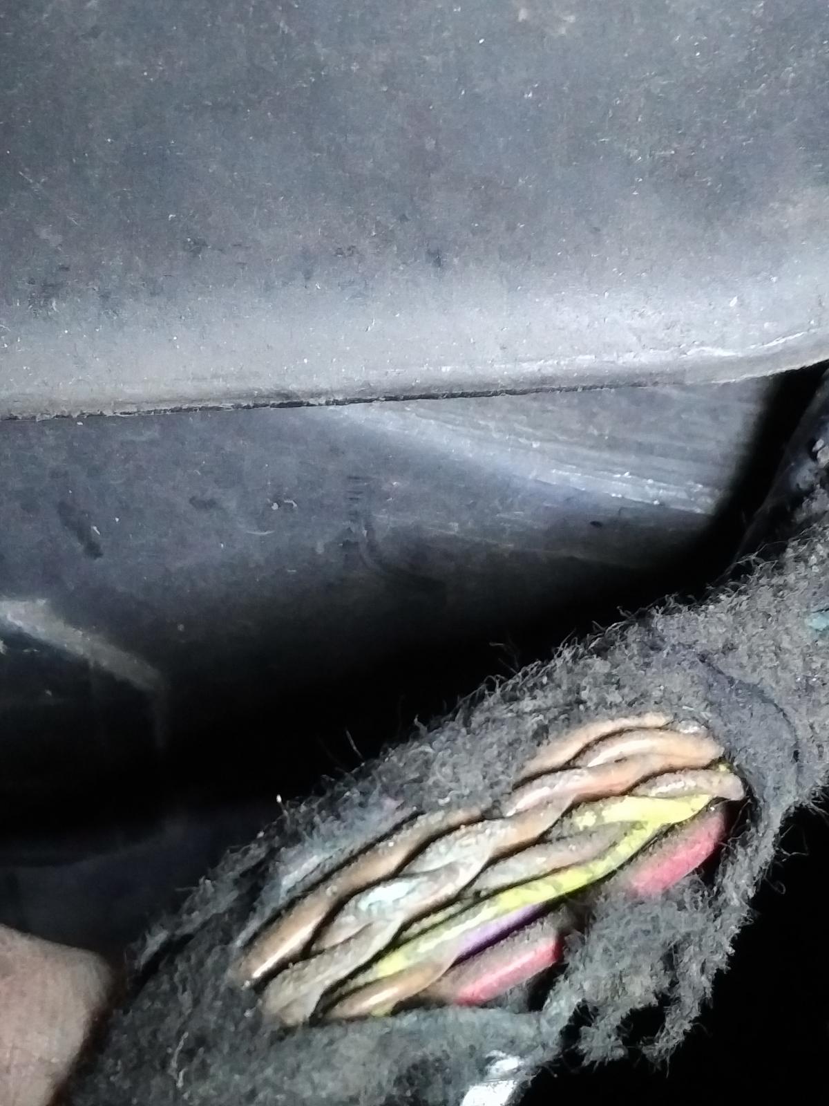

Found some time to look at the ABS wheel sensor fault today. The code is front left Wheel Speed Sensor and it looks like a new sensor is fitted. I managed to get a wiring diagram and wasn't able to get continuity between ABS controller and the sensor plug.
No problems under the wheel arch with the wiring so had a look at the ECU end. Air filter, battery and fuse box out to get access and release the ABS unit to get a good look at the wiring. As you can see the harness had rubbed through and then corroded the wire. Chopped out the bad wire and reassembled, code cleared ok.
The original wiring was by no means ideal, tight radius against a bracket and trapped on the plastic shielding. Most of the harness tails seem tight, maybe BMW wanted to carry over the charms of the original Mini, post Lucas days.

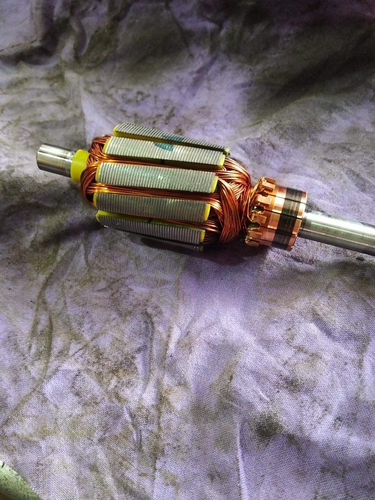

Also had time to look at the non-functioning drop glass. The suggested door card thump failed to breath life into the motor, however tapping the motor directly did bring success.
Regulator out and motor dismantled showed the commutator slip ring to be dirty, a clean up and reassembly did the trick, fully functional widow now.
