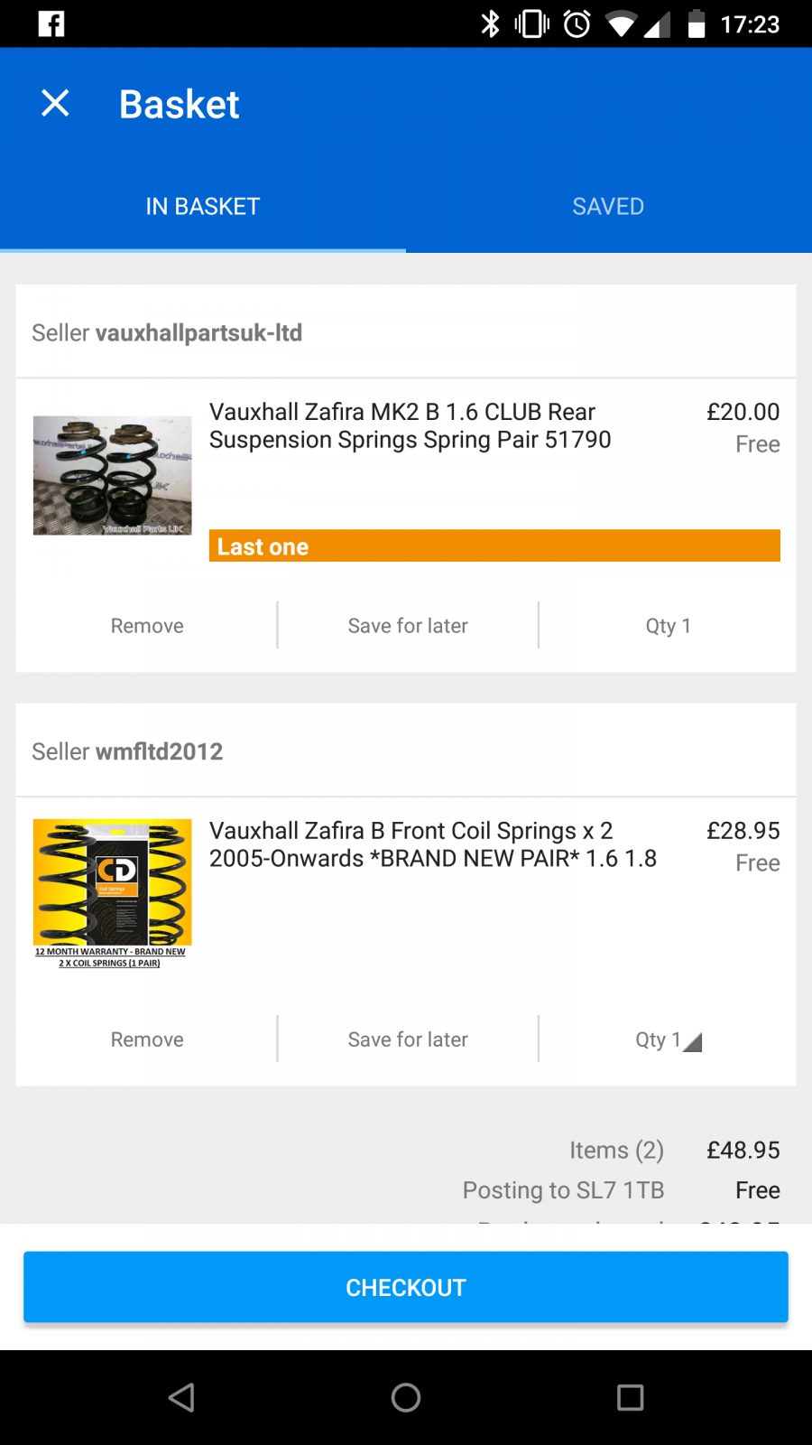

Why second hand rears? Because their very easy to change, and it'll get a ticket easier. The rears are bloody expensive new. The meriva had second hand rears years ago and their probably still fine now!

Springs ordered! £58 rather than £46 as I opted for some fronts that had a delivery date of next week, not the week after. Will drop into slowsilvers for the spring compressors on Sunday.
