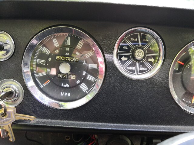

Several people have mentioned my warning lights, both here and on DW's thread. So here's some close up pictures of them.
By day.
By night.
And deconstructed.

Then I took a slightly extended drive home so I could achieve this.
That's 150,000 obvs. The car was on 64k when I bought it 23 years ago, so that's 86,000 with me.
