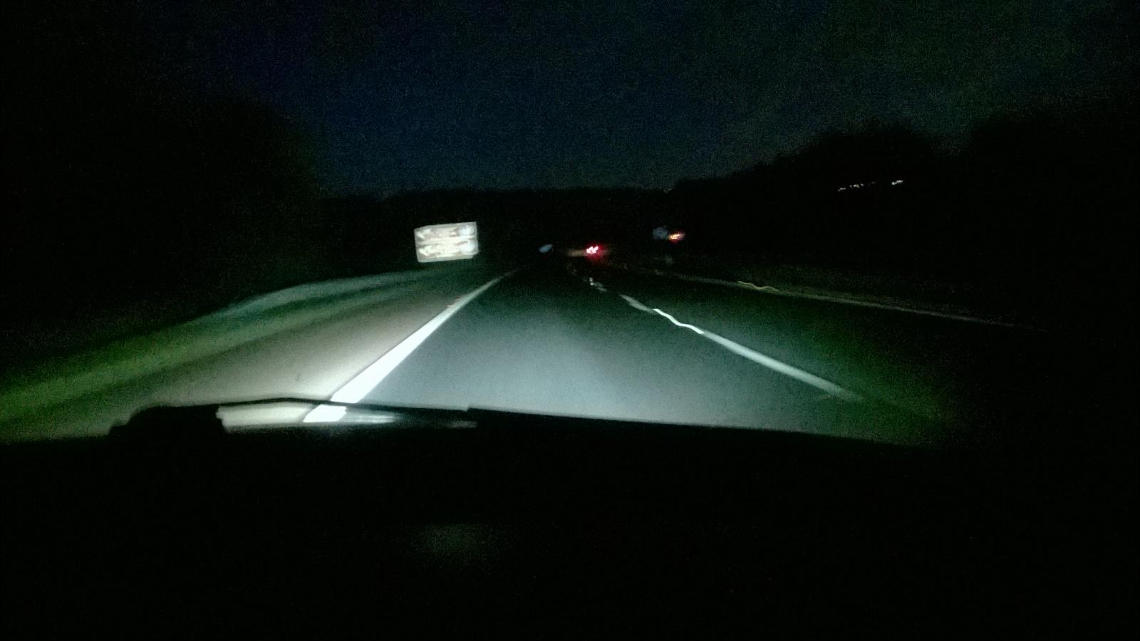

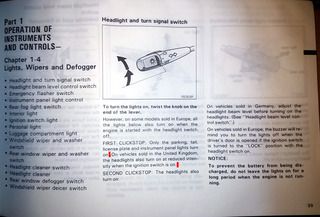

.... my dipped hlight come on (50% power) 'dim' with the Sidelights selected only.... then 100% dipped on next click.
never had a car do that :shock:
TS
TS
Have you not? I think it was standard on all UK market cars for a short while in the late 80s.
Is that "dim dip"?
I've not seen that on any cars I've owned though. Always had a separate sidelight bulb.
Is that "dim dip"?
...aye, I have a separate sidelight (very bright btw) in the wing corners... just never seen 1/2 headlight before :?
TS
I had it in my 1988 Nova

There's always been a separate sidelight bulb, but with dim dip you didn't get the option to drive on sidelights alone- and rightly so, because they are parking lights. As I recall it was made a UK requirement but the EU wasn't having it so it was quietly dropped. My 1995 Volvo 940 had dim dip, with the added bonus of not being able to turn the sidelights off either, but my 1996 850 doesn't have it.
Does a full Brexit mean dimdip will return?
Drop the PM a line and make sure there's a separate vote for that. I don't give a shit about free trade, but our bulbs are nobody's business but ours.
I had dimdip on my Disco, one of the first things I did was disconnect it. I'm quite capable of knowing how far to move the lightswitch thanks.

iirc dim dip was allowed to die a death as it cant/wont work with HID
