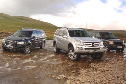

Loan paid up in March - thinking of a replacement - missus still wants 7 seats, I want 4x4 as well for OMGSNOKAOS up at Borwick and Kendal and the back roads in between. Whatever I buy I would like between 8 and 10 years of life out of it. Welderizing not an issue - mechanical apocalypse, however, is.
Current thoughts:
Ovolv XC90
Hundry Santa-Fe
OLLI Discovery 2 or 3
Budget £12K.
Anything else I shoudl be looking at - or NUNS & KITTENS death squad with any of the above suggestions?
LandRovers seem massively unreliable to me
XC90 look ace but isn't there a gearbox achille's heel with them?
Santa Dr Dre best bet?
What about a GL?
