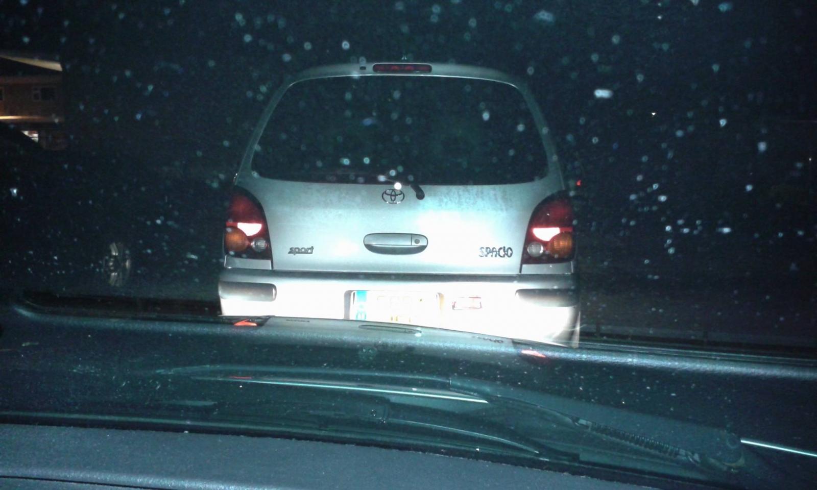

Recently spotted in a car park near me. Yet another Inappropriate use of the infamous Halfords universal 'sport' badge. Adds extra shiteness to any shite car and is also a waste of a fiver.

The badge on that Toyota Spacio has been applied much too well to have any effect on performance.
If it was to the right of the windscreen wiper or actually on the boot release, that would bounce off the rev limiter in every gear (1st and 2nd, anyway).
