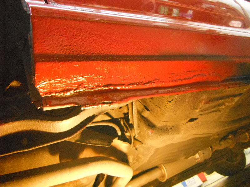

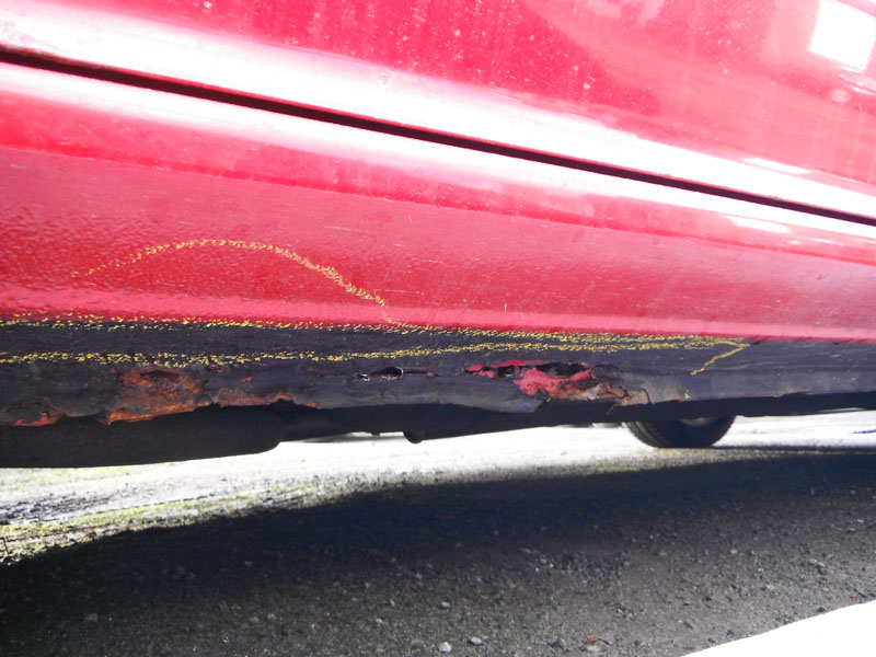

eddyramrod Posted November 14, 2016 Posted November 14, 2016 Not forgetting a glancing blow from me, when I won the roffle for it and sent Omegod to pick it up because he was in need... I still haven't had a go at it!
omegod Posted November 14, 2016 Author Posted November 14, 2016 Glancing blow or skilfull avoidance Eddy? I'll decide when i'm on my back at the weekend,in the cold rain ,knocking shit out of the trailing arm bush . eddyramrod 1

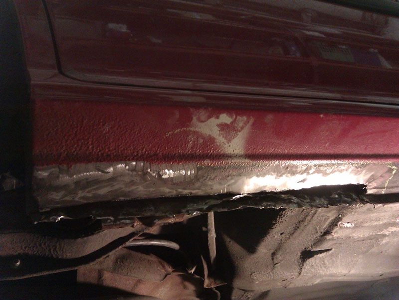

vulgalour Posted November 14, 2016 Posted November 14, 2016 If it's any consolation, that's the same area mine needed repairing in March this year and this is what happened: It was really solid behind what was on show so I wouldn't have The Fear in your situation. eddyramrod 1
