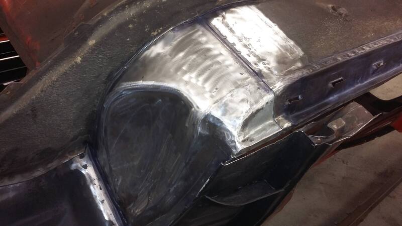

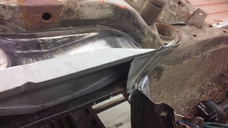

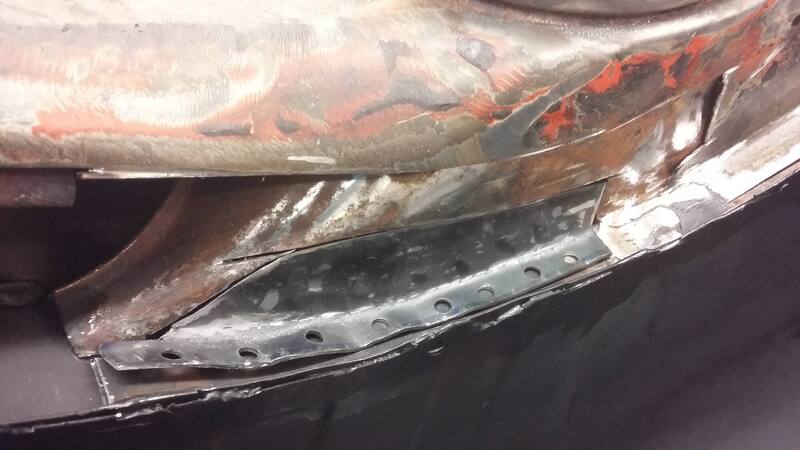

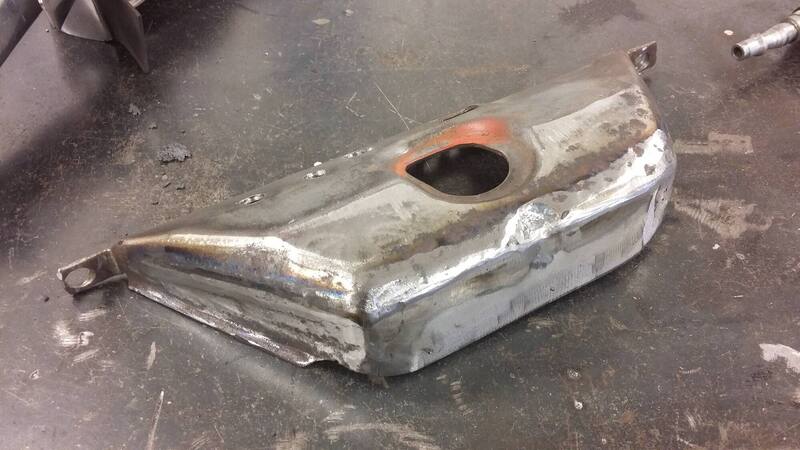

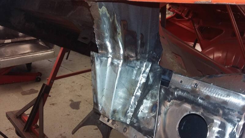

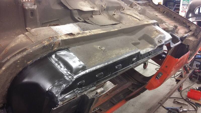

Completed the repairs to the rear chassis leg yesterday.
Started off with making a repair for the inner strengthener that supports the coil spring.  Again its all funny shapes so it can take quite a while to make up each repair section.  I'm using 1.5mm steel which is the original thickness for the chassis leg.  The thick metal adds extra time and difficultly to making each section.
20170520_112427.thumb.jpg.13c0840f16eb7a7170ea7a5ff410ea8e.jpg20170520_120405.thumb.jpg.3ab9d85277ffed6ef5bba03d81d3719b.jpg
Once welded in I finished up with the power file and a roloc disk.
Next was the end of the rear section that laps under the section i'm repairing.  This one was fairly quick to make.
Finally the big bit which took quick a while to fabricate.  I made a template from cardboard and copied it onto the steel.  Once it fitted I clamped it to the chassis leg and then beat the flange down to the correct position so it can be welded to the floor section that I replaced last week.
20170520_143701.thumb.jpg.77c51872ef0c1b1db64c7b5483160361.jpg20170520_144122.thumb.jpg.d524c63f5c50acc4cc9fed5bb7f15316.jpg

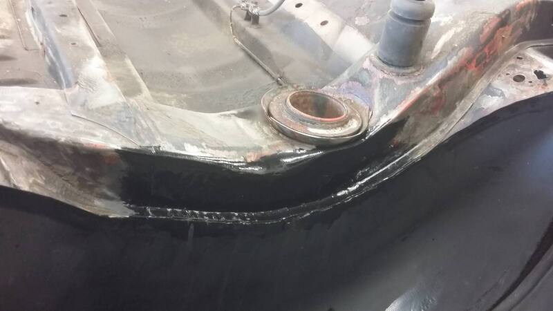

Plenty of welding to make the leg strong again including puddle welds to the inner parts.  This was originally done with spot welders in the factory before the leg is attached to the floorpan.  I've also painted inside with POR where I can.
With that complete I ground the welds down and painted the repair with POR.
20170520_160036.thumb.jpg.c267ddc1eda20460169bea049655b2ad.jpg20170520_160045.thumb.jpg.62d5ec22599c29124faa2d019a436f7c.jpg
Next I'll clean up the surrounding areas towards the boot floor and paint.  Later I'll drill a small hole in the leg to allow for the repair to be waxed and protected from the inside.  The other side of the car has a hole in about the right place so I'll mirror it on this side.

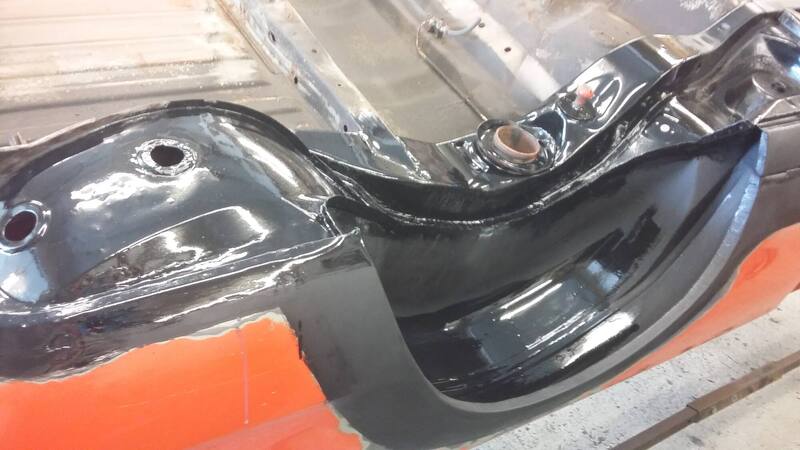

With the chassis now repaired I moved onto the smaller jobs to finish the area up.  First was to get rid of any remaining paint and underseal.  I removed the bump stop to prevent it from getting damaged.  Easiest way to get one of these off is to lubricate it and then pry it with a big crowbar.  Mind your head when it flies off the car!
20170527_092755.thumb.jpg.113ba2c8871365fb85bfe115627e4477.jpg20170527_104956.thumb.jpg.3fd9824baa96c85065c2f2bb2e7ed1bf.jpg

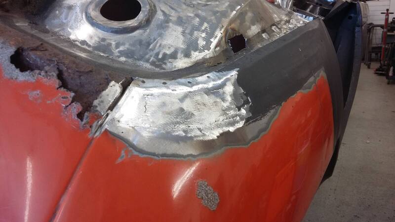

I repaired some small areas and applied rust treatment to some of the scabby areas.  This stuff goes black once it completed converting the rust, you then rub the area back and paint.
I also knocked the dents out of the spare wheel well and repaired a small area that had gone through.
I also completed to repairs to the bottom of the rear quarter panel.
20170527_120706.thumb.jpg.cb3f3a749418a56c5abfeb937e206f77.jpg20170527_124147.thumb.jpg.397a089d345a5ab8c55916ba04bc4268.jpg
Then a coat of POR to finish up.  This completes most of the underside work for the drivers side.  Once I complete the passenger side and do the rear valence thats most of the metalwork completed.

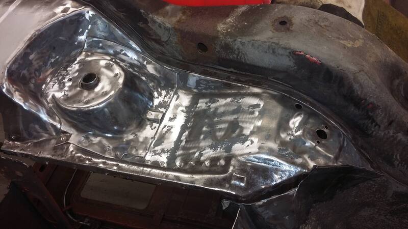

Started off today with grinding some welds and cleaning back the spare wheel well inside the car.  I dug out the old seam sealer and applied rust treatment to various areas.  Did the same underneath and luckily didn't find any further rot so these areas have now been painted.
20170603_104351.thumb.jpg.409ad1bdbf06dac7596cf366a300aabf.jpg20170603_112353.thumb.jpg.c871d8a6c3061da7b14268dcd2dba7ea.jpg

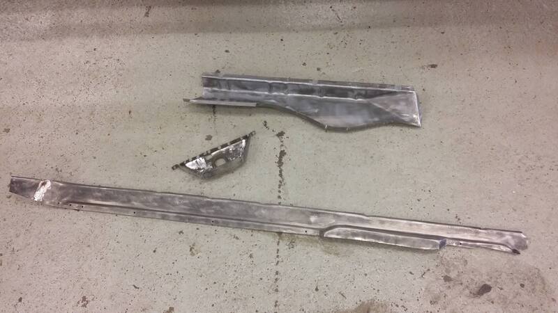

Back on the car I've been removing many bits of rusty metal from the passenger side sill.
Lots of spot weld drilling, hammering and cutting being very careful not to damage the rest of the car too much.  About 8 hours of work to unpick and remove all the various bits.
20170608_105715.thumb.jpg.a6163617da64fff2d9a9b609acdd77ce.jpg20170608_132626.thumb.jpg.44c36066088c53dfabd976c42871ecb3.jpg
Cleaned back various places along the way looking for holes or heavily pitted areas.
20170608_170812.thumb.jpg.98f45726bd7fb43041245163cab85ab6.jpg20170608_170758.thumb.jpg.dfe98a290dc14723293e1fe03c125da6.jpg
These are just some of the bits which are all for the scrap bin.  I'm now ready to start repairing the various parts of the floor and can then begin fitting the replacement sill.

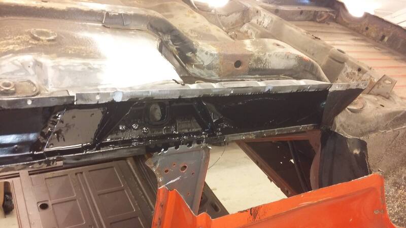

I'm working my way through the various repairs to the floor and bulkhead in preparation for the new sill.  This side is in better condition but theres still quite a bit to do...
First I repaired the floor where the rear outrigger is mounted.  This is a common rot spot which usually needs attention.
Up front quite a bit of the floor edge and bulkhead is missing.  The inner sill sits here and the small cave inside rots out underneath and eventually goes through the floor.
20170610_131009.thumb.jpg.026b20a085a4a66c99ecf3dd8c66cf5c.jpg20170610_132051.thumb.jpg.d45f4c2b44a0a4ab56e4b1daf5b3ccb1.jpg
First I made a new end for the floorpan and welded it into place.
20170610_143118.thumb.jpg.dd33782966679ac6279e9f28cad159bd.jpg20170610_151036.thumb.jpg.7f3c24510f12dd8ece576d2d3d98480d.jpg
Next the bulkhead corner is remade using whats left of the original as reference.  Quite a difficult shape to remake so a few hours where chewed up doing this.
Finally I replaced a section of the floor flange which will be spot welded to the new strengthener and sill cover.  Next thing to do now is sort out the wheel tub/ closer which is quite heavily pitted.

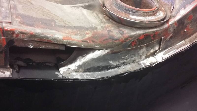

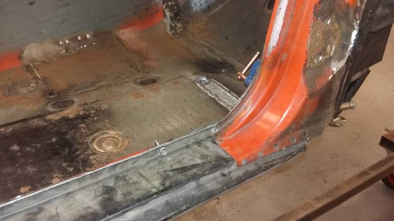

Today I completed the repairs to the floor on the passenger side.  Started off with a small repair where the front outrigger goes and also cleaned back the bulkhead to check for any additional rot.
20170624_094311.thumb.jpg.3022b2c761c7213edeff7155f5d4f061.jpg20170624_104250.thumb.jpg.a86c46a6691cd527b60ff365cd63ba5e.jpg
Then I moved back to the the bottom of the wheel tub where it links up with the inner sill.  It doesn't look too good so I removed it and set about making a new bit.
20170624_110210.thumb.jpg.3737ec17910aba2b0cc9118f60f7a5cc.jpg20170624_114555.thumb.jpg.c01c10851961effbbcbb1fdb42dbc364.jpg

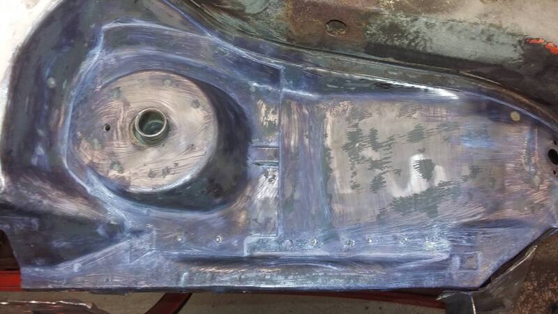

I also took this area back to bare metal and rust treated to sort out the various small blisters and scabs.  I did the same to several other places.
20170624_115944.thumb.jpg.c5e046b7ab7526284bd12dd100d1a3c5.jpg20170624_120845.thumb.jpg.88679d2335e8fafd15b0e63efdafb880.jpg
With a new piece for the wheel tub made I could now start trial fitting the inner sill.  Plenty of adjustment and hammering was done as these panels are not brilliant.
20170624_150437.thumb.jpg.17be32a942543f51c6ed4f5d13328680.jpg20170624_150419.thumb.jpg.334fbcd7142d28c43f149e6d32bb3d33.jpg
Happy the floor is repaired I wire wheeled off any excess rust treatment and painted with POR.  Next time I can trial fit the entire sill and check for alignment with the door before welding.
20170624_154054.thumb.jpg.fad54c6442b59d3bdb89a590fc371f08.jpg20170624_154113.thumb.jpg.ef8b700b1ebd595648d6f77e64ff14e7.jpg

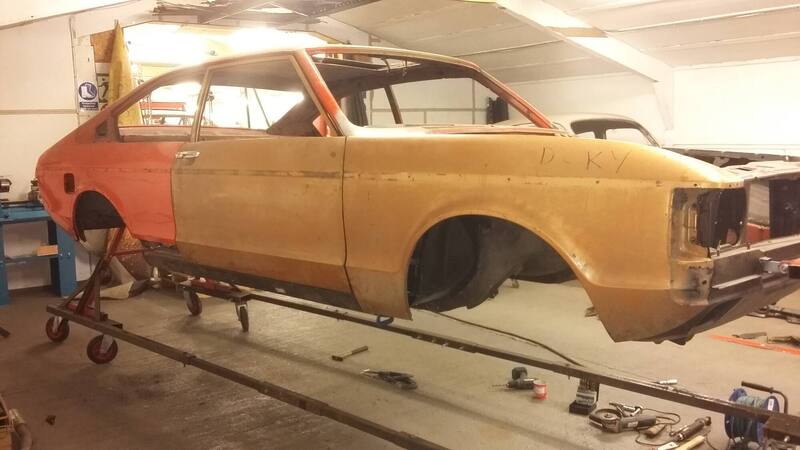

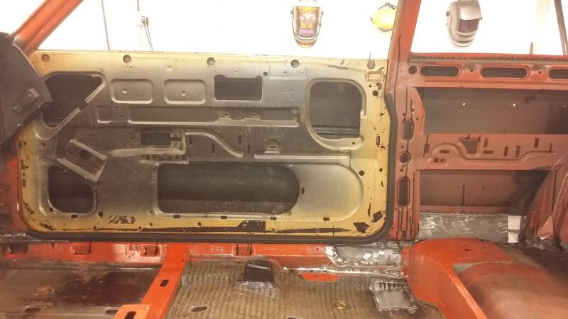

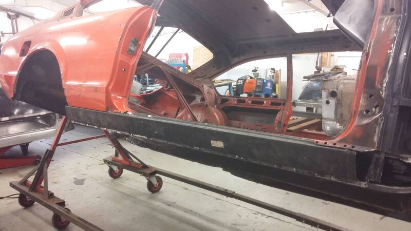

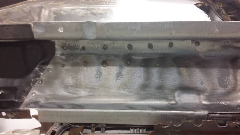

Today I was able to trial fit the complete sill assembly on the passenger side.  I placed the various panels onto the car and fixed in place with screws.  I also bent up the leading edge of the inner sill so it meets the bulkhead.
20170701_105459.thumb.jpg.343ddb35af22e3f45dd202f2c5e02f73.jpg20170701_105524.thumb.jpg.483b3e5dd75a051363292cb183a8f2f3.jpg
As the panels come together it becomes obvious that some will need assistance from the hammer.  Took a little while to get this one right as its quite a tight fit.
20170701_105540.thumb.jpg.1122032bde1b2ff3bcb80a4d3f8311e7.jpg20170701_114820.thumb.jpg.0caf0c33abaa64e60756760a5210978f.jpg
With everything screwed on I can then roll the car over and begin to fit the door & wing to check I've put the sill in the right place.
Looks promising as the A post and B post look about right.  Things also look level when looking down the car.
20170701_133312.thumb.jpg.de089f974deaea6fe273e22eb1c7dc49.jpg20170701_133328.thumb.jpg.bd958607a578c204612ff75b464a3096.jpg
So I grabbed the replacement door and wing and they bolted up without issue.  The gaps are looking sweet with the door needing to come up a fraction at the rear.  Crosschecking with other Granadas we have in the workshop confirms the gaps are about right.
20170701_143805.thumb.jpg.287d880208f2f66278461a5e52521eb1.jpg20170701_143824.thumb.jpg.f1b38a4665d2557386c1884a836f3edb.jpg
Next I removed all the old bits of sill from the rear quarter panel section I cut off previously and slotted it into place.  Again things are looking good with all the original parts of the car sitting where they once were.  This confirms I've got the new parts in the right place so next time I'll remove everything, clean & paint the new panels and then begin to weld them on.
20170701_155008.thumb.jpg.3a9583b80de05a062179092bfea7f962.jpg20170701_155150.thumb.jpg.300b03d7000fcc68846c13d83e065d25.jpg

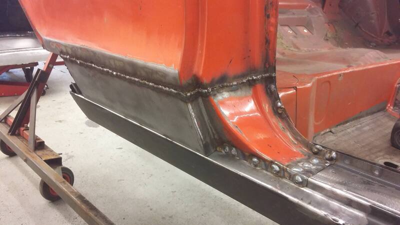

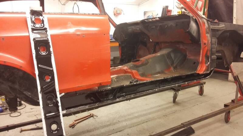

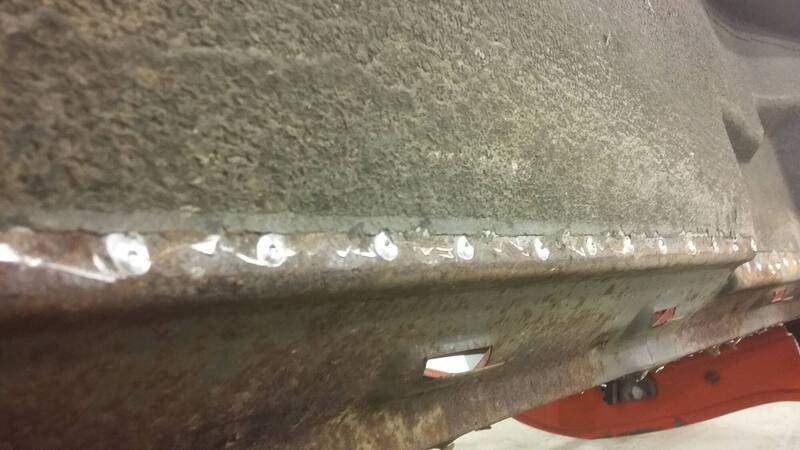

Very hot today but managed quite a bit of progress on the coupe.  First I repaired the jacking point as it had survived much better than the one on the other side.  It only needed a small repair at the bottom.
20170708_091756.thumb.jpg.d4269e09a431140e6251f34f2366f905.jpg20170708_100418.thumb.jpg.f1af4b0fe3657195a8924709a64e2f4d.jpg
Next I took the new inner sill panels back to bare metal so they can be welded on and painted with some POR.
I then screwed them back onto the car and began spot welding them into place.  Making sure all the seams are super clean is very important when using the spot welder.
20170708_130920.thumb.jpg.5f9e3ddecca430a0e93c6c60720ff9cc.jpg20170708_141616.thumb.jpg.a5e6c80d5619e5ee4a5a9983d45de833.jpg
Then the jacking point is put back in and puddle welded through the holes where the spot welds on it used to be.  It needs to be strong so I made sure all the welds penetrated well into the new panels underneath.

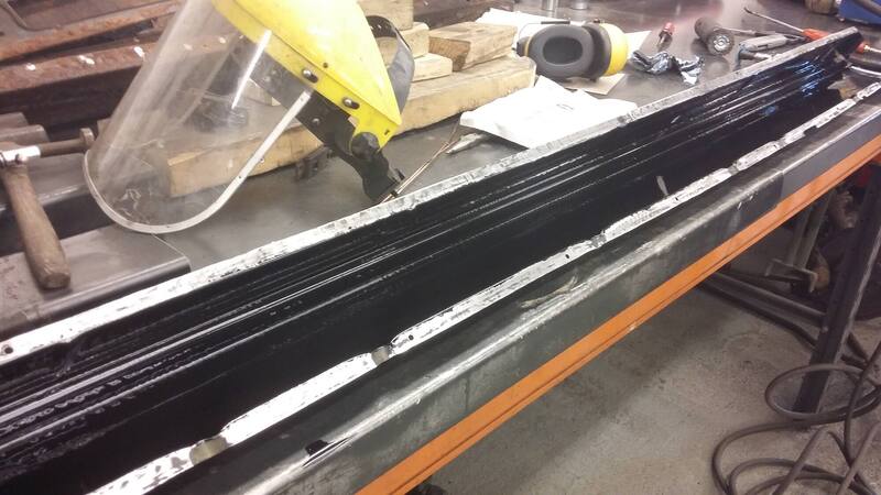

Now for some paint.  I covered everything that will not be accessible once the strengthener goes in and also put in a bead of tigerseal to protect from water.  I also painted the inside of the strengthener.
20170708_152000.thumb.jpg.f01433cacafeb8ab0d7efd8b07749af3.jpg20170708_152006.thumb.jpg.6d4967c6d86fbea4352dd8e6e6c02ec8.jpg

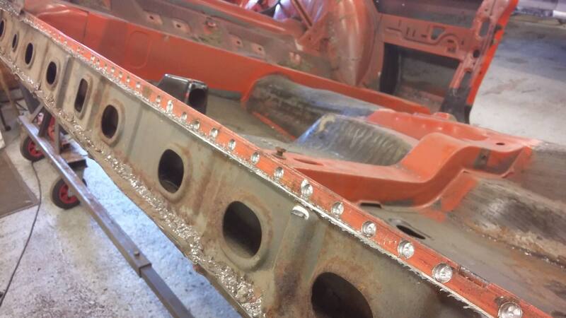

Happy everything underneath is done I spot welded the strengthener on.  The spot welder weights a ton so it was quite hard work but the end result is very neat and tidy.  Doing this when the paint is wet allows it to run into the seams as the spot welder heats up the panels.
Thats as far as I could get today so next time I'll be putting the bottom of the A post back on and sorting out the outer wheel tub/sill closer.  The sill cover can then be fitted and I'll cross my fingers that the door still fits properly!

Managed a full 8 hours on the car today.  Started things off with the sill closer/outer wheel tub.  Its much easier to fit this before putting on the sill cover, a mistake I made on the drivers side.  Made up a template, cut some steel, bit of folding and job done.  I also painted and sealed the area ready for the outer sill to go on.
Next I took the sill cover back to bare metal and painted the inside ready for installation.
Then I screwed it back onto the car and did a final check for door alignment.
20170715_120414.thumb.jpg.17da340b6cf9dd723ca931f6d20732ee.jpg20170715_121338.thumb.jpg.aa45b1f5c24b7af62d2e55d09015b854.jpg
Happy the gaps are good I got the spot welder out and spot welded the cover on.  This takes time as the spot welder gets very hot when welding through 3 layers of steel and has to be left to cool between welds to avoid overheating.  You can just about see the drips of POR that have run into the seams as I've worked my way along with the welder.  Should provide years of protection.
With that done I cleaned up the rear quarter panel section and welded it back in.

Heres just some of the stuff thats in at moment...

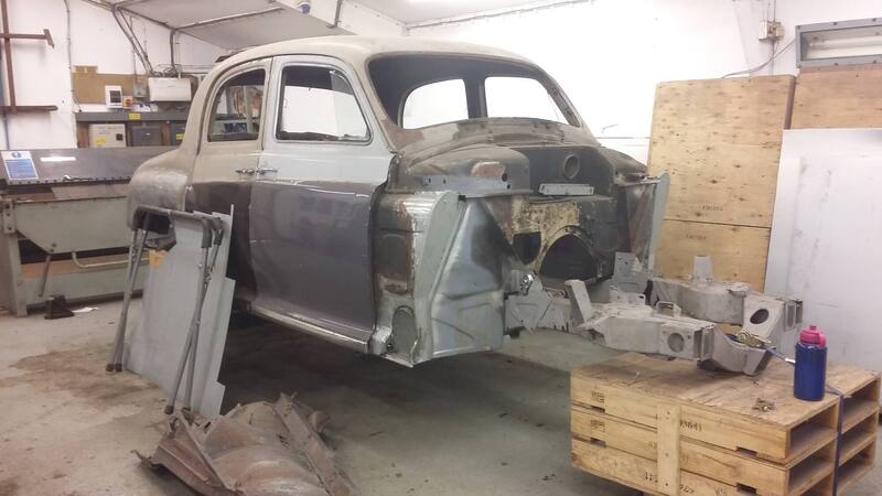

Rover P4 - Very bad condition when it came in.  Total mechanical overhaul, new A posts, sills, floor sections, rear wings, front wings, doors, wheel tubs and valences.
20170711_135308.thumb.jpg.784d52a94f9df86eb57369604eb016af.jpg20170606_172631.thumb.jpg.2310c57df19e4bd475693ca8615a62b9.jpg
Austin 16 - Even worse than the P4
20170606_172542.thumb.jpg.a530e4ae97329aa186c7be9c4546589d.jpg20170615_165008.thumb.jpg.bb3ca8a48d3a44419c0c14476fb8b58e.jpg
Datsun 240z -  Even worse than the Austin
20170606_172504.thumb.jpg.680b12216c808dcccce6f369640739eb.jpg20170525_170921.thumb.jpg.8c161dd15e3d84fdb5ea2126db118f26.jpg

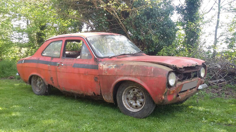

Escort Mexico - Right on the edge of being unsavable.  The floor pan on the drivers side fell out on route back to the workshop and none of the doors will shut.  Our head fabricator gets the joy of sorting this one.  I certainly wouldn't fancy doing it!
Just as important though is how the car is treated once finished.  We can only put it back to how it was when it was new with added paint and waxoil.  It still has all the rot traps and design flaws so keep it inside if possible and only take it out when its not raining and there's no salt on the road.  If left outside do not put a cover over it, much better to let it breath.  Covers make shells sweat from the inside out rapidly.
