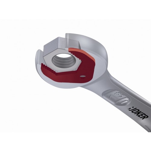

You can get wera ratchet spanners designed with this sort of fun* in mind
Ive got a 10 and 13 milly but i havent tested this function yet, I bought the fuckers to get at an awkward 10mm bolt on an BMW waterpump thats ''impossible'' to reach according to some, In the end a tiny little hilka spanner got it working blind.
