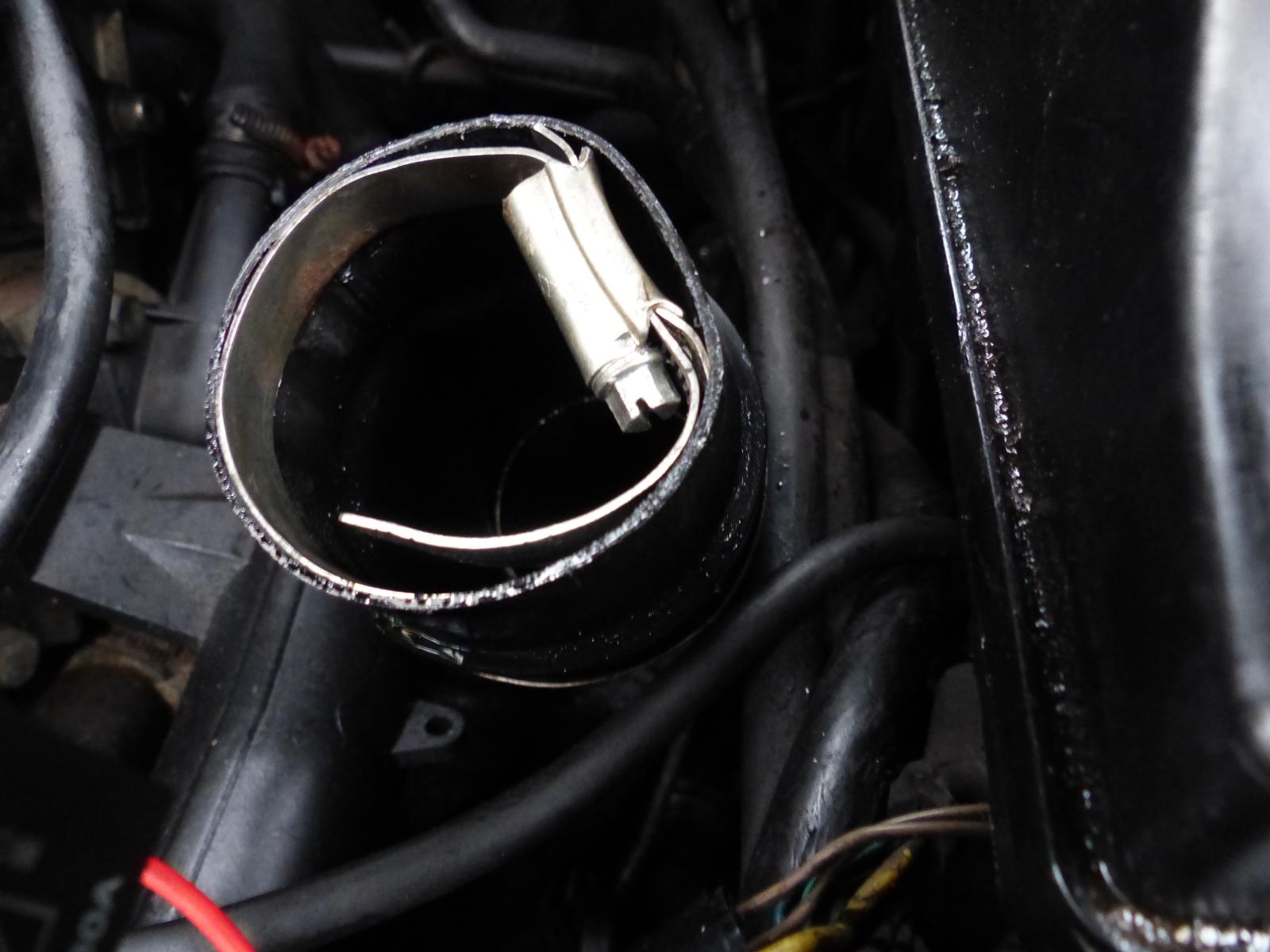

There was a goodly amount of whistle whenever the turbo woke up on mine, which I traced to a collapsed section of the plastic intake pipe - it had gone from circular to roughly heart shaped and so there was always a good proportion of the air sucked in to the turbo that was not coming through the air filter at all, but from the gap in the pipework. Bearing in mind that the turbo is almost brand new, I'd rather not lunch it with unfiltered air, so I ummd and ahhd about how to resolve the leak, and ended up doing this:
I know it looks like a recipe for disaster, but I'm satisfied that this type of jubilee clip can't self destruct into parts that would end up in the turbo. It holds the pipe in shape, allowing sufficient tightening of the rubber pipe that goes over it, with another jubilee clip. And it's banished the whistle, so I'm happy that all the air is coming in through the filter.
There's still a satisfying whoosh whenever it's required
