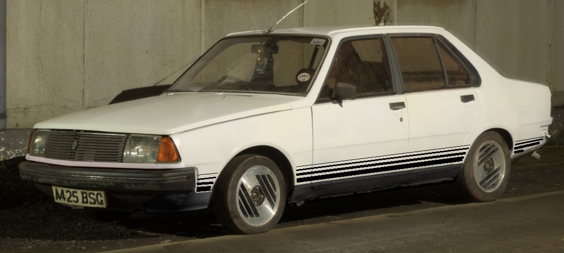

Also got the brake lights kinda working so it's almost ready for the road!
Many moons ago me and FOAD explored an old hospital that was also once a motor spares type shop, we found in a damp cellar a host of 80s car graphics many of them were knackered due to water but we manged to save a few, one of them was a roll of black stripes.
Im thinking of fitting these to the 18 and ive mocked up a picture of it, yay or nay?
15724581_1094746760647988_19572332726751

15672839_928185927315153_273660658542361
I like those stripes, though how about the other way up, just above the black sills?
Like this:
Crikey, I'm impressed with myself there! The stripes really suit the wheels too.
They both look like special dealer editions, which is no bad thing.
