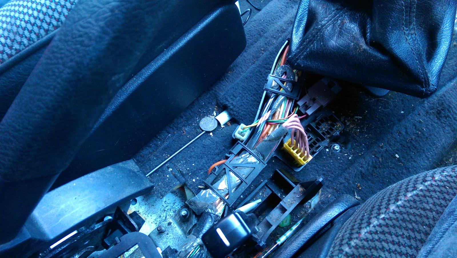

So this morning, I have been out to have a look. The first thing which was hopeful is there was 20p stuck by the handbrake
Praying to the shite gods I removed the switch, broke it open and cleaned off the filth from the contacts and... Nothing.
I even bridged the connection to put the light permanently on, but still nothing (tested with the engine running)...
This upset me, as the haynes guide for stripping the dash to get at the bulbs looks scary, and it's too cold for that today. So I put it all back together and will hope it fixes itself in the week, I might hit the dash a bit too incase that sorts it.
I went to look at the squeaky climate control sensor but couldn't remove it from the dash as there's a massive multiplug plugged in, so will fire a squirt of contact cleaner in at some point and see what that does.

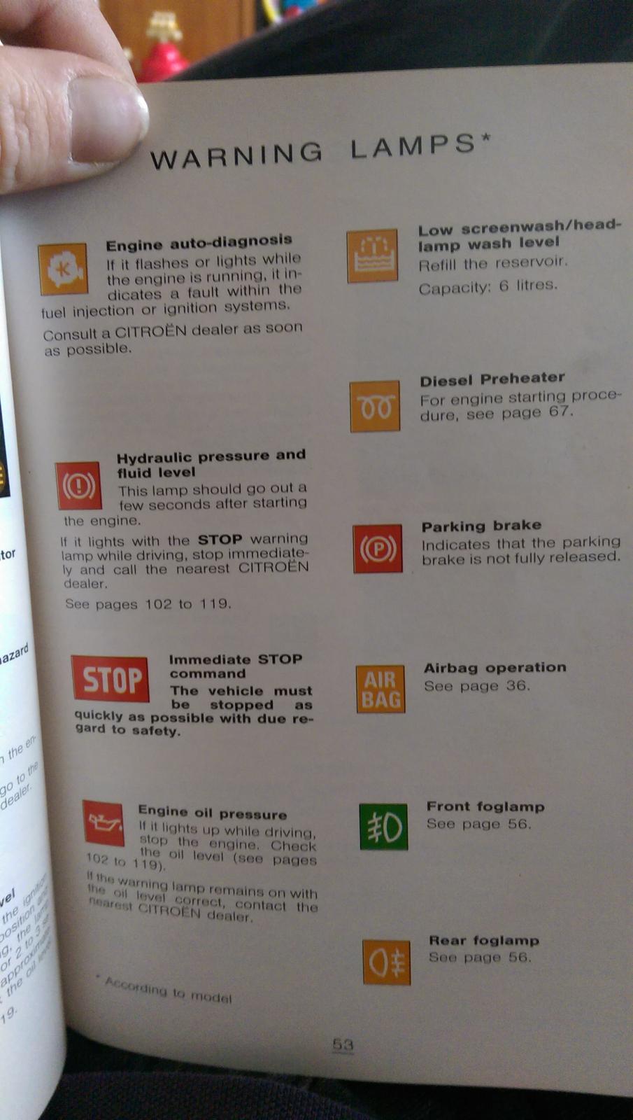

It's a Xantia, it doesn't have brake fluid. I think there's another warning for the LHM being low.
^ That's a good point. Does it have the usual cit/pug "STOP" warning on the dash, and does that light up with the ignition? If so, you can ignore the handbrake light problem.
Yep, big stop light, beeping and another warning light, which actually may also be the handbrake light, I shall consult the manual in due course.
So no links to brake fluid, because there isn't any brake fluid! Just no light when I pull the handbrake up.
Ill confirm with a browse of the book over lunch, I'm now doubting if it's the same light that does the handbrake that comes up with the stop light now
Here we go, on the rh side, I don't have the P light anymore
But I do have the hydraulic pressure/level and stop lights
Wonder what other warning lights don't work due to bulbs? I should really do the lot, but sod that in this weather, not really the attitude I know but still...
So it looks like I should be ok?

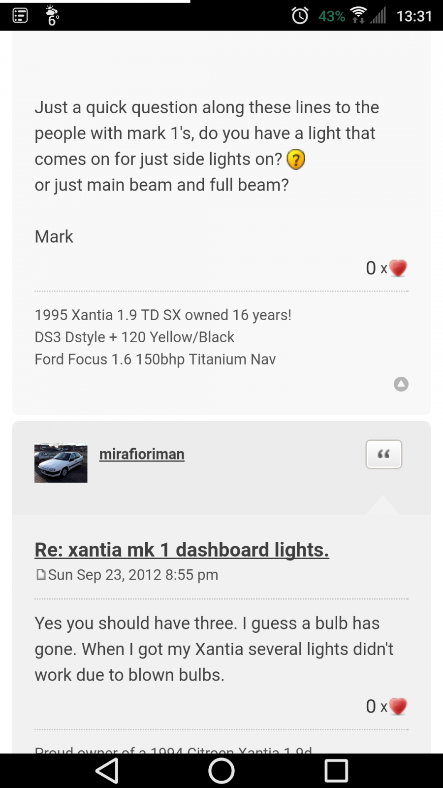

I have never seen this warning light before, and I've driven with no screenwash as it started to stink so I drained it then forgot to fill it back up and drove
My experience of removing stuff in cars with bulbs in, the act+shock of removing the thing makes the other aged bulbs blow too. So if you are going to pull the clocks out, I'd replace them all. Literally everytime I remember removing something, it has popped a few. This is why the climate control display on my Saab is a bit dark at the moment... :(
Also not least if you replace only a few backlight bulbs, you get some of it really bright with fresh bulbs and other bits very dim.
That's the plan I think, there's a how to guide on the French car forum which says what and how many bulbs I need. Half the red counter is dark too, luckily the half that I don't go into very often. And the fuel gague but that comes back depending on road surface...
Ha make that 4 dead bulbs at least
I've never had the side lights causing a dashboard light to come on!

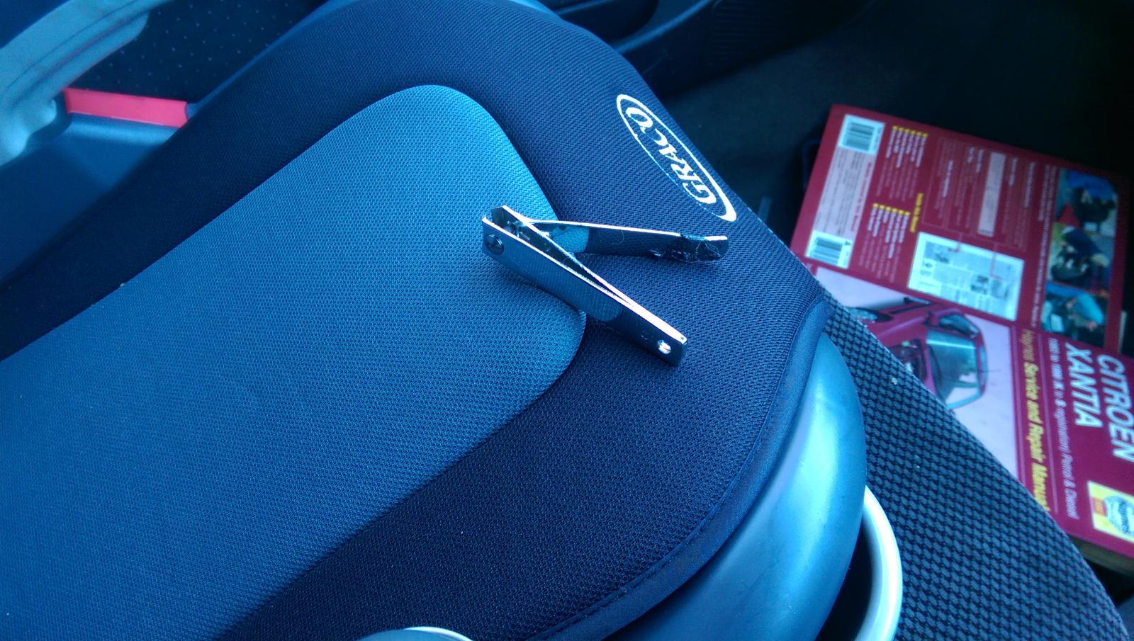

O yea, and whilst having the centre console out I found a massive pair of nail clippers, anyone on here?
They seem to have been used for spreading sealant somewhere!

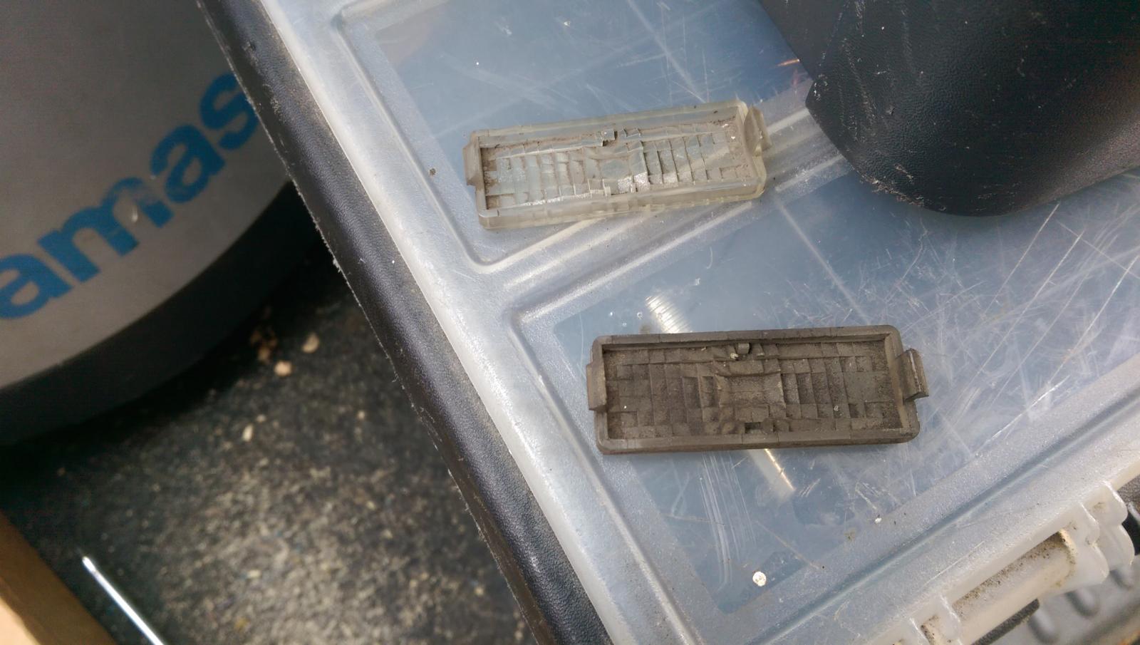

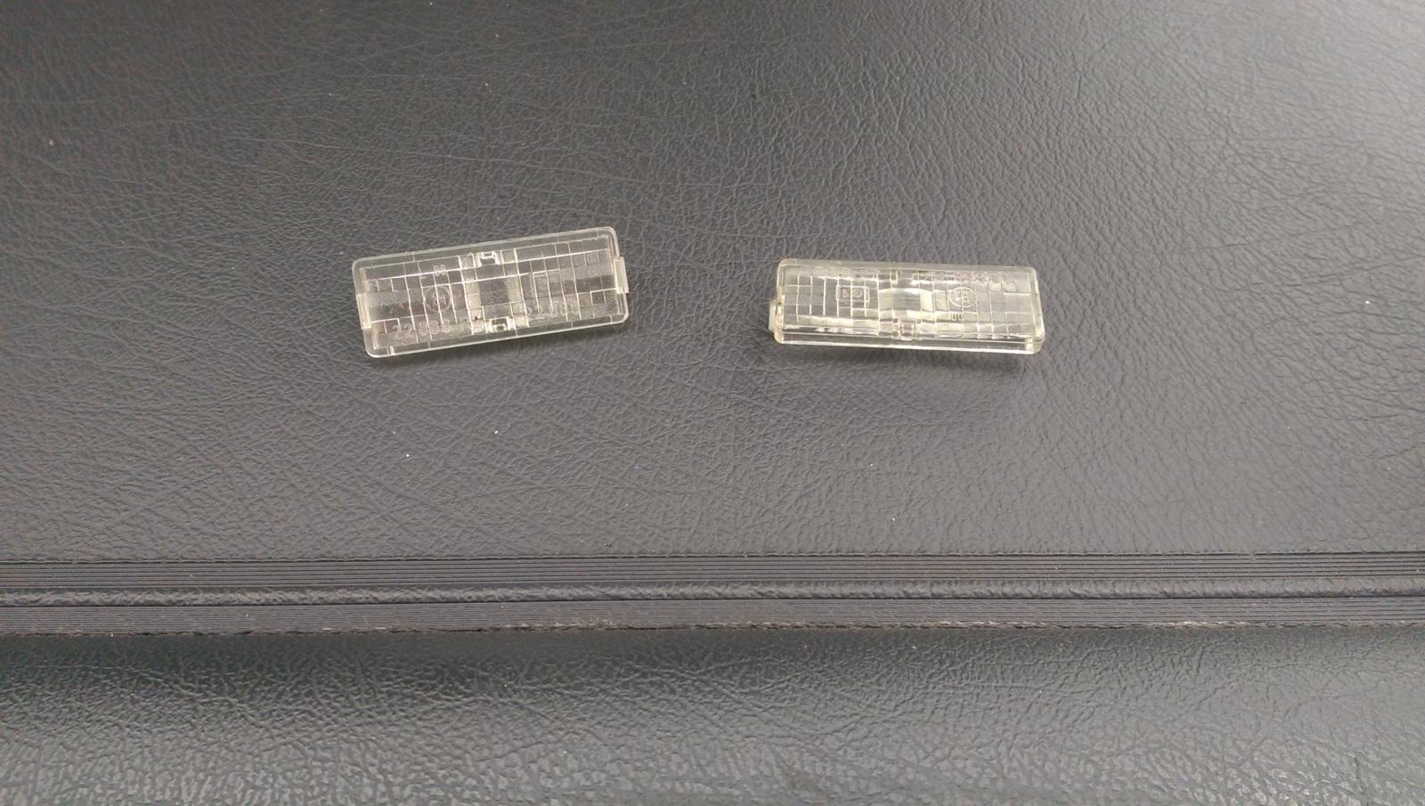

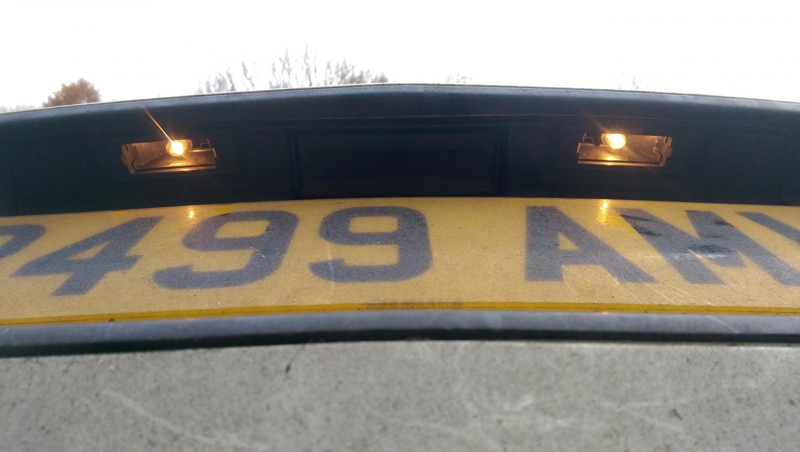

One of the number plate lights didn't, so I took the bulbs out, which were fine and put them back in. Voila! Light
The lenses were a bit mucky, so I bought them in and soaked them in hot water and washing up liquid

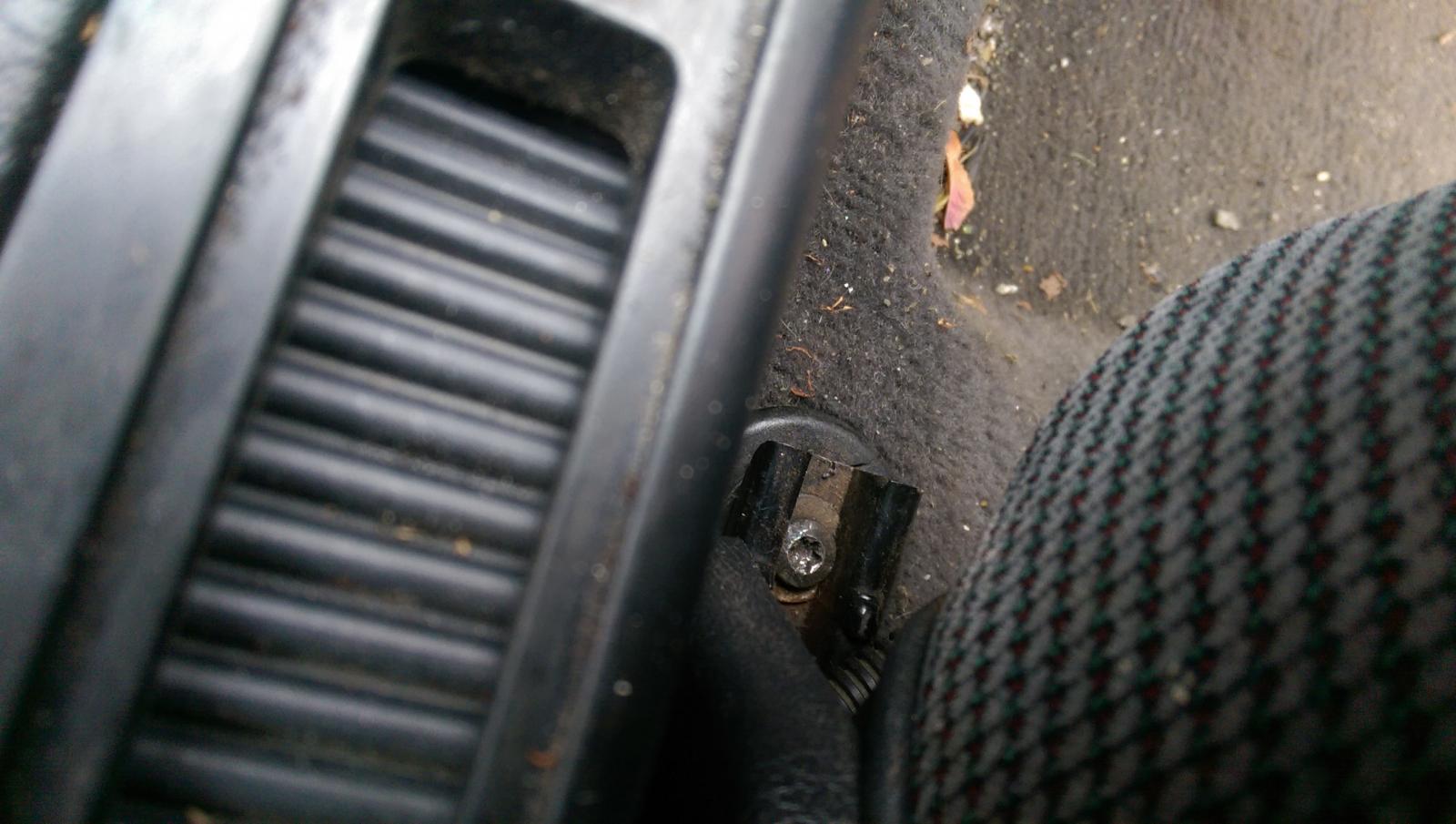

On a roll, I tightened up the loose seat bolt

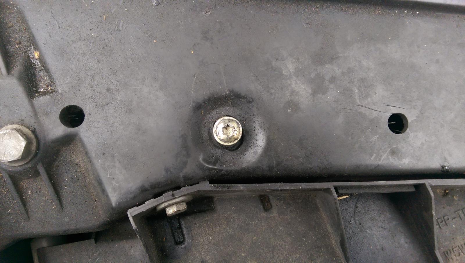

Then had a look at adjusting the headlights, but have no idea how! Is this bolt that sits under the rubber cover the one to turn?

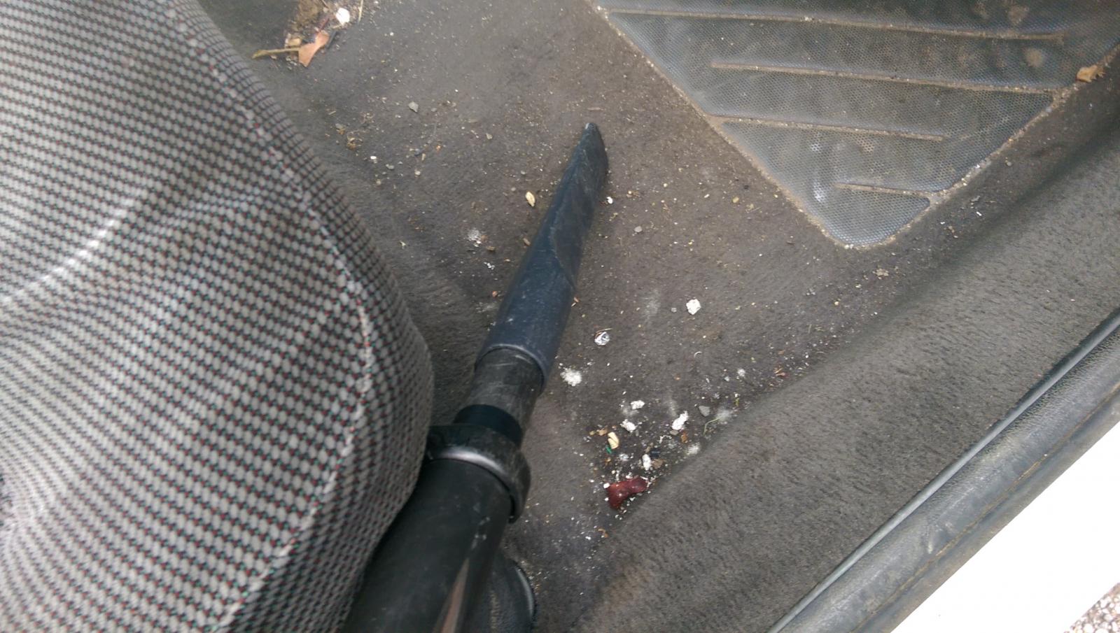

I decided to not turn it until I know what it is, so did some vacuuming
Then cleaned the lenses with a brush and refitted them
