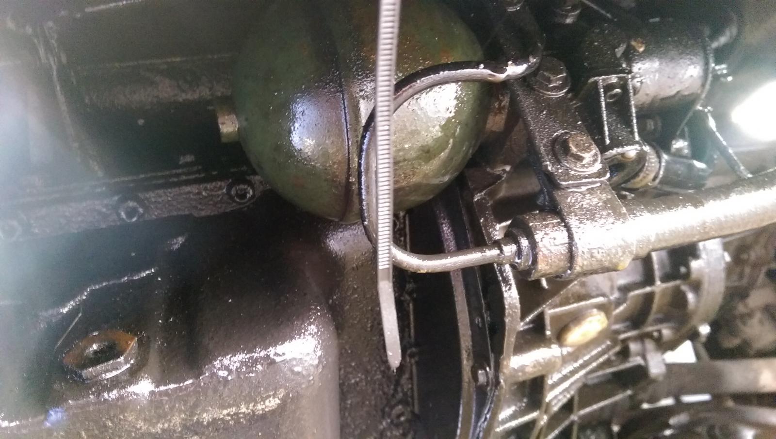

beko1987 Posted August 24, 2016 Author Posted August 24, 2016 Can't you just cable tie the connecting rod on? That's what I did on mine and it lasted the life of the car.I might well do, it's stayed on so far though, will keep an eye on it
beko1987 Posted August 24, 2016 Author Posted August 24, 2016 Please remember not to be underneath it when it's "high", then mess with the height corrector unless it's supported by axle stands or is up on ramps - several people have suddenly found it detrimental to their health when half-a-tonne of Citroen back end sinks onto their chest. Yep, she was up on ramps. Was quite odd at first pushing the lever not even 1mm and watching it rise away, then moving it the other way and watching it get closer... More adjustment to do at the weekend though so will be doing it again! M'coli 1

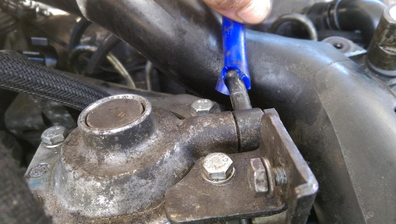

beko1987 Posted August 24, 2016 Author Posted August 24, 2016 I might buy one of these first and try http://www.halfords.com/workshop-tools/tools/spanners-wrenches/halfords-professional-flare-spanner I stopped as soon as I felt slippage, so only knocked the edges off slightly, rather than properly fuck them up. Also sprayed plusgas on them before I ran out of that so hopefully that will help

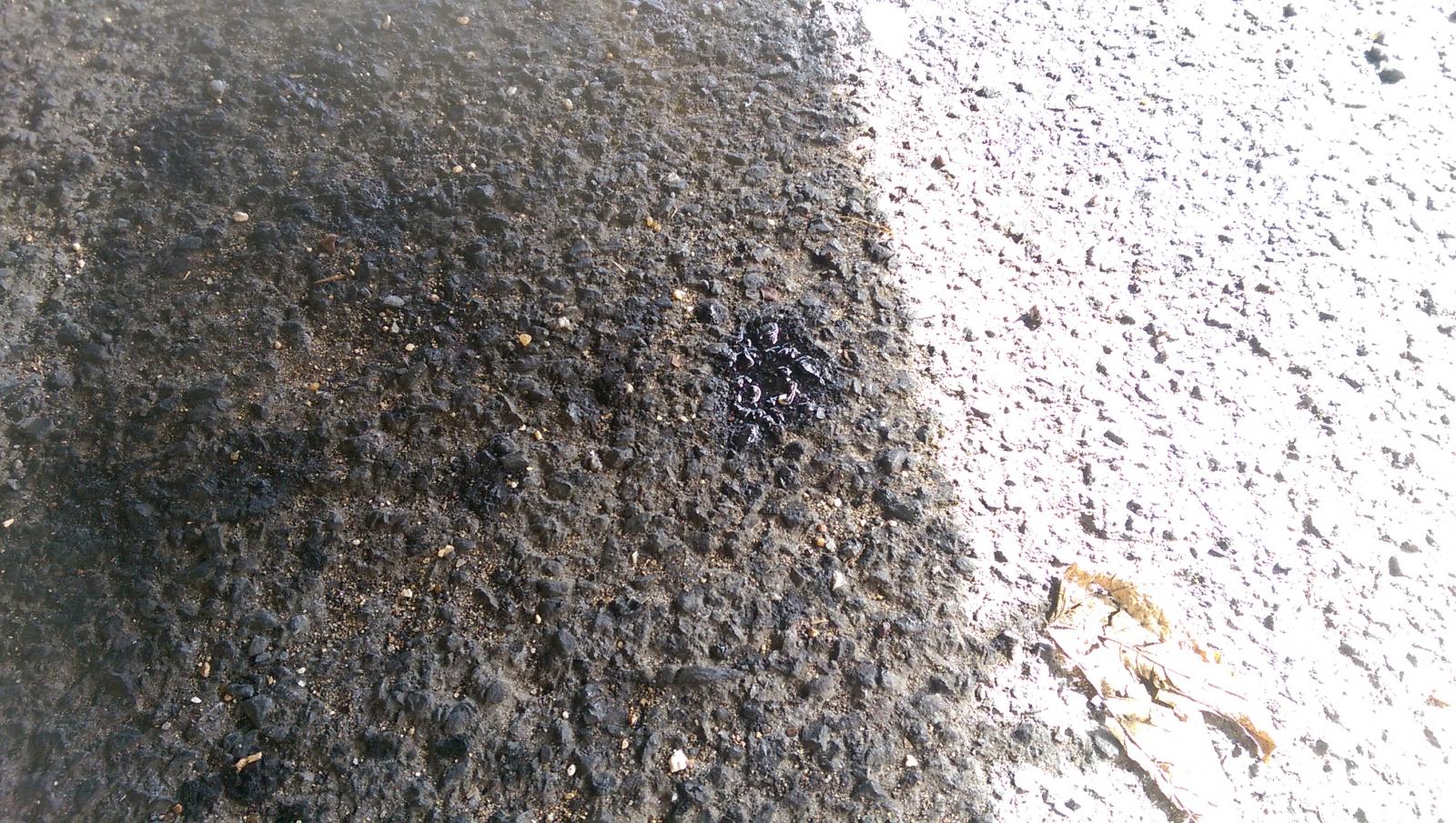

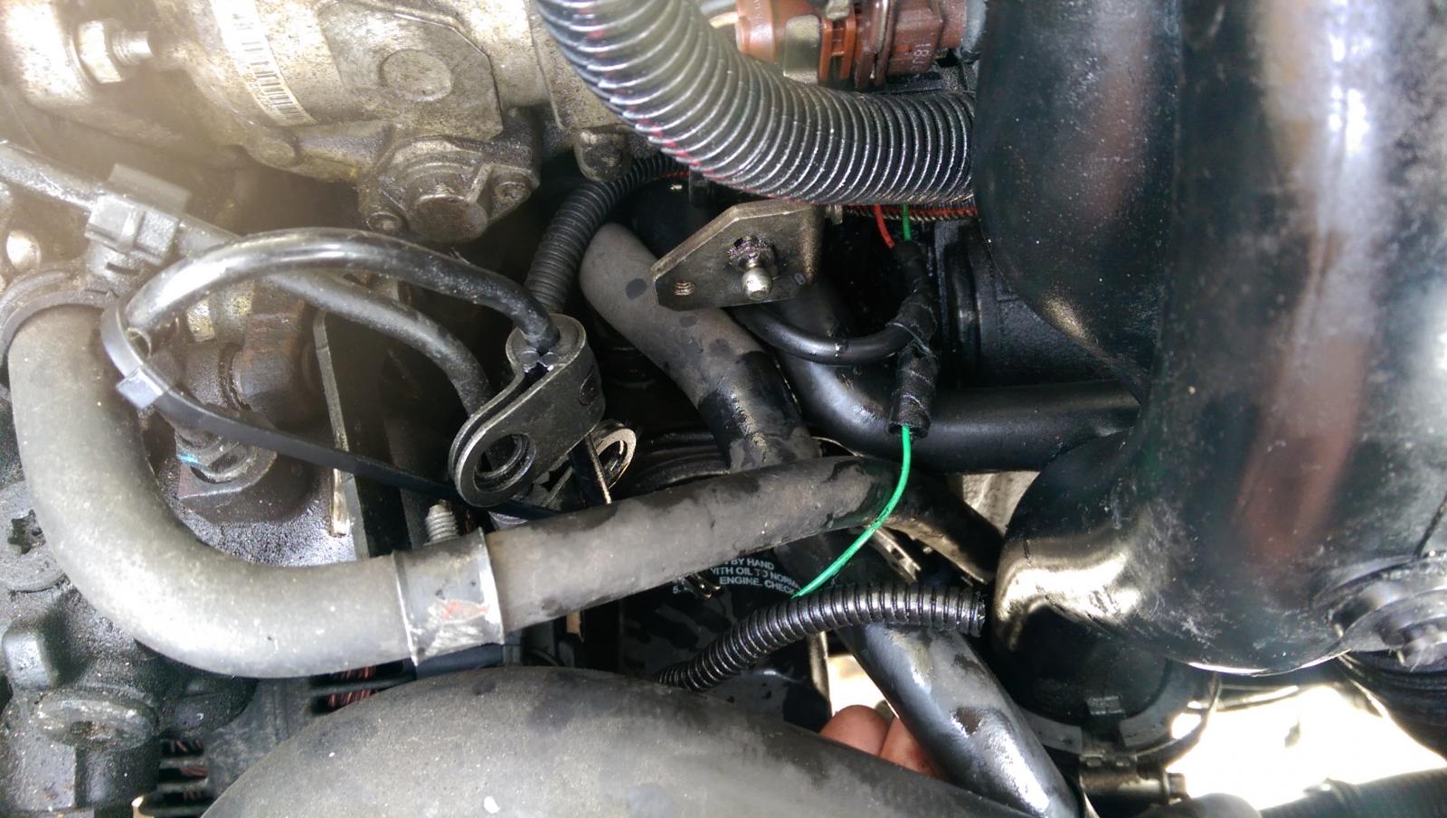

beko1987 Posted September 23, 2016 Author Posted September 23, 2016 mmmm there is certainly a water leak somewhere, this is after 18 miles No idea where it's coming from, it's obviously being blown around everywhere whilst driving, will have a look when it's dry and up on ramps tomorrow. any common water failure points on a 1.9td to get me started? best start carrying water around. the bloke who sits next to me already suggested radweld/kseal, I slapped him

beko1987 Posted September 23, 2016 Author Posted September 23, 2016 Nah it's ok Bub, I only noticed when I was under it fettling the rear height corrector after it had been idling for 2 hours! It's not as bad as I thought though, I brimmed the expansion tank yesterday lunchtime at my mums, and I checked just now back at mums (so 50ish miles) and it's gone down a CM, so not quite as bad as I thought. It just looks worse I think, as wherever it's leaking from is splattering EVERYWHERE when driving, and taking oil and other shite from the engine bay with it. So it all looks bad, hopefully when I'm sat properly under it behind the block I can see what's occuring. It's all too wet and oily for rainagains talcum powder hack to work. It might be coming from the drivers side, as the drivers side wheel is wet inside, water is running down the wishbone on both sides, but more on the drivers side. But everywhere is wet. Due to my inability to find an 8mm flare nut spanner that isn't made of shite this will be tomorrow's job, either hoping to see where it drips from, or remove pipes one by one and inspect. Interestingly, once brimmed with water the temp gauge didn't rise up to a bit past halfway as it always did, so at least once this is fixed it'll run a bit cooler. It was properly out of water before though (having never checked it). Talking of the rear height corrector, I'm almost tempted to get some mole grips on, and hope they grip the union enough to not slip, but that's a one chance only thing, so keen to avoid. The unions undid from the block of them further up the body though, so if the 2 height corrector pipes run to there I'm going to try removing them from the block and slipping a good ring spanner down the pipe and undoing them that way. We shall see, coolant is a tad more urgent now, I'll reposition the height control rod anyway as that's easy and 80% of that the rear height problems are for now. You watch it fuck down with rain here all weekend now... I did pop to our local diy shop too, but they only had a tiny selection of mainly 10mm silverline shite spanners. Fair play to the old bloke though (family owned, his son runs it now) he said 20 years ago they would have had it, but I'm the first person this millennium who has asked for a flare nut spanner. He knew exactly what fitting I meant when I mentioned citroen LHM pipe too. I think he felt a little sad that times have changed and it's no longer worth their time stocking stuff like that Also tried screwfix and toolstation, toolstation sell a 23-24mm flare spanner, screwfix laughed in my face (as much as a website can), so it looks like finding a single good one on ebay is the way forward, unless ruffgeezer, do you have a decent 8mm flare nut spanner in your MASSIVE tool stash?

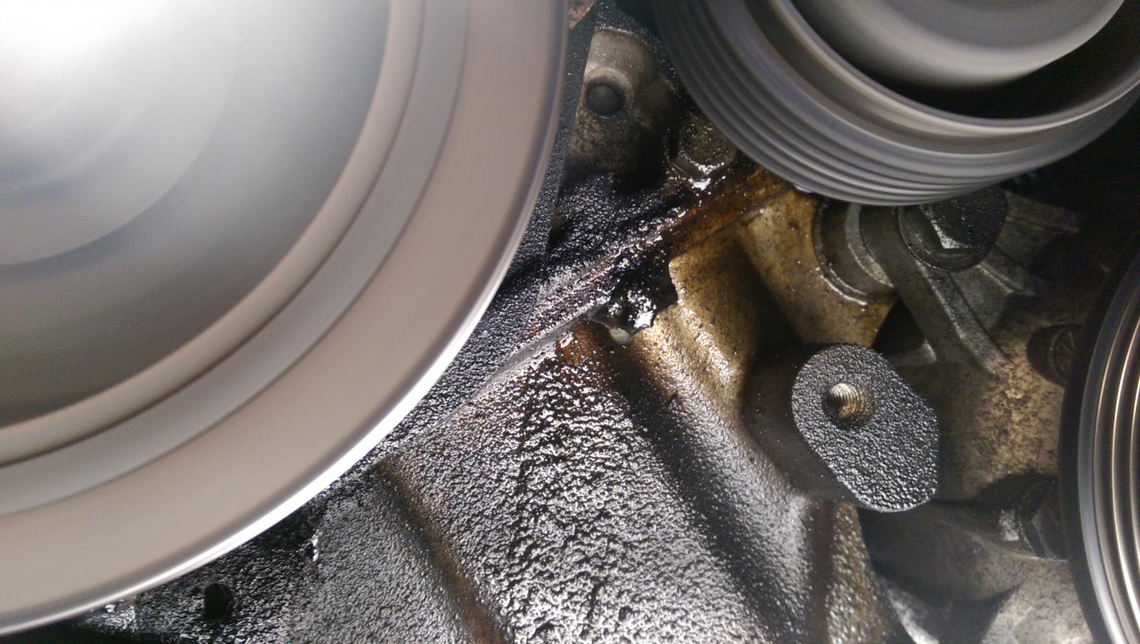

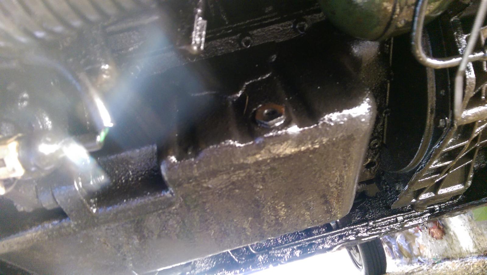

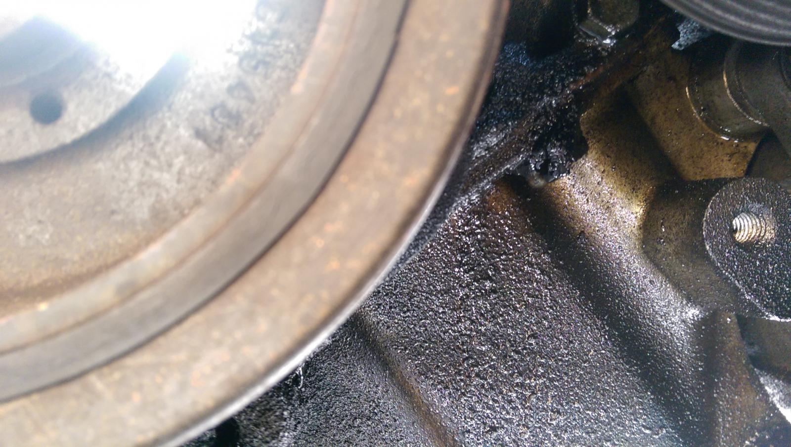

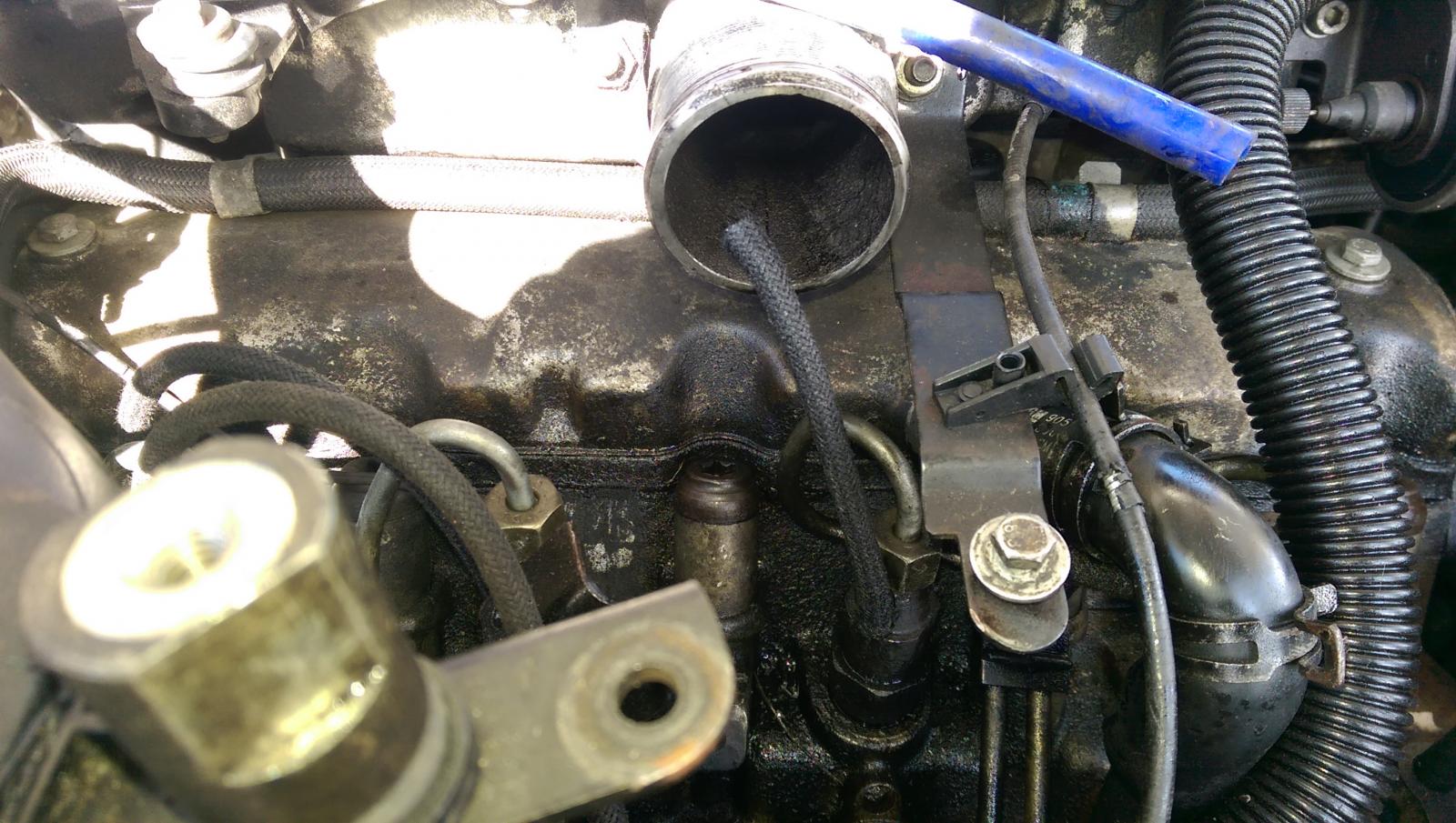

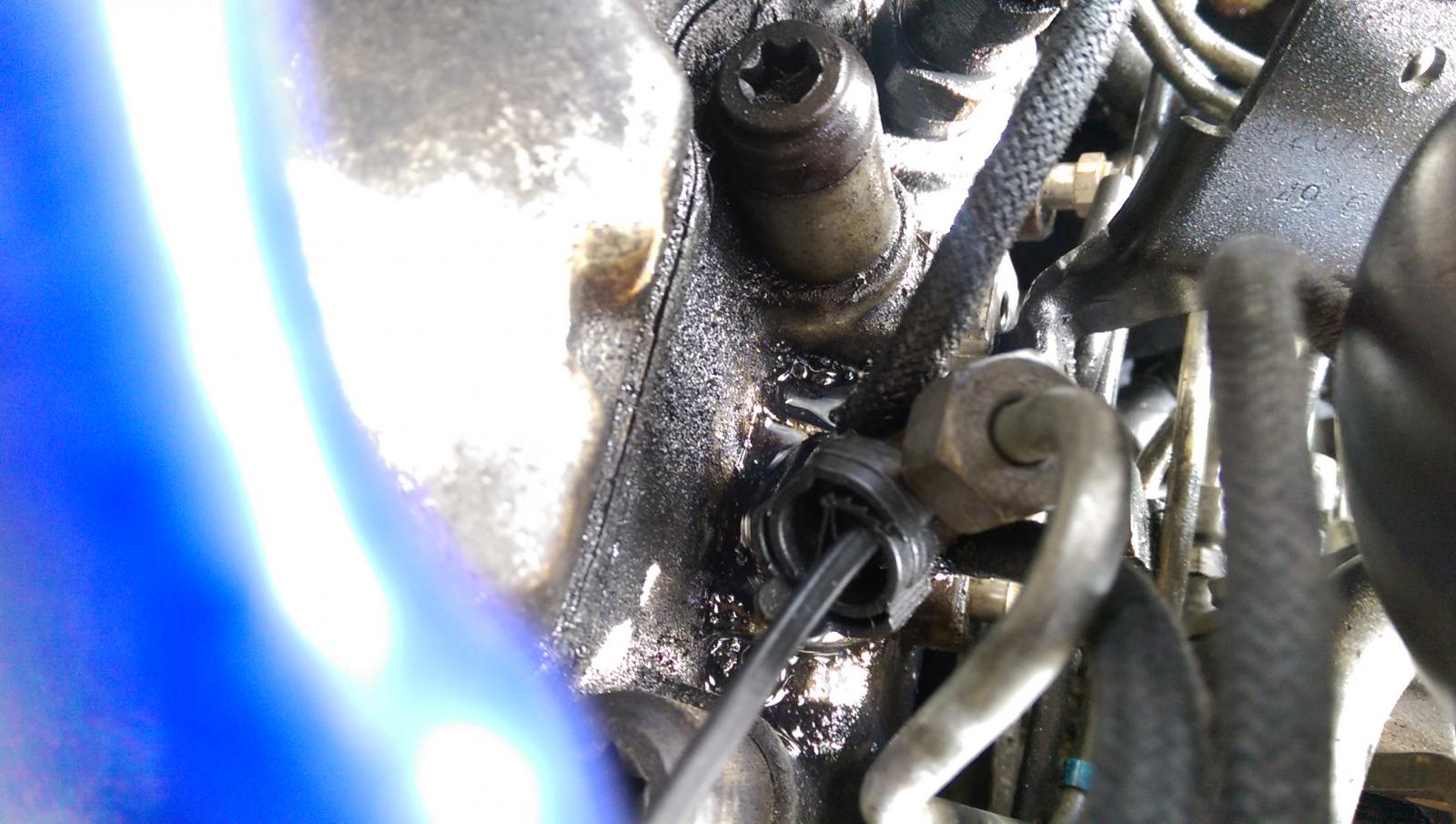

beko1987 Posted September 24, 2016 Author Posted September 24, 2016 So, on this glorious but fucking windy day, I have tools out and the drivers side jacked up, and the wheel and arch liner out, as mu lying on the floor in the week deduced that that side is soaked... I turned her on (the belts are squeaking now too, this started friday morning, I think the leak and this are connected), and ran it up to temperature, and a drip made itself known, running off this sump bolt it wasn't much though, a drip every few seconds, this was the mess after 15 minutes I squeezed lots of hoses, revved it up from the fuel pump etc, and I can't see any water leaking. One pipe (goes to one side of the fuel filter housing) is damp, but i think it's water from inside the top layer, not a leak However, what did make itself known, was this pool of liquid around what I think is an injector (is it?) And after cleaning off the sump and various pipes underneath with an old towel, liquid is running (not too fast) down the sump from up above the front (the back of the engine is dry) Could this be what my drip from the sump bolt is? It's running lots of ways? And doing more taste tests, it's bloody veg and diesel (running about a 50/50 mix). This would explain why the underside hasn't dried, cos it's coated in lovely rustproofing veg! And after turning her off, and buggaring about for a few minutes, the pool of liquid on the engine had gone! So, could the 'raining liquid' I saw on friday morning after getting to work actually be loads of fuel pissing out of somewhere? How/what do I do to have the injector off to have a look/seal it up? Not sure why the header tank was a bit empty, but I don't think that's the alarming cause here, maybe it just needed topping up? Fuck my mouth is dry now though!

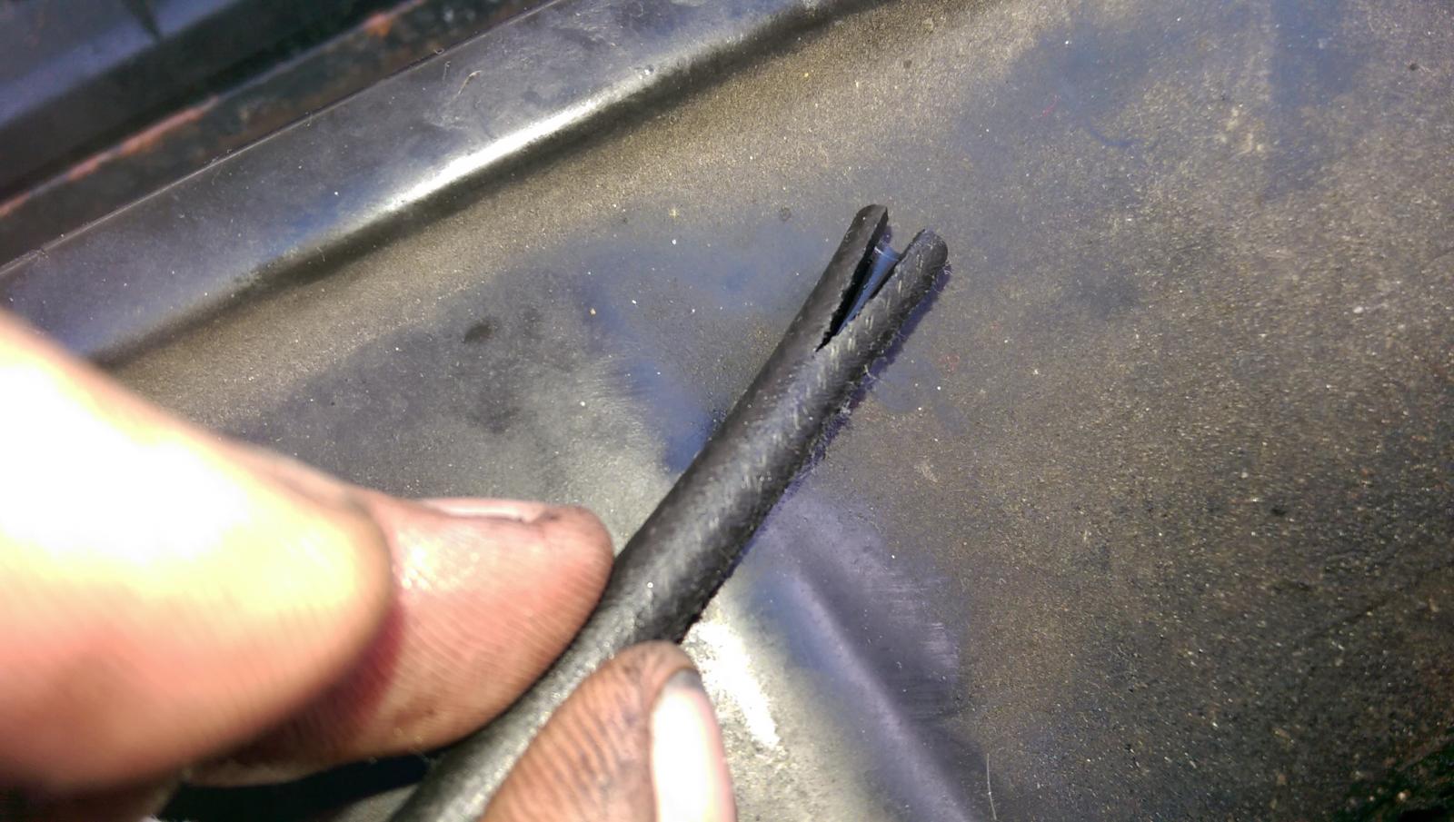

bub2006 Posted September 24, 2016 Posted September 24, 2016 I did mention a weeping leak off pipe. Could be that? beko1987 1

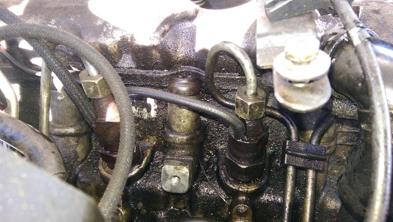

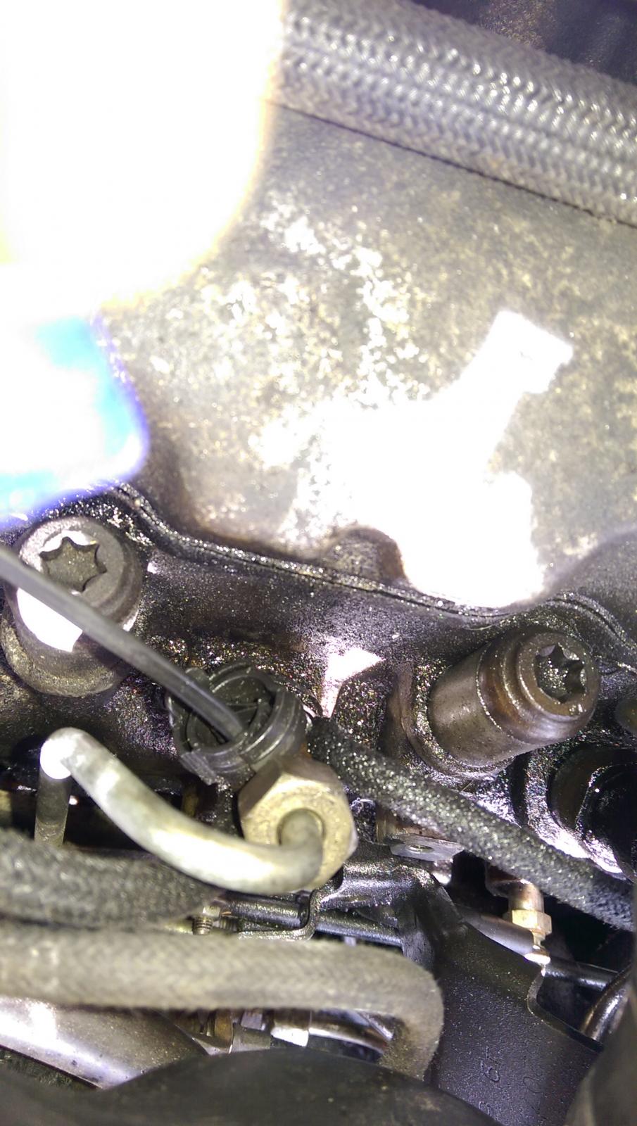

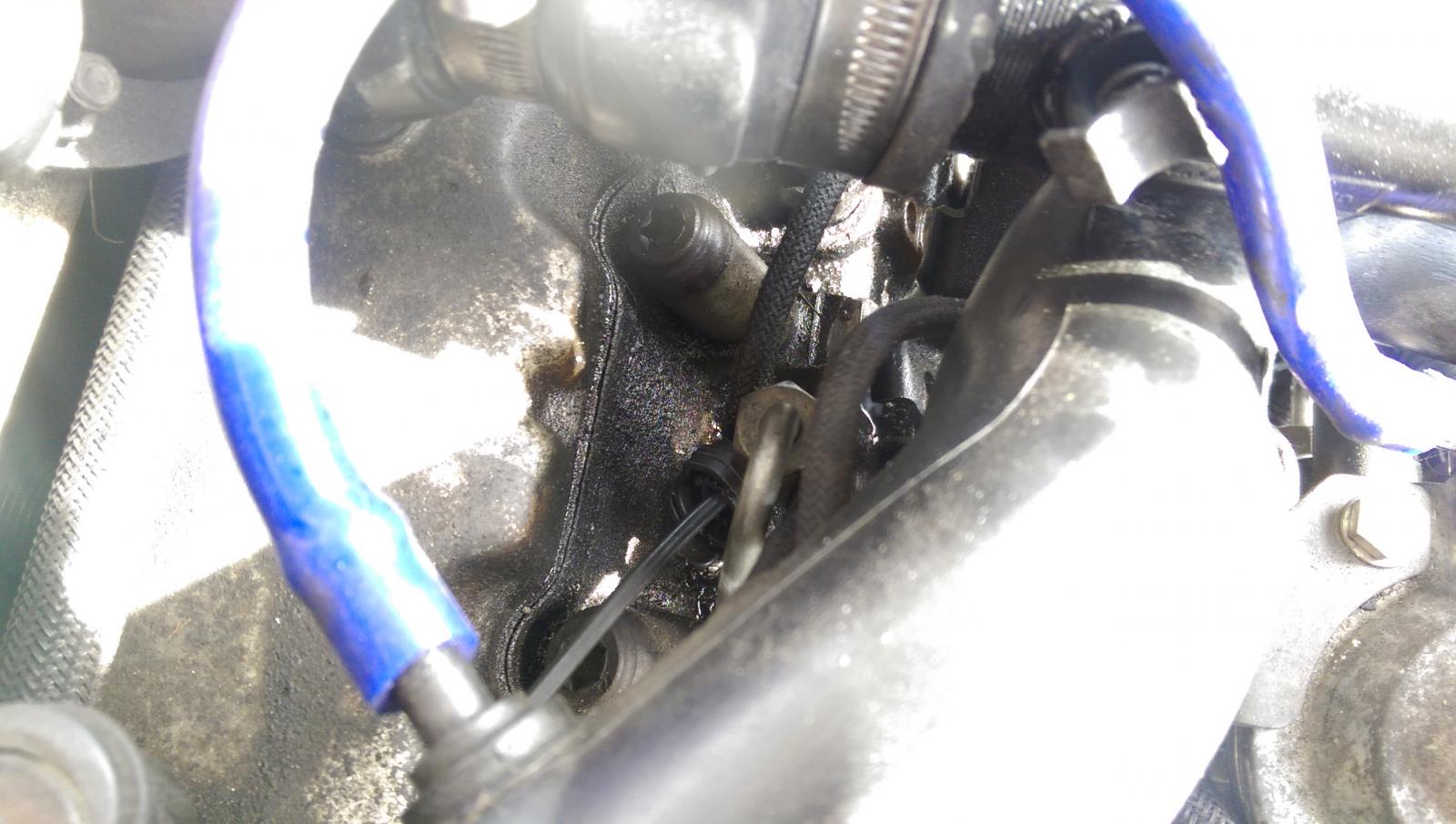

beko1987 Posted September 24, 2016 Author Posted September 24, 2016 It might be! Looks to be coming from around the injector base, but obv it could be running to that point. I feel some stripping down coming on once I've got the arch liner and wheel back on. I didn't notice it doing it when running diesel, but could smell a waft of it every now and again, but everyone has always said that veg leaks more than derv
dean36014 Posted September 24, 2016 Posted September 24, 2016 if theres enough slack in them trim the ends of the leak off pipes and reattach. Every XUD I've had eventually had the replaced. you can buy it by the length for peanuts. Also nip the injector pipes up and make sure they are tight. beko1987 1
The Moog Posted September 24, 2016 Posted September 24, 2016 Just replace the leak off pipes . They arent that hard to do, can be a bit fiddly anf cheap enough beko1987 1
oldcars Posted September 24, 2016 Posted September 24, 2016 Is this spanner any good?http://www.ebay.co.uk/itm/like/151992011724?lpid=122&chn=ps&adgroupid=28306099746&rlsatarget=pla-184492175826&adtype=pla&poi=&googleloc=9045996&device=c&campaignid=628859225&crdt=0 Its park tools with i used to use all the time for the mountain bike and were good quality when i used them, all be it about 18 years ago. mat_the_cat and beko1987 2
beko1987 Posted September 24, 2016 Author Posted September 24, 2016 To all those who confirmed leak off pipes, you were right! I remember asking this about the ZX but that didn't leak so I never bothered. I found the culprit, once the intercooler pipes were off it became apparent A quick test fire revealed fuel spunking out of the nipple, it was hitting the intercooler pipes and running for it! The reason became clear when i took the braiding off the hose chopping the end off and re-attaching did the job and will keep it dry for now, I'll buy new soon I then saw this bit of bare wire, what wire is it and should I wrap it in something or just leave it alone? I then tidied all the random hoses up, too kthem off, cleaned them up and re-attached them, tidied this blue one up it needs an air filter soon, I rotated it so the cleaner bit was over the intake When Bub handedm e the keys he asked if he could have his lucky sidelight bulbs back (these weren't fitted the the escort... what could have been? All out now daz, I'll lob them i nthe post when I remember! Job done for now I think, need to go to asda later so will test it out. I did some bits on the meriva too, but we are going to the food festival now, which is good cos i'm starving, so I'll put that up later! vulgalour and CGSB 2

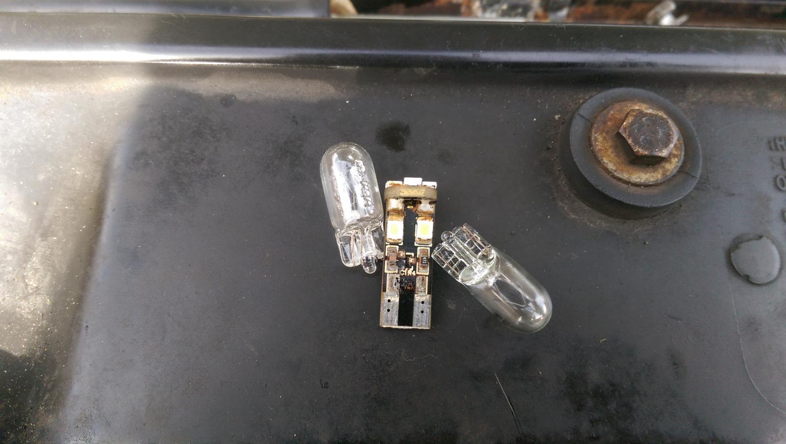

bub2006 Posted September 24, 2016 Posted September 24, 2016 I had them same bulbs in the van. I bought some after crash and swapped them along every car beko1987 and oldcars 2
