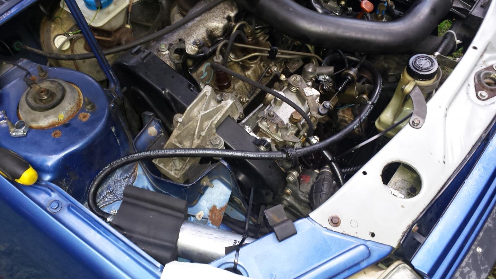

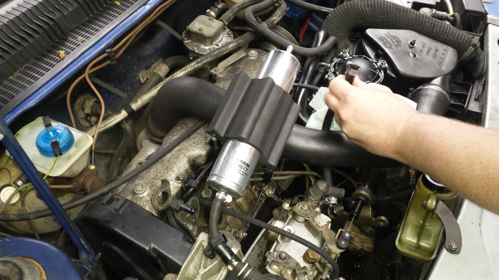

I got a replacement filter from a bmw e46 320d and fitted it bypassing the original filter and housing.
Initially it was just papped in to see if it'd start. Happily it did.
then we got it secured out the way down beside the wheel brace on the inner wing.
It performed faultlessly on the trst drive, right up until the Drivers track rod end decided that it'd wobble like fuck..
bloody thing!

It appears to have sorted out the fuelling issues for the moment.. I may get some clear line at somepoint.
the Octavia was fucked suspensio wise and a touch crispy in the sills too-- wasn't just the air in fuel that did for it:)
I know the glowplugs are ok based on thr fact it doesnt smoke like a beagle on cold starts (unlike my 306 did beore I changed the glowplugs)
I'll sort the tre and run a tank of derv through it I think.
I know I've not made life easy for myself just haranging veg in it but that's life:)
on he plus side mose everything fuel related in the engine bay is new now:)
