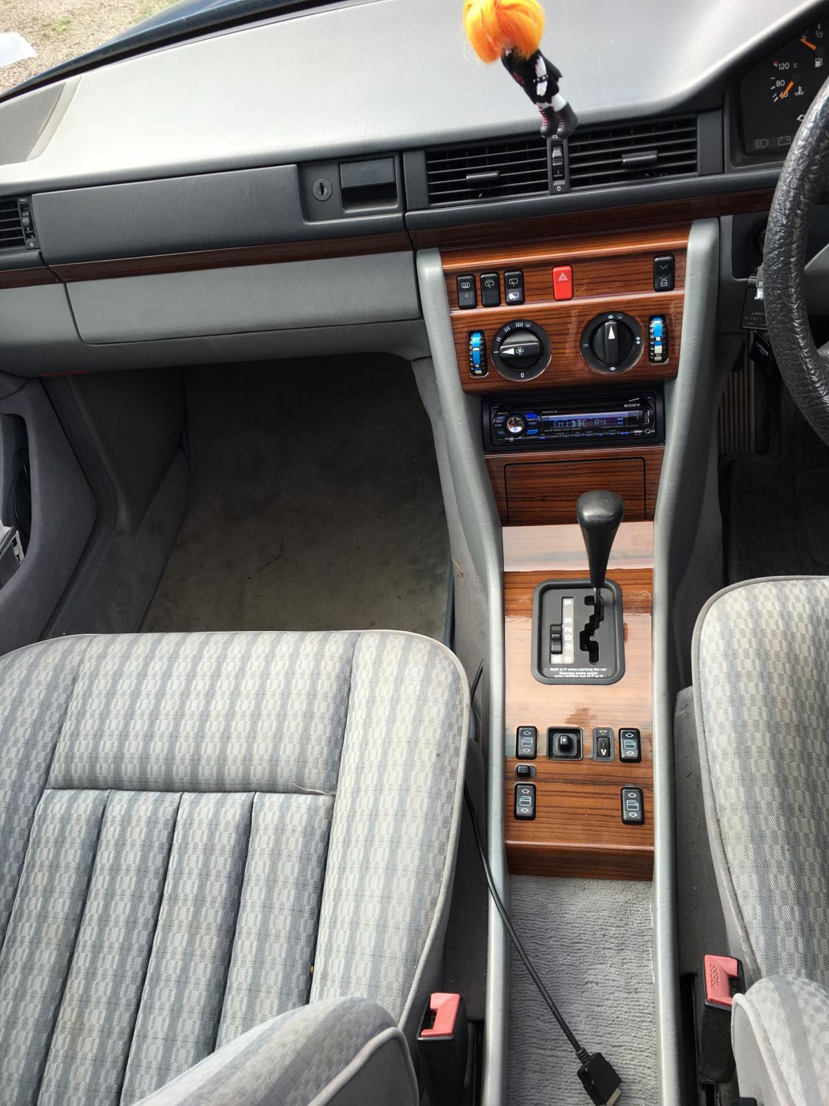

For a while, it was driving about with the centre console in bits.
This has now been rearranged, and one of my spare up to date (HAH) radios installed with a USB port. All four speakers work, the fader control just passively sits there but you can fade out the rear speakers if you want.

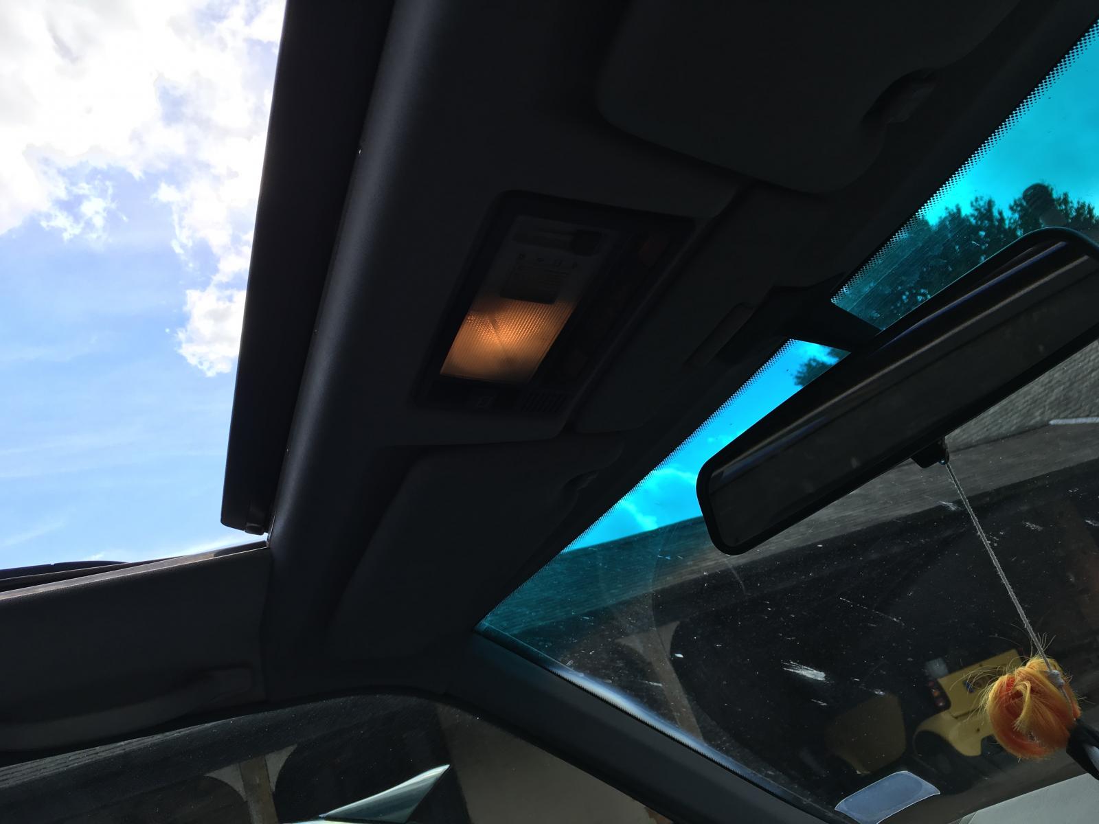

The sunvisor no longer hangs loose...

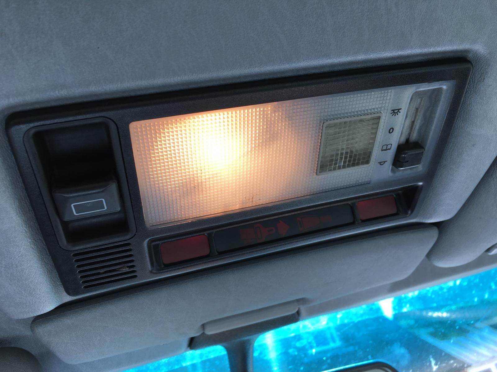

The interior light works again...
Who doesn't love a sunroof.

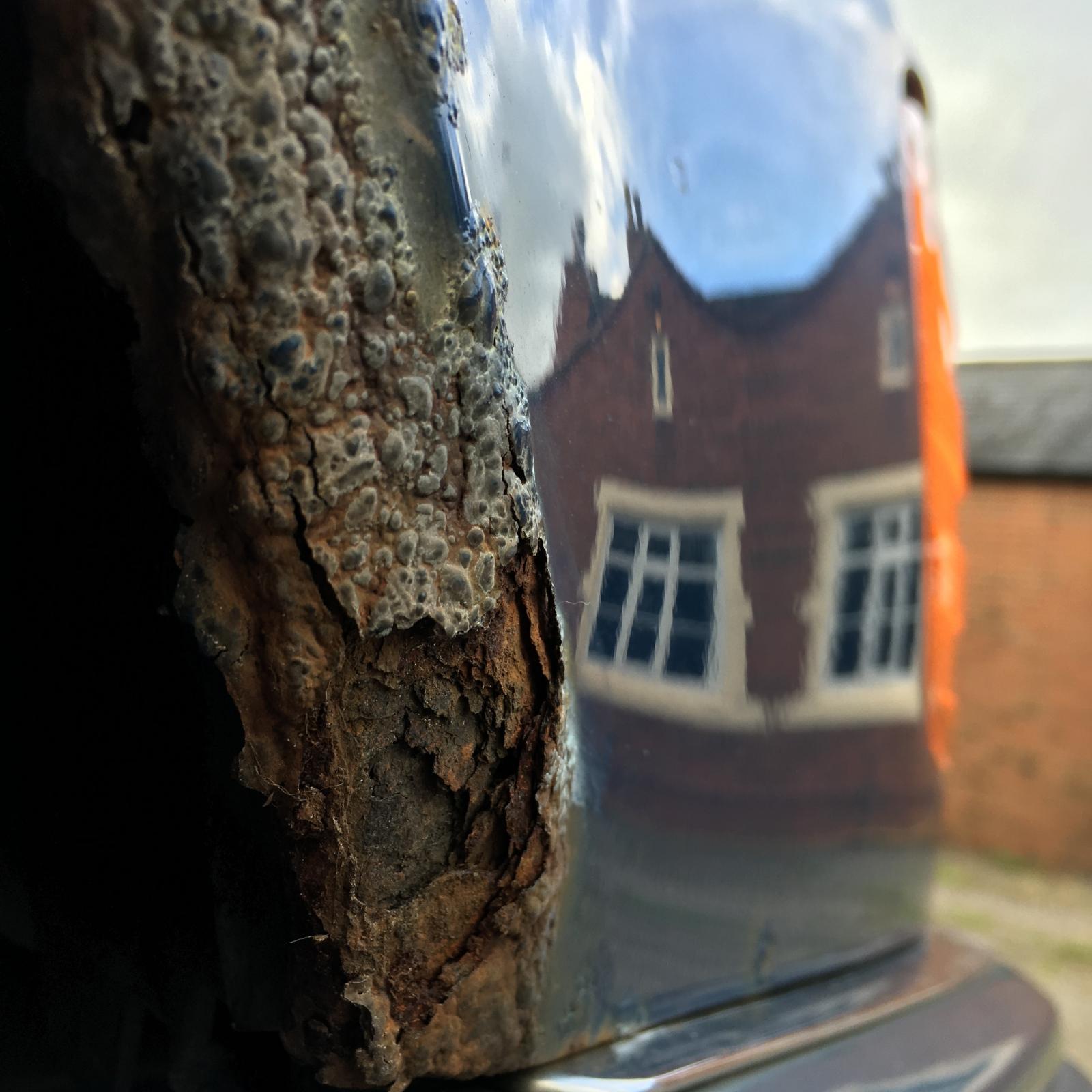

Replace both front wings
Repair rear quarters in the usual places, make good rust areas near scrape but leave dent and scrape where it's not causing problems

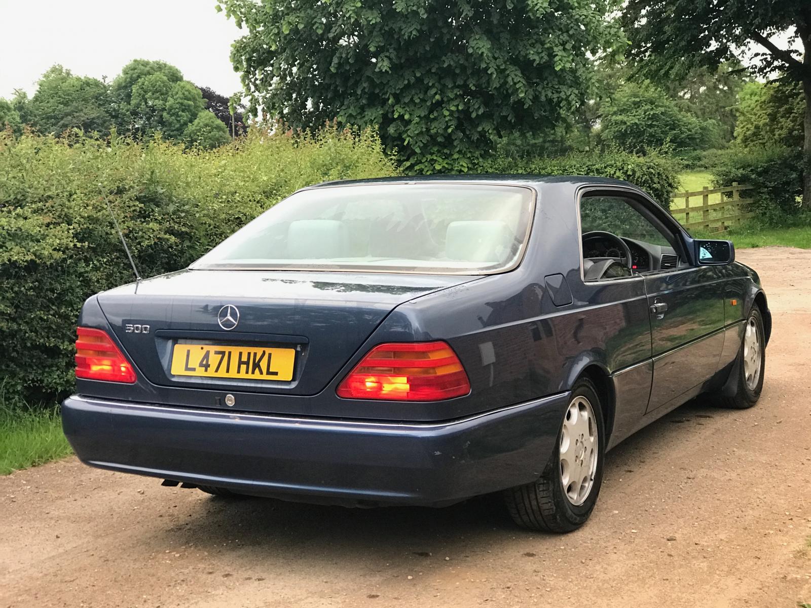

MoT expired on this, but it can't get a new one until I replace the combi relay as one indicator flashes randomly if the lights are on, and the hazards flash double speed on one side. Still waiting for the window seal to show up, too.
Chances are this one has to go, as life got really intensely weird and now I'm trying to pick up the pieces. Not helped by the C5 being (probably) written off. S'okay though, I used it as an excuse to buy another Sera.
  • 2 weeks later...
This definitely has to go - it's too big for my little car ramp so I can't work on anything underneath easily (what people don't notice given how much I run about normally - my right leg is smooshed at the bottom and various pain issues mean jacks and stands result in a lot of frustration), and although I hoped I might manage to do all these things and at least see it through to another MoT, the Sera's headgasket going means the project pile REALLY doesn't need a 500 SEC in it as well.
Early posts show what it is - the main issue stopping me taking it for an MoT is the hazard lights/random right turn signal behaviour. Hazards flash double speed on the left, the right turn signal sometimes flashes if the lights are on. Just once, randomly, but it does it frequently enough on a night drive to be annoying.
Pretty sure the issue lies in the N10 combi relay. These are specific to C140s, though I found one that looks right-but-with-trailer-option on eBay and am tempted to try it - have sent an offer - but the direct replacement is available for £240 most places. I did try opening the one in the car to check the soldering but it's a bastard of a design, not like the K40 on the SLK.
