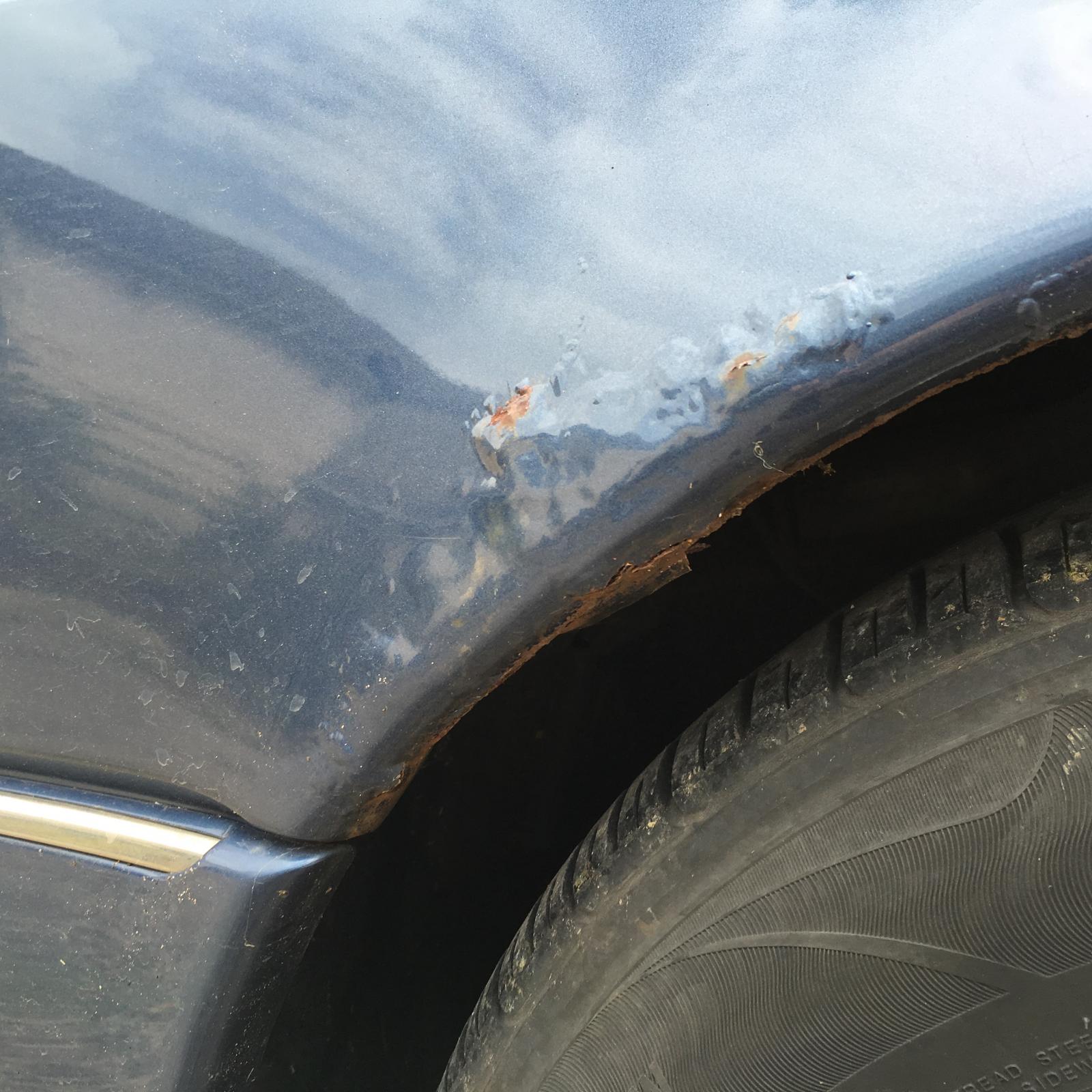

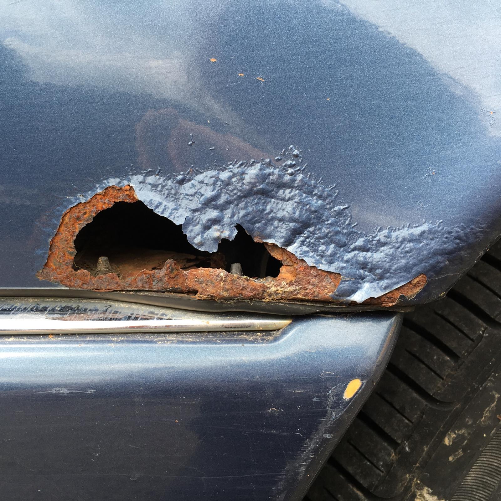

First, I don't think the 30 year warranty would cover this... It is a shame Mercedes weren't more proactive with their warranty where bodywork is concerned.

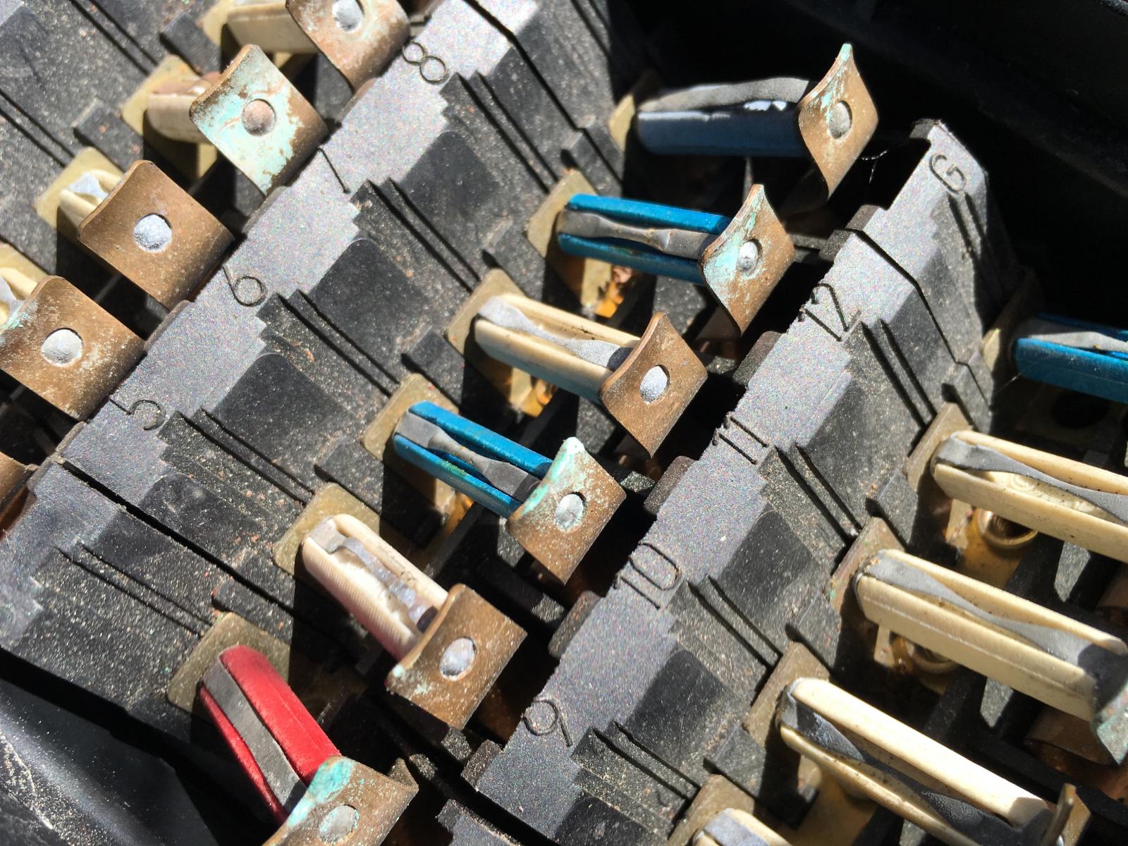

Now, flashy indicator weirdness...
So far this is the only corroded wiring I've found, going into what I think is the wiper control box but can't remember.
Into the fusebox and...
There's the N10 relay. I suspect it's got an internal failure - hazards with ignition off, fine, with ignition on, fast-flashing nearside (bulbs are fine). Lights on, the indicators flash sometimes, one flash. I could do some tests, or I could do what I usually do...

What does the warranty cover then? I've been quoted £200 a wing for mine to be painted. I'm going to ask them for a price for the whole front to be done.
If the car has full Mercedes history, and has had regular body inspections, and so on, they apparently do make a contribution to bodywork repairs, but only at Mercedes workshops, and given the UK's salt roads, stonechips, attitudes to cars and attitudes to customers, it's not well implemented. People don't maintain, and dealers don't care.

Yes and no - the N10 relay on the W140 is more sophisticated - and I've a suspicion is a component failure rather than a dry joint, but I want to investigate the wiring loom at X27 (join front loom to main body loom) and indeed, the front harness, as this is of the era when Mercedes made biodegrading looms and the outside temperature sensor - that thinks it's anything from 9° to 50° on any given day - is part of that loom, so degrading wires could be shorting out and causing erratic behaviour. The harness is plug & play to replace, but "not cheap".

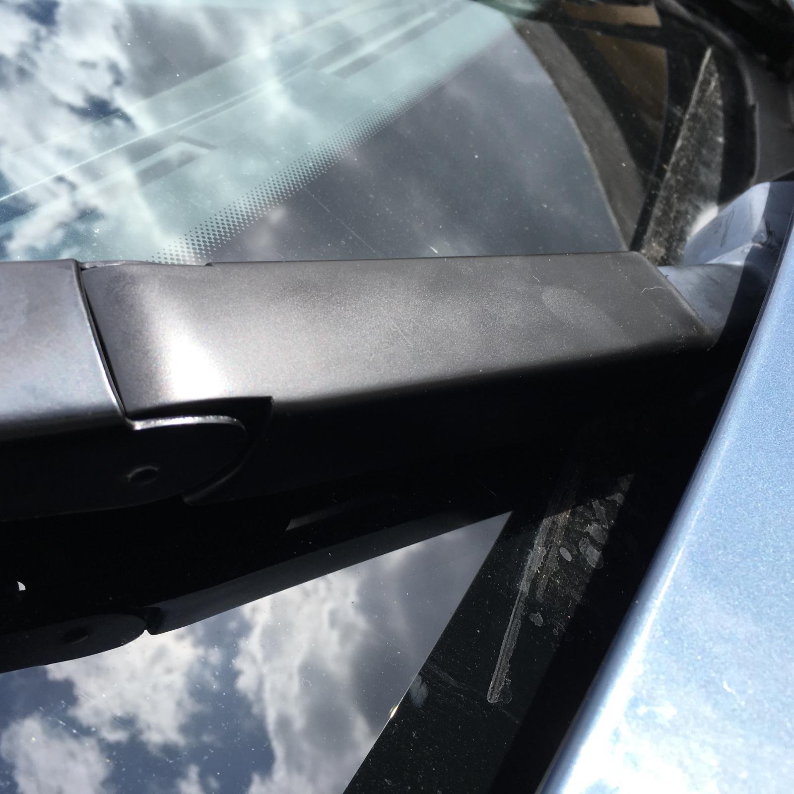

Undo boot trim, undo one screw. move pneumatic motor, remove other half of broken gasket, pop new one in and...
Plus bonus extending-wiper-bit-cover action.

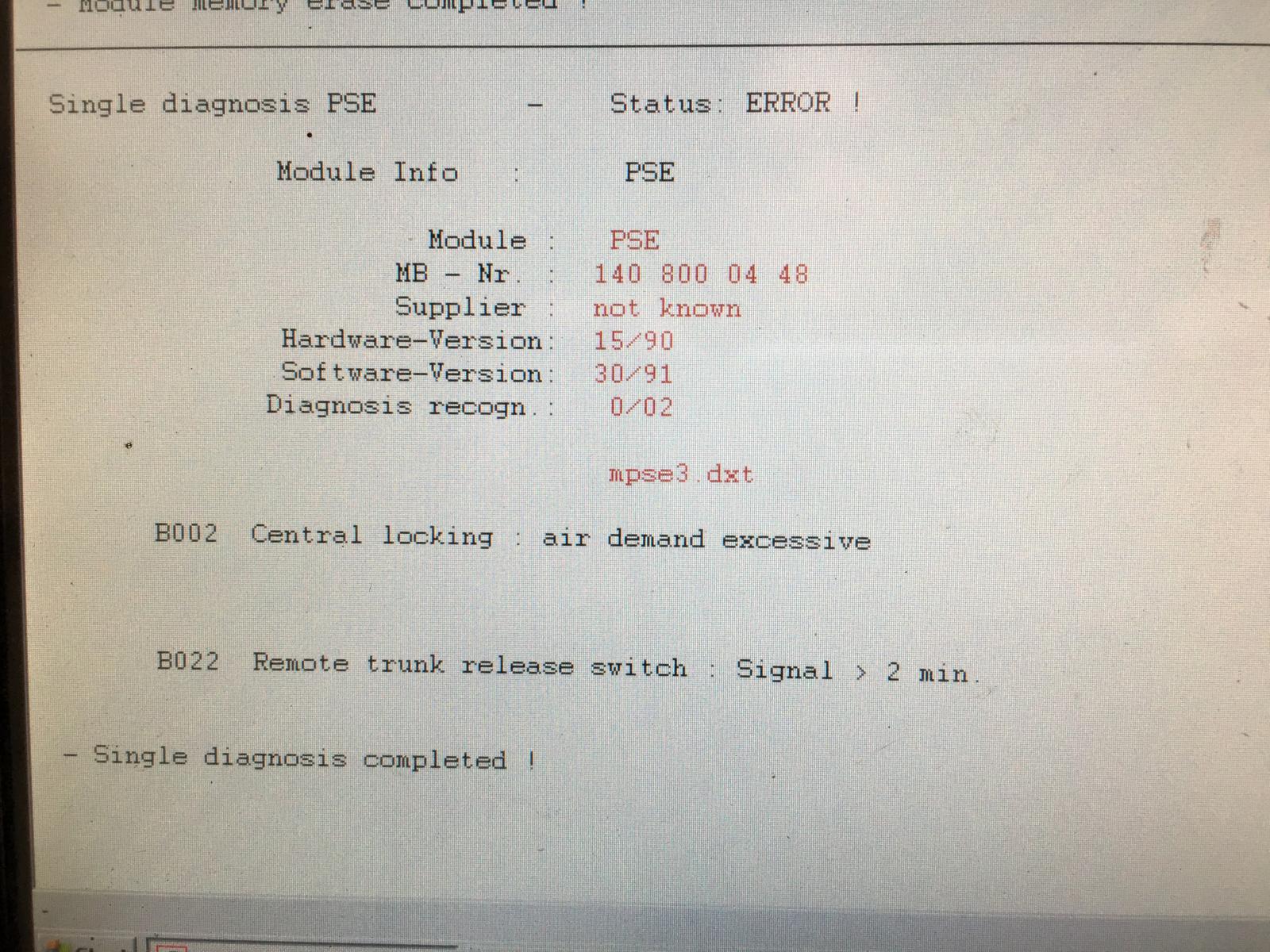

Central locking... let's begin with the basics.

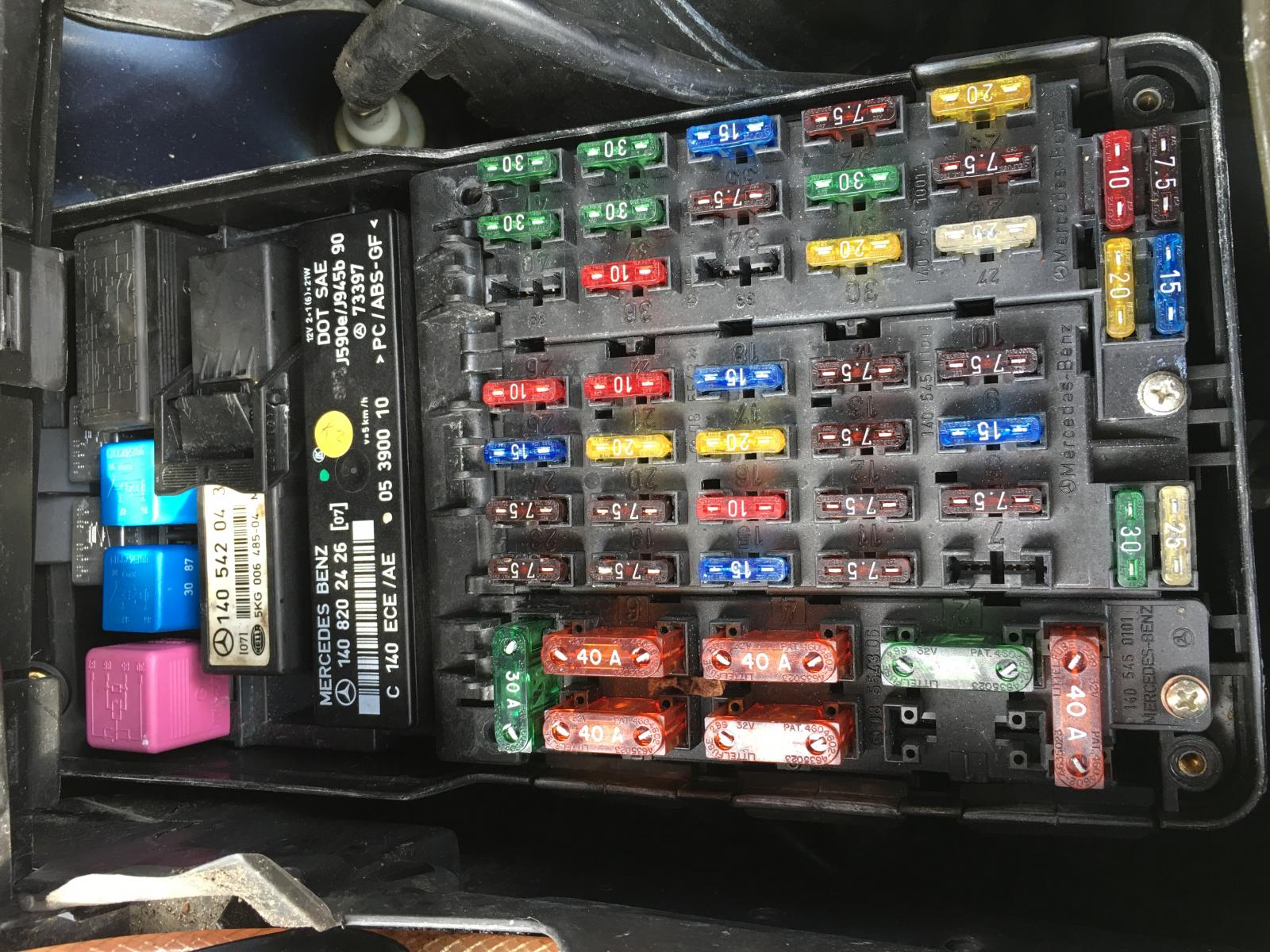

How's that fusebox?
"Standard".
Let's check out the rest...
Not looking too bad, things are where they need to be :)
Now, what else...
Still has the alarm then. And yes, it works, and works the central locking. Which is interesting, because the central locking doesn't. I think I know why, though...

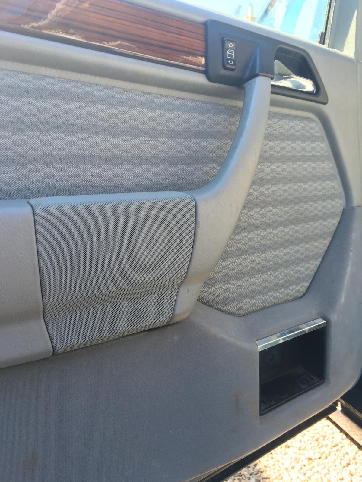

Ah, missing a cover though. The other side is missing an ashtray, so it balances out.
Whilst being curious about things, why do I have no overhead light on the front doors? The lights on buzzer works. The circuit is intact...
There's a clue right there. Rust staining inside the lens...

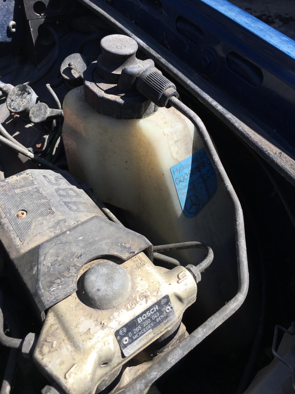

First though - to cure a car which has plenty of power and sounds healthy, but is breathing heavily!
