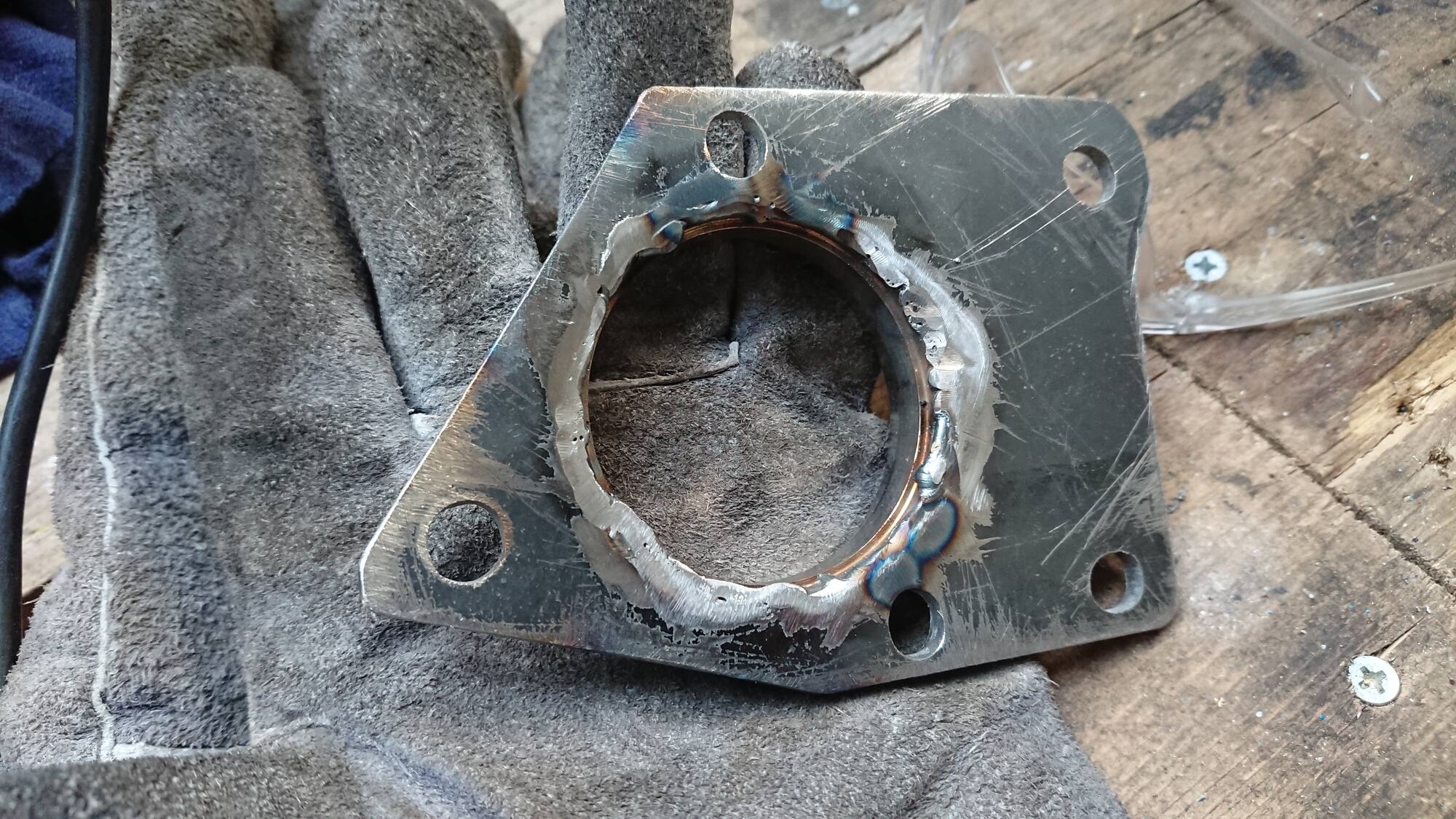

More flange action occurred today
Welding could be prettier... I'm still learning that too
But beginning to get there, think it's going to work.
Next it needs some counter sunk little fixings for the two holes under the v band, but it looks as if there is room. Just.
Pleased with the progress as I'm a metalwork novice and I've not had to scrap it and start over. Yet.

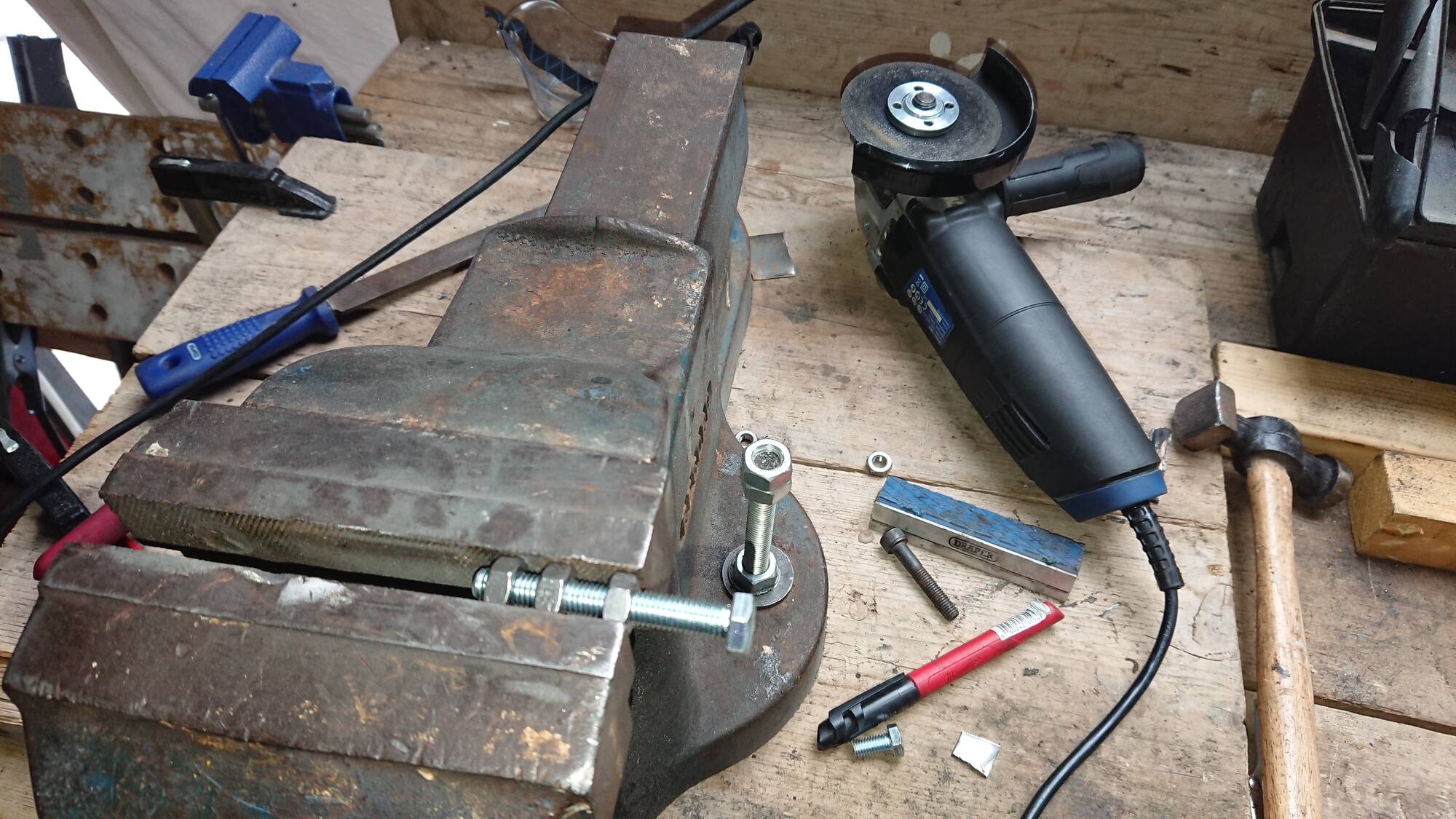

Of course, despite getting it cut off on a lathe the threads caught and pulled a coil out of the filter head. Caused quite a bit of quiet panic for a while but I managed to fiddle it right in the end.
Success. Much better. ?

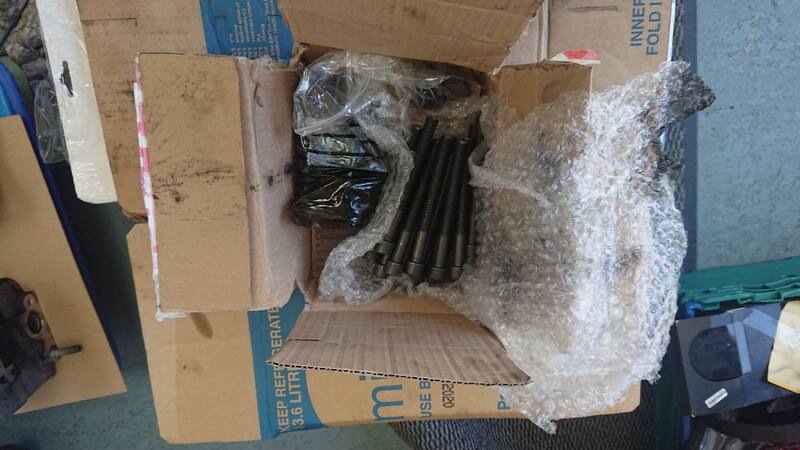

New head on, proper reinz headgasket
Held down by these bad boys, heavy duty, shortened vag pd150 head bolts.
These are apparently needed as the standard head bolts aren't strong enough to hold the head fully on in a full boost fuel situation. ?. Bolts give up and the head lifts up off the block and bleurgh.

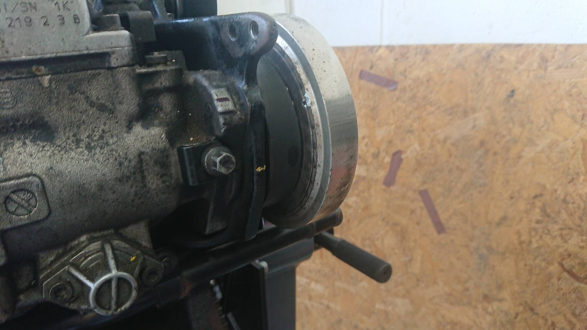

D5252t engine timing method.
Tldr: 0.55mm at tdc. Do cam up last.
1. Engine needs to be top dead centre on number one (closest to timing gear). Locate indicator peg on flywheel through the window in the base of the crankcase /gearbox join.
Peg and cutout just visible above. Normally involves both being under the car looking AND being by the rhf wheel inching over the engine on the crank bolt (27mm not deep socket required)
You need the engine on the 1tdc with the cam looking like this with the lobes for cylinder one (on left in photo) pointing out of the head. This only happens once per 2 crank revolutions, pop off the rocker cover and get it right. If you are building from first principles there’s a slot in the ip end of the camshaft that goes parallel above.
Once you have got the engine at the correct tdc, you'll need vag special tool 3313 (ebay £15ish)and a dial gauge, preferably a mini one. It's very cramped in the engine bay.
Remove the centre plug from the back of the injection pump and screw tool in with dial gauge.
If you have fully lost timing the injection pump timing marks are there, but only useful to find number one out of the pump. Using the pump marks only you will probably have a non running car. This seems to have annoyed a few people over the years, myself included.
To make life much much easier fire a couple of bolts into the injection pump pulley. Clamp a molegrip on and you have a handle to turn the pump with. I have a luxury taper that allows easy, steady adjustment.
It's well worth knowing that you can also clamp the pump at this point by unslotting this spacer and tightening the bolt that was holding it on the side of the pump. Do that and it defo locks the pump, but I have no idea if it is official method, so use mechanical sympathy.
Lastly, (and one of the more counterintuitive bits)...
Our aim is to get 0.55mm of lift in the injection pump at TDC, so we need to be able to adjust them independently of each other. So undo the cam either or both ends. As long as the lobes are on the correct phase then it's good.
Turn injection pump backwards (away, top towards windscreen if in car) slowly, a bit and zero the dial gauge at the lowest level (no more than an inch of pulley rotation).
Ensure that the bottom end is at tdc
Turn pump towards you until you have 0.55 mm of lift. Hold it there by whatever method.
Check tdc. Check lift. Check belt tensions as next we do it all up. Pump end pulleys are adjustable and can be used to adjust the pump timing, but that's a different way involving a computer and old proprietary software... That's exactly what this avoids so just set them where you want to get the belt tension right.
If you are sure it's good tighten up the cam (bolts work against each other so keep it at tdc.)
Bada bing Bada boom.
And that's it.
Look how far away the pump marks are
Have fun. ?

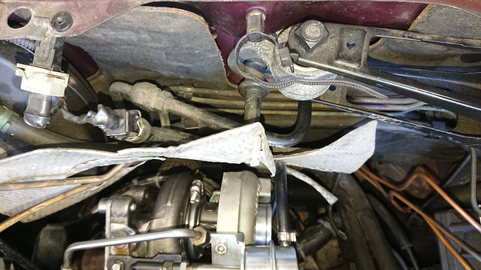

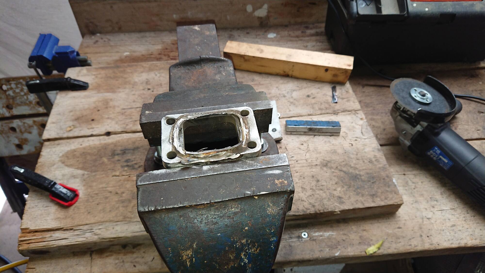

I decided that it was too tight. Fixings on the turbo output were hidden, exhaust too close to the servo, lines having to be moved. I'm doing this as a hobby, there's no rush or reason not to do it right. And it would annoy me every time I looked at it.

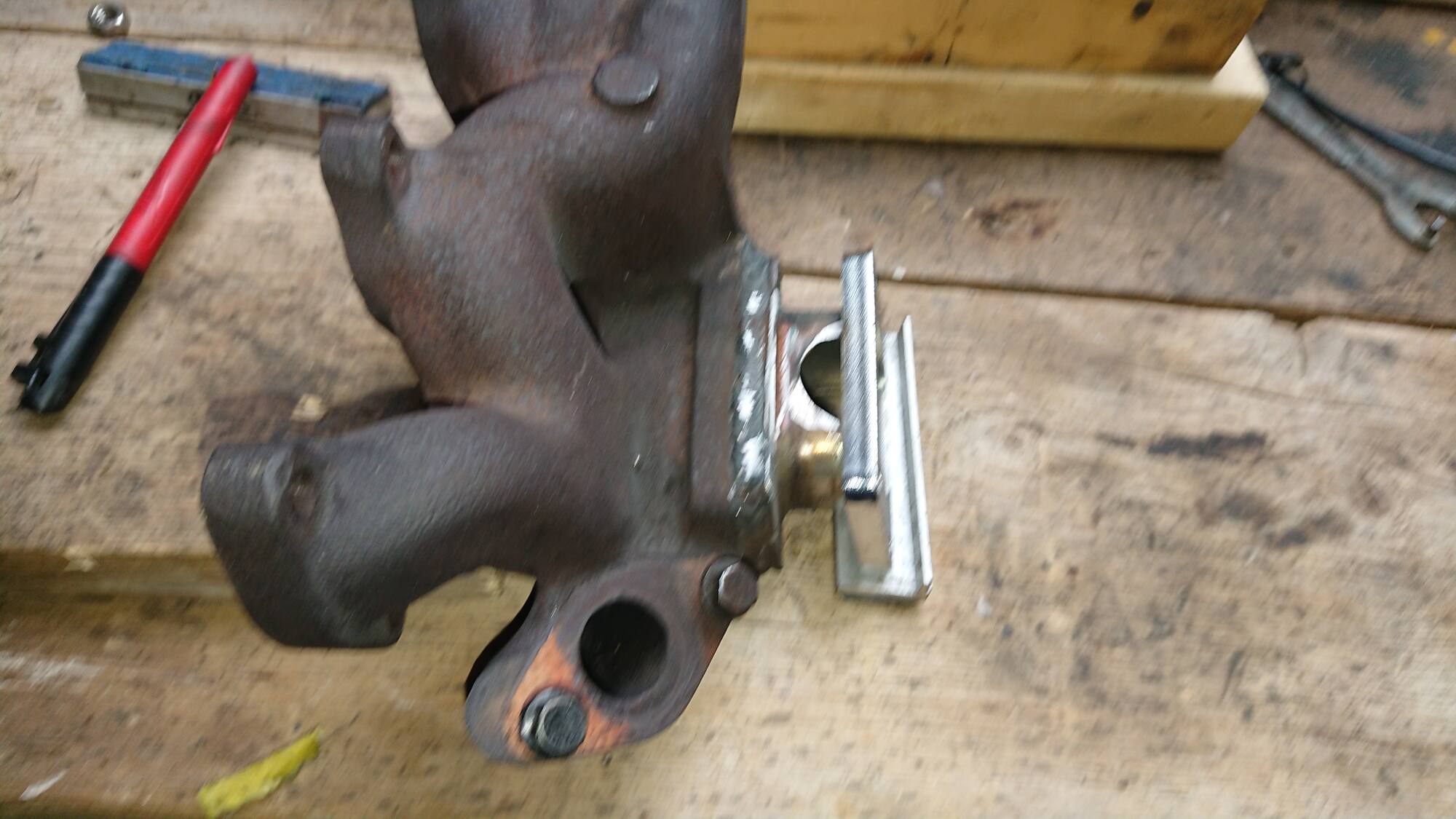

Off with the manifold and slice down /shorten the link pipe
This is done on the angle as it will fit /look better

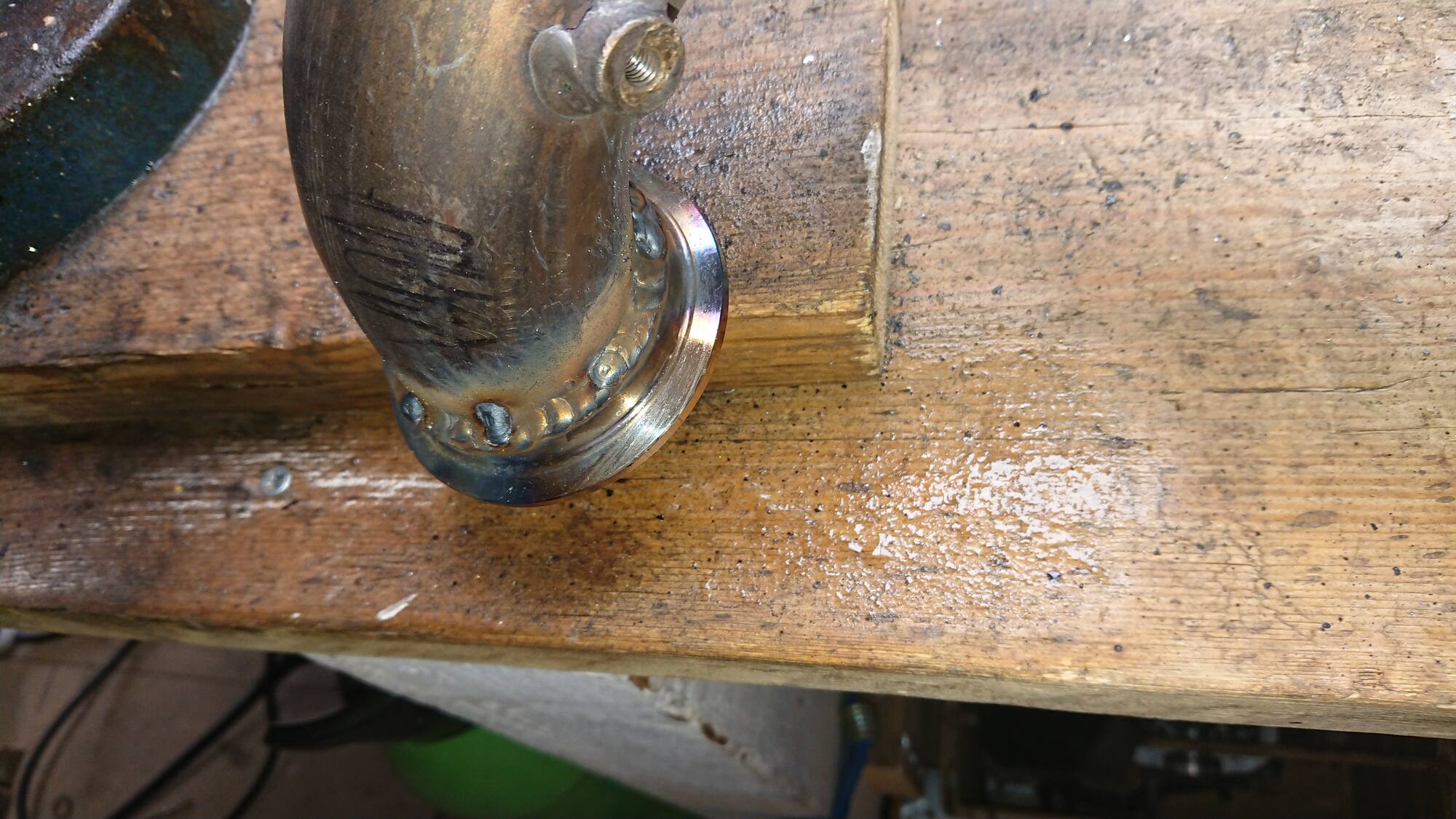

Excess pipe cut off the flange
Which was then flapped clean
And tacked on
A fillet was made to fill my hole and the flange was welded fully onto the pipe
And then welds were slowly filed away from where the fixings go. If I'd known it was going to be that slow I'd have taken more care in the first place. Only thing I had that reached was a hand file.
Chopped off the heads of some bolts to convert the turbo fixings to studs
And it all came together nicely as my time ran out.
And hopefully we'll have gained a smidge over an inch, which should make quite a difference in comfort indeed. ?
