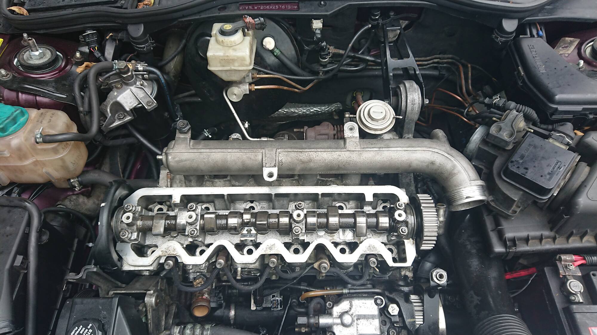

I had a similar timing belt session a couple of weeks ago.
You'll notice there's quite a lot of rubber not there, it was all inside the timing belt area making everything sticky and causing the belt to jump a tooth. Lots of farting around later and I think I've got it working. They're great engines but a fugging nightmare to work on.

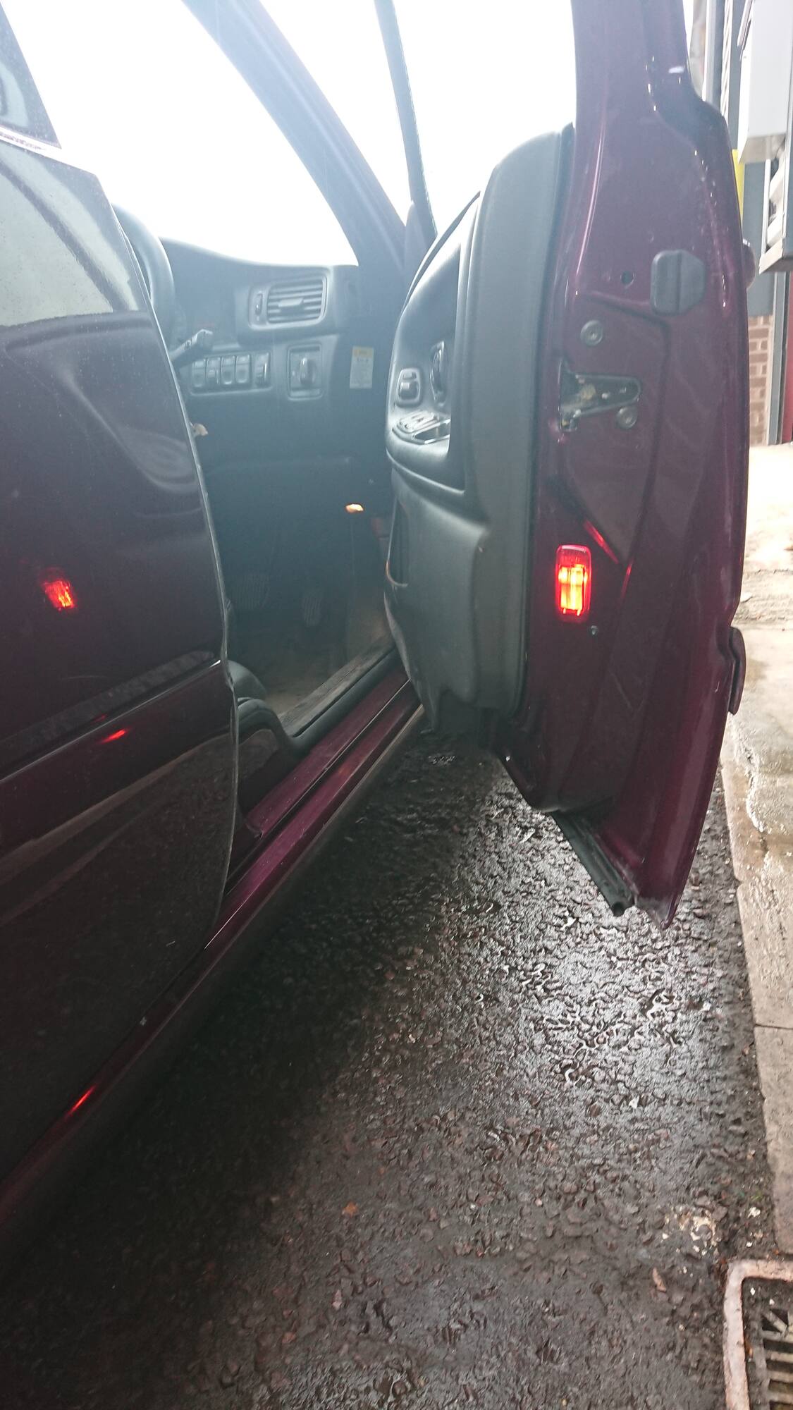

All door lights present and working, as are footwell lights. Front fog lights now have additional sidelights and flash with main beams. Yellow bulbs. Proper sidelights also yellow and dipped beam is osram all season, with are both not yellow enough for my liking and expensive enough to stay. Full beams are still nightbreakers. All the front lights came from donkey.

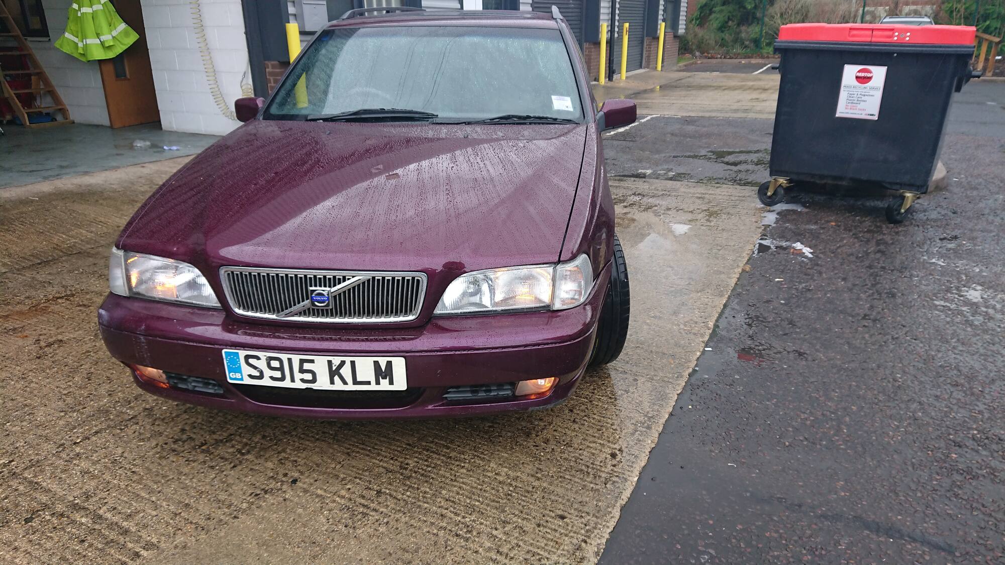

So there it is, my Purple Throbber. I had to show it to you now really, as it’s never been shinier and likely will never be this shiny again, but I’m proud of it, so thanks for looking.
Well played chap, looks spectacular.
It must be really satisfying after all the work you've put in, a well deserved victory.

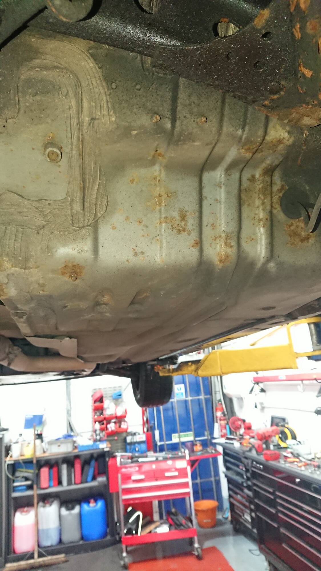

So how rusty is our newly acquired, 20 yr old Mercedes ?
its pretty good. Mostly. There are (a couple?) of bad bits though.
thats the fuel filler pipe . The other side looks better
but is structural paint with the strength of wet cardboard. I’m going to have to learn to weld. I’m 41, have fucked about with cars and bikes all my adult life, and have managed to avoid learning to use the sparkly stick... which is a bit of a poor show to be honest. this looks to be the perfect opportunity. It is time to Man Level Up, or fry trying.

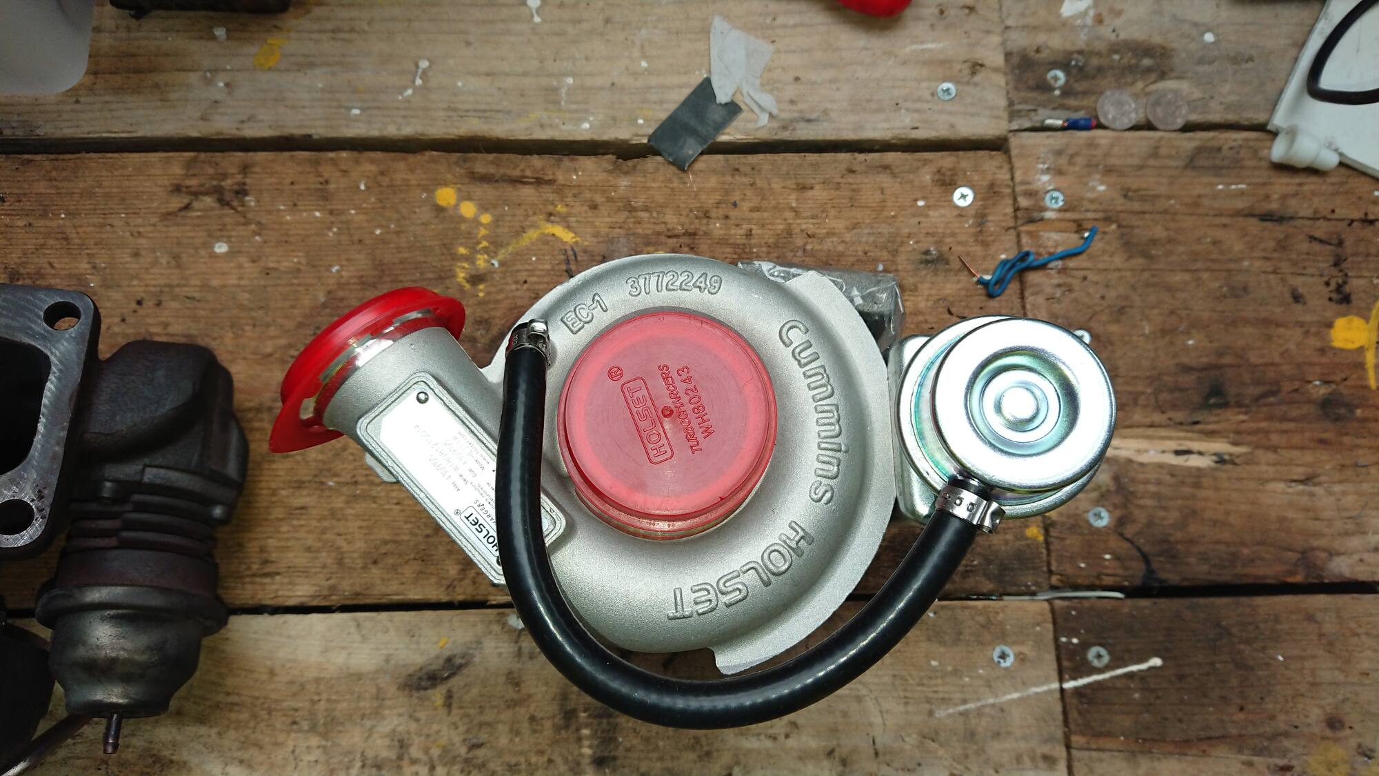

Yes it is destined for the Throbber. It was too cheap to ignore so i didn’t. A bit of a Fisher Price / Step Of Manhood moment, My First Tuning Turbo. It’s that lovely if I don’t use it on the car it can come into the house and be an ornament.
 I don’t know about remapping, yet. Apparently, so a man in the pub told me, you can get good results (circa 250bhp) with bigger nozzles and a tuning box (which I already have) so we’ll probably start there. The ecu from the engine donor car is allegedly chipped, but no one could answer who by or when, so who knows, but it’s another (untried) option. That’s all for winter though, getting it back on it’s feet has to come first really.
which, all being well might happen next week. (Famous last words!)

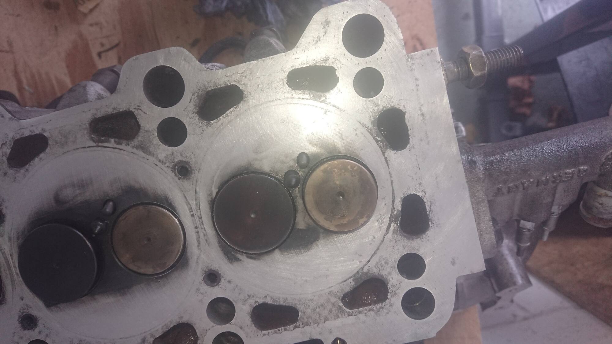

Yep. The new* engine is pressurising the coolant under boost. To the extent that the car behind had to put on their wipers.

4 hours of lacsidasical spannering finds me finding a rusty head bolt. Hmm.

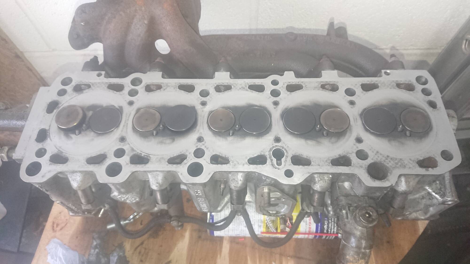

and a few moments later I delicately stood on the car and birthed the head. Much better for my back. Don’t think I fucked anything.
And how does it look? Blowy out the end. That’ll do it.
Get a gasket on it lad and crack on. Top choddage right here.
I'm impressed by your perseverance, lesser mortals (Including me) would have well and truly sacked this off and be sulking in a corner by now.
Cleany cleany with white spirit and a teethbrush
Cleany cleany with flat block mounted 400 grit wet and dry with wd40
Can you guess where it was blowing? No wonder the coolant was falling out.
Checked with a engineers straight edge and all looks good. ?

Shiny block with clean dry stud holes.
Shiny new not shite gasket. 3 layer steel rather than the brown composite one found in it.
And 'just popped' the head (and fannymoulds and turbot - it has a bit of weight to it) on.
Hurrah. Then the difficult bit, attaching the turbo drain pipe. Down the back of the block sandwiched between the starter motor and turbo. Can't see it. It's a sod.
And 2.5 hours later it started to rain and I took the hint to give up before I lost my patience. I think the drain pipe is bent as its not lining up. There is space for maybe 3 fingers and I need to hold the pipe head very hard in place, the paper gasket, the bolt, find the bolt hole and get it to bite, all uphill.
