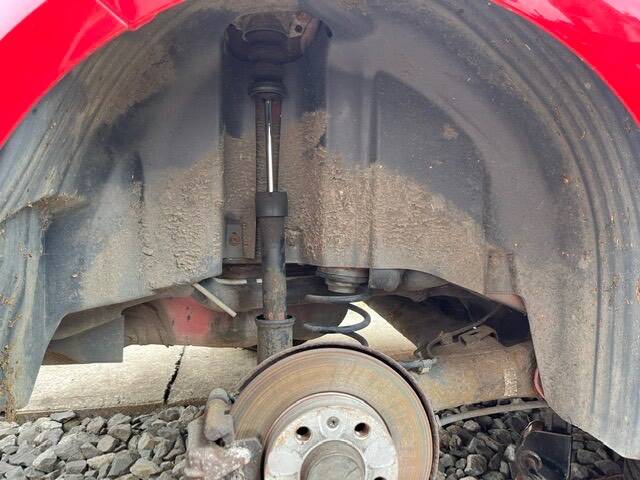

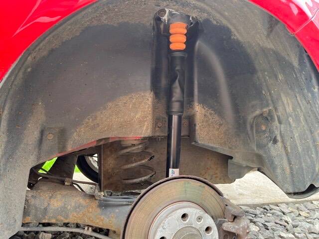

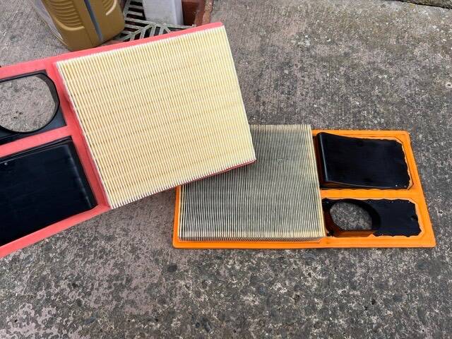

83C Posted May 14, 2024 Author Posted May 14, 2024 Whilst I can look forward to a collection in a couple of days, work hasn’t stopped on the rest of the fleet. Today it was the turn of the recently acquired Ay-beeeeef-ah for a service and a few other bits. This is going to Cornwall in a week or so to be outstationed at the in-laws as a car for my MiL and also for us to use when we’re there. Driving it back from Norfolk it became very obvious that the rear dampers were shagged. Fine on smooth tarmac but any bump had the rear wheels skipping around. A few days ago a pile of parts appeared. One of them is incorrect, more on that in a bit. Thankfully unlike the VXR8 epic swapping the rear dampers on the Ibbitttza is a doddle, jack back end of car up and remove wheel: The dust cover had split into its separate components, and the bump stops didn’t look too clever either - the n/s one had split in two. Fortunately the new pile of bits also included topmounts and bump stops, so the only bit needed from the old unit was the dust cover. From this: To this: Sachs dampers - OE fitment according to the labels, so it’s actually rather pleasing to fit replacement units that are the same. And back on: The eagle-eyed among you will have noticed the before photo is the o/s/r, and the after photo is the n/s/r. By the way, if you’re planning to do similar make sure you have a 16mm socket and spanner in your set. Who the fuck uses 16mm? Well, Seat do. Crazy Spaniards. Test drive confirmed that the suspension was now behaving itself, so onwards to the service. Engine bay was minging: I much prefer these canister-type filters, they’re invariably easier to deal with. Cleaned out and ready for the new filter: The old and new filters - always worth checking that they’re the same size: Sadly the intake for the used oil pump won’t fit down the dipstick hole on these engines, so it was off with the undertray and sump plug out the old fashioned way. Went to put the oil in and looked again at the label - I’d ordered 5w40 and this was a bottle of 5w30. I think 5w30 is a bit thin for higher mileage engines (reinforced by a video a while ago by @richykitchy ) so I’ve been careful about which oil I order. The 5w40 does meet the specs for the BTS engine, so off back to Halfords I went. They were good about it, a straight swap. Only then did I realise that the 5w30 is ten quid cheaper than the 5w40 for a 5L bottle, even with the trade discount, so I’m definitely glad I went back and made sure I got the right oil. Note to self - be more careful and double check they’ve picked the right items when dropping in for a click and collect order. Once that was back together it was the air filter’s turn. It didn’t look too bad but the new one was already there, so in it went: Once that was back together the engine bay got a wipe over: Not exactly a concours-spec toothbrush job but clean enough. Last filter to change was the cabin filter, located in the passenger footwell: Move two clips, pull old one out, fit new one to frame, slide back in and refit cover. Easy. Final job was to fit a replacement switch pack in the centre console - the aux input was knackered on the old one. The flap that covered it was loose anyway, but the sound was only transmitting to one speaker and the input cable wouldn’t sit securely, indicating the jack itself was broke. Testing the new one before clipping it in: And all done. An easy, steady afternoon. High Jetter, Dyslexic Viking, mercedade and 8 others 11

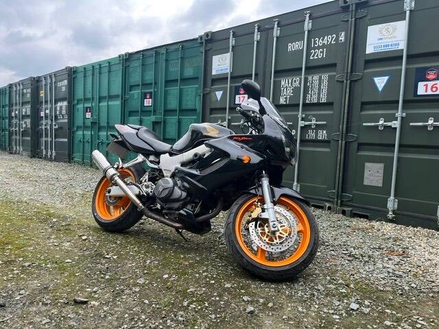

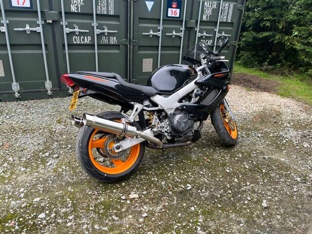

83C Posted May 21, 2024 Author Posted May 21, 2024 Second go today at collecting the eBay win: Its a Honda VTR-1000F. It’s ok as a ten-footer, paint isn’t great, anodised bolts are a bit naff (may well replace those) but it sounds well and crucially, I actually have a key for it. Unlike the Triumph 🤦🏻♂️ Joey spud, LightBulbFun, Burnside and 5 others 8

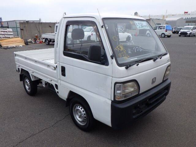

83C Posted May 21, 2024 Author Posted May 21, 2024 And now for some procrastination. My current car obsession is importing something. This has its roots in last year's trip to Australia, where initial plans involved buying an old Commodore or Falcon, using it and then shipping it back at the end of the holiday. That idea got overtaken by events, because plans changed and a camper van was rented for much of the adventure instead. However the idea hasn't really gone away, I am going back to Oz in a couple of year's time so the idea of a Falcon XR6 or Commodore SV6 might still happen. But then I'm also considering a GU Patrol or 90-series Land Cruiser for that particular trip. Either way though it's not happening until 2027 and I'm impatient. Watching lots of Mighty Car Mods recently has had me looking at JDM imports, not the usual fast things but either small nonsense like a Honda Acty pick up (which I probably wouldn't even fit in but it'd be good for shits and giggles): Or maybe a Toyota Crown wagon for some 1JZ or 2JZ goodness: If I were being really silly and felt very flush I'd want one of these: Toyota Crown Majesta with the 4.6 V8. Around £6k for a 2011 example including shipping. The thing is there isn't so much adventure to actually obtain the car, the fun starts when the boat docks and the car needs to be made UK road legal. So, onto Europe. Something like this Opel Omega really appeals. 2.6 straight six with the dual ram intake, 4-sp auto so all pretty solid kit. This particular one is in Dresden so a road trip home via a couple of attractions (Sinsheim Museum, Nürburgring) sounds fun. Obviously that reduces the budget as some of the money goes into the trip itself. None of this will probably happen until next year (though I nearly had a drunken credit card accident last night with a JDM Suzuki Jimny) but its fun to think about it and maybe plan something. AnnoyingPentium, mk2_craig, warch and 6 others 9

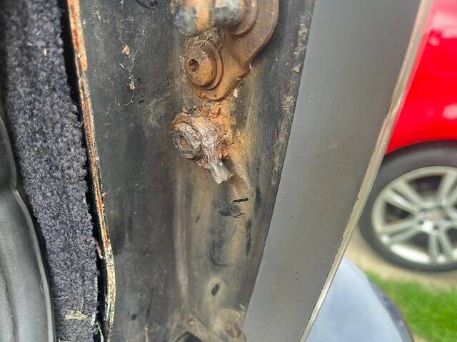

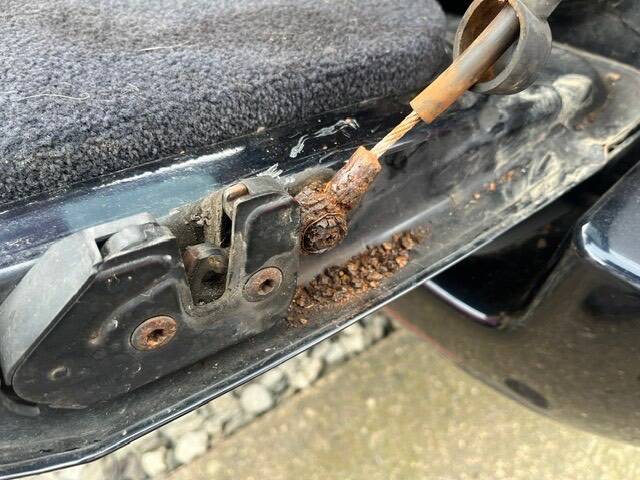

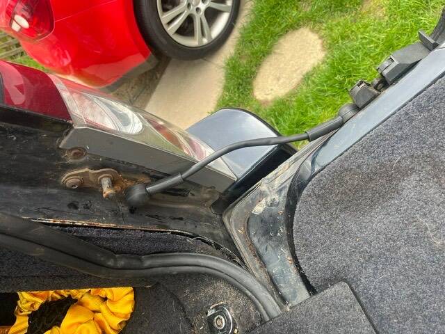

83C Posted May 23, 2024 Author Posted May 23, 2024 The Range Rover is a stalwart of my little fleet, solidly reliable, comfortable and properly go anywhere, do anything. However I have been a bit guilty of neglecting it beyond essential servicing so outside is a bit tatty, as is the inside, and various bits are coming due for some attention. First up, the rear lower hatch check straps: As can be seen, they’re buggered. Both sides, heads all knackered too. So it was out with the grinder, slot the heads and get a big flat head on them, luckily the bolts weren’t seized in the threads. 10 minutes later and: Cheap fix too at £12. The Ibbittzaa was made ready for a long distance trip tomorrow, with a cable tie bodge to a broken parcel shelf clip: It now sits in properly. Next steps for the L322 will be air system fixes (compressor isn’t great and rear valve block is suspect), interior refresh and finally some bodywork. Burnside 1

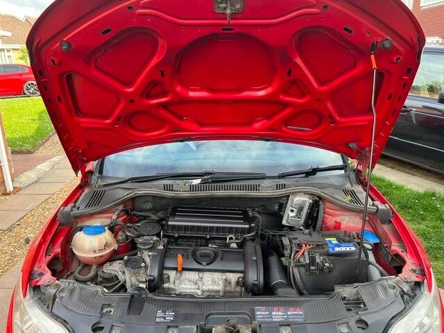

83C Posted June 1, 2024 Author Posted June 1, 2024 The Ibiza is now in Cornwall: Beachfront picture fail as the car park was busy. In other news: JJ0063, Dave_Q and Sunny Jim 3

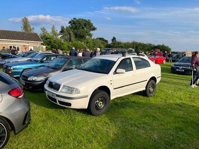

83C Posted June 5, 2024 Author Posted June 5, 2024 Local meet at High Ercall this evening, always a good selection of vehicles: Dyslexic Viking and fatharris 2

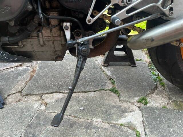

83C Posted June 28, 2024 Author Posted June 28, 2024 So with the Fabia gone, the next job was finish getting the FireStorm ready to sell. The kickstand wasn’t ideal and leant the bike over far too much for my liking: The replacement came as a complete unit but I opted to swap the kickstand sensor from the old one because a) I knew it worked, and b) I didn’t fancy tracing the other end of the lead to find the plug where it seems to disappear under the fuel tank. 20 minutes later: Bike now feels much more solid. New kickstand also doesn’t visibly bow under weight like the old one did. Next up on the block: the Rio, the 106 and maybe even the Triumph Tiger.

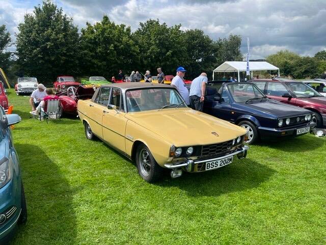

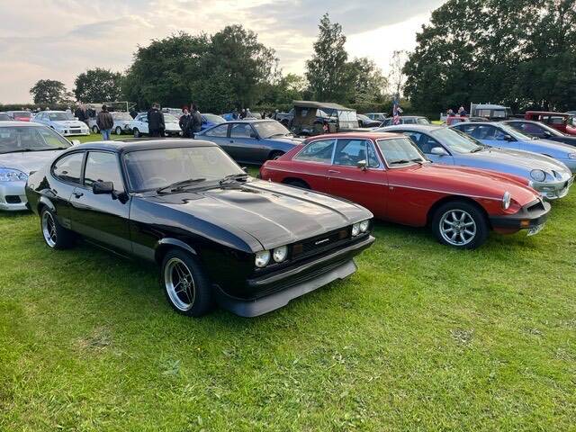

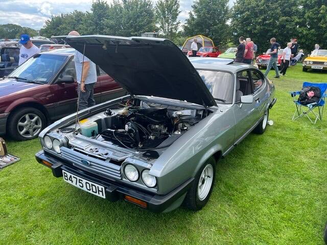

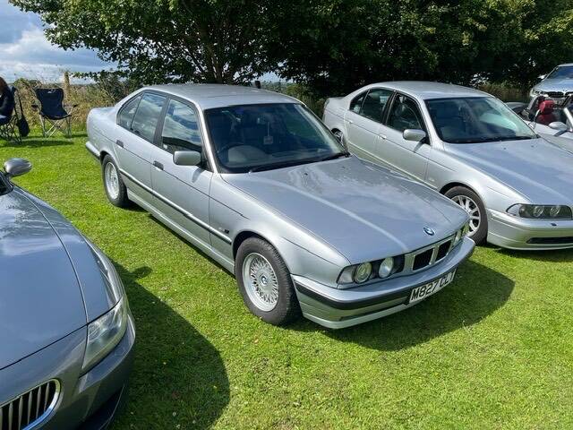

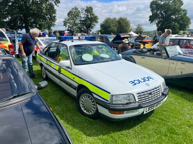

83C Posted July 14, 2024 Author Posted July 14, 2024 Today I’m in Longden near Shrewsbury for a local car show: Some of the highlights: Seen this somewhere before. Sunny Jim and fatharris 2

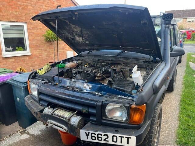

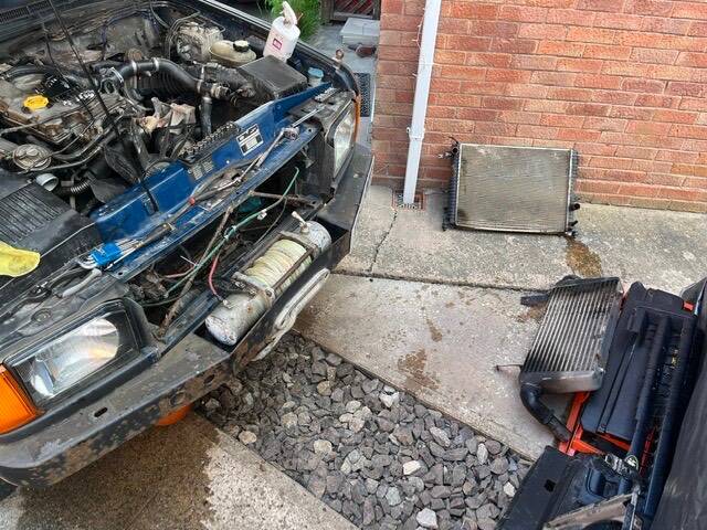

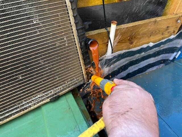

83C Posted July 22, 2024 Author Posted July 22, 2024 Thought I’d take the family and do a couple of lanes yesterday, my sister joined us in her 110. Play was very quickly cut short by the Disco suddenly sending the temp skywards, the red light coming on and then the temp gauge falling to zero. Fortunately we were by a pub at the time… I cracked off the header tank cap, waited for the bubbling and hissing to stop, then took the cap off - at which point all the coolant tried to fuck off in a Vesuvian eruption of steam and hot water. After many swear words were said, the system was refilled and bled, and seemingly all ok. We carried on uphill for a bit and then lost heaters, so something was clearly amiss so we sacked off the lanes, went back to the pub and then home after topping up the coolant again, and throwing a dishwasher tablet in with an eye to today’s shenanigans. Going home involved 10 miles of driving and the Disco behaved itself for the rest of the day, coolant not overheating, heaters working. Same today, did a few local trips this morning and no issues. Seems to be an issue when there is minimal airflow through the rad and the engine being worked fairly hard, which would explain why it wouldn’t show at normal road speeds. With this in mind, out came the tools… First up was washing out the rad, which was fairly grim: The rad itself doesn’t look too clever but isn’t leaking at the moment. Next step is to flush out the engine itself. Dyslexic Viking and Dave_Q 2
83C Posted July 22, 2024 Author Posted July 22, 2024 A bit more digging and this fine* specimen of a shit thermostat design is unearthed: This isn’t my first encounter with these plastic ‘stat and junction in one things, MG Rover also used it in the later 1.8T K-series as found in the ZT I had last year. There are actually two discs in these, with a smaller one in the angled pipe and the main one roughly in line with the outer ring on the main body. Small one moved easily, big one took several hits from a big screwdriver before it shifted: This side is the side that goes to the rad bottom hose and it was filled with the same brown/red crap that the rad spewed out, which is why it probably gummed itself shut. Other side was fairly clean. The next step was flush the engine itself out, so top hose back on and wedge the hose in: Water flowed out of the engine nice and clean, so I’m guessing the rad silted up, blocked the ‘stat just enough and when faced with some very slow plodding up some fairly steep hills it was just enough to upset things. New stat, good clean out and a few other things and it should all be fine. I do want to replace the plastic header tank with an alloy one at some point, and I’m going to rewire the winch controls as the cables are a bit under specced for the amps that a winch can draw, but I’ll get it back together and running again first. Dyslexic Viking, LightBulbFun and goosey 3
red5 Posted July 23, 2024 Posted July 23, 2024 Those stat's are prone to just that - apologies chap. I flushed it once when putting it back on road after a year off whilst I procrastinated about stripping it and it came our clear enough (after bicarb flush). I do suspect the PO was a leak preventer additive type mind - although that might just be sludge stuck behind stat? it'd not missed a beat over 600 miles of towing/traffic since welding repairs on reflection maybe Ishould have changed it when I did the top hose bleed screw split pipe... May, 250 mile round trip (Hooten Lodge) June 400 mile odd trip (Dawlish Warren) Dave_Q 1
83C Posted July 23, 2024 Author Posted July 23, 2024 @red5 no problem at all fella, it looks and feels a lot more like sludge of some sort to me, plus a few small lumps came out of the rad. Just one of those things.
83C Posted July 23, 2024 Author Posted July 23, 2024 Onwards with the Disco. Went out this morning and collected a few bits, so this afternoon’s task is to clean up and get everything ready to reassemble. First job - clean as much of the oily schmutz off as possible. A reminder of the end of play yesterday: And after some detergent and lots of scrubbing: Still shit high but better than it was. The oil has been leaking for some time from here: It shouldn’t be able to come out using just fingernails: This cap is a known leak spot on TD5s, and normally the answer is to replace it and the O-ring. However because I’m a fucking idiot I forgot to get one this morning, so if there are any professional mechanics reading this, look away now: Nope, it isn’t the right way of doing it but a thin smear around the edge will do until I get around to doing a proper job with a new one, and more importantly will stop the engine chucking all its oil down the front of the head, block, EGR cooler, belt, pulleys and whatever else is in the way. Onwards. Dave_Q, Westbay, fatharris and 2 others 2 3
