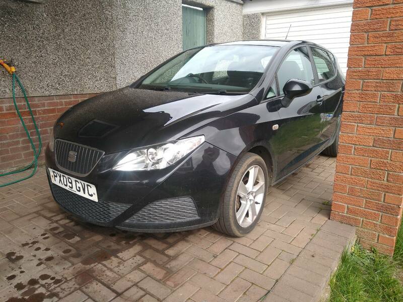

And here we are. A 2009 Seat Ibiza 1.4tdi Ecomotive. The same 3 cylinder PD engine as the A2 had, so that should be fine*

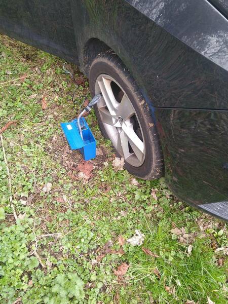

First things first, inflation was required. I'd already done this when viewing it so knew the inflator was there.
Install copilot
No dash lights at present, I'd already reset all the codes

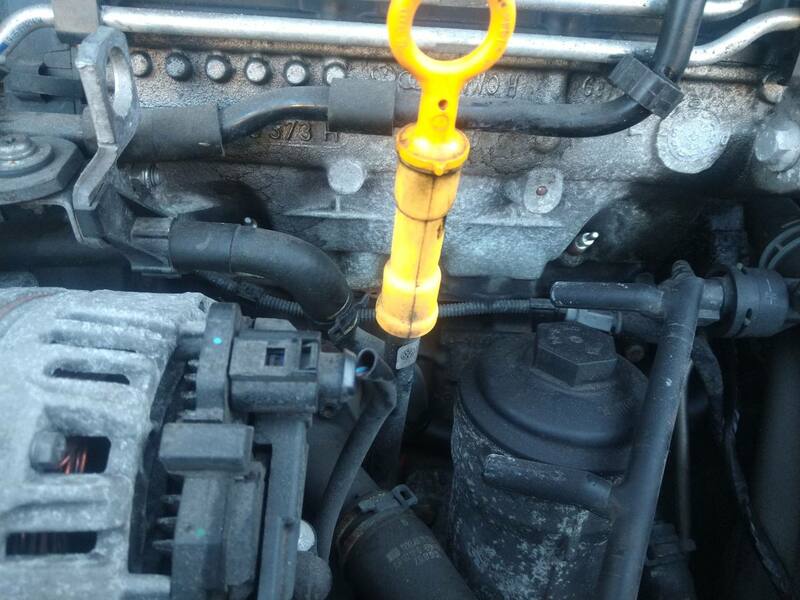

First things first, I popped the bonnet and discovered this.
All 3 glow plugs were unplugged. Now, as the car has sat since January it's safe to say it wouldn't have been running very well in the cold like that.
I plugged them in and plugged in my code reader. It gave a load of faults, mostly related to the glow plugs but also a P0234 for boost pressure.
I cleared all of these and fired it up.

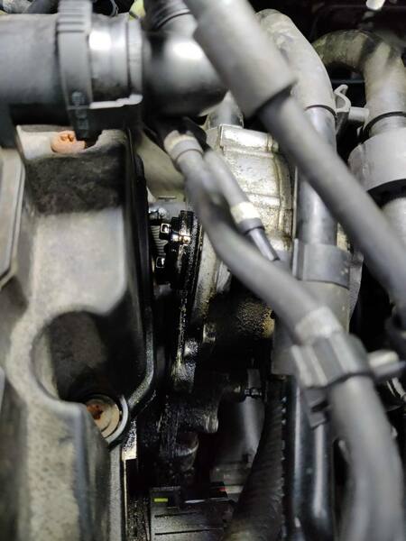

Hmm. That chuffing and oil leak is coming from the tandem pump, a fuel pump on the side of the head driven off the camshaft.
It could be as simple as needing a new gasket or it could be more serious.

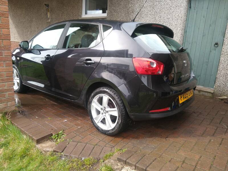

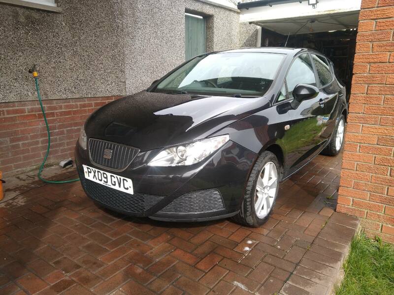

So, back home and I gave it a quick wash and soak in TFR to see what we had.
Not too bad. Pretty straight but it's a long time since it's seen polish. That can wait though obviously.

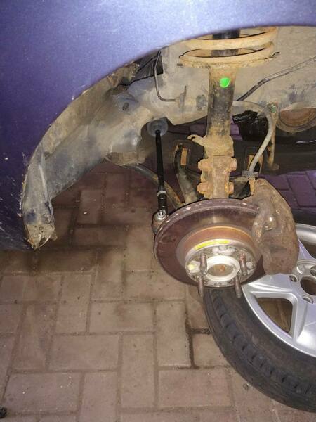

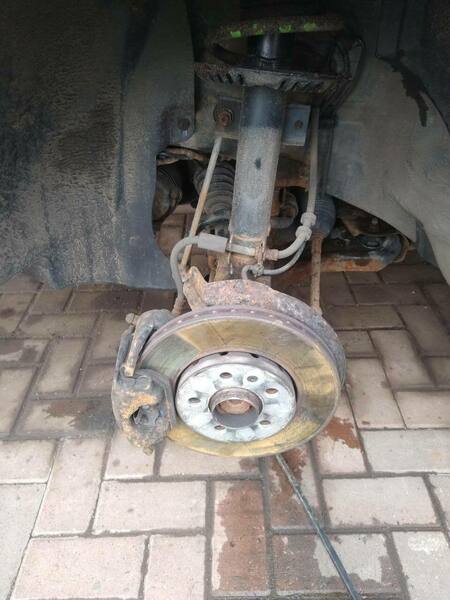

I popped the wheels off to see what i could find. Recent discs and pads on the front and possible struts/springs too

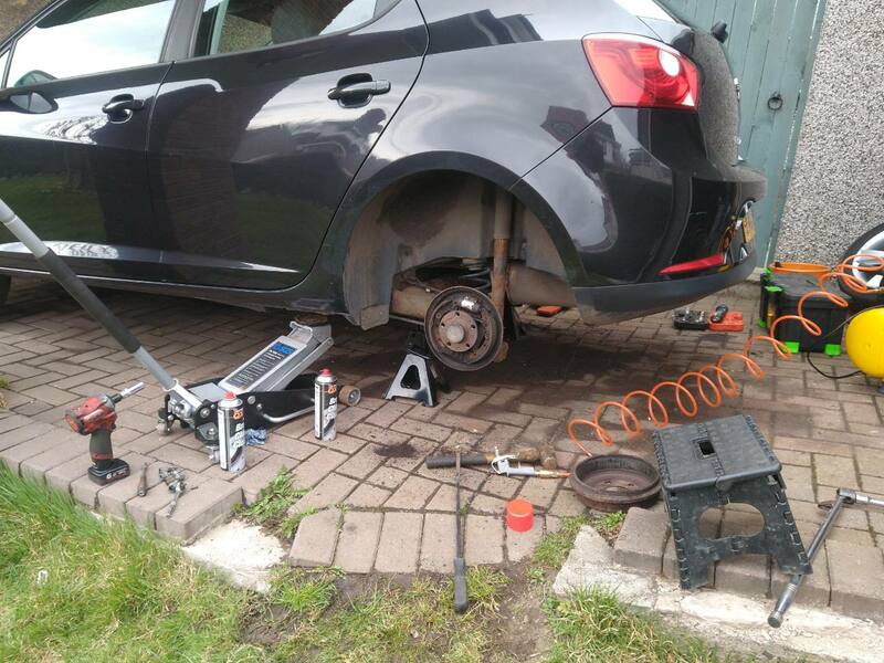

The rear brakes were pretty manky inside and the shoes have been replaced at some point as they are Mintex, all I've done for now is clean them up.

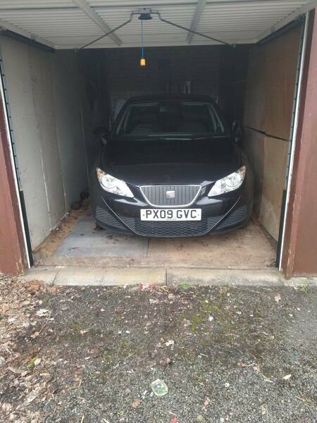

It's currently tucked up in my lockup awaiting parts arriving.
On the basis of my investigations I've ordered the gasket that goes between the pump and the head, an inner and outer track rod and a drop link on the front.

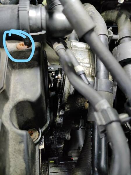

I did a bit of prodding and eventually found a possible cuplrit.
Going back to this picture, see the rocker cover bolt circled? The one right above the tandem pump where the leak was?
Yep, it was loose. Like, properly loose. Balls.
I went back round and torqued all of these up but it's still leaking. I guess a new rocker cover gasket is in order then.
One of the bolts looks a right arse to get to round the back. Hopefully I can get to it without removing the inlet manifold but it'll be tight.

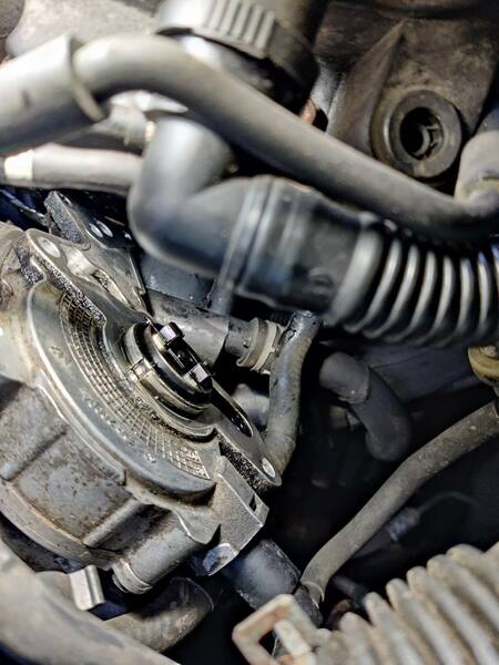

I had to buy a long reach T30 as one of the rocker cover bolts was toit. Got it off and look what I found.
I'm going to suggest that I may have found the source of the oil leak.

First up I jacked it up to get the track rod and drop link changed. Needless to say these were a pain until the angle grinder came out to play.  The drop link was easy enough once I'd ground off the old one.
I'd chopped down a 32mm spanner to change the inner track rod on the Kangoo, handily this also fitted this. It was easier to get the Kangoos one changed than this one though, it was tight. The inner track rod was well fucked-it had been an advisory on the last MOT. I'd bought an inner and an outer to make things easier. This was handy as the outer started to rotate as I undone it. The grinder came out again to cure this.
Back together and I stuck the spare on so I could get a slow puncture repaired.  I also stuck a new air filter in it.

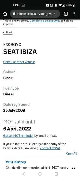

2 things happened today which made me happy.
First, the Ibiza passed an MOT 😁
Second, for the first time ever, I didn't have to pay to tax a car!IMG_20210407_131813.thumb.jpg.e5acdf3a88d788b33012cf44c0e296a5.jpg
Free tax ftw!
