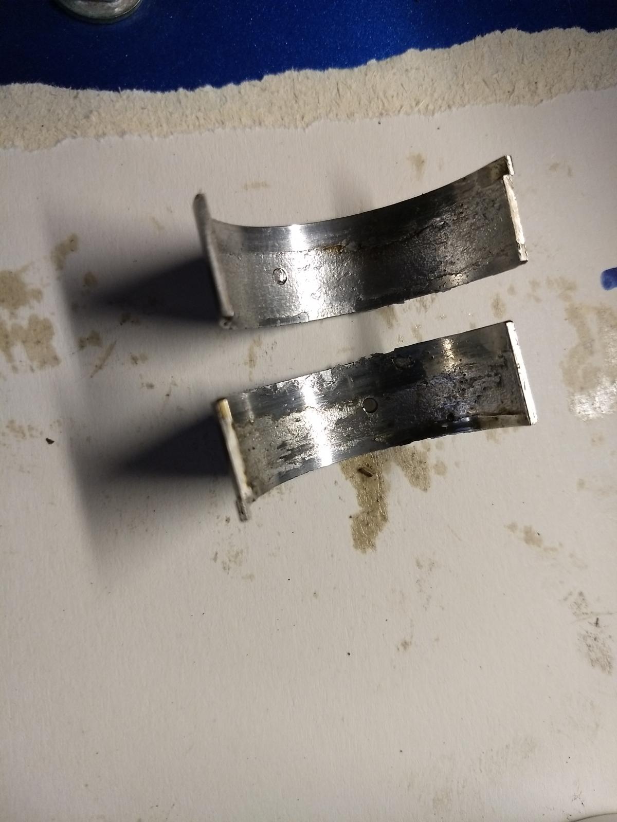

Very shortly afterwards the sump was off and numbers 1 and 4 big end bearings were available for perusal. Both had some play in them before unbolting them which indicated we were on the right track.
Number 4 looks a bit worn but not too bad.
Number 1 however...
S'fucked mate.
You'll note how we go for F1 levels of workplace cleanliness here at Cowboy Motorsport.
The crank seems OK. I'll inspect it properly and will maybe CAREFULLY smooth it over with emery paper.
Likewise the sump contained no nastiness and the oil whilst black looked OK.

Ouch! Be save of the century if you get away with that one. Saying that, I can't say I wouldn't try it myself: what's to lose at that price?
There's a good chance the mains are just as bad, is it worth changing the halves you can get at?
Can you feel anything other than silky smoothness over the crank journals with a finger nail?
Those bearings look wierd too - like they have eroded rather than worn.

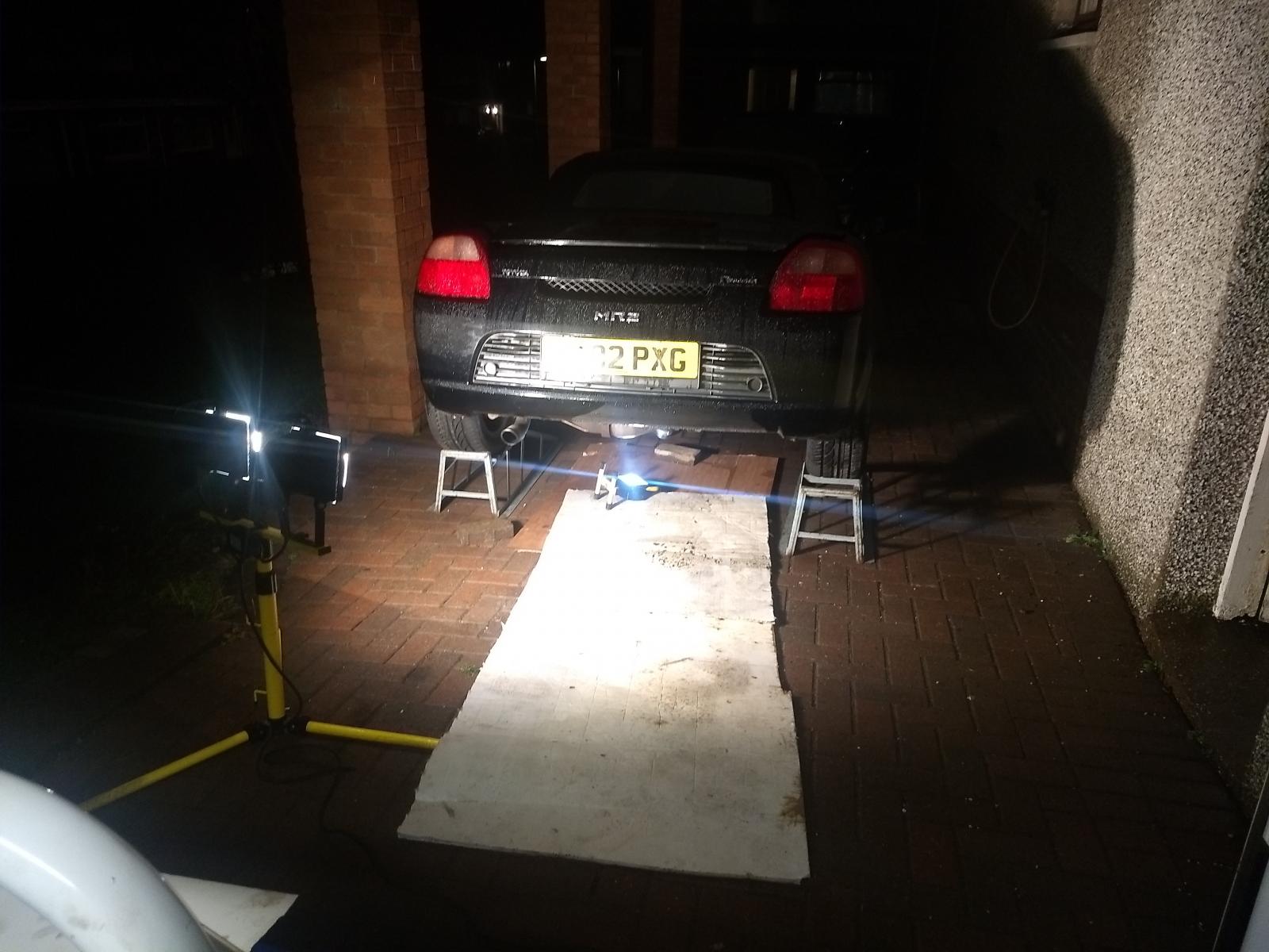

I came home and set up my workspace...

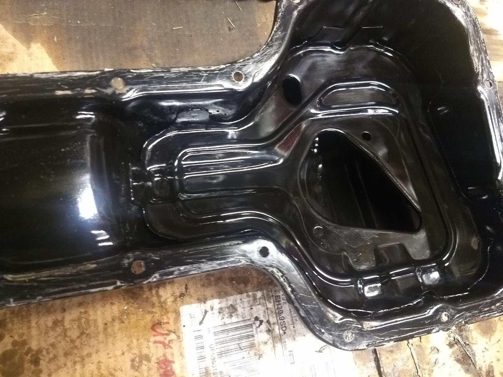

While I was doing this my mate was scraping the sealant off the sump. Closer inspection revealed the sump was a bit manky so a slightly extreme solution was sought-hose!
It's a good job we did as aswell as bits of sealant which had fell in to the sump there was some gunk in the bottom aswell as what looked like bits of big end  :shock:
With a good blast and dry out it looked like this

Nah, crank was fine and only 1 big end was really bad. 1 other had some play and the other two were OK.
