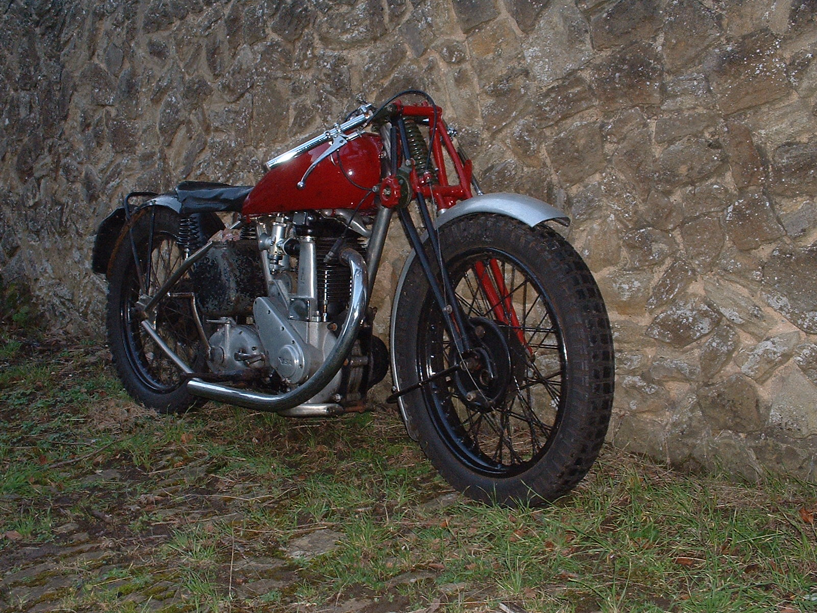

Wot lights? I do have an acetylene lamp which belonged to my Granddad but haven't found the MOT nor road regs  which cover it.
That looks brilliant.
I'd fit the lamps, just for the entertainment of confusing plod at 4am half way up the M1.
