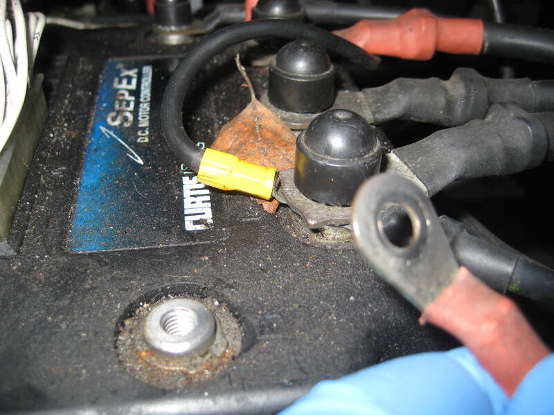

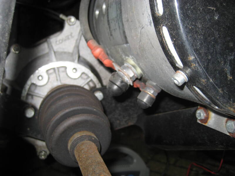

strangeangel Posted January 5, 2020 Author Posted January 5, 2020 Finally recovering from the old Man Flu, I thought I'd have a morning at the Aixam. It wasn't a great success... The plan was to isolate the power and clean up all the 48V connections. I made the exciting* discovery that turning off the main breaker switch still leaves 24V appearing at the live terminals on the speed controller. However, all thoughts of fixing the ungrateful little bastard went out the window when it somehow activated the central locking with the keys in the ignition. Much was there swearing, and I had no choice other than to go old skool car thief on its ass with the ubiquitous wire coat hanger. Once back in the car, I lifted up the battery covers and disconnected what look to me like the main live and earth from the traction battery pack: Wrong. Next job is to remove the seats so I can get the battery enclosures off and properly disconnect all the power. I'm not fannying about with those connections until I'm satisfied that there's no electrickery of any description knocking about. But that's a job for another day, I think. LightBulbFun, egg, somewhatfoolish and 2 others 5
strangeangel Posted January 23, 2020 Author Posted January 23, 2020 After a fairly successful morning upgrading the garage's solar power system, I decided to have a go at the Aixam. The aim of today's session was to definitively isolate the power from the engine end of the car, in a real and definitive way totally unlike the way that the main isolator switch fails to do. This job necessitates the removal of the front seats. Well, that can't be too hard, can it? WRONG. The runners are bolted to the inner sills without the benefit of captive nuts, so the whole lot just turns. Helpful. You can't unbolt the seats from the runners either. Yes, that's right - Aixam really did build the whole fucking car around the front seats ? Much sitting around variously swearing, tutting and muttering led me to the only possible way of getting the seats out: if you push them far enough forward they should just fall off. Well, not *just* fall off, they'll need a good shove against the dash, because the runners are, helpfully*, that bit too long. None of this was helped by the fact that the runners were as dry as a nun's twat and were all but seized in place. Eventually, after much pulling, pushing, kicking, grunting and swearing they came off. This was achieved at some cost, you can see from this photo how the seat runners have been 'flared' as a result of all this. The car is made with everything at the lowerst tolerance they could get away with. Granted, that's for obvious reasons particularly with this electric variant, but it doesn't make it any less of a ballache to work with. I'll straighten those some other time. By the time I'd disconnected all the power lines from the battery pack (and carefully labelled them all, natch) I'd had more than enough for one day. In other news the BX trundles ever onwards. The washers failed last week, thanks to a build up of rust in the washer jet that runs through the boss of the wiper spindle. A straightened paper clip and a good clean of the length of hose between the tank and the nozzle fixed that. Unbelievably, MOT time is starting to creep into view (early March)! The Ami is still rattling along in its own, inimitable style; now with the added benefit of yellow headlights! UltraWomble, LightBulbFun, RobT and 7 others 10
strangeangel Posted February 4, 2020 Author Posted February 4, 2020 I've been up to all sorts these last few days... pretty much anything that means I don't have to work on the Aixam. Today I gritted my teeth and got on with it, with about the same level of success as previous attempts. Now the power's off, I can take off and clean all the high voltage connections. This was easy, a little wire brush on my Dremel did a cracking job: In all honesty none of them looked corroded at all, unlike the car's frame. Finally, I got round to the ones on the motor - there are two lives and two earths to it (why?). Both of the lives have melted plastic caps. Access to the lower pair of connectors was much improved by removing the car's inner wing. This was a lot less painful than you might think, but Aixam fashioned the car's inner wings (and sump panel) from sound-proofing mat. As you might expect, all this achieves is lots of water gets held against the car's frame, which helps it to rust as efficiently as possible. While I was rummaging around I found more work that'll need doing: And then onto the motor, The connector is impossible to remove because the nuts above and below are tightened against each other: And that would be OK had Aixam not used a nut so shallow so as to make it impossible to get a fucking spanner on it ?. I went to Halfords to see what they had in (our local factor in the next village packed in last year), and that was an education in itself. They had no spark plugs (needed for the beige BX) and I waited 10 minutes while the sole youth on the till stood with the phone clamped to his ear. I waited, on the assumption that one of the other half-dozen people employed there would be with me in just a nanosecond, but that wasn't happening. In the end, I gave it up as a bad job. Cursing under my breath, I wondered how I would ever get the motor out of the Aixam. And then, in a flash, I remembered how to think like a 'shiter again! I went to the pound shop and bought some fairly wanky looking spanners. I think you can guess where this is headed, can't you? More soon! BONUS PICS: Giffer damage caused by grounding the battery shelf: The battery shelf is total crap, in a moment of mischief I twatted a suspicious looking bit with a tyre iron. Mmmmm: Lovely pile of oxide: stonedagain, johngarty, chodweaver and 3 others 4 2

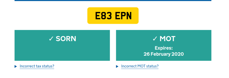

strangeangel Posted February 14, 2020 Author Posted February 14, 2020 It's around this time for the last couple of years that I start stalking E83, my car's sort-of sibling, to see how it's got on with the dreaded MOT. This doesn't look great: Hope it doesn't end up being terminal...
barrett Posted February 14, 2020 Posted February 14, 2020 Is that the red one? I'll drop in on my local Citroen garage and see if he knows the score. I'd be very surprised if hadn't done some work on it over the years.
strangeangel Posted February 14, 2020 Author Posted February 14, 2020 18 minutes ago, barrett said: Is that the red one? I'll drop in on my local Citroen garage and see if he knows the score. I'd be very surprised if hadn't done some work on it over the years. That's the one, yeah.

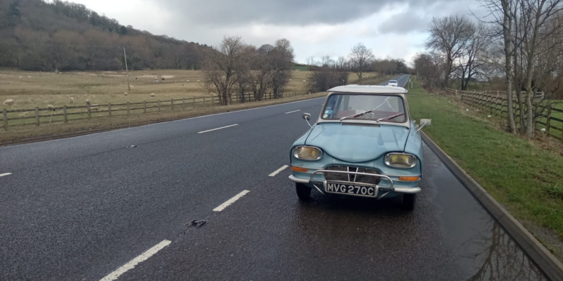

strangeangel Posted February 17, 2020 Author Posted February 17, 2020 Right then... Autoaid have been summoned. Apparently the 'Prestige Team' is required to deal with the Ami for some reason? They're sending someone local to check that it's actually broken first, given that I want it taking home, rather than to a garage. Place your bets - will I be home this side of midnight? HarmonicCheeseburger, stonedagain and richardmorris 3
strangeangel Posted February 17, 2020 Author Posted February 17, 2020 Half 12 and the triage man arrives... "I had to Google this 'cos I didn't know what it was!" "Well, mechanically it's a 2CV if that's any help?" "Only ever seen those on the telly" [I open the bonnet. He looks quizzically into the void] "Fuel pump, yeh? [pauses for thought] So you just want it recovering home then?" "Yes, please" "I'll ring them now" ? Saabnut, brownnova, Spurious and 8 others 6 5
